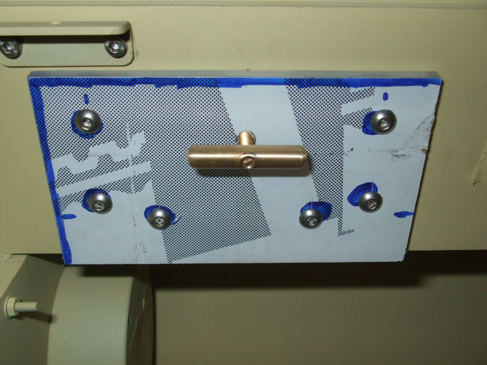

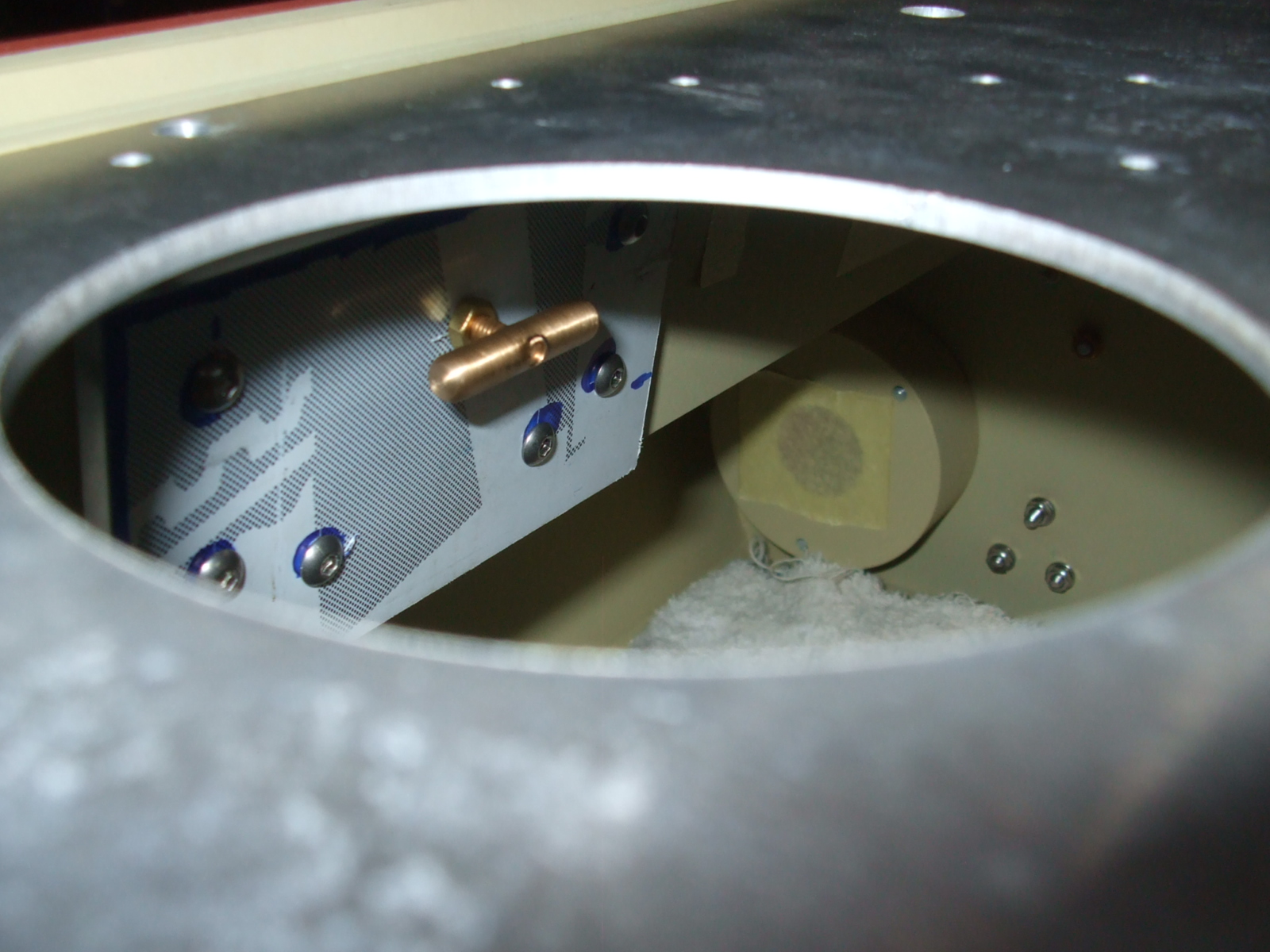

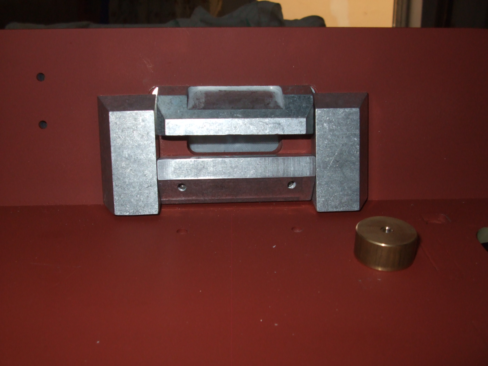

Last weekend played a bit with the driver's vision port armour and I think I found a non-permanent solution of how to keep the vision port open.
Drilled and tapped a 3mm hole just above the vision port and made a special screw (from the scrap bin) to lock the armour in the open position.
Like this I can have the port either open or closed and I can reach the screw from the driver's hatch.
I also covered the port with a piece of Lexan sheet but for now left the Lexan protective cover in place. If anybody needs a diagram of the position of the bolt holes I can also put it on the forum.

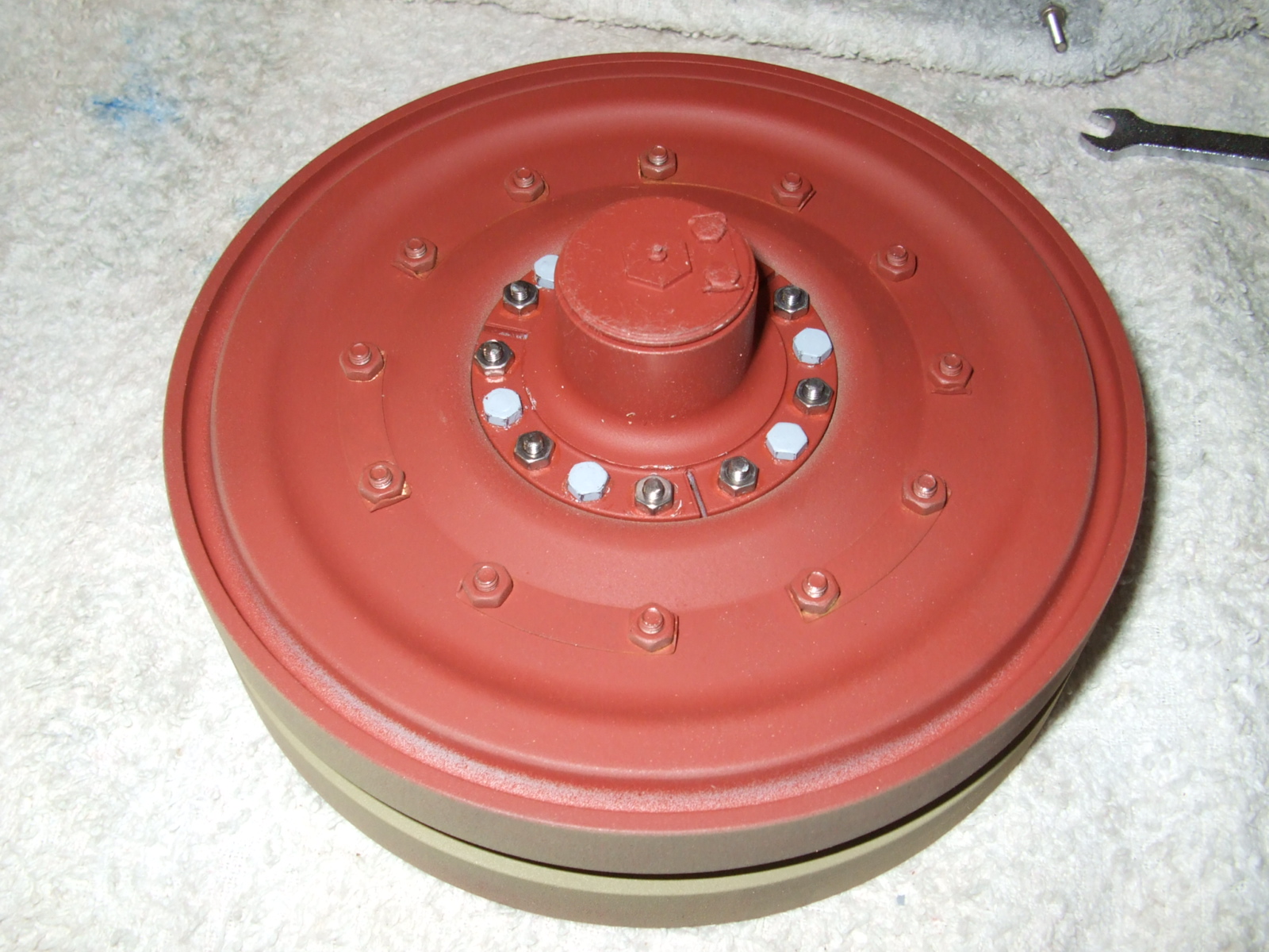

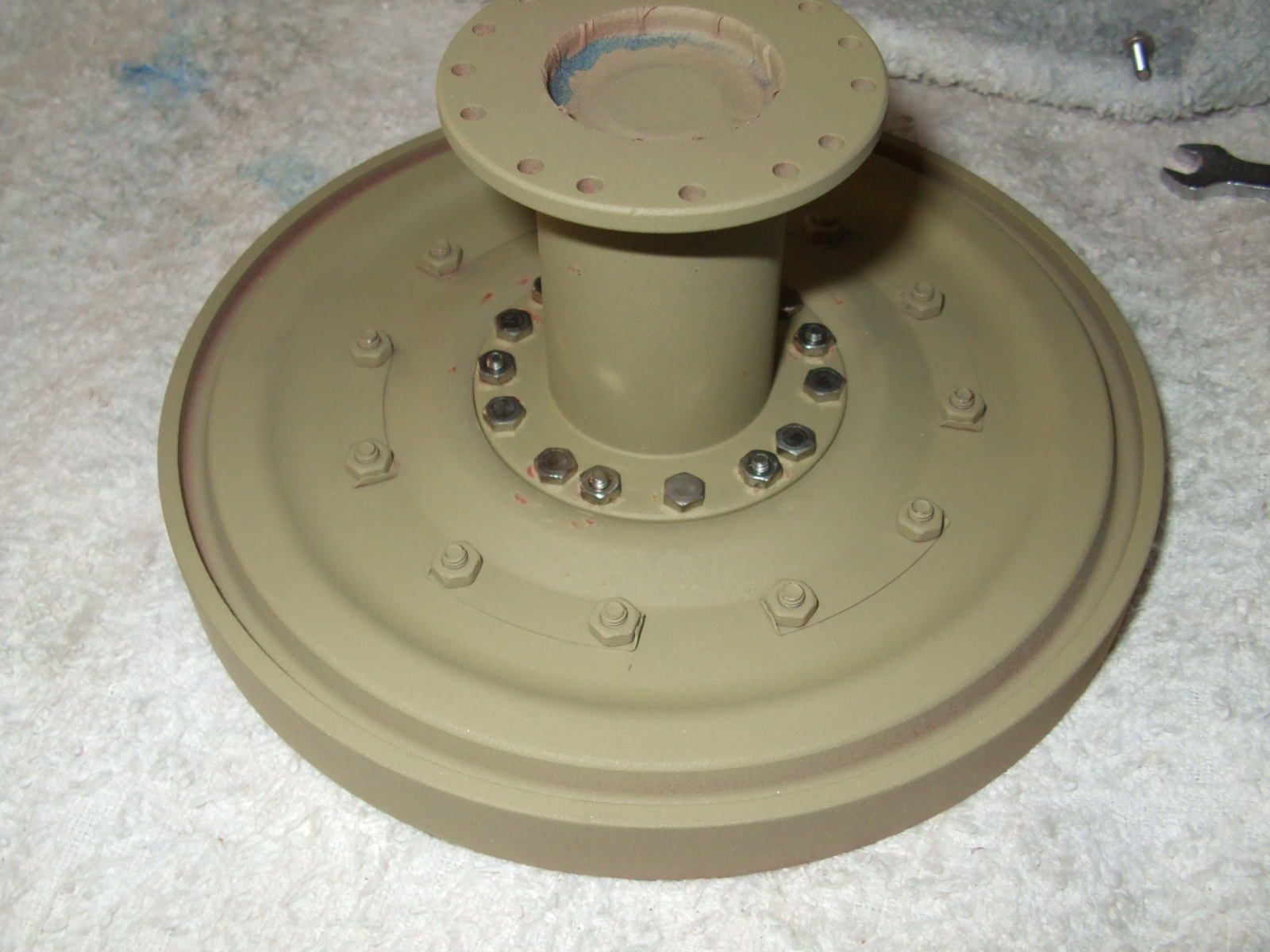

Started the slow process of assembling and final painting of the road wheels.
The inner faces of the above road wheel were pre-painted prior to assembly. All that remains for this road wheel is painting the outer faces.
For this road wheel I will first paint the fixing hardware before fitting the other wheel. The inner faces have already been pre-painted.
Has liked: 794 times

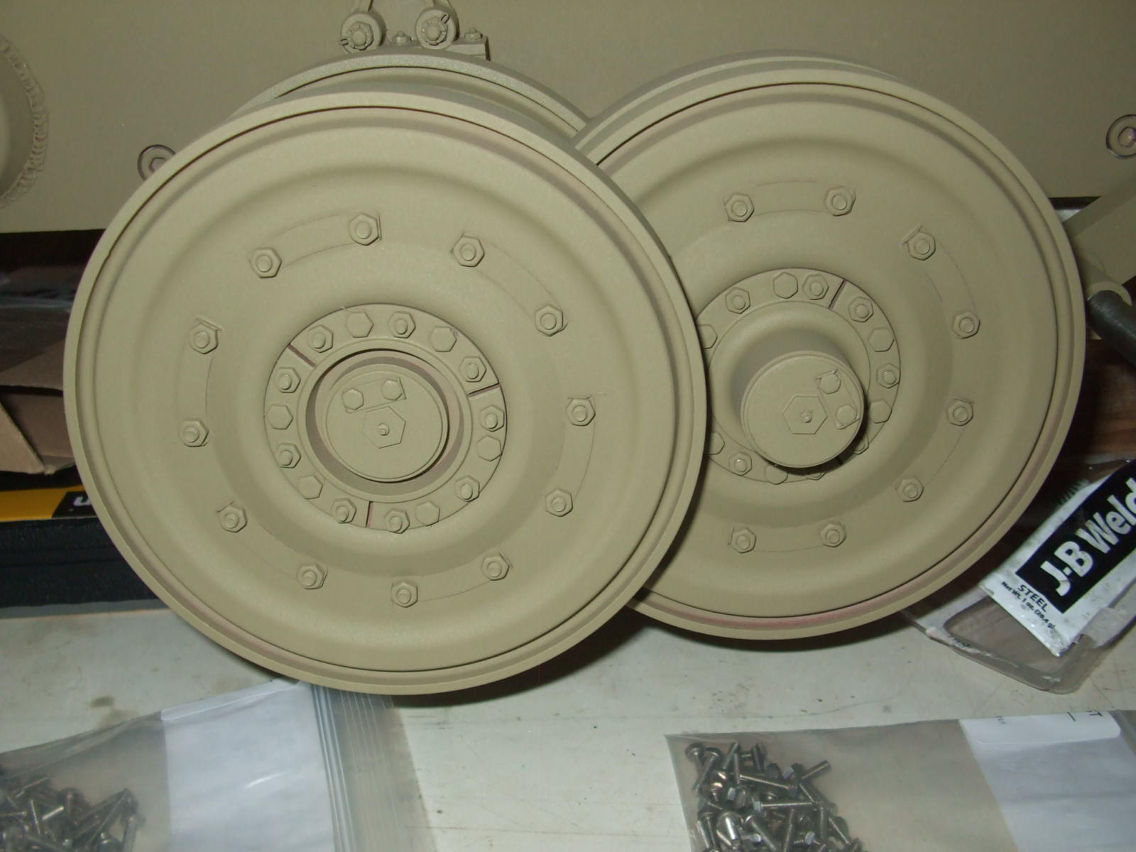

Still working on the wheels but I have managed to get two of them fully finished. Just out of curiosity I checked to see how they look on the swing arms.
Nice
Nice

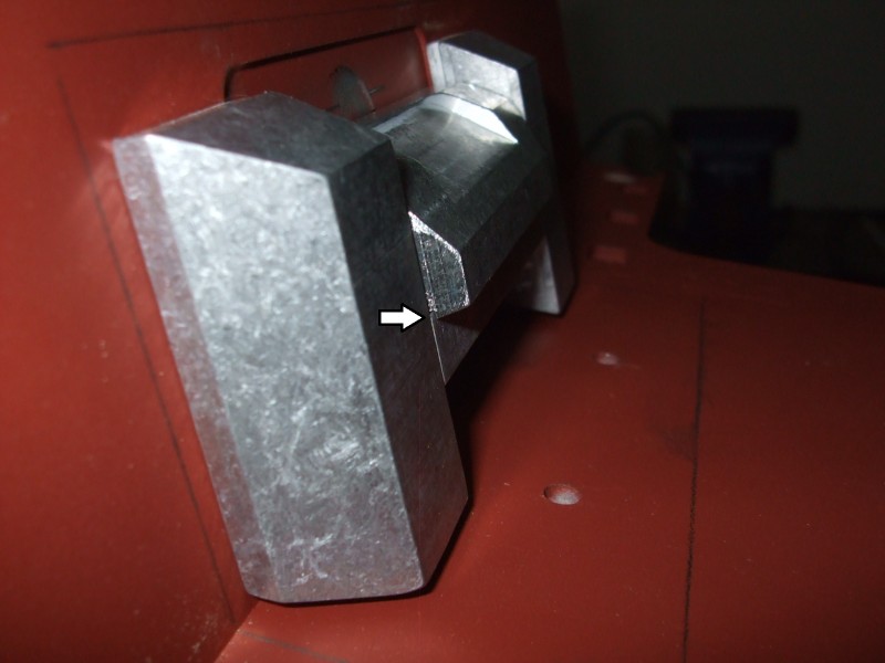

It wasn't hard to slip them on the axles. Let's see when I have another two finished if it becomes more difficult. I have also started doing some modifications to the visor armour. Noticed in photos that the top sliding armour (CE0126) has got an undercut or lip at the front (not sure of the proper English word for it). So I milled some material off to create this lip.
With the armour in the closed (down) position, the lip overlaps the bottom part of the armour.

Finished another two sets of road wheel assemblies and tried putting them on. It's fiddly but doable. Most probably when I come to the stage of final fitting of the road wheel assemblies on the axles, I will turn the tank upside down as it will be easier to fit the wheels.
Also noticed that when I put a couple of tracks on the aft road wheel, the tracks were interfering with the lower bolts of the bump stop. Put a wood block under the wheel so that it will take the weight of the tank (and the road wheel moves up) and the tracks just miss the lower bolts of the bump stop. Most probably I will re-adjust all the swing arms to 30 degrees from the current 33 degrees to increase the clearance.

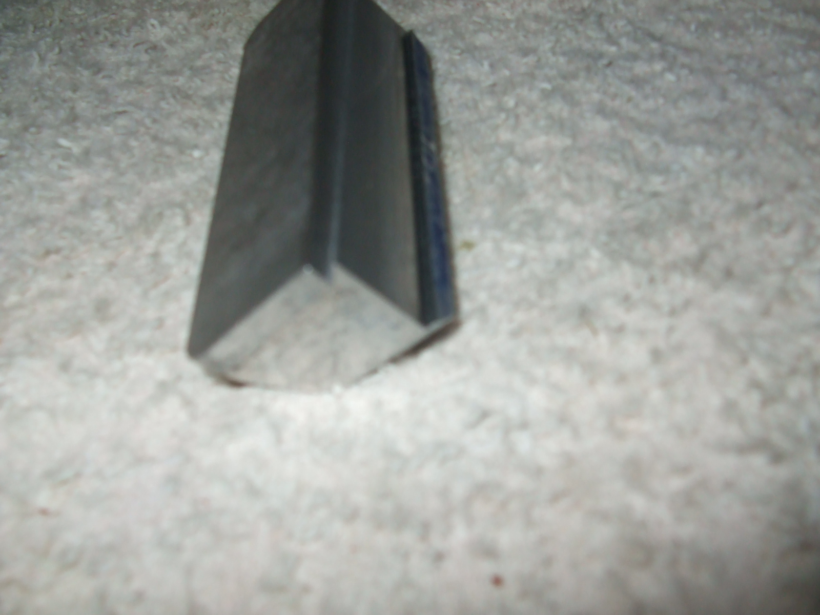

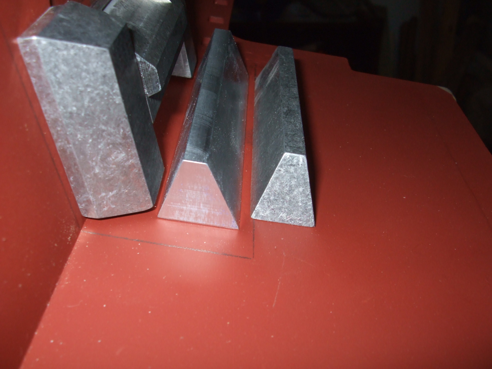

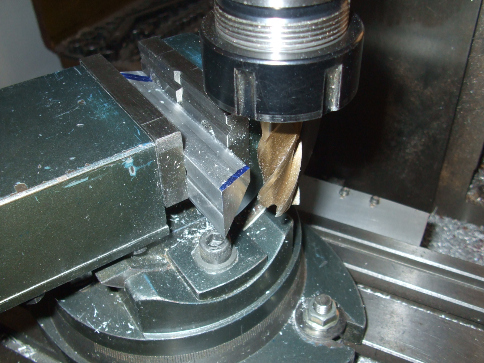

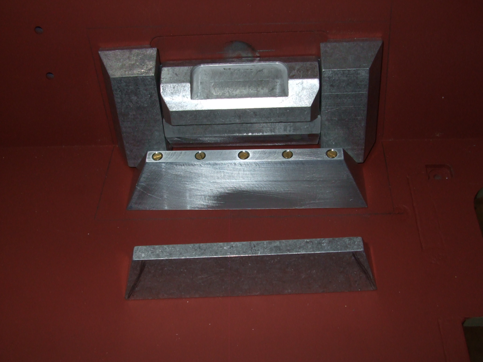

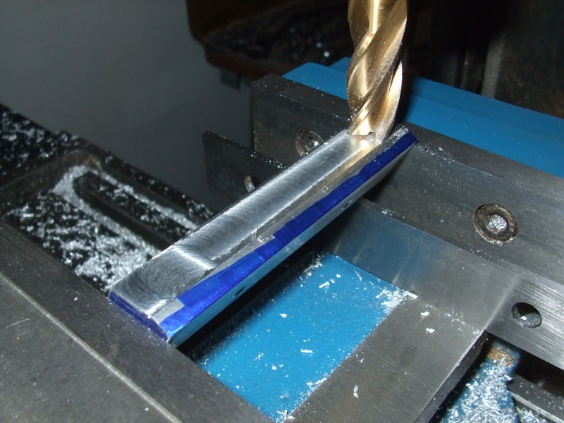

After finishing half of the road wheel assemblies I decided to take a break and do another modification on the driver's visor armour, namely Visor Armour D (CE0129). I wanted to put in the five fake mounting screws on this part but suddenly decided to remake the part from scratch. Nothing wrong with the original kit part but the new part should have a more true to life profile.
Milling the front and rear faces
On the right is the original kit part
Milling the side faces
Adding the fake mounting screws
Finished part
Finished part

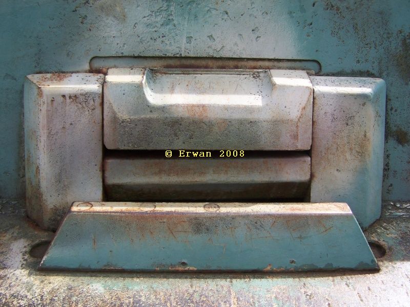

Just a reminder...there was no slots in the 5 bolts, just a flat top.
http://tiger1.info/EN/Drivers-vision-port.html
Kind regards
Kent
It´s all in the details!
Thanks Kent. I did not know that. I thought they were slotted head screws. I guess some Milliput will fix that.

hi Vince,
In response to your question about the road wheel inner face - I made mine the same as the outer facing wheel. That is with a brass tab between the two bolts and nuts on the bolt end instead of the hex head facing the hull. I assume the inner wheel face and outer wheel face would be the same. I had to make some extra brass tabs as there are not enough supplied in the kit. I could be incorrect in this assumption however. Perhaps Kent or someone more knowledgeable can respond.
Bob, I was planning on doing them just as you described but then I came across a period drawing in the Culver and Feist book (which I showed in a previous post) which made me change my mind. The photos I came across are not very clear so I am still not sure which is the proper way.
