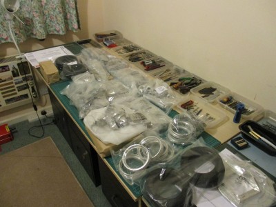

I intended to wait until today before opening the box...no chance, So, last night at half time during the Burnley v Chelsea football match, a quick dash into the garage, and hay presto.
I like the information pack, well thought out and presented, someone has given the instruction book some very careful consideration, I like it.
There are loads of parts to sort, for a smaller model. All well packed and labelled as we have come to expect. All in all a cracking kit, well done.
Information, parts list, and building instructions
Packages galore
Packages galore

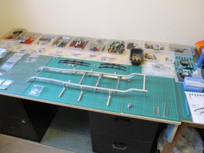

Three glorious days weather wise.....I am supposed to be gardening, Could not resist making a start. I even browsed through the instruction book at 3am this morning, while making a cup of tea....trouble sleeping, never mind I have had my share over the years...Mick
Springs taped
Springs taped

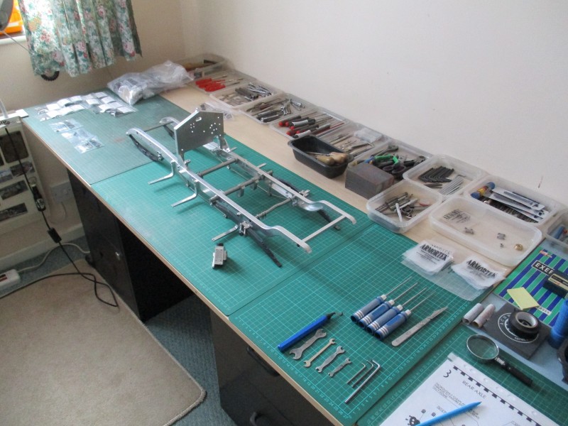

Good afternoon each, this morning and with a cold wind outside, no gardening,.... I made a dry fit of parts related to the basic chassis. The parts list is easy to follow and matched to the bagged parts. The diagrams are also clear and easy to follow, take care to pre-fit the parts listed on page 3 or some dismantling will be necessary in order to fit these parts later. I will post the build as I progress....Mick
