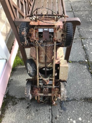

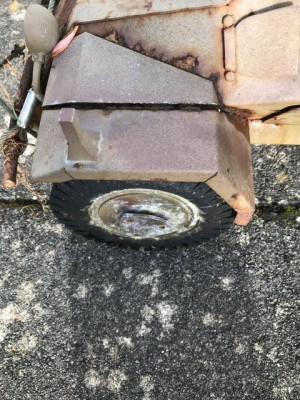

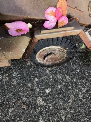

Hi all
Do you think this is recoverable!!!
And how,are spares are available.
Regards Andy Q
Regards Andy Q

Wow, that's nearly as bad as my prototype Sherman purchase
It's amazing how much can be cleaned off, but you'll need to speak to Monique about the spares situation, as the 222 production dates from July 2006 and there hasn't been a rerun since.

strip it down and blast everything, no doubt its rebuildable, have you any more pictures of the bodywork it will be interesting to see what its like.

The 222 is one of the kits I'd love to build.
I bet that is restorable.... May take some TLC and some fabrication. But, hey, restoring old kits now seems worthy, since all the Armortek kits are so iconic.
Bring it back to life and please post lots of pictures as you do! Great project!
RPR

interesting find, whats the story behind the 222, never seen one that bad, regards simon manning.
