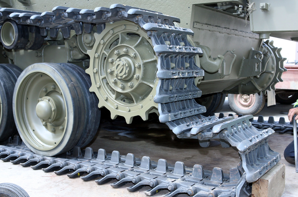

Pic below is of a new set of Centurion tracks being fitted to a museum tank in Australia.

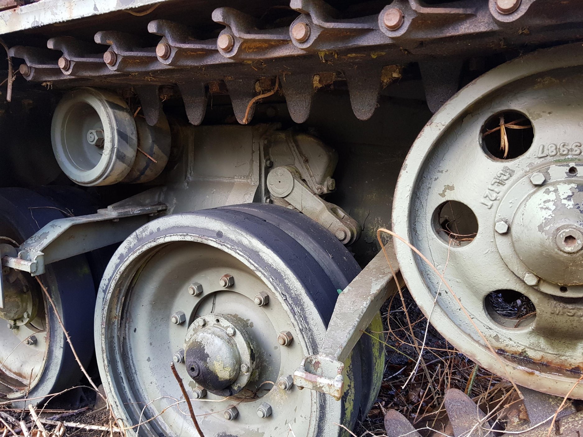

This is a picture posted today of a Chieftain being rescued after several years lying derelict in a field. There is no visible rust on the links themselves. The track pins and circlips are rusty where they’re exposed but they’re both steel. Painting “rust”on model tracks is like putting a beard on the Mona Lisa, amusing but utterly inappropriate. If I was on Facebook, I’d add “just sayin” but I’m not.

I'm afraid I have to disagree and say that those links look rusted and pitted to me...
I'm surprised at the amount of overspray on the tyres and return rollers, but not on the tracks, so it looks as though it was painted with the tracks off.

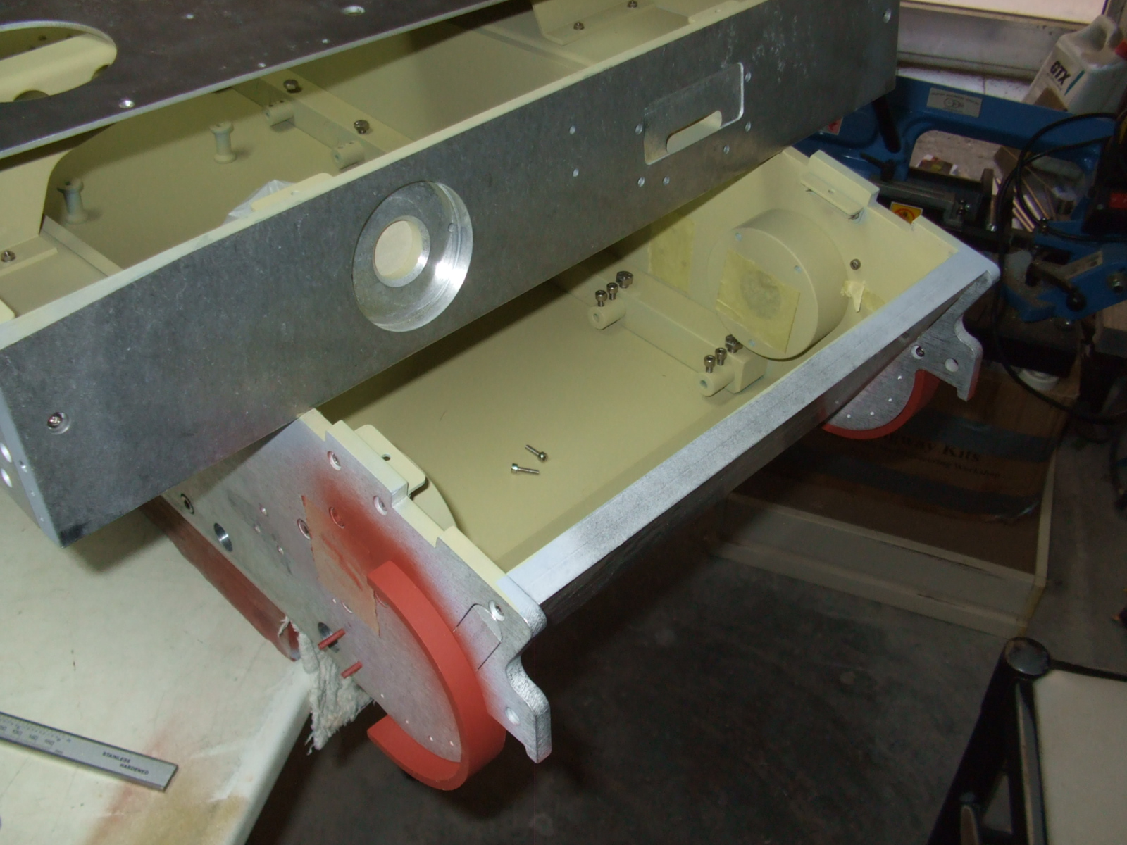

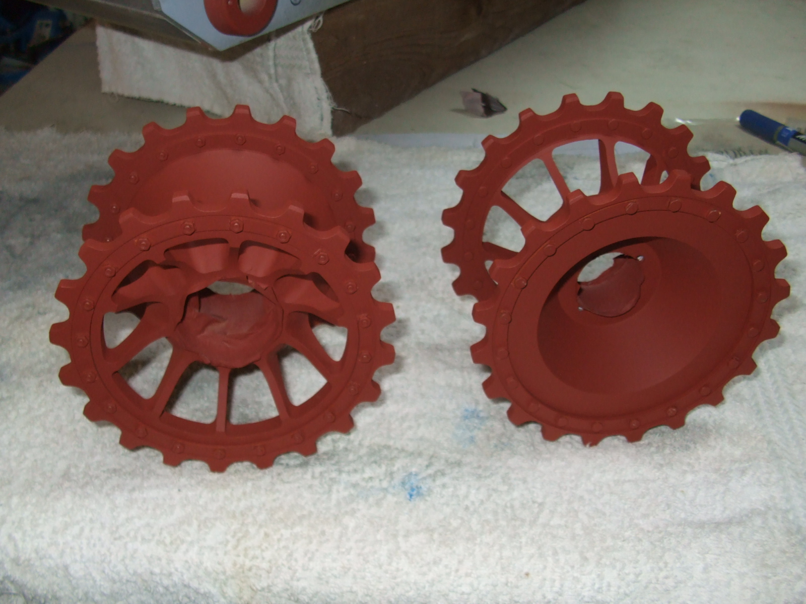

Sprocket assemblies have been finished.

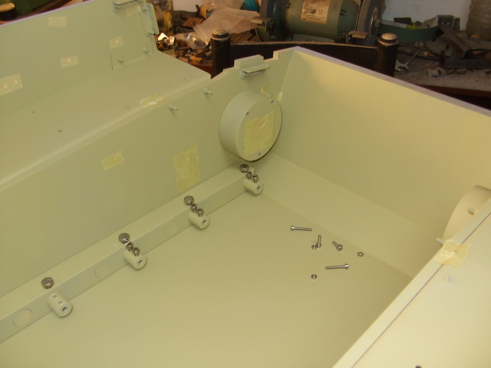

Fitted the electric motor mounts, idler bearings and also the drive gearbox casing armour.
When fitting the casing armour noticed that one of the bolts specified was a bit too long so used a 12mm one instead of 16mm. Fitted the front bulkhead, the glacis plate and upper front panel. Used the hull roof to get and check for proper alignment.
Starting to look like a tank now.

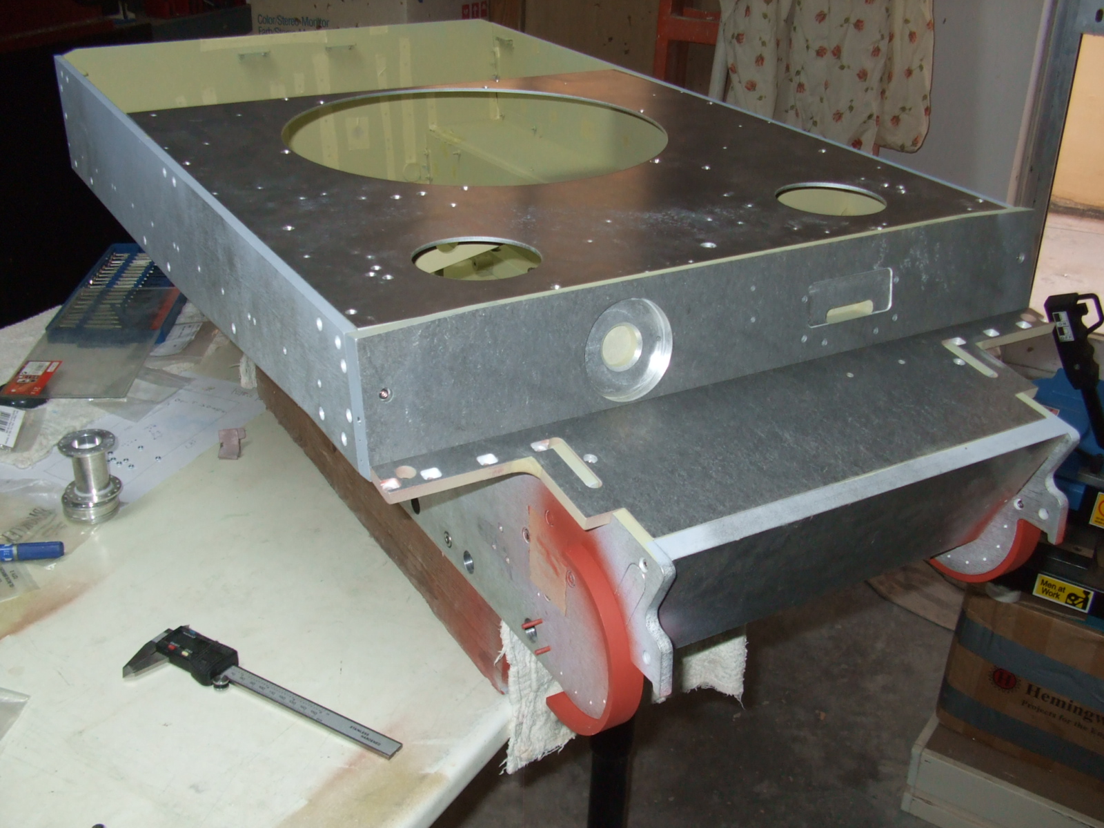

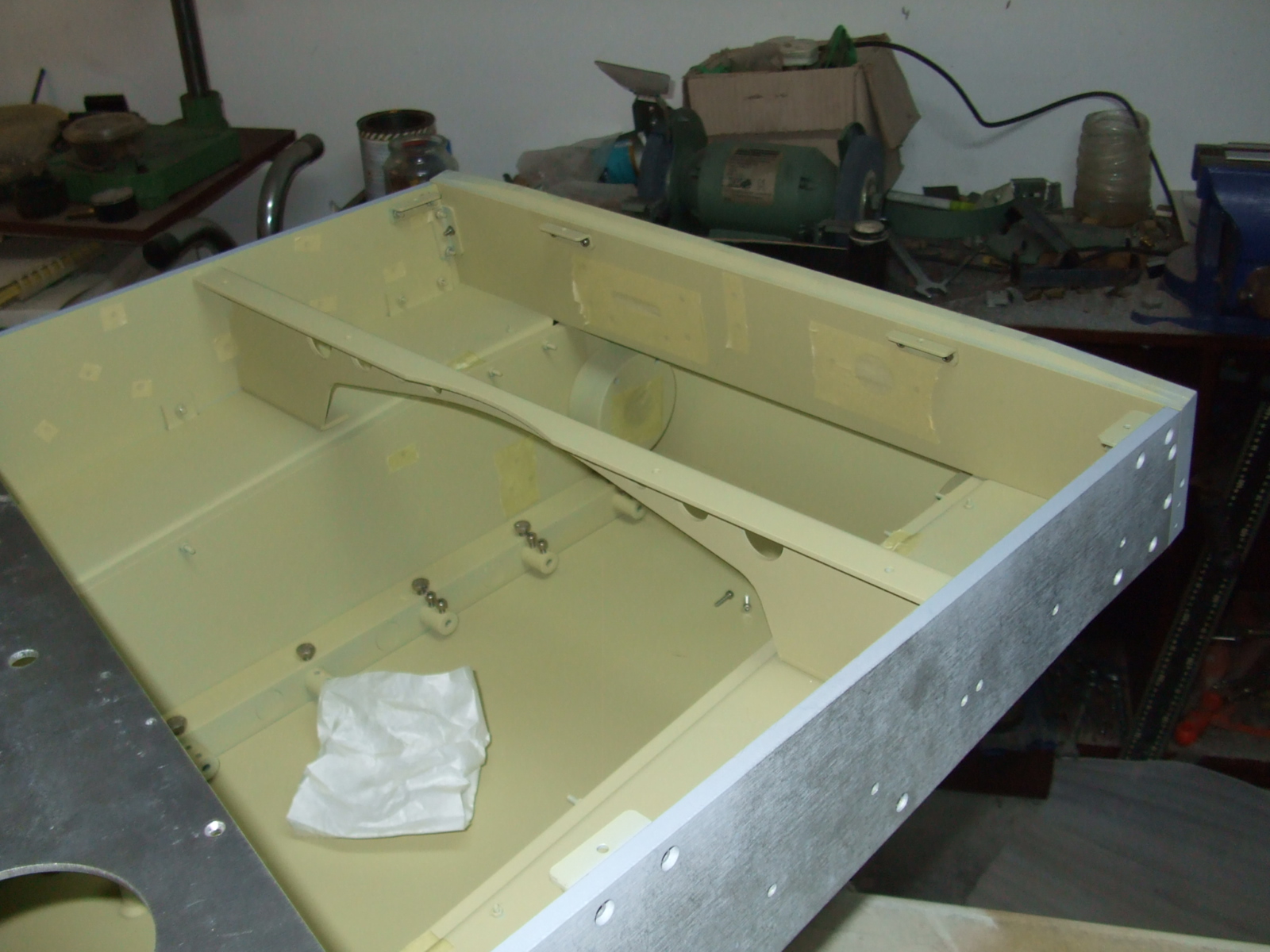

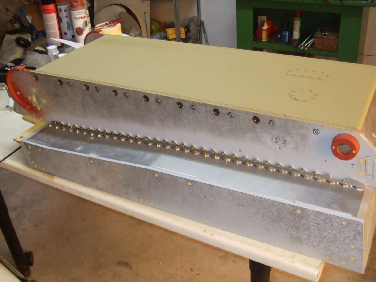

Finally managed to finish the clean up of all the road wheels.
Also, turned the model over to start plugging holes and applying weld seams. Started with the easy part of plugging the counter bored holes with milliput.
Haven't fixed the track deflectors yet. As there are many weld seams in that area I thought I would bolt them on after the welds are finished. I also took a decision of not making any weld seams in areas that will be eventually covered in zimm. Hope it was a good decision!

Good thinking Vince, then you will need to add weld to the track pin bumpers also, nice work, regards Phil.
- Has liked: 790 times
That's the plan Phil. Do all the weld seams and than fix the track deflector and add the weld seams to that also.

Hi Vince,
Regarding the track pin deflector plate. When the Germans switched from the 700mm diameter idler to the later 600mm diameter, the deflector plate changed position. I think you already picked up on this, but the wheels changed some time before they got around to repositioning the plate. So nows the time to choose which individual Tiger, unless of course you’re not bothered, after all it should be fun above all else.

Thanks Simon for that piece of info. I always assumed that the position of the track deflector was changed when the small idler was introduced.

The whole idea of the track pin bumper is it does just that, and it is totally functional if it's in the wrong place it just won't work, if you lose a pin collar and the pin drifts the only way it can ie towards the hull it will cause damage, and it does happen, it bends the pin and scratches the hell out of the hull
that's not fun , regards Phil.

Meant in the nicest possible way, maybe this’ll be of interest?

Great stuff Simon. I'm in luck then. Armortek said this is a June 1944 model. Good thing I angled downwards the track deflector.
