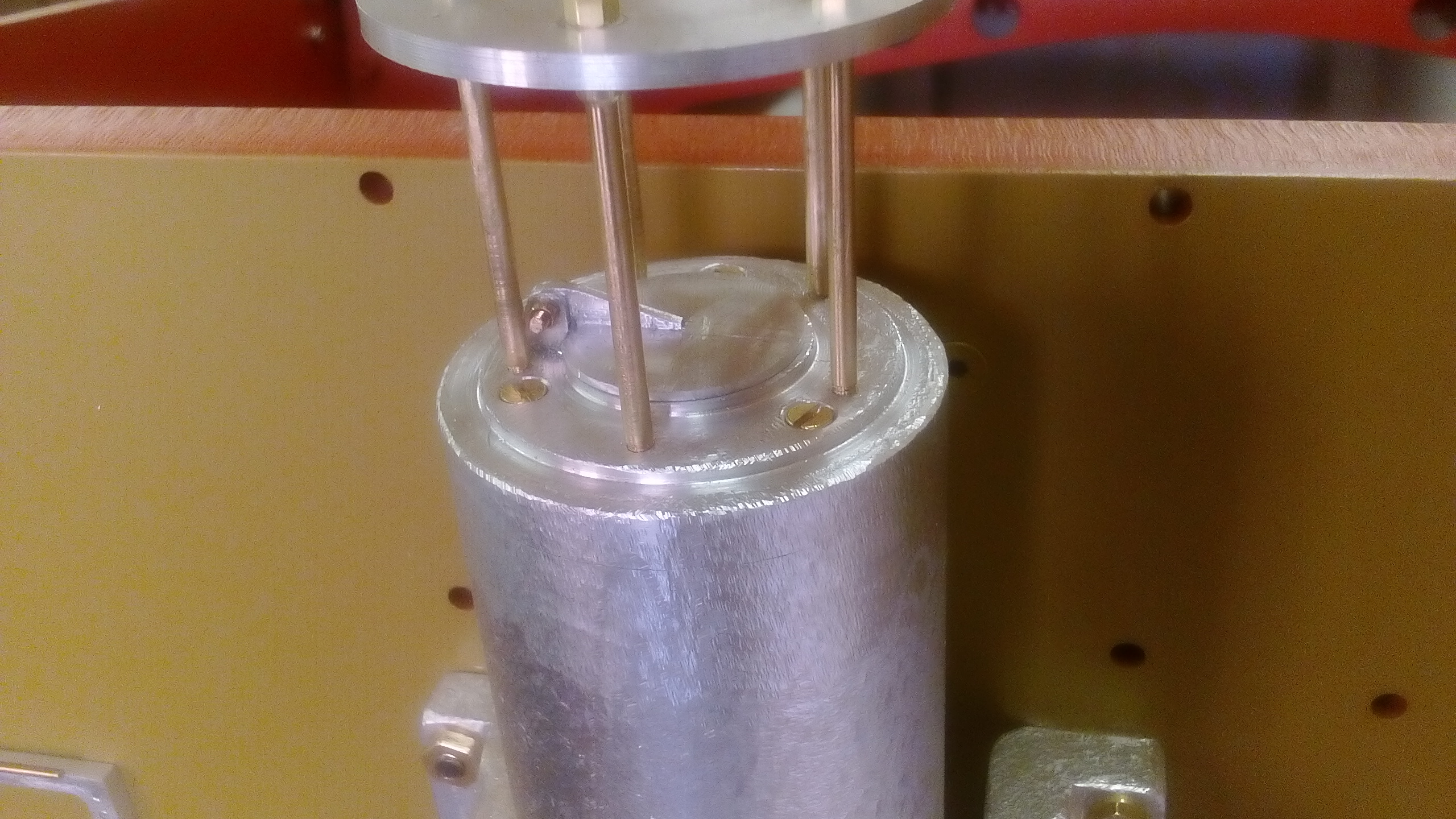

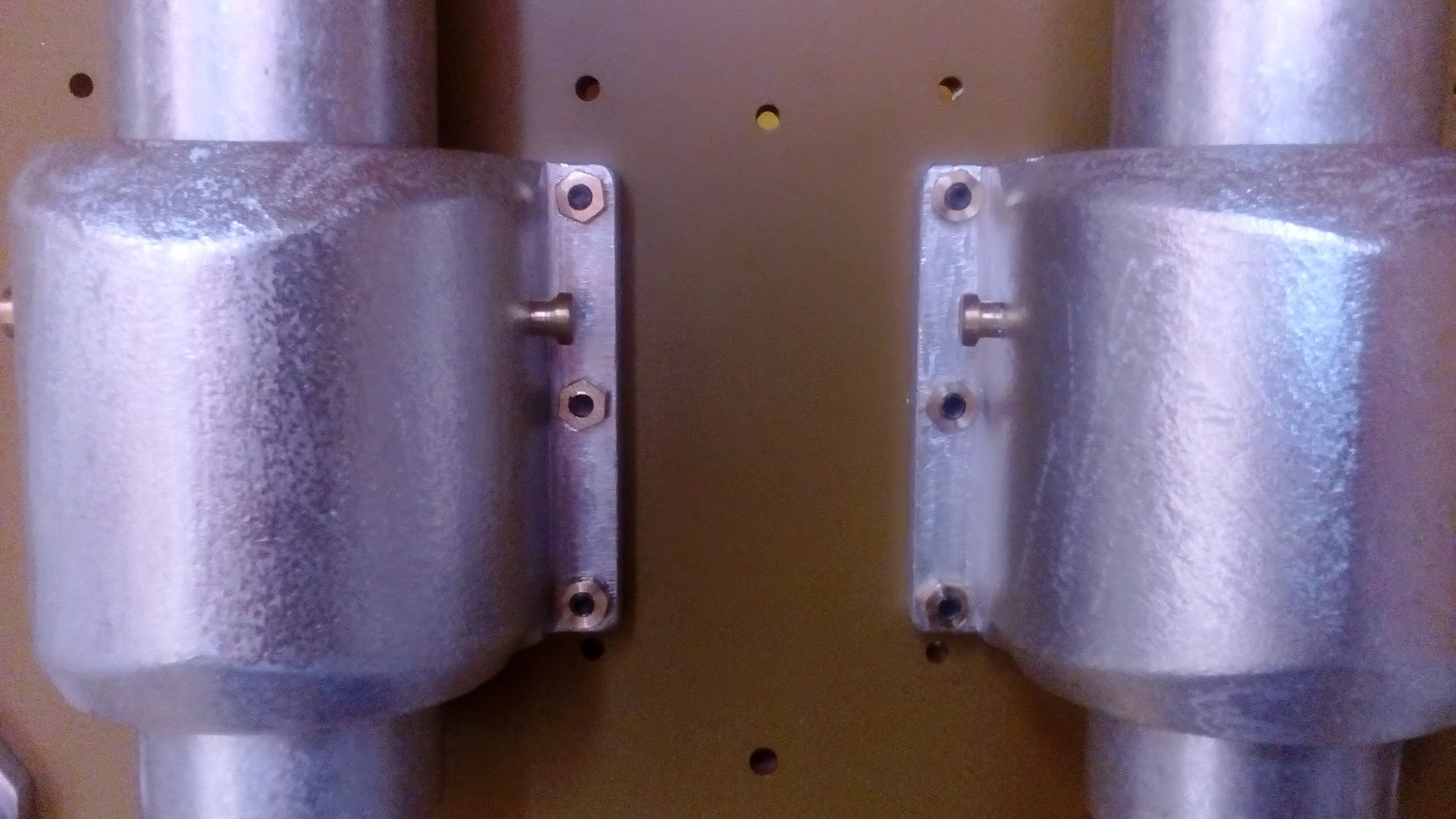

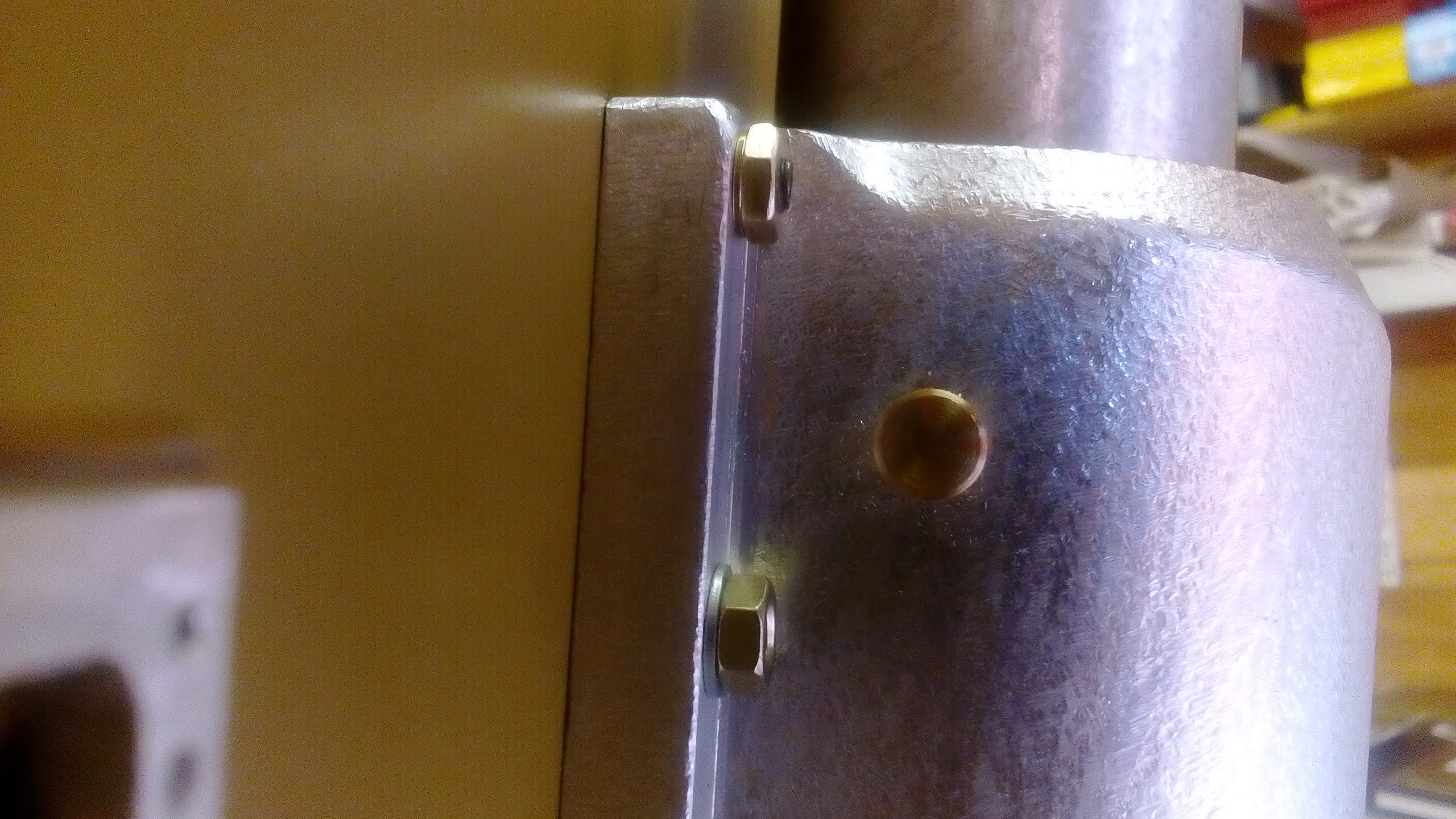

I have started to work on the rear of the model and have had to make a few compromises on the armoured shield that fits around exhaust, I had forgotten to machine out the new hole location for the corner holes where of the armoured shield that fits around the exhaust I was going to use M5 bolts and make some nuts out of some M8 hex bar to give the right scale size nut/bolt. The main compromise is now to use M4 bolts and make some thin M7 nuts instead.

Nice work David, those exhaust outlets look good to me, I have to manufacture two sets some time soon and if mine look anything like yours then I will be happy. Are you going to machine the exhaust mounts and mount holes in the rear plate true to the original? If you decide to take photos or make a diorama of the exhausts removed it sure does look good ,but it does require making new flanges and machining square bottom holes in the rear plate to except those exhaust mounts.

Thanks for the kind words. I will probably leave the exhaust mounts as they are but I do intend to bash and put a few holes in the thin skin shield around the exhaust.

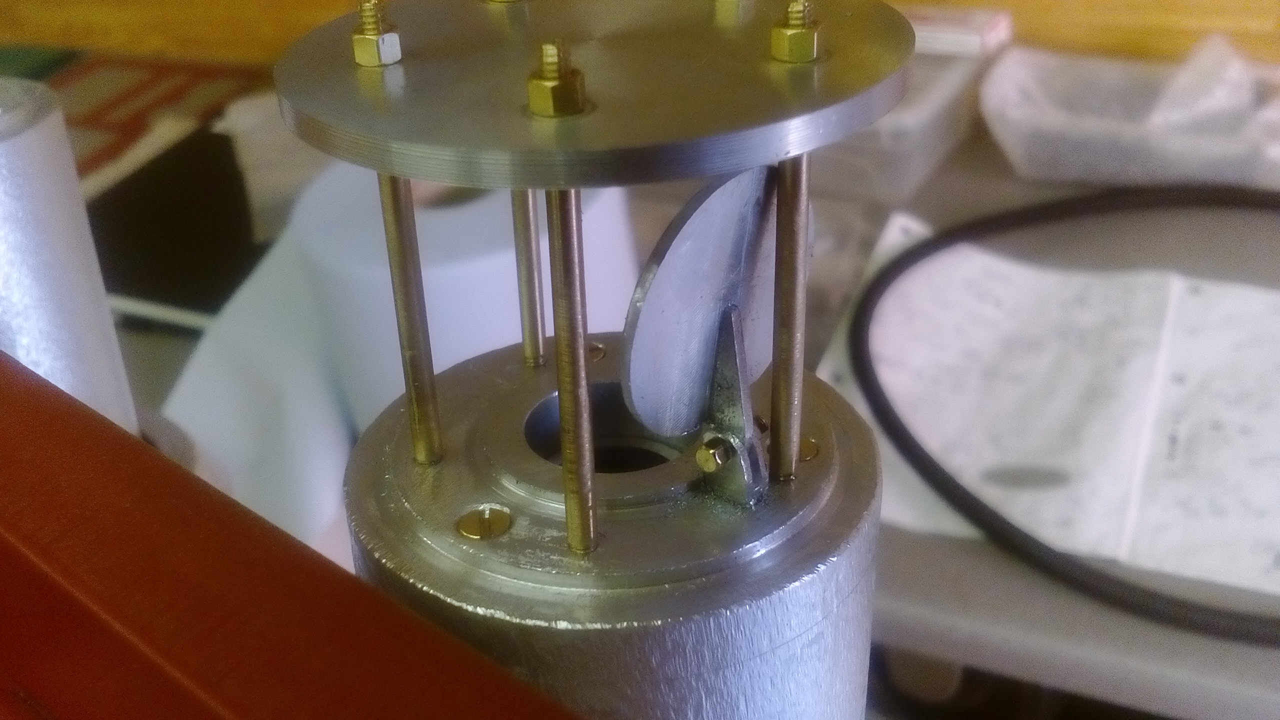

Thanks for the kind words always appreciated. Making my own parts for these kits is what I get the most enjoyment out of when building a armortek tank, and for me offers very good value for the money when each model takes 3 to 4 years to build.
I have just fitted the exhaust caps and I hope to try and get these to work when I fit the smoke module.

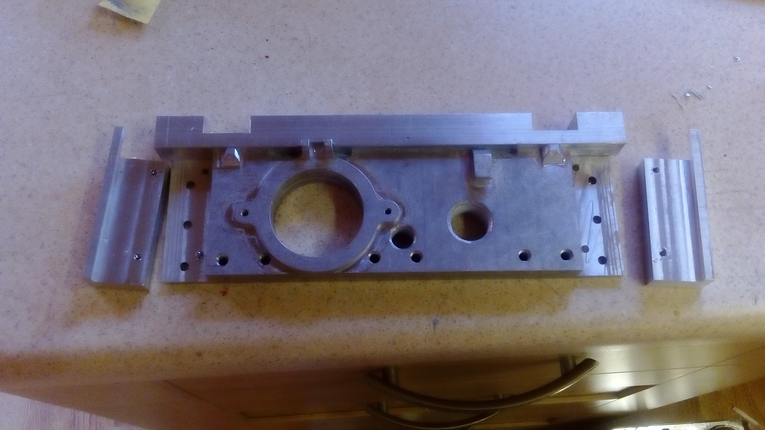

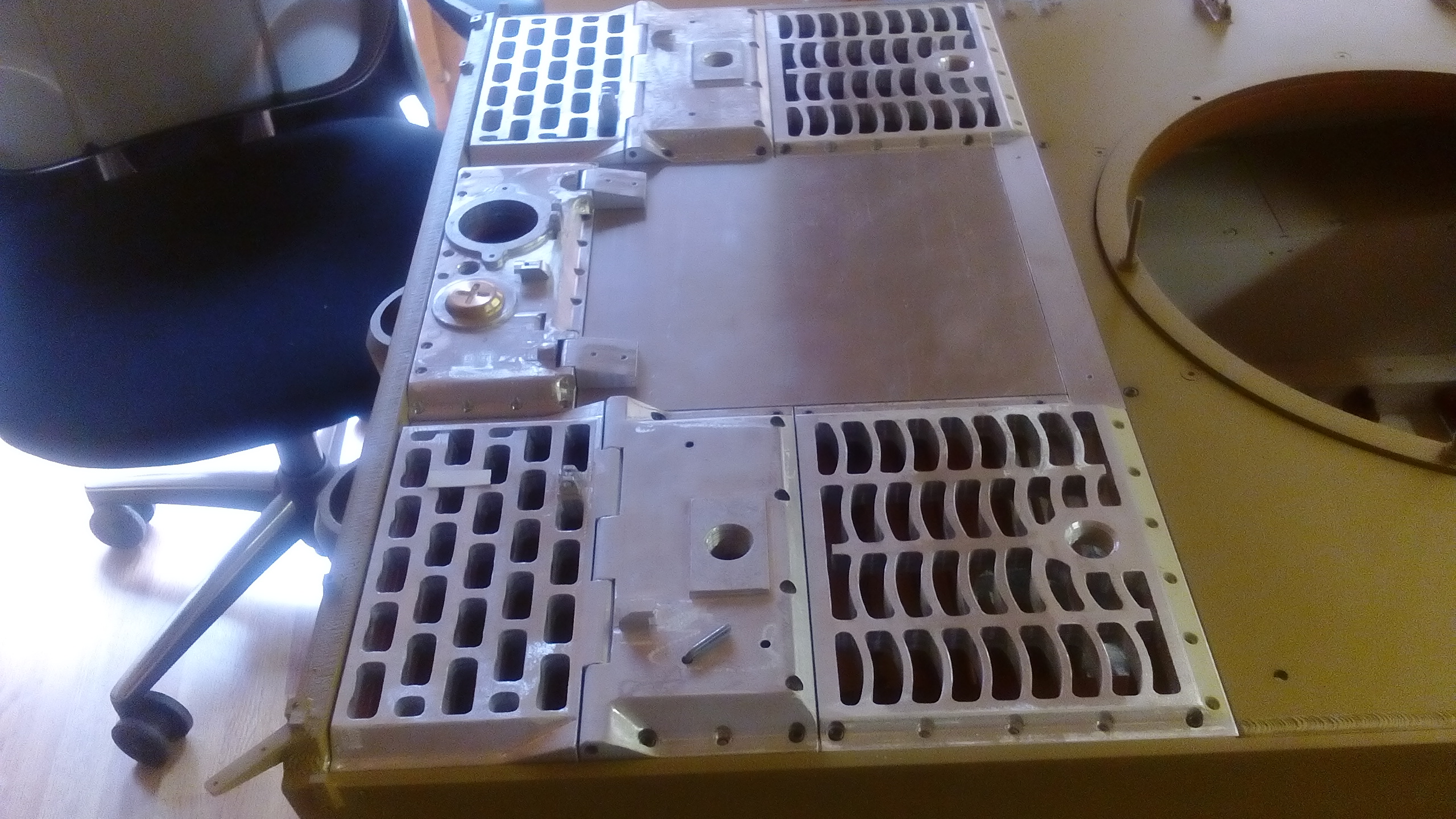

After looking at a large amount of photos and taking some measurements from the tiger tank info website and a bit of guess work I decided to move all of the rear hatches side ways by 4mm. This was to prove a real challenge as it meant cutting a 2mm by 3mm rebate in the side plates. To do this cut I bolted the rear hull plate into position then clamped some thick Aluminium plate onto it and use this as a guide.
Then came the hard part using a hand held router but to be fair it done a good job and having it set at 20000rpm there was no kick back.
Now I need to start looking at the two centre hatches as these will now need to be made wider.

Using David Bryden website as starting point for making the engine hatch I now made all of the rear deck plates and hatches and fitted into place. I still have a lot of detail to add particularly with the fitting of the feifel filters this is where I have only just realised that with these filters fitted you lose all access to rear end of the model.

Hi David, the engine bay is coming along nicely and I am well jealous of those engine hatch locks

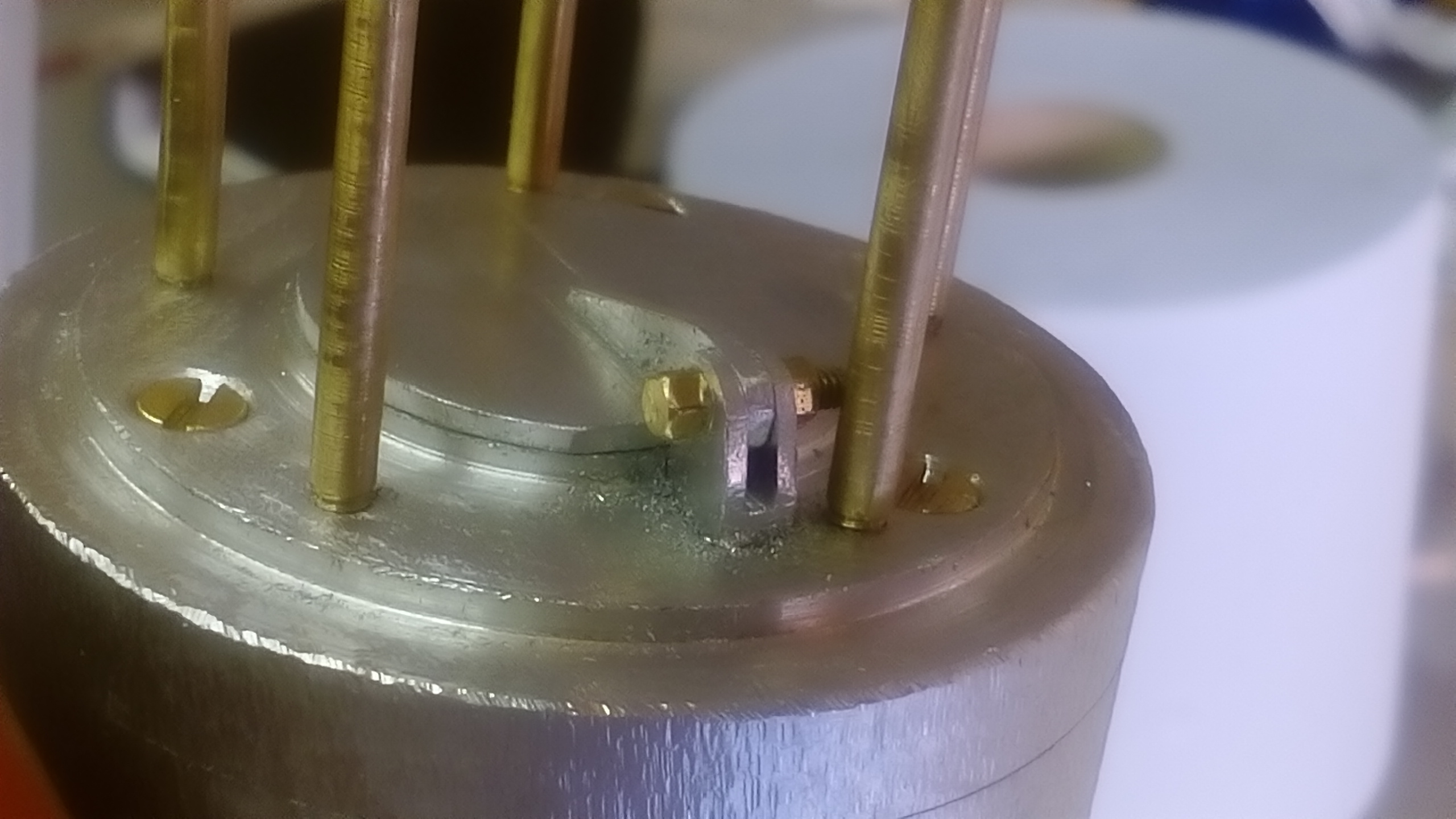

Re: Tiger 131 In South Wales
Hi Paul, Chris,
Thanks for your encouraging words always appreciated. As regards my square drill bit I milled a 3mm hole 1.75mm deep and then used a 1mm milling bit to square out the hole to 3.3mm square.
