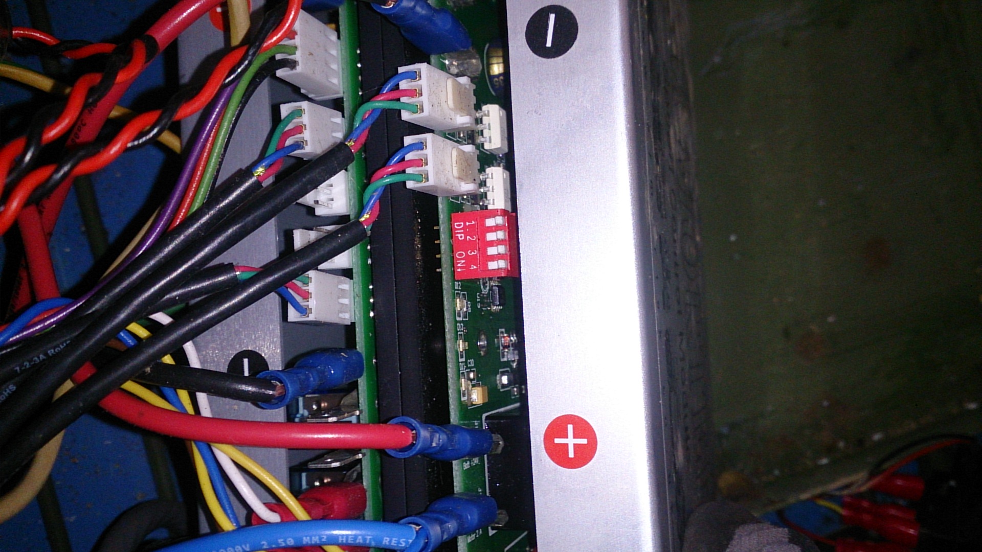

Can you post a couple of pictures of the motion control unit with the top off - especially of the dip switch settings.
thanks,
Kian
thanks,
Kian

Hello Karsten
Having read your reports here, and seen the responses in which everyone has tried to help, I can add one
thing only. Your model is showing all the classic symptoms of flat batteries. I know they are new, but I strongly
suggest that this is the cause of the problem. Remember a fully charged pair of batteries should read
between 28 and 30 volts off load. If they are reading 24 volts off load, they are not charged and your tank will
behave as described. What type of battery charger are you using?
Re: Tiger Late
And if possible, check the voltage of each battery individually, rather than as a pair, to check they have roughly equal voltages, especially if they are charged at 24v.
If they are charged together at 24V but have different internal resistances, they will charge to different peak voltages.
