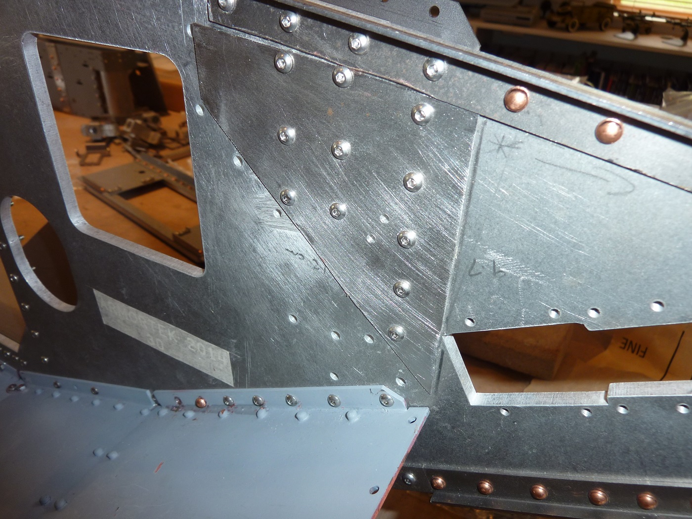

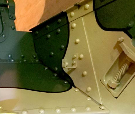

Going back to the six extra rivets you added to the front horns...
On the Bovington and Ashford tanks, there appears to be an additional extra plate between the cab and the vertical row of rivets on the kit. It looks to be the same on Lodestar III but I haven't found any hi-res images yet.
On Flirt II, there is just a plate under the six extra rivets.
Is this just a factory deviance do you think, or an upgrade ?
Also, on Lodestar III, the rear cover plates which have the additional part for a bow shackle are the same on the inside and outside of the horns. This is the same in the Fletcher Osprey book in the image of Mark IVs under construction. Other tanks seem to have the ones on the insides of the horns on the idler cover plate. This would make sense as it would prevent the cables from rubbing on the beam rails.
However, if all four shackle points were in use, it's likely that the cables would all be the same length, so it would make sense for the shackle points to all be at the same location.

Adrian, I fitted the extra plates on the bow, with extra rivets as well. There is also the issue of the headlight brackets....
Have fun! Steve

I took the various inspirations from the great builds here in the forum and choose this solution for the headlight brackets.
Oliver

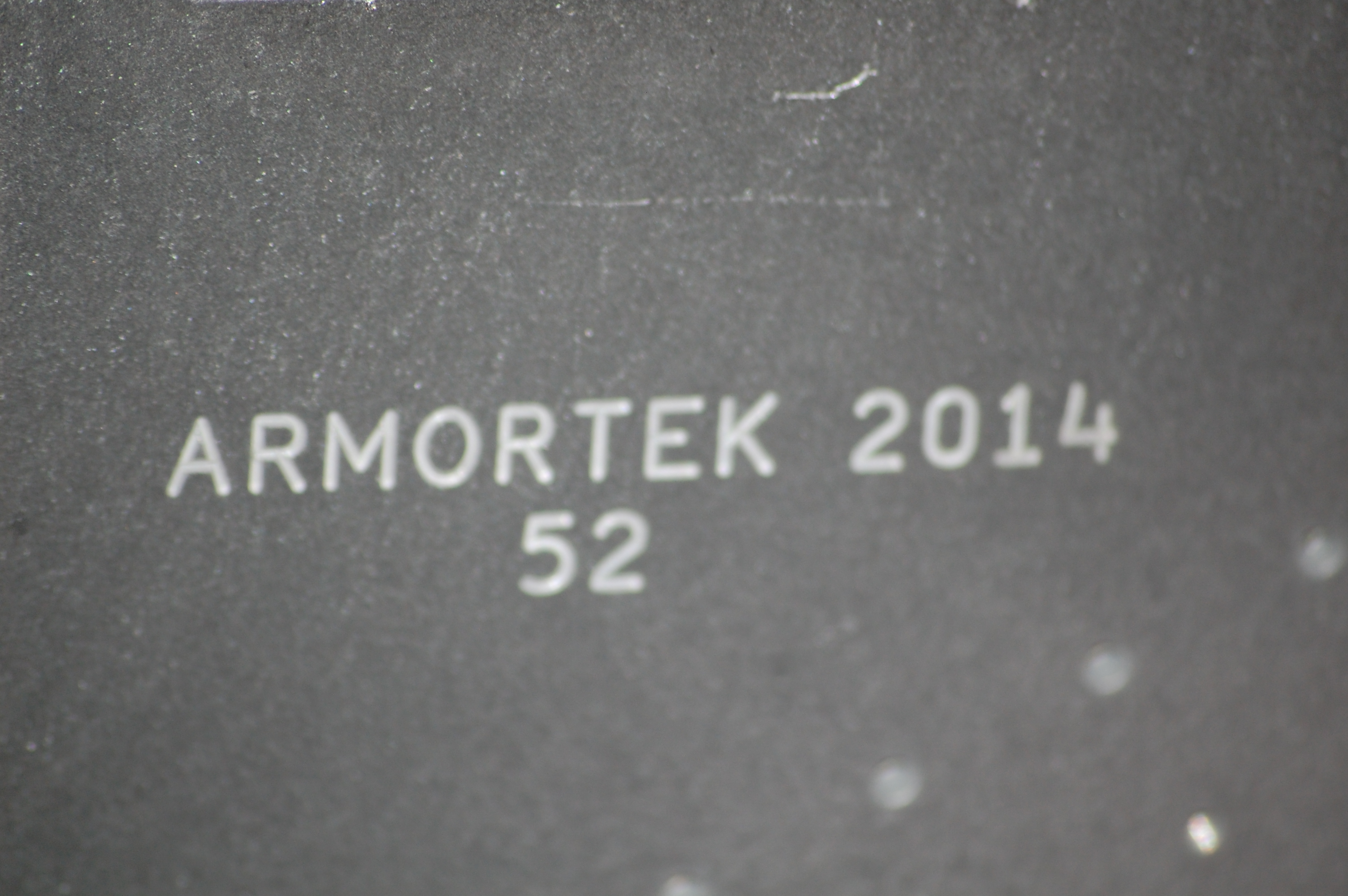

I bought the tank from Simon who lives in Totton, Hants. It was advertised on the Forum and I took it at face value. He told me that he purchased it, with other Armortek tanks, from a guy who was giving up/Or had died - can't remember which now. (its an age thing). He had a good selection of Armortek tanks in display cases.
The Mk.IV was not boxed in original Armortek Boxes but cardboard fruit boxes. I didn't do a full inventory check but what was there was in 'sealed' and marked bags.
When I got home I looked through the instruction but found no Certificate. Now I know why. I will do a full inventory check soon and hope that it is all there.
A side plate is clearly marked ARMORTEK 2014 52

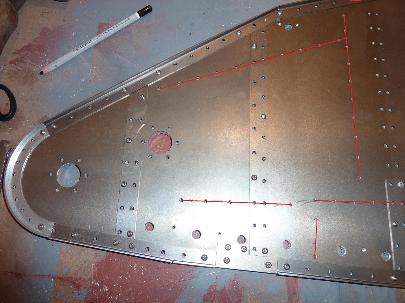

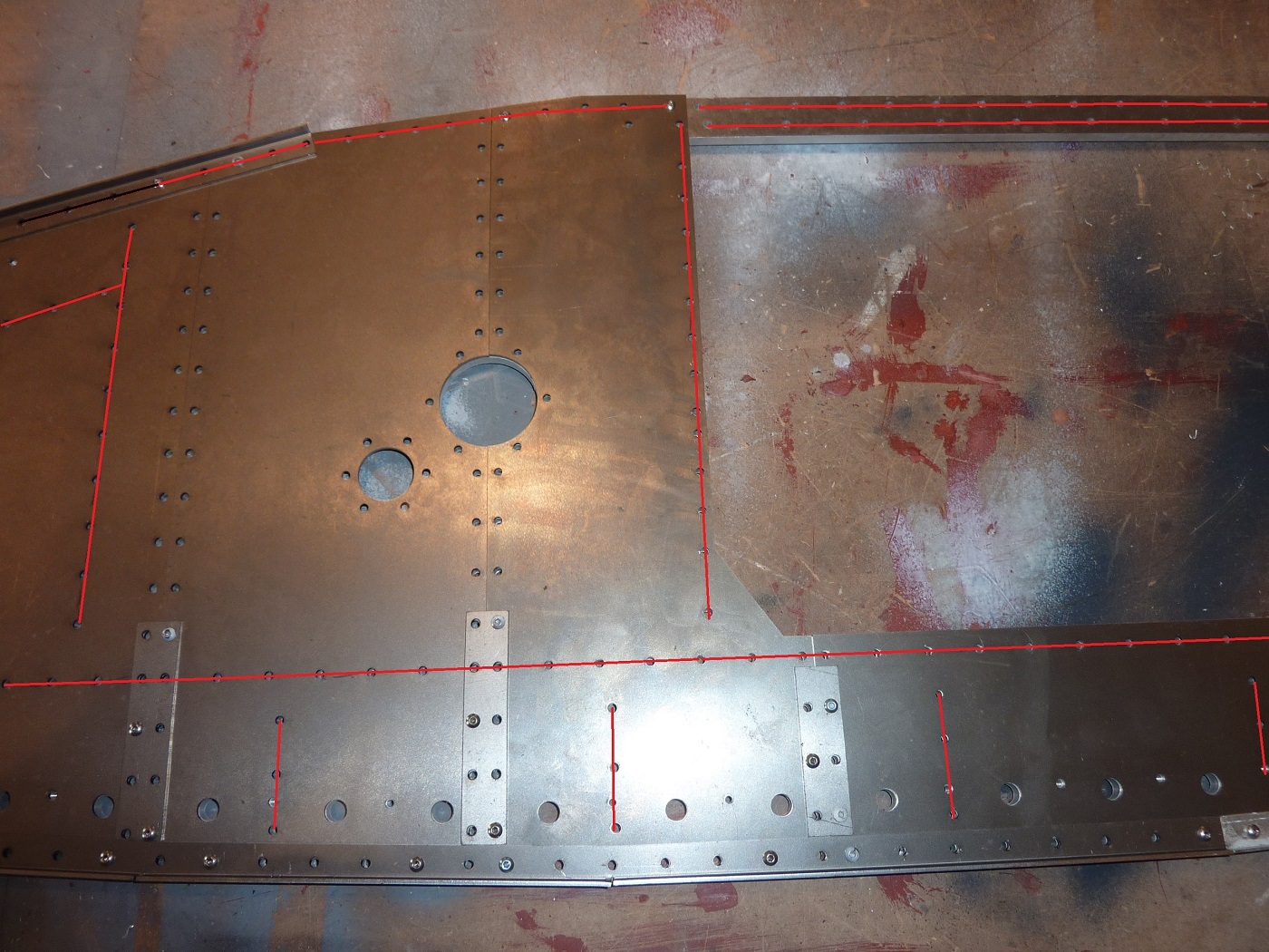

Build time: 50.5 hours
Elapsed time: Almost 18 months ! Is it always like this when you've already got one to play with ? I'm having so much fun driving and tinkering with Liesel and the Panther (name to be revealed soon ) that I've somewhat neglected poor old Flaming Fire II. But, coming home all enthused from Tiger Day, and with the Cambrai centenary looming, it's time to crack on. And, actually, I'm quite surprised at how far I've actually gone .....

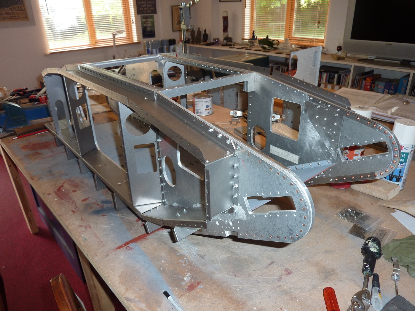

Firstly, she does at least exist in 3 dimensions, with all the track runs fitted:
Significant alterations from the build instructions are re-angling the rear mud chutes (as I mentioned in the Liesel build) and the fitting of the extra armour inside the front horns. I'm indebted to Oliver and Adrian for pointing this out - another of those things I couldn't see for looking ! But it's a clear feature on all the WW1 rhomboidals, from the Mark I to the Mark IX (so how did I miss it then ? ).

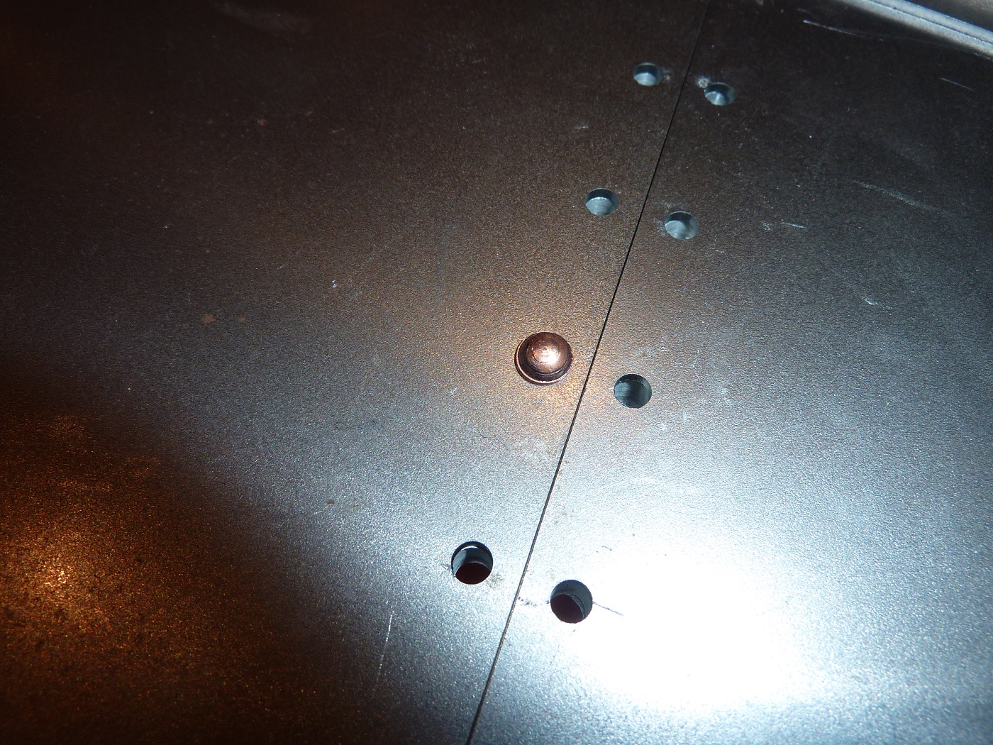

First step is to knock out that rectangular pattern of 6 rivets I told you to put in earlier (sorry about that ). As any marks are covered by the new plates, I knocked off the heads with an angle grinder - then the pins just push through. Then I did a cardboard template to enable me to cut the new plates out of sheet aluminium (much easier to work than steel, for those of us who lack the necessary metallurgical skills). The dimensions are quite odd - this is what I came up with:
(any gaps will be filled with putty before painting)
And the end result looks like this:

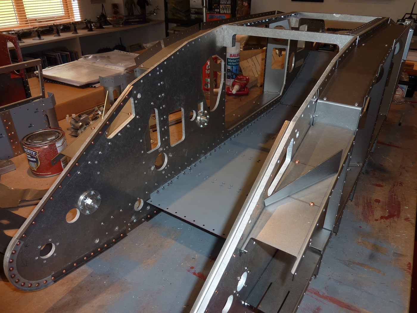

(the two small angled holes are for the headlight bracket, which would seem to be a permanent fixture as well, although the headlight seems to have been removed before action for the Mark IV onwards)
The inner frame assembly now needs the bolt heads filling, and then some serious painting (etch primer, red lead, white internals) before the cab and rear assemblies (which are finished) are bolted in.

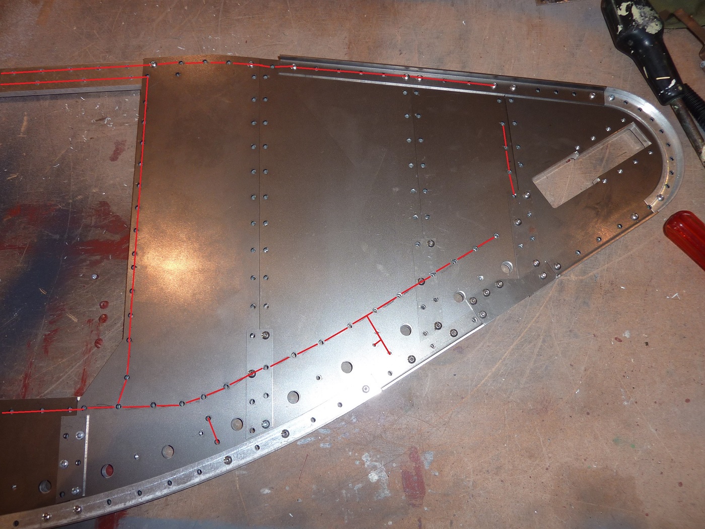

While all that's happening, I need to finish off the outer plates, where all the armour is. During the Liesel build I mentioned a 'bolt line' which (well, duh !) requires bolts rather than rivets (assuming that (a) you like riveting, and (b) you over-engineer it by putting in as few glued rivets as possible). As I never thought I'd be going down this road again, I didn't keep records of where the bolt line is ! So I've had to work it out again, and here it is, marked in red, for posterity (and those of you still staring at a pile of unopened Armortek boxes):
I've assumed it's obvious that you don't do anything (yet) with the holes where the drive covers (EK0324 to 326) go, and the smaller threaded holes near the bottom where the roller angles go (Stages 20 and 21).
So that's the story so far. Serious painting and riveting to be undertaken. Once that's done it's a gentle ride home (he said, quickly) with only the rollers, drive sprockets, tracks, roof panels and sponsons to go ..... and then painting and marking, of course .

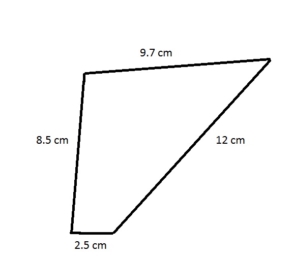

I've just been looking at creating these front armour pieces and unfortunately, it's not possible to create them from just the lengths of the sides.
Is the angle between the 9.7cm and 8.5cm sides 90 degrees ?
