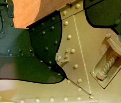

Going back to the six extra rivets you added to the front horns...
On the Bovington and Ashford tanks, there appears to be an additional extra plate between the cab and the vertical row of rivets on the kit. It looks to be the same on Lodestar III but I haven't found any hi-res images yet.
On Flirt II, there is just a plate under the six extra rivets.
Is this just a factory deviance do you think, or an upgrade ?
Also, on Lodestar III, the rear cover plates which have the additional part for a bow shackle are the same on the inside and outside of the horns. This is the same in the Fletcher Osprey book in the image of Mark IVs under construction. Other tanks seem to have the ones on the insides of the horns on the idler cover plate. This would make sense as it would prevent the cables from rubbing on the beam rails.
However, if all four shackle points were in use, it's likely that the cables would all be the same length, so it would make sense for the shackle points to all be at the same location.
Idle thoughts :lol: :lol:

Adrian, I fitted the extra plates on the bow, with extra rivets as well. There is also the issue of the headlight brackets....
Have fun! Steve

Hi Cris,
I took the various inspirations from the great builds here in the forum and choose this solution for the headlight brackets.
Oliver

Significant alterations from the build instructions are re-angling the rear mud chutes (as I mentioned in the Liesel build) and the fitting of the extra armour inside the front horns. I'm indebted to Oliver and Adrian for pointing this out - another of those things I couldn't see for looking ! But it's a clear feature on all the WW1 rhomboidals, from the Mark I to the Mark IX (so how did I miss it then ? :shock:).
First step is to knock out that rectangular pattern of 6 rivets I told you to put in earlier (sorry about that :oops:). As any marks are covered by the new plates, I knocked off the heads with an angle grinder - then the pins just push through. Then I did a cardboard template to enable me to cut the new plates out of sheet aluminium (much easier to work than steel, for those of us who lack the necessary metallurgical skills). The dimensions are quite odd - this is what I came up with:
(any gaps will be filled with putty before painting)
And the end result looks like this:
(the two small angled holes are for the headlight bracket, which would seem to be a permanent fixture as well, although the headlight seems to have been removed before action for the Mark IV onwards)

fitting of the extra armour inside the rear horns
First I've heard of this but looking at your photos that new plate is mounted at the front and will be inside the body? What am I missing?

Oops - good spot, Daniel ! It doesn't matter how often you proof-read something, a mistake always slips through ....
Front horns, of course. Duly corrected. :oops:
The plates are on the outside of the inner face of the front horns (if that makes sense). In front of the cab. My personal theory is that they were a throwback to Marks I and II, when the fuel tanks were in the front horns. I can't see any other reason for them ....

I've just been looking at creating these front armour pieces and unfortunately, it's not possible to create them from just the lengths of the sides.
Is the angle between the 9.7cm and 8.5cm sides 90 degrees ?
