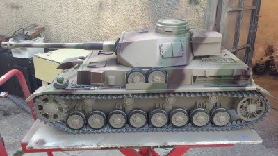

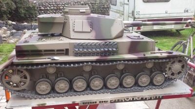

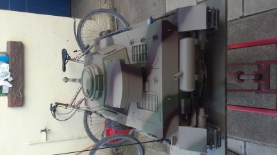

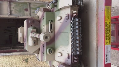

Hi all,
My Panzer IV is now built and painted. Just wants the cross and a few other markings and that side is done, for now. I am waiting for electronic magic boxes to bring it to life. When those are in and working I will have the makings of a battle group.
Here are a few pics to show how far it has come from the rusting and neglected thing it was.
All the best
Kevin.
All the best
Kevin.

Looking good ! And very quick work - less than 2 months ....
