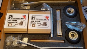

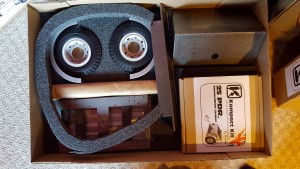

So it starts. Thank you Dave and Bryan, I took your advice and bought a 25pdr and limber. I will not be building soon but look forward to be able to start later in the year. Time to think about how I will build it, unpainted, painted, standard, modified or upgraded?
