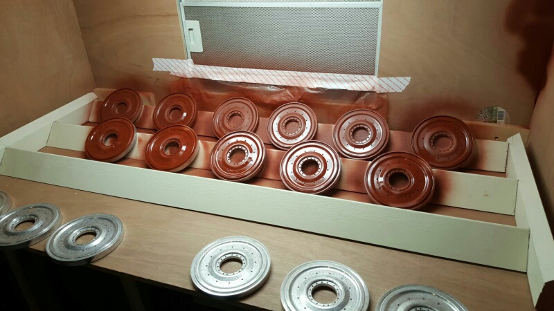

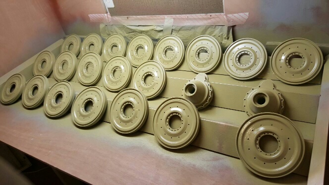

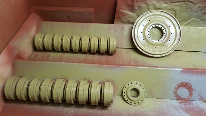

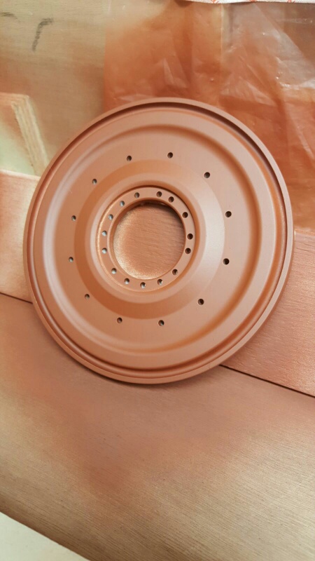

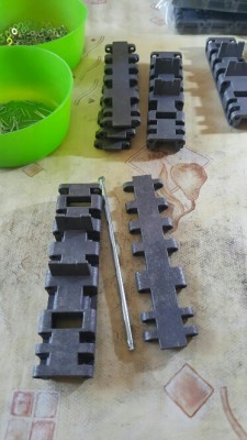

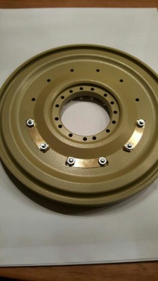

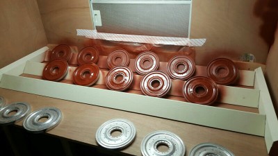

Here are some pictures of the progress of the built. I assembled the tracks and I'am busy with coating and painting the track wheels. I build a special airbrush cabin on the attic for painting. Fabian Bekkers

On of the tracks
On of the tracks
Putting the tracks together and getting dirty hands
Assembling the track wheels
First layer of paint
A track wheel in coating
Coating the track wheels

Great setup. I'm yet to acquire the patience to do prep for spraying properly.

Thnx Sam its a lot of work before painting.I build my own spraying cabin on the atik.
The first time I started spraying the primer I had a failure with spraying the paint over the primer the drying time of the primer was to sort. I sprayed the paint to quickly over the primer, the primer starded to cracking when drying :( .
so I have to start all over. have to clean everyting.
now its going well with the primer and the paint 8) doing some progres now.
Fabian :D
