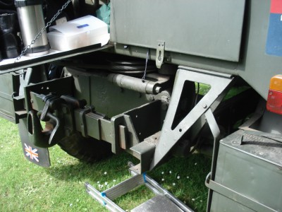

Can anyone out there tell me how I can fix the two Towing Latch Springs so that they don't launch themselves across the room at the first opportunity?

I've spent quite a while looking at walkarounds on the net and I've not seen any tow hitches with springs attached. They all appear to be as below:

Phil, Adrian
Yes, it is correct that the full size tow hitch has no springs. But if you run the model like that, the weight on the 25pdr will flip the limber off the tow hitch.
