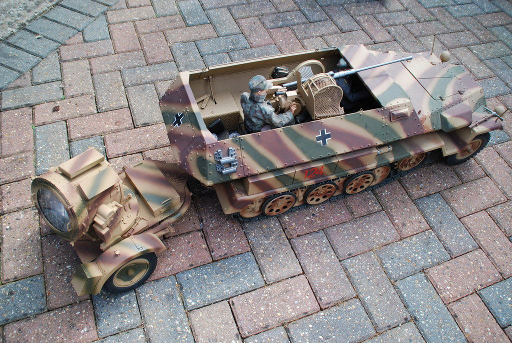

Working searchlight now added to the 251 not strictly an Amortek model but I don't expect Gill and Mark will mind. Both under radio control, working video can be found at :-

Hello Dennis, excellent work, I follow your build and enjoy the posts, well done mate. Those 'searchlights' are little works of art......

I've enjoyed watching this build, your extra detail is outstanding. Did you make the trailer base, or did you buy it from some where?

I was given the Flak 38 gun which I mounted in the rear of the 251, it came complete with a trailer and a bit of fabrication later managed to use it for the searchlight. The searchlight came from a Club member that I did some repairs and mods to his Tiger so we did a deal. It originally had a 2.5 volt filament bulb in it so i changed it for a 3 watt high power led and a lot of mods later to radio control it. I was thinking of buying a searchlight from the web until I saw the price £135 plus shipping !!! The Flak 38 was a Dragon model which is no longer available I think, so was lucky to get one free.
