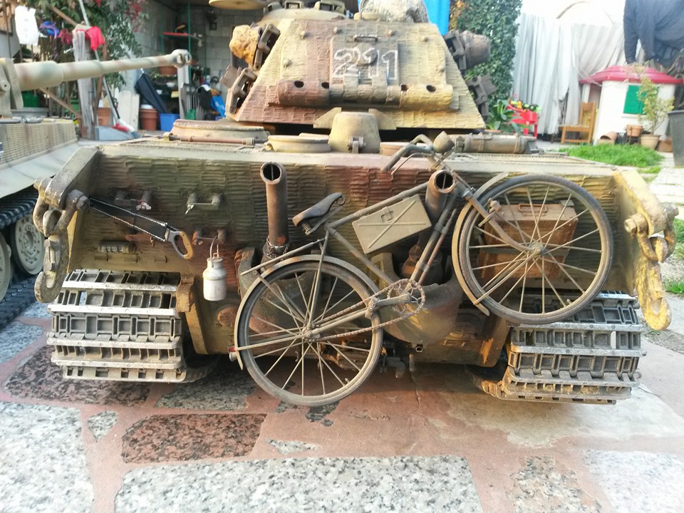

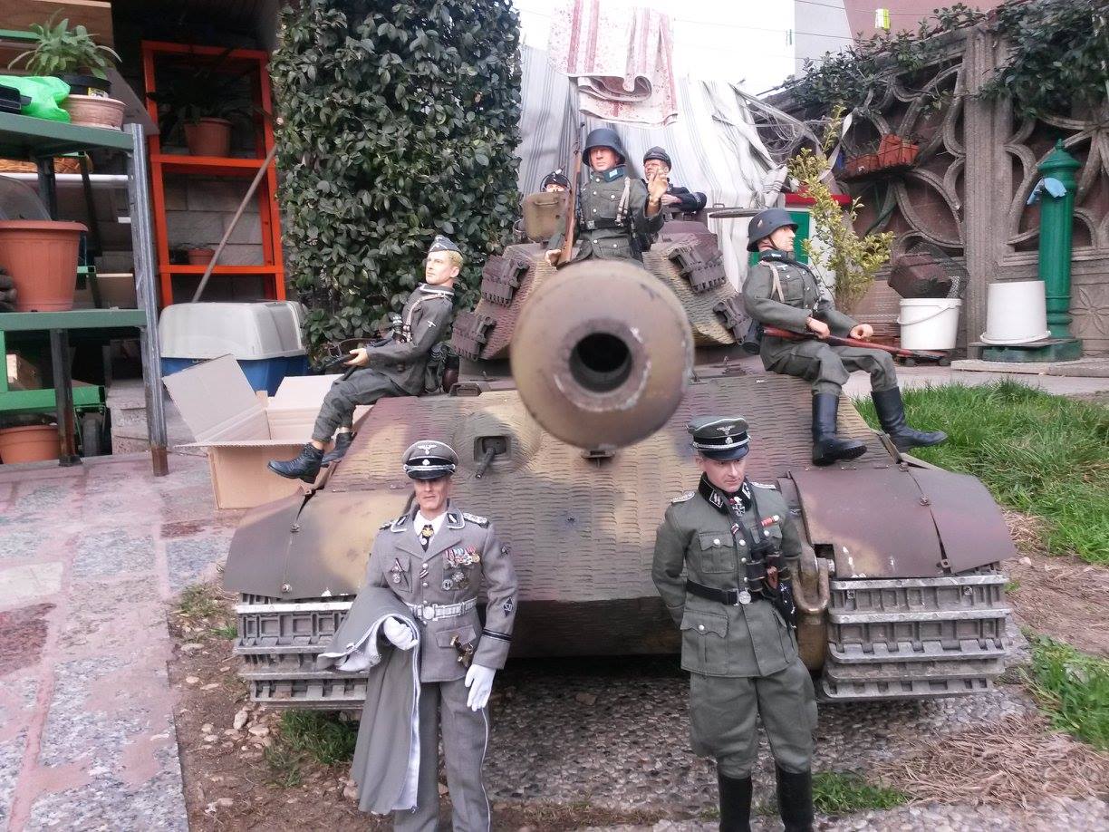

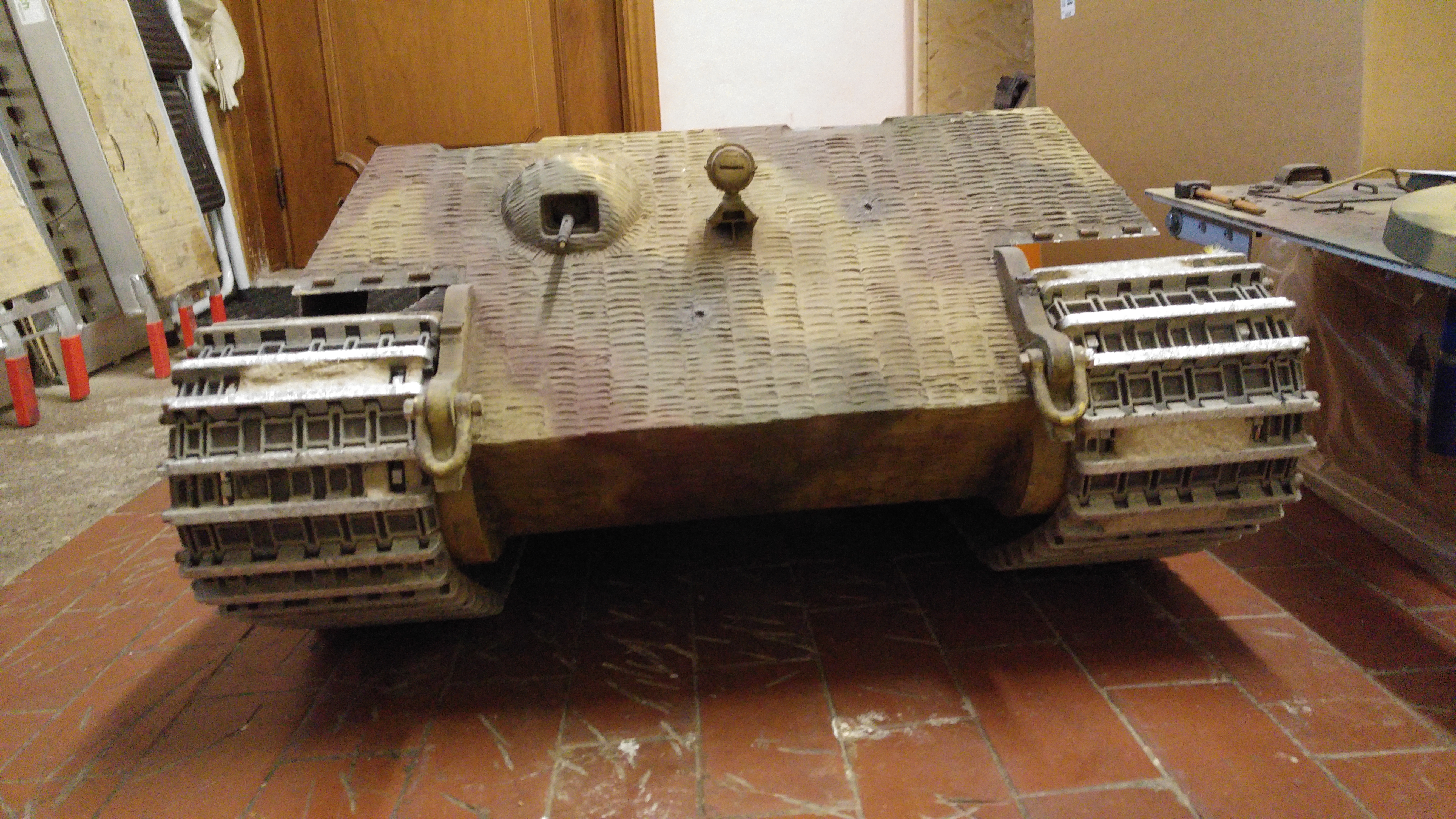

hello i'm new in this forum.
I post some photo of my King Tiger with porsche turret.
As soon as possible i will make some photo of the upgrade.

sorry for delay,this is the upgrade i make for King Tiger:

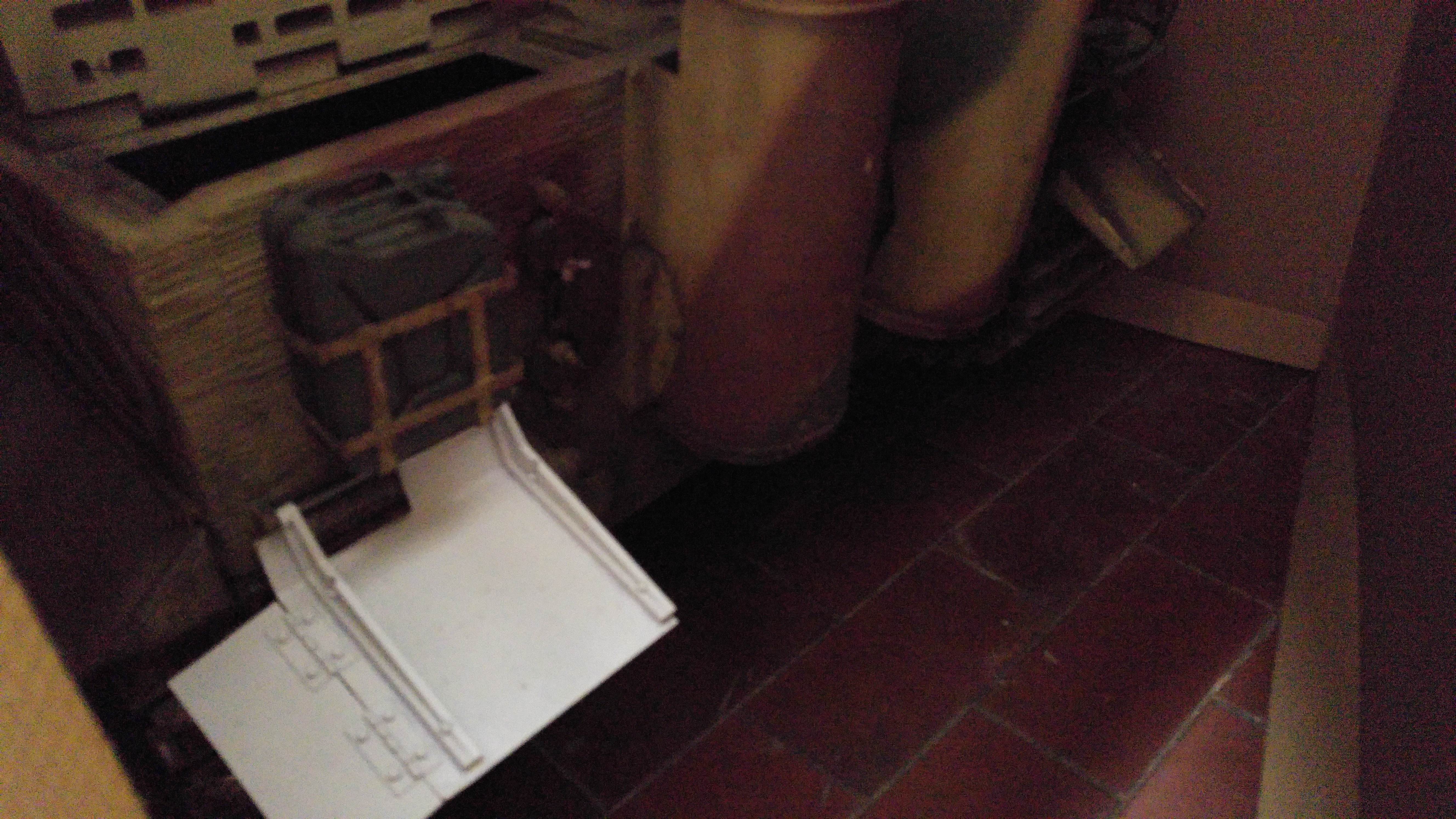

this is a hommade fender made from Aluminium piece worked with CNC milling machine and flat plate of brass
the little brother
the little brother

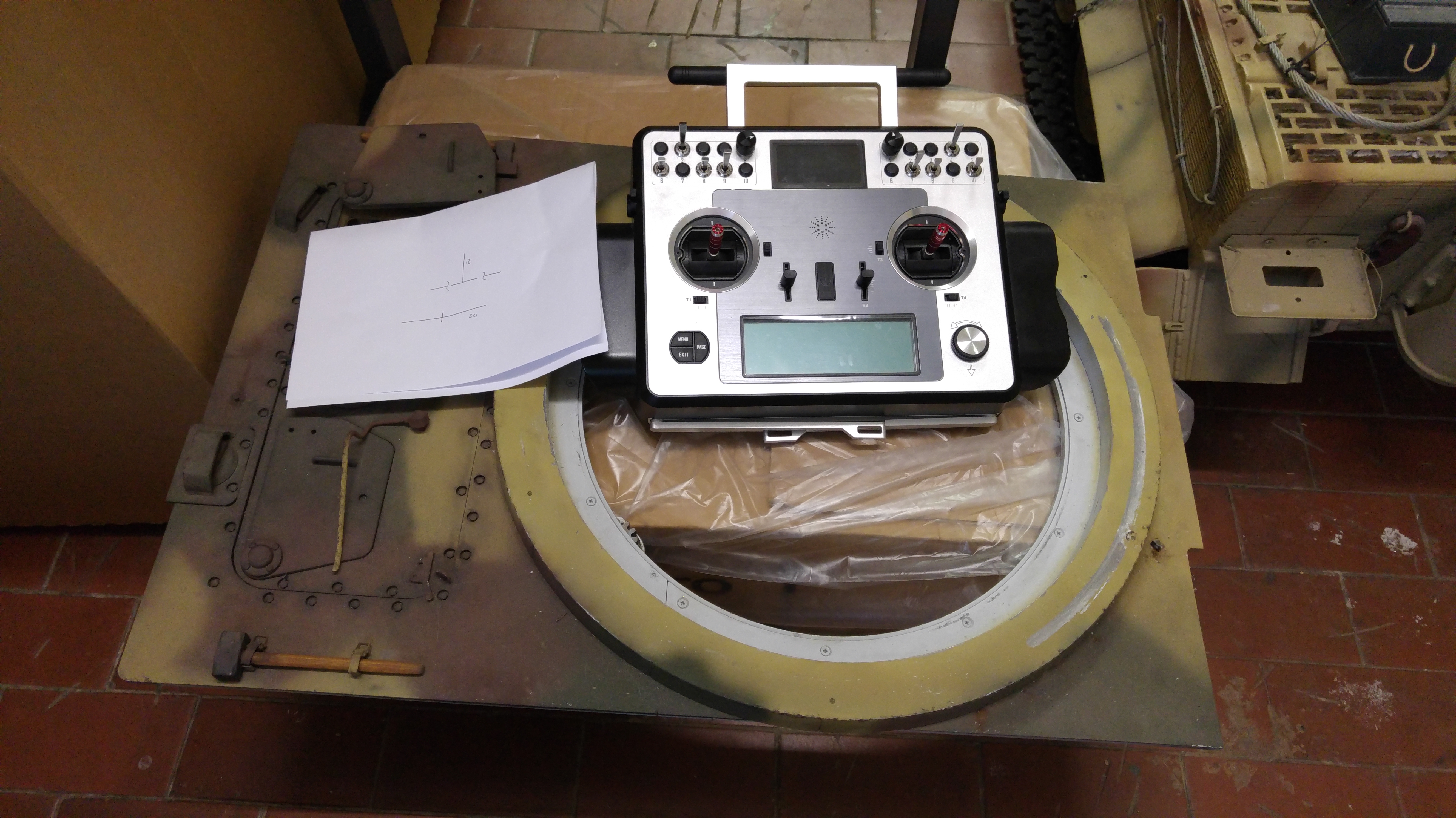

now the turret can turn on the bearing, without bushing.

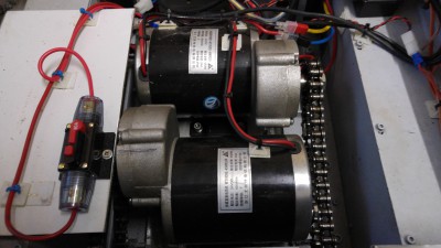

New engine, this bad guys have each one 450W of power with 1:3 reduction gear

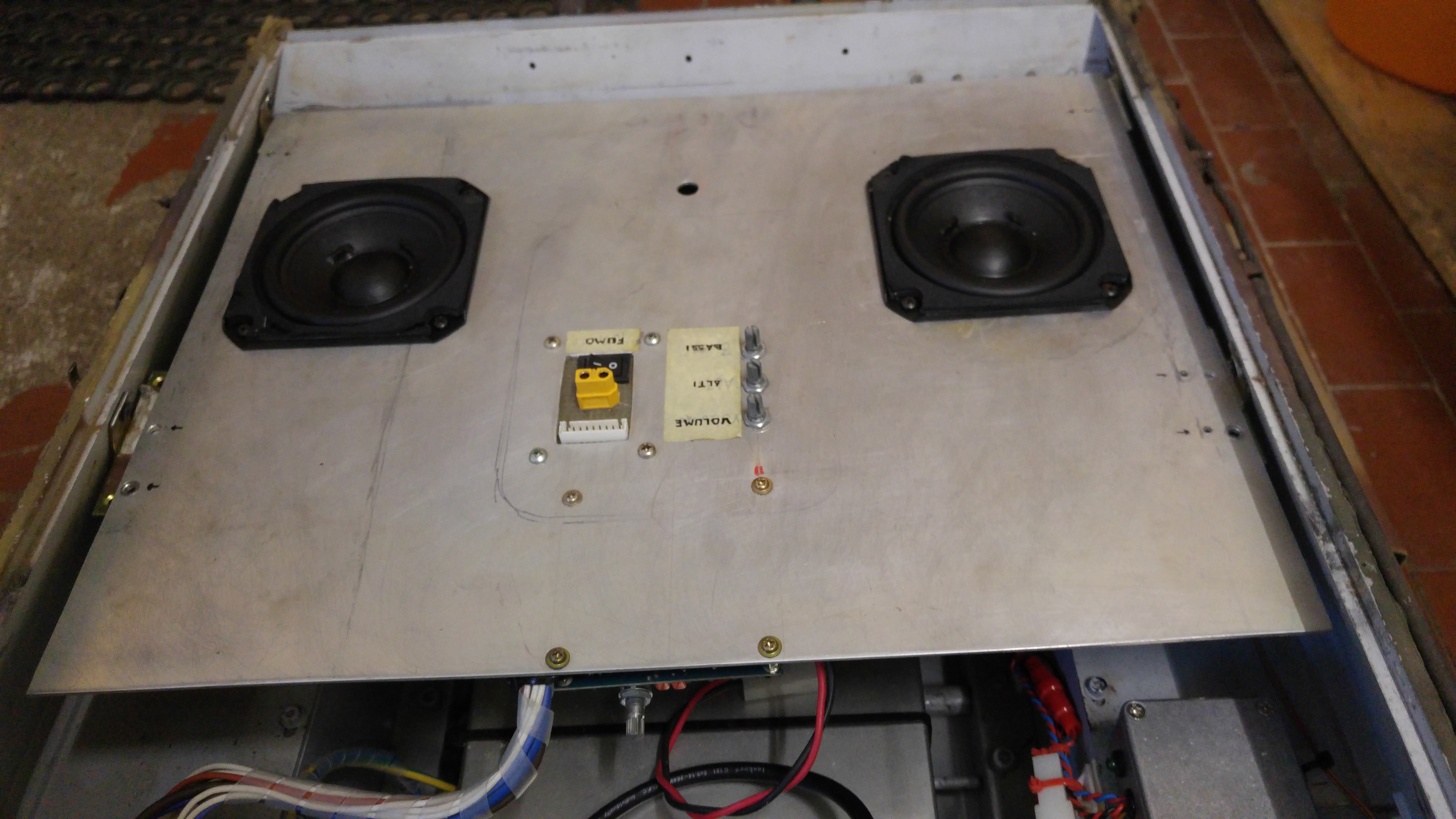

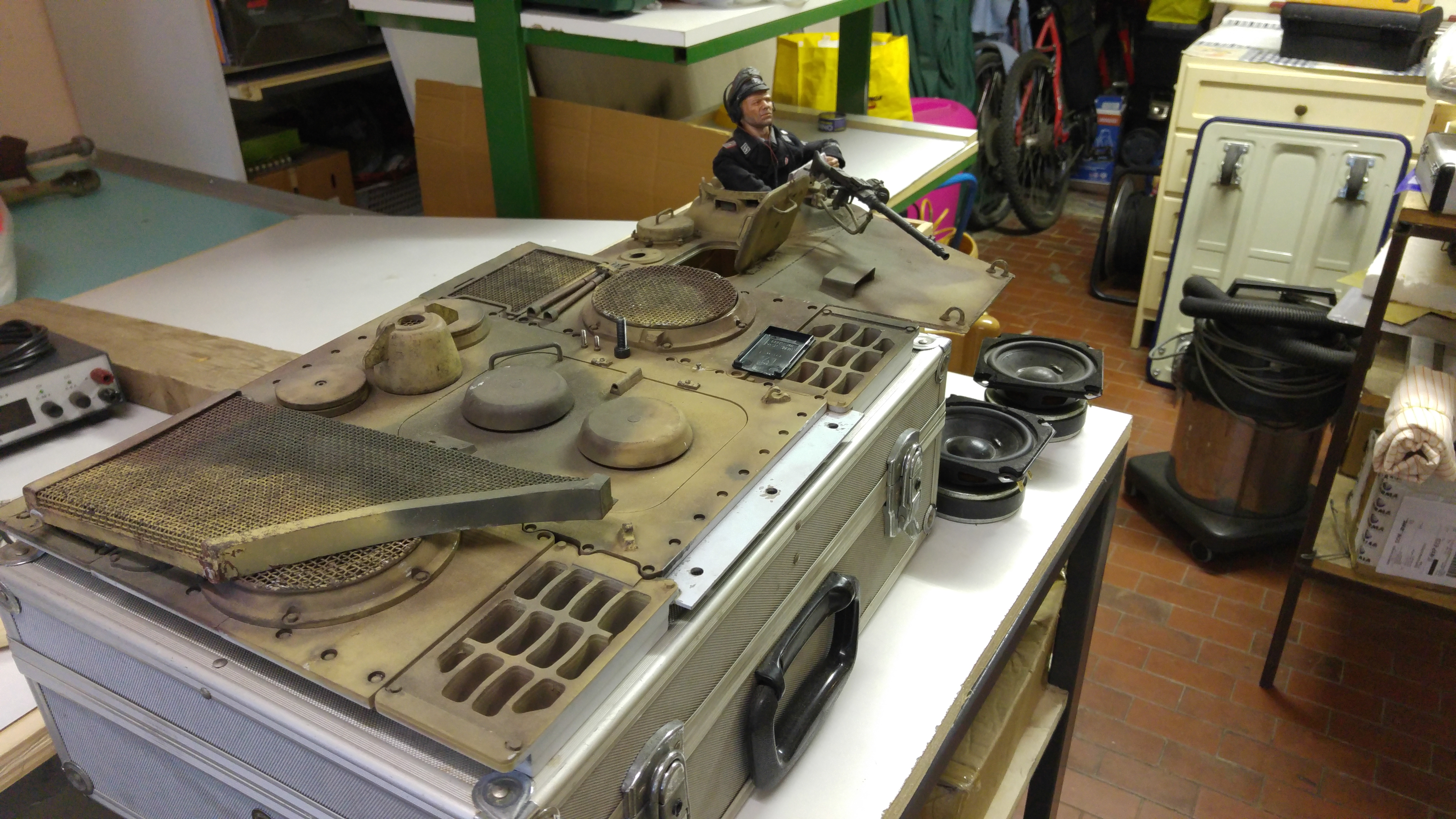

new amplifier with two speaker, each one with 150W

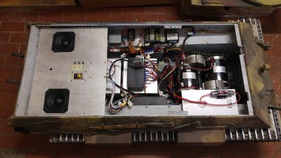

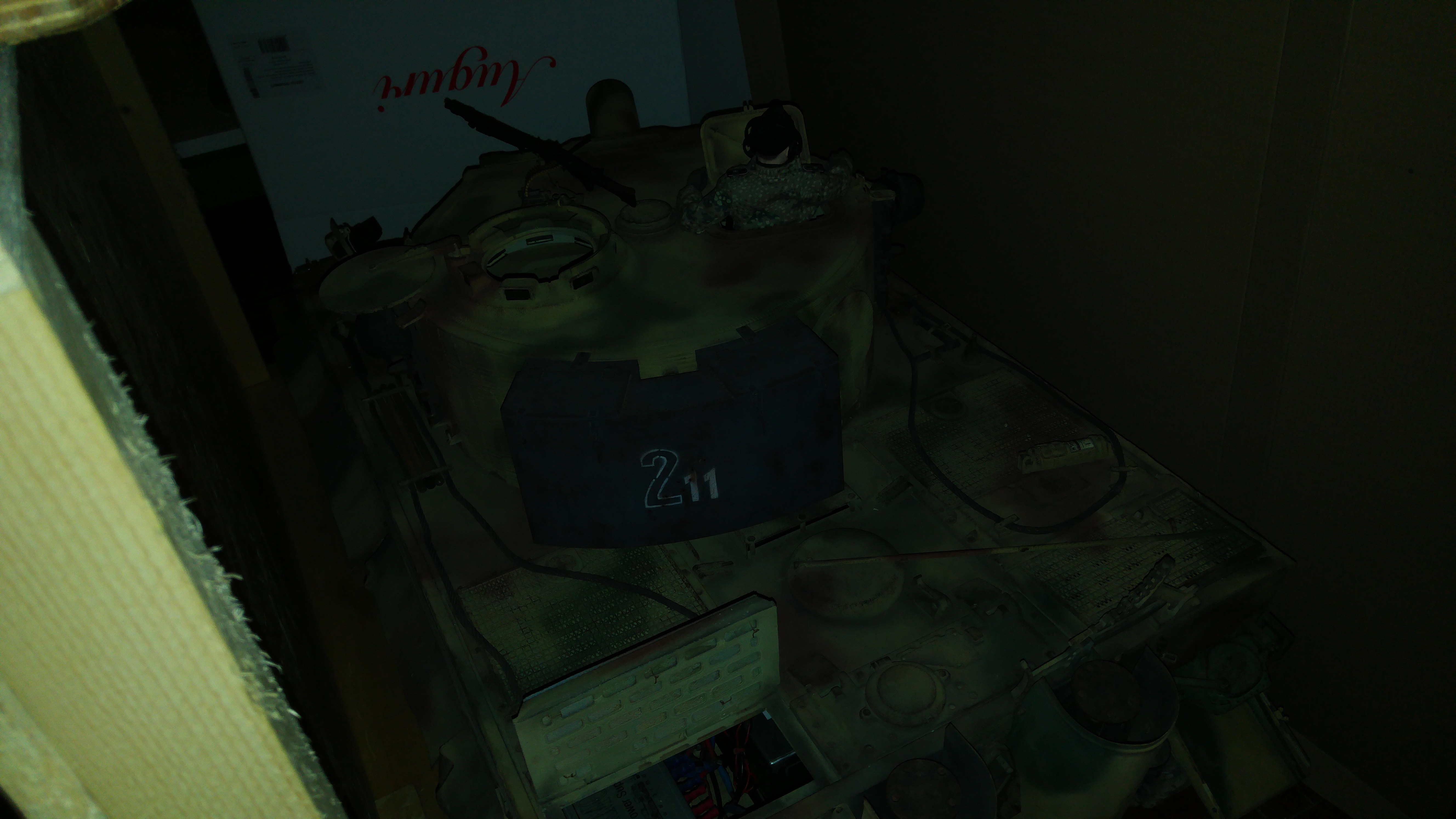

general internal view
