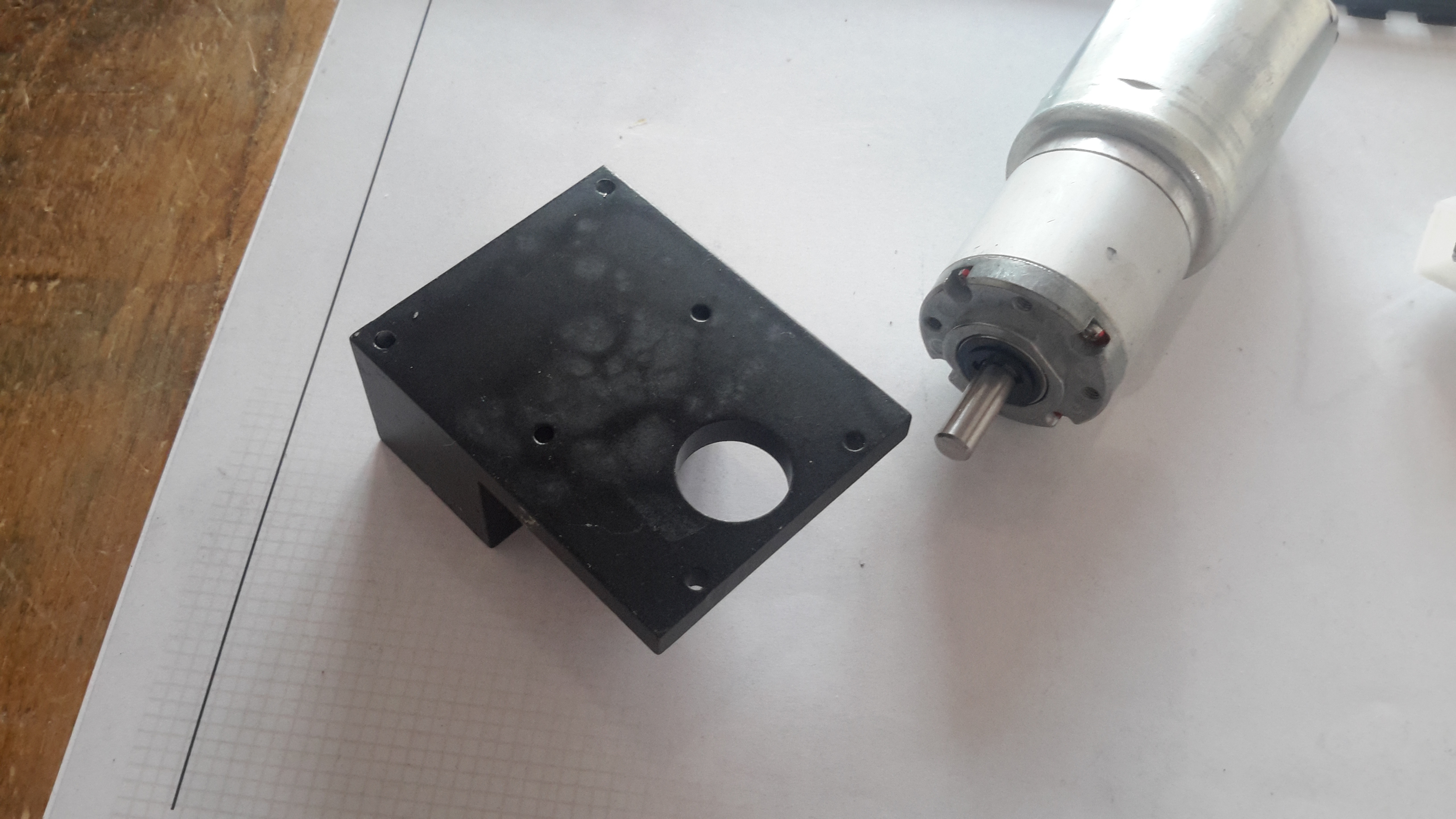

Hello could someone help me with this , Im trying to fit through rotation otor to my
Panzer 111 but the motor doesn't match the mount , there is no detail in the manual
To reference it to , or is there something I have missed that is staring me in the face
Rgards David :|

If you look at the layout picture in Stephen White's posting:
http://www.armortek.co.uk/Forum3b/viewt ... t=45#p9795
his traverse motor is shorter than yours and has a large square gearbox.
It looks like you have a different model motor, so you either need to change the mount or the motor.

Hi Adrian. It looks like there is a plastic mount missing off the motor I will have to speak to mark

Hi mark tried to fit the rotation motor but the the gear is bottoming out on the brass bearing ring , it looks like it would need packing up about 6mm to clear ,is it
Possible the gear is the wrong size ,the length of the gear is 22mm and it fitted the larger motor I originally had
See photos
