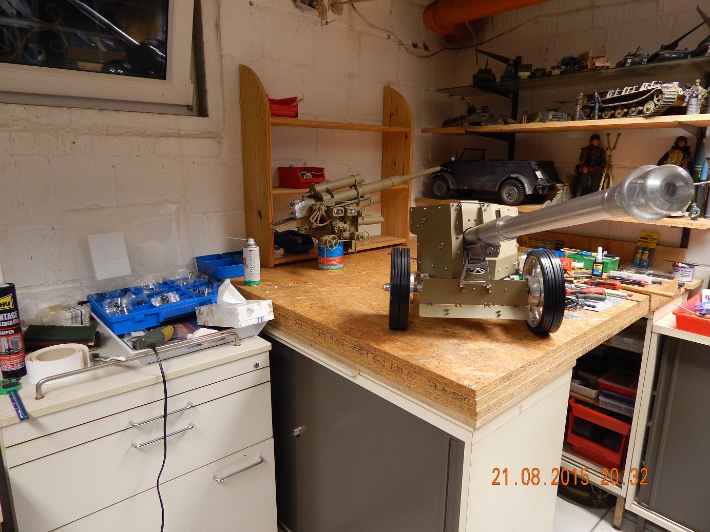

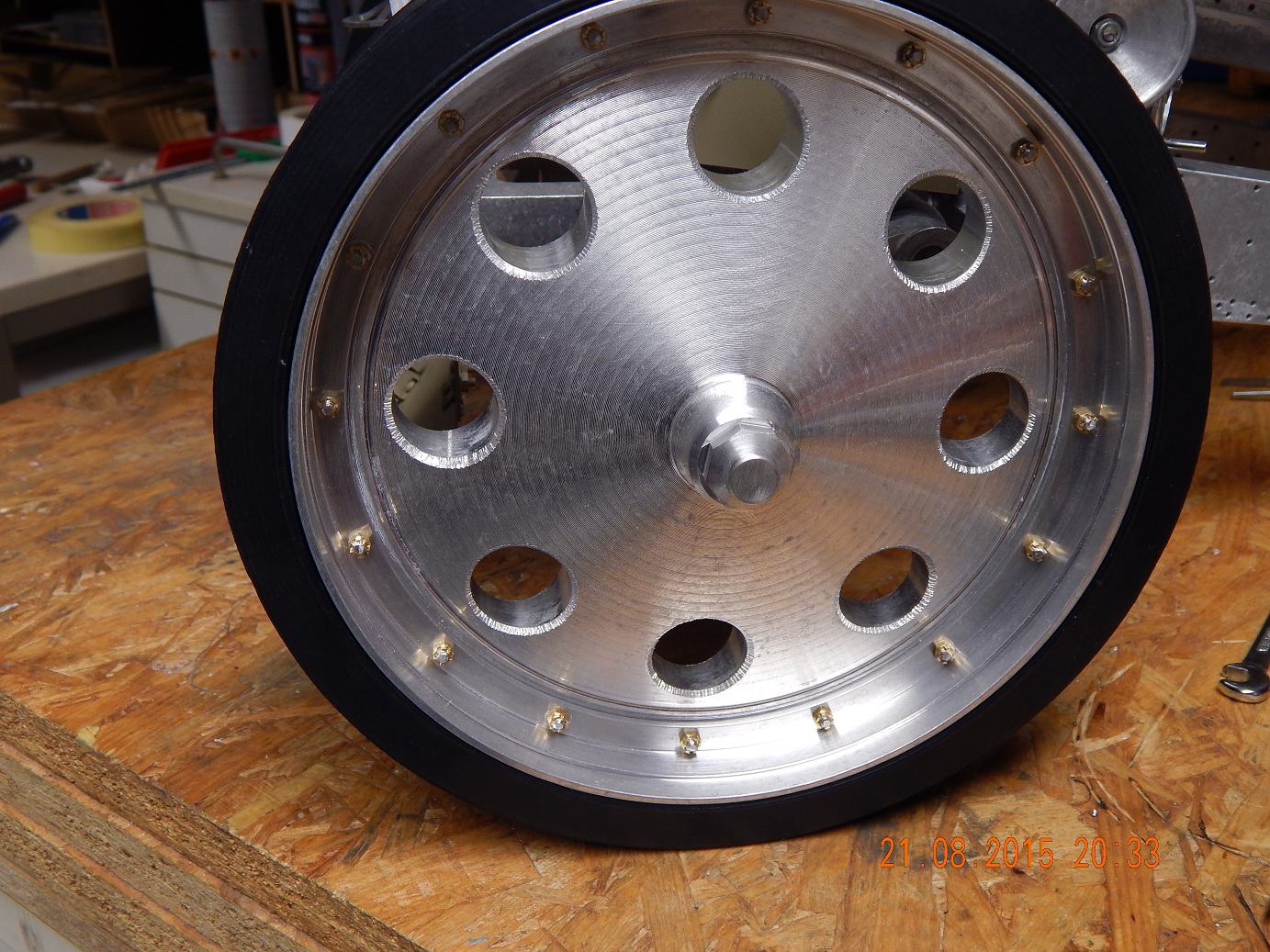

I'm really looking forward for the October events so I had a start on PAK :)
The "fit & function" has been finished yesterday and everything is working smoothly now :wink:
For the Guiness target it should be OK like it is now :? :wink:
The only Mods I've done are on the diskwheels and a "recoil-upgrade"..

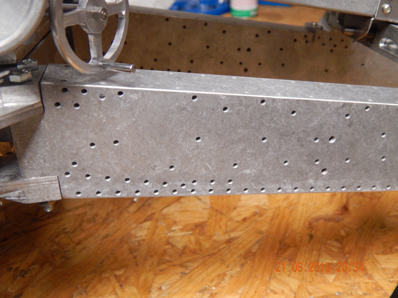

One point I'm struggeling with are the rivets :? hundrets of 2,0 mm holes but 1,6mm rivets :(
Has anybody the round-head dimension of the original rivets at the PAK ???
That Info would be much appreciated to figure out some potential alternatives.

Your Pak is looking good Uwe,
What size are these Castellated Nuts on your disk wheels!
They look smaller than M3 size!
Did you buy them somewhere! or did you make them yourself?

Hello Ian and Doug :) ,
hope I can answer your questions as follows:
The Castle-Nuts M3 with SW4,5mm I got a long time ago from Martin Diessel. They were "selfmade" CNC'd and not available in any regular shop. I need myself more of them for several apps on my models so I've contacted Martin allready for that.
The Hex Bolts are from Knupfer Germany, M3 x 20mm SW 4,0mm, shortened to 17,0 mm lenght.

standing in the forest and don't see the trees anymore :lol: :lol:
Walters hint is so clear..., just since I'm lazy I'll modify just slightly the pivot-pin and secure them with a spring pin (RC car use) instead of the bolts - no tools required and pretty quick :wink:
Later today I'll post a pic of my setup,
cheers,
Uwe

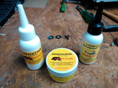

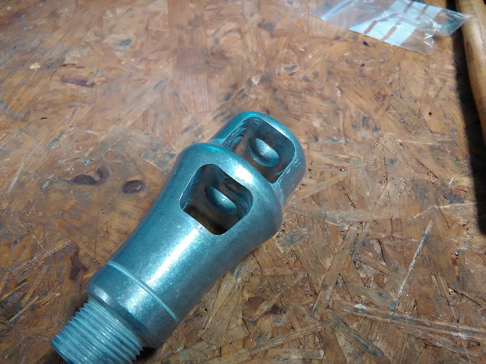

On the fair in Dortmund early last year I meet a nice couple selling special treatment chemicals used for guns . The technology is called " brünieren ". What is that correct in English ???
Very interesting stuff and I'm very pleased with the results. :D Maybe of good use for several applications in our hobby :idea: :wink:

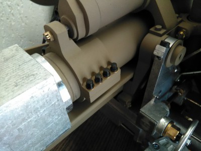

Fixing concept changed to Countersunk. Bolt removable for transport, secured

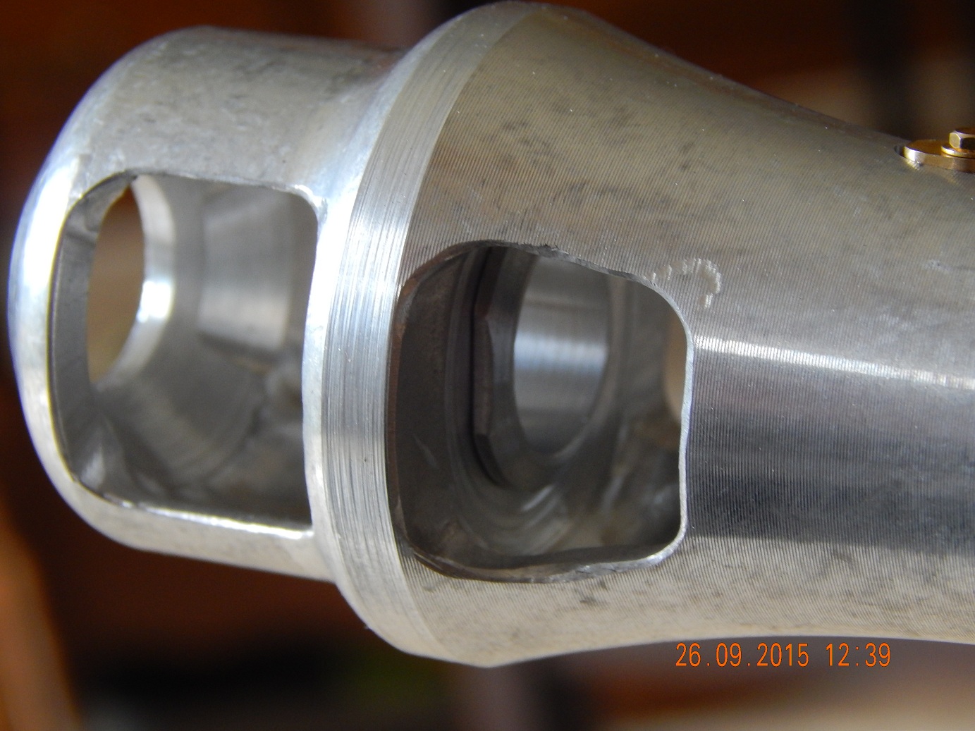

hollowed out on the lathe with micro steels 4,0mm hight
Muzzlebreak after been on the Mill, Drill, Lathe , Dremel etc...

Squarebolts made of brass, block milled
sight apparatus "browned" ??
Special chemicals for steel and brass
