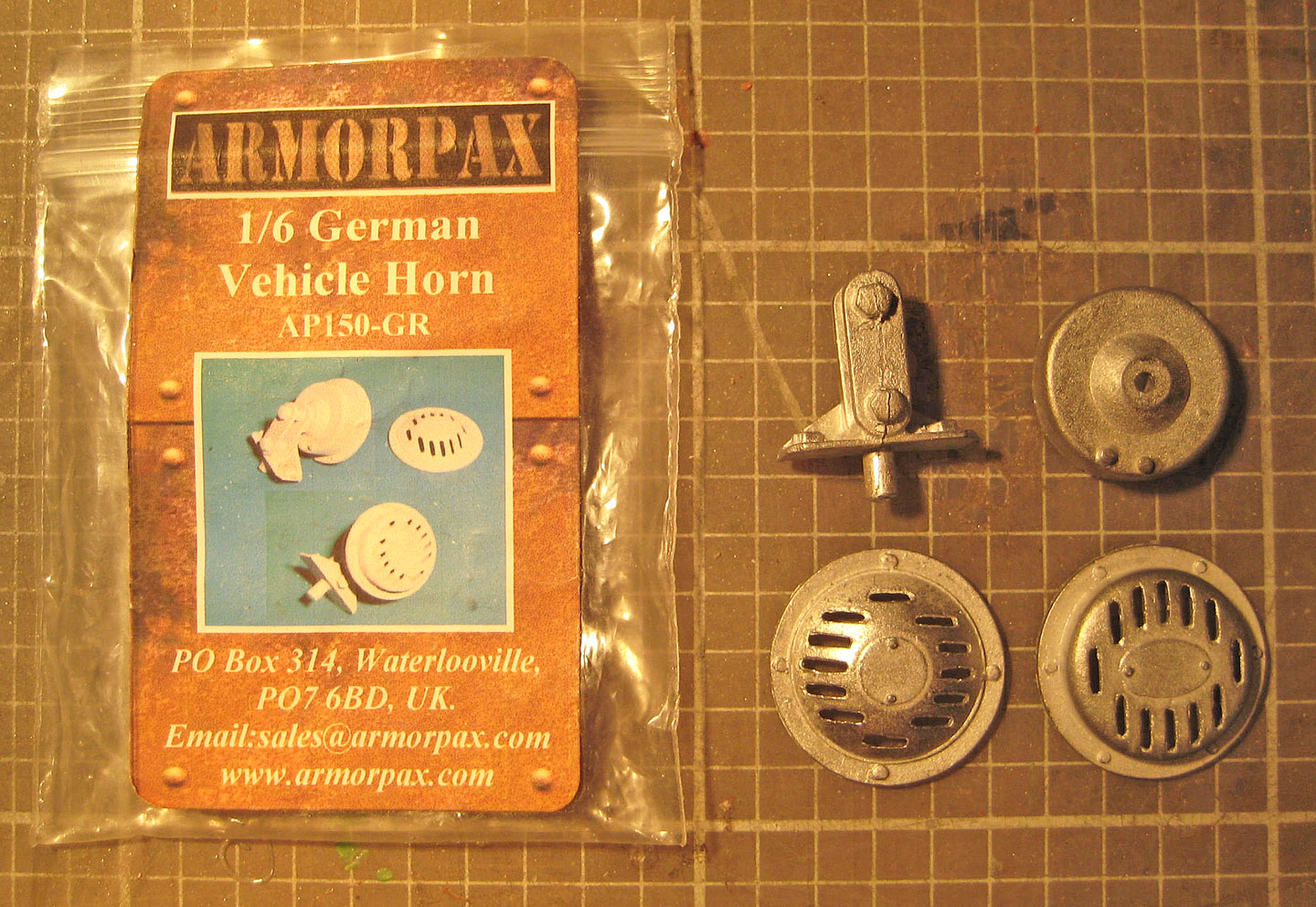

Just noticed on Armortek Forum T/34 section, that you are looking for T34 Headlight & Horn.
I cobbled together, made my side head light and horn from.
Headlight from a Panzer III Front light and a Horn from Dave's Armorpax 1/6th German Vehicle Horn ( AP150-GR).
See my build Re: UPGRADES ON T34-85 KIT. Page 3 (POST:372)
Ian from (Glasgow)

Re: Headlight / Signal Horn
Thanks lan, for the horn info, I may use parts from that kit and add the trumpet to it. Your drawings have been very helpful, especially on how you made those unique tow hooks.

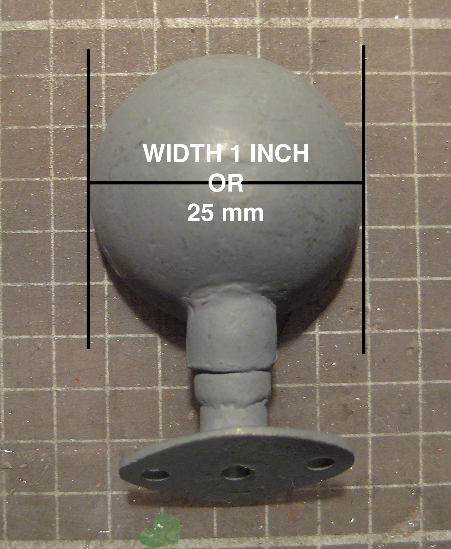

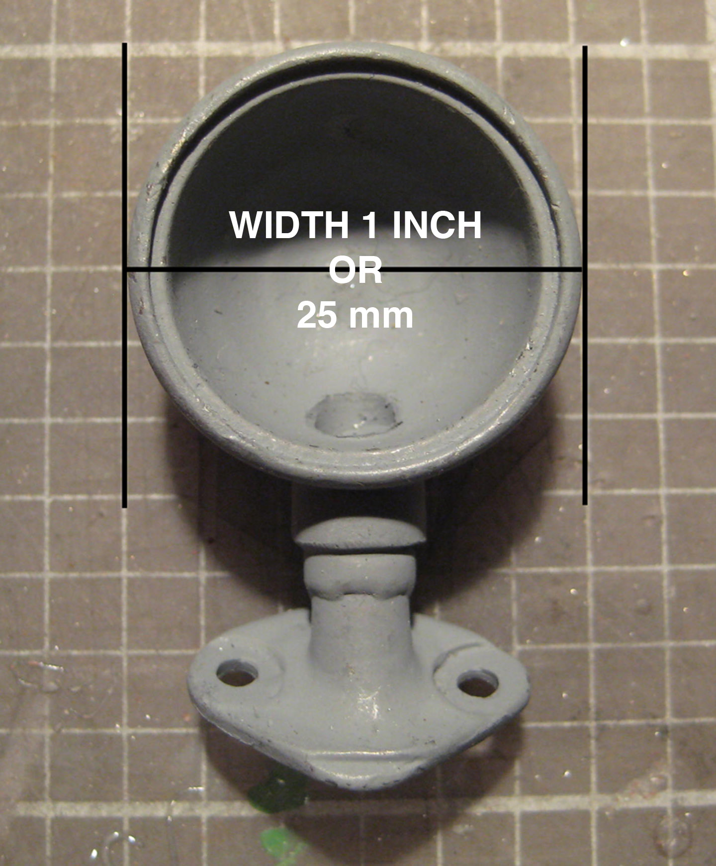

This is the Panzer III front headlight I adapted to create my own headlight for the side of the T34-85.
Diameters on the headlight are Width 1 inch or 25 mm.
A yes those T34 Tow Hooks, they were fun to make for sure!
Hope this helps you to create your own headlight and trumpet horn for your T34.

Hi lan
Thanks for the photo, 25mm that's the diameter I was thinking.
