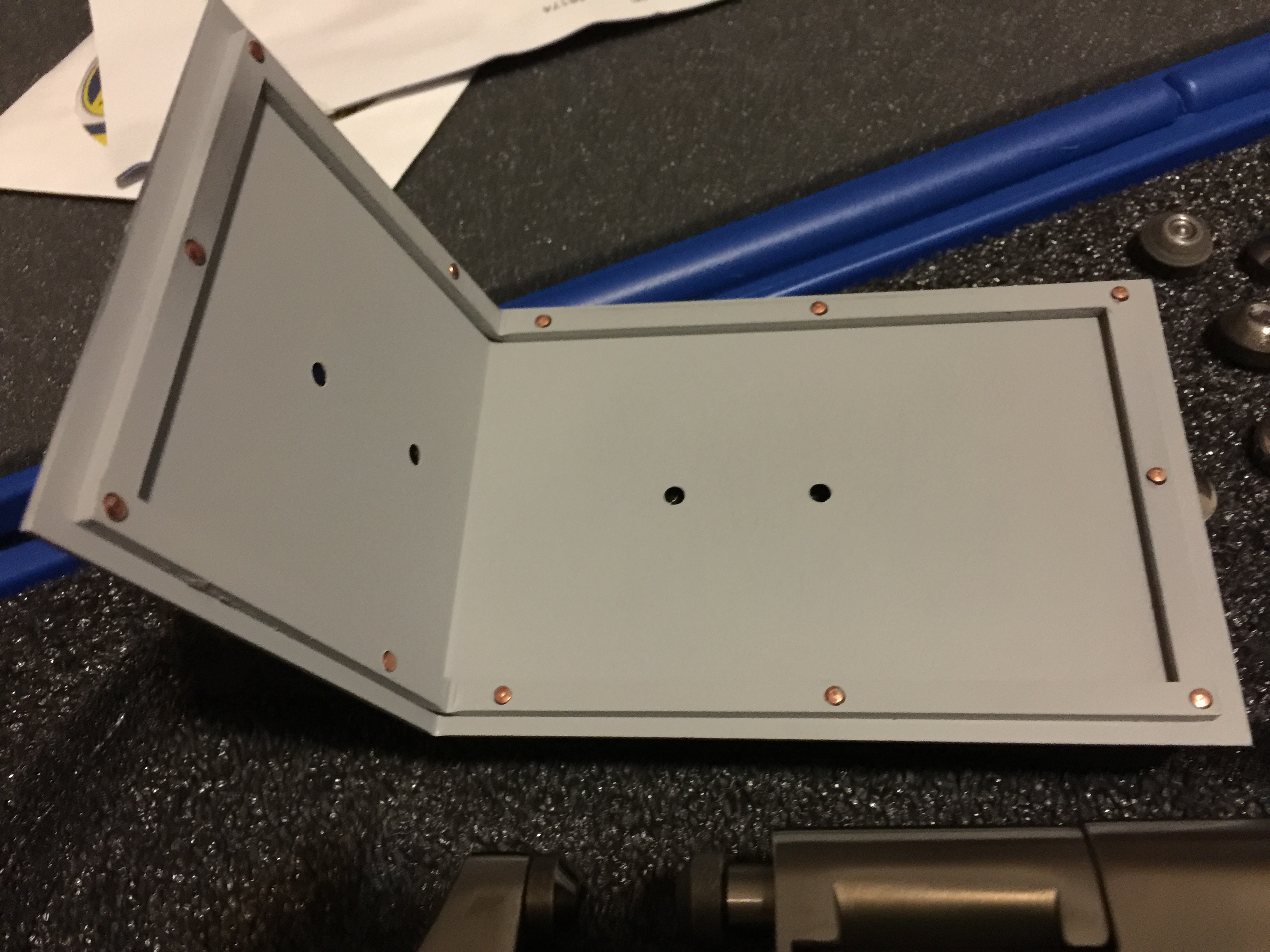

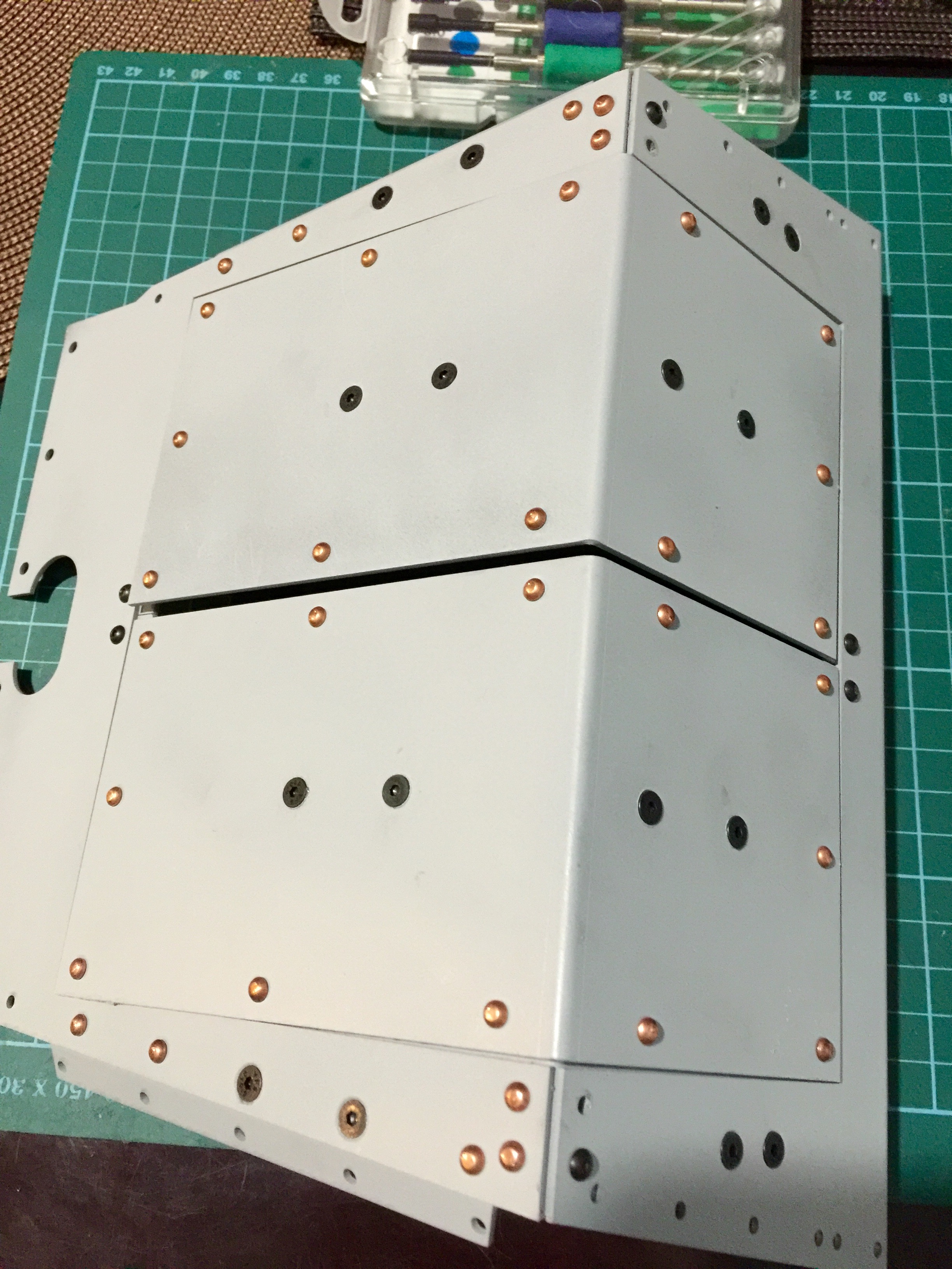

Hello Michael, it's quite easy to assemble all the panels using the M2.5x6 bolts on the corners only (2-3 bolts per panel). That way the form and orientation of the panels (esp the rear triangle pieces, and joiner angles) is established. I also mark the part numbers at this stage.
Then I degrease, clean, and disassemble in sections, before prime and paint - it's easier to me to keep track of the parts before reassembly after priming. And also easier to start the riveting at this stage. I would recommend to start riveting at the front end, leaving the top bonnet off first. And then working backward towards the cab. Of course the long straight rivet sections can be done almost anytime, and good practice areas as well. Ill

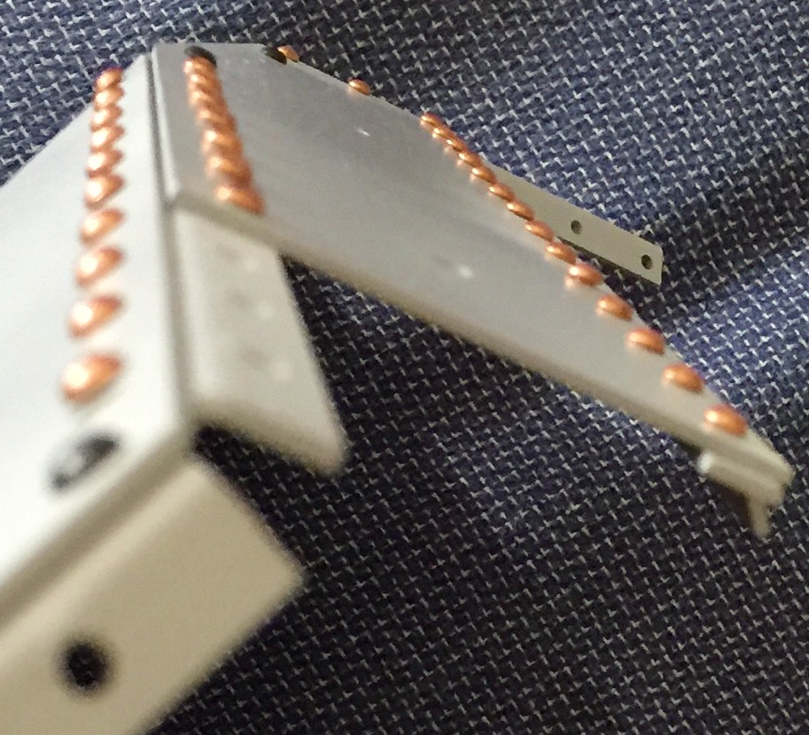

Rivets...need to have long (uncut) and short (cut), the rear door and frame were just nice for the original uncut length of rivet. Whereas in the front cab areas where the rivets go through only one layer (dummy rivets - was tempted to superglue these but the purist inside protested..).
The rear door section assembly went smoothly, only thing to note is the triangular CM0511/0511M pieces have a right and left orientation, even though they look very similar.

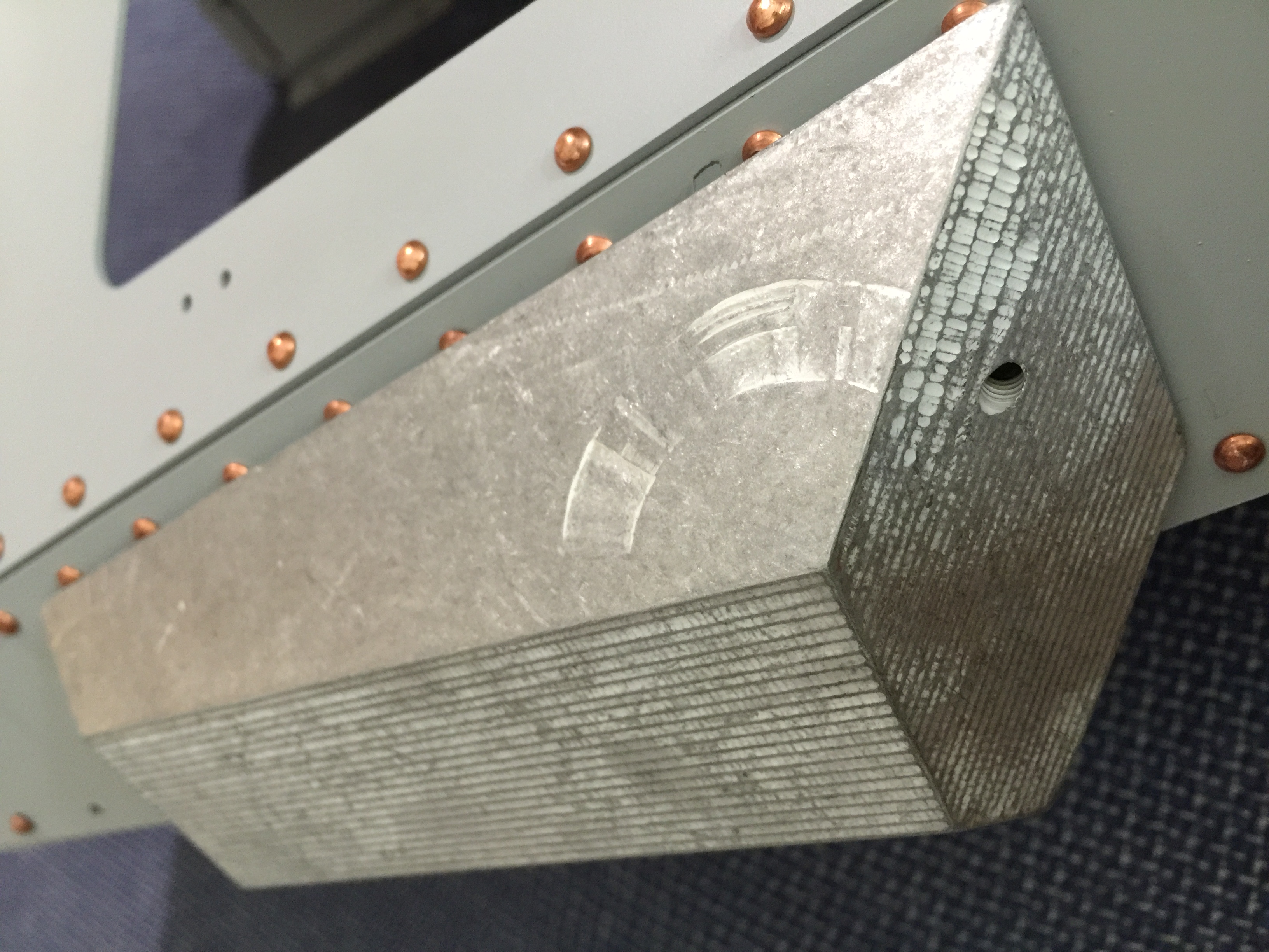

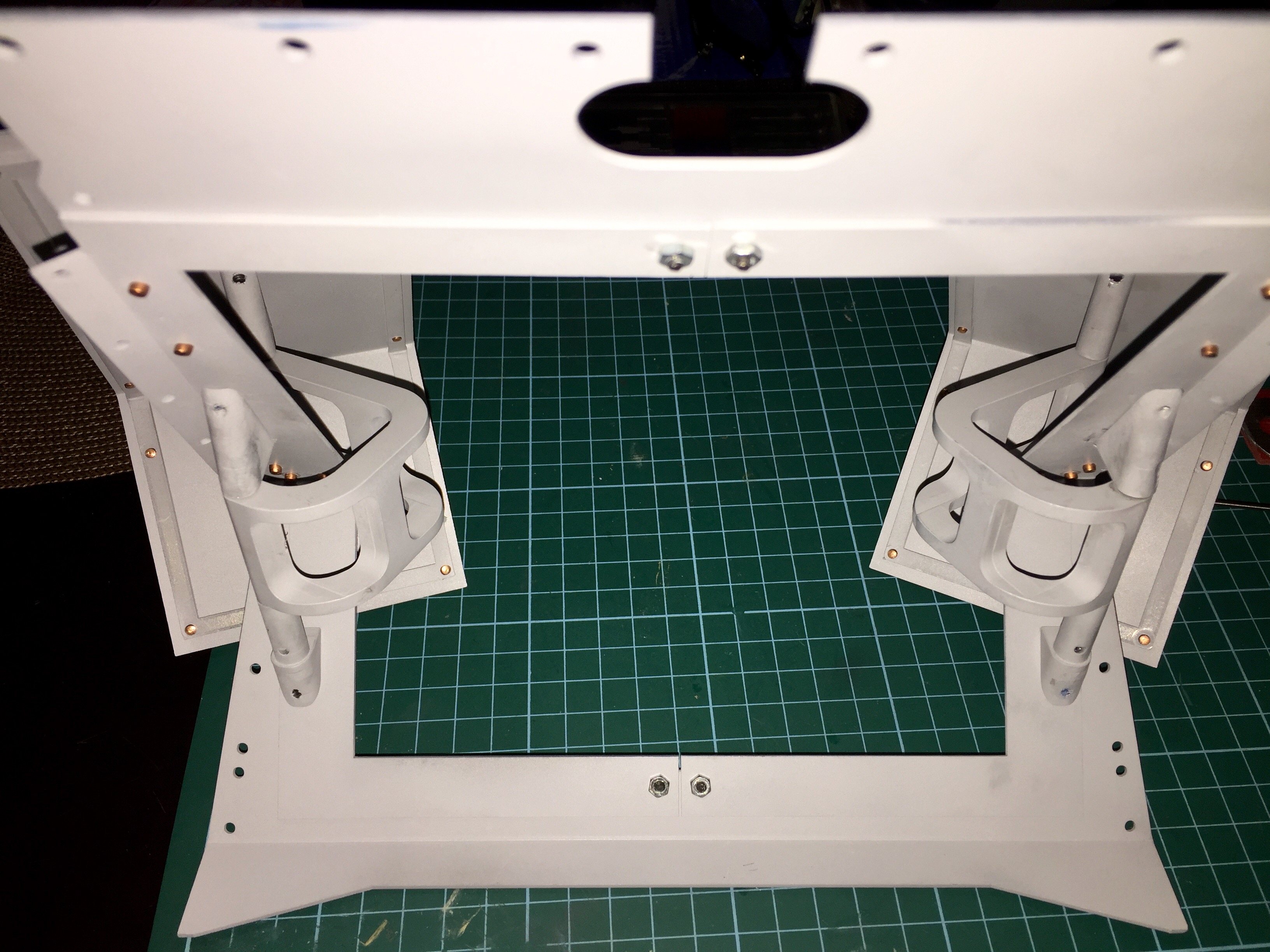

A busy year, packing, moving, unpacking...finally restarting on the 251. Pardon the horrible holes made on the side, lots of adjustments I made trying to get the mountings 'right'. I promise the other side looks better!

Luckily those 'horrible holes' would be covered up by the air intake boxes once mounted, it should have been a straightforward measurement and translation to move the holes lower to clear the rivet line, but I must have been careless or didn't account enough for the slope/slant when relocating those holes as the mounted boxes were a little askew and I have to tweak the holes a bit.
