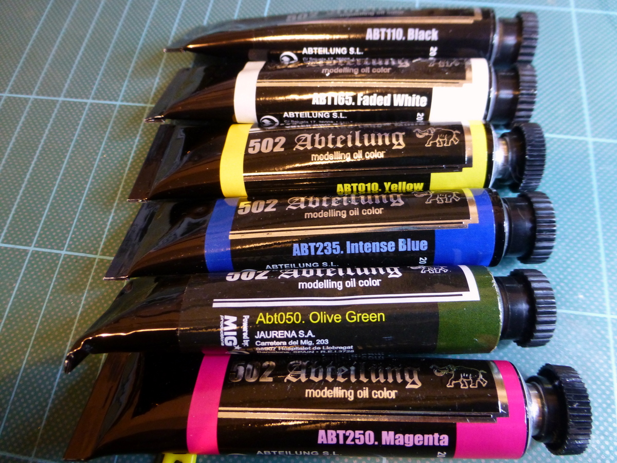

Oils: oils are the most versatile medium for weathering, you can control the opacity, hue, saturation and shade (terms explained below). One tube will last for years. A suggested starting palette:
o Basic colours for changing hue (colour tint) and shade (lighten/darken):
Note that Black and Faded White are included for use with Panzer Grey (RAL 6006 Feldgrau) only. Don't use with other colours.

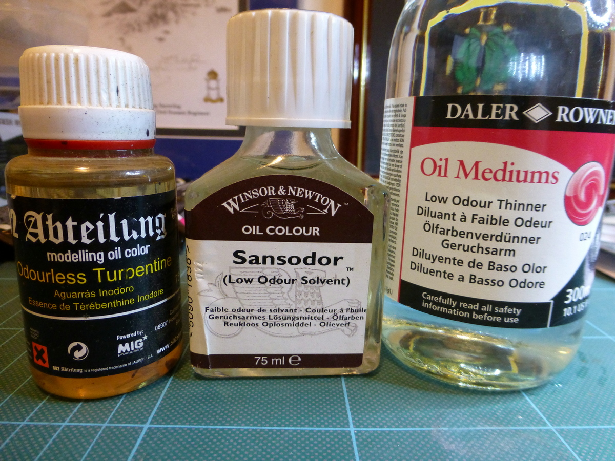

o Solvents. Oils require the correct solvent, either refined turpentine (smelly), white spirit or best of all one of the low odour thinners:

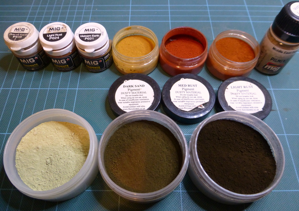

Pigments: use modelling pigments to represent dust and mud and earth effects.
o Mixes. There is no need for a huge selection, make up three colours, light, medium and dark in airtight containers. You can always add distinctive colours for specific theatres, such as the red laterite soils associated with parts of Vietnam or the Russian Steppe.

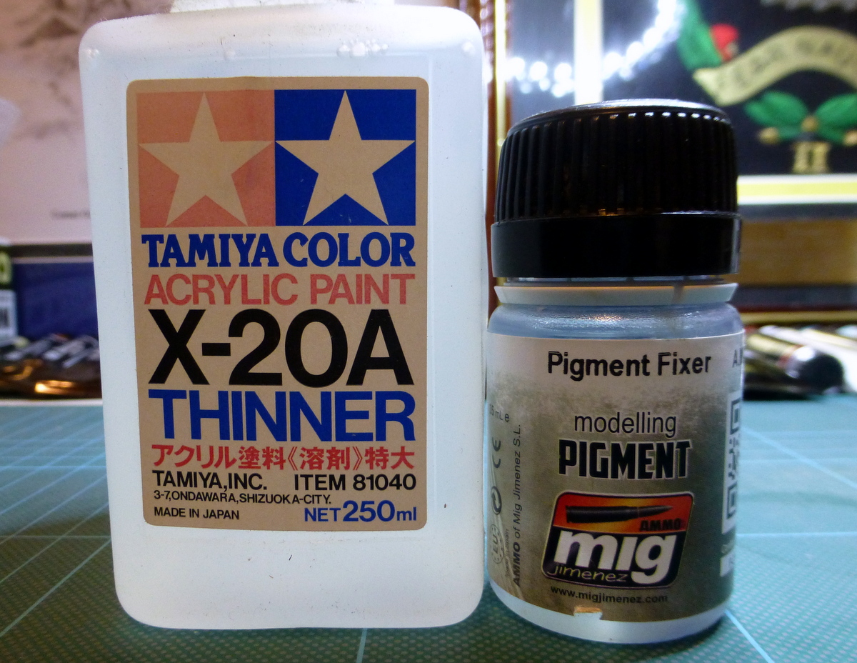

o Application. Application is simple, apply layers of pigment, starting with lighter colours and fix with a pigment fixer or an acrylic thinner such as Tamiya X-20A, using a pipette or eye dropper.
As with oils, the drying process can be speeded up with a hot air gun/hair dryer. Wet mud can be represented by darker colours and if desired, some the thinned oil colours above, flicked onto the pigments from a loaded brush.

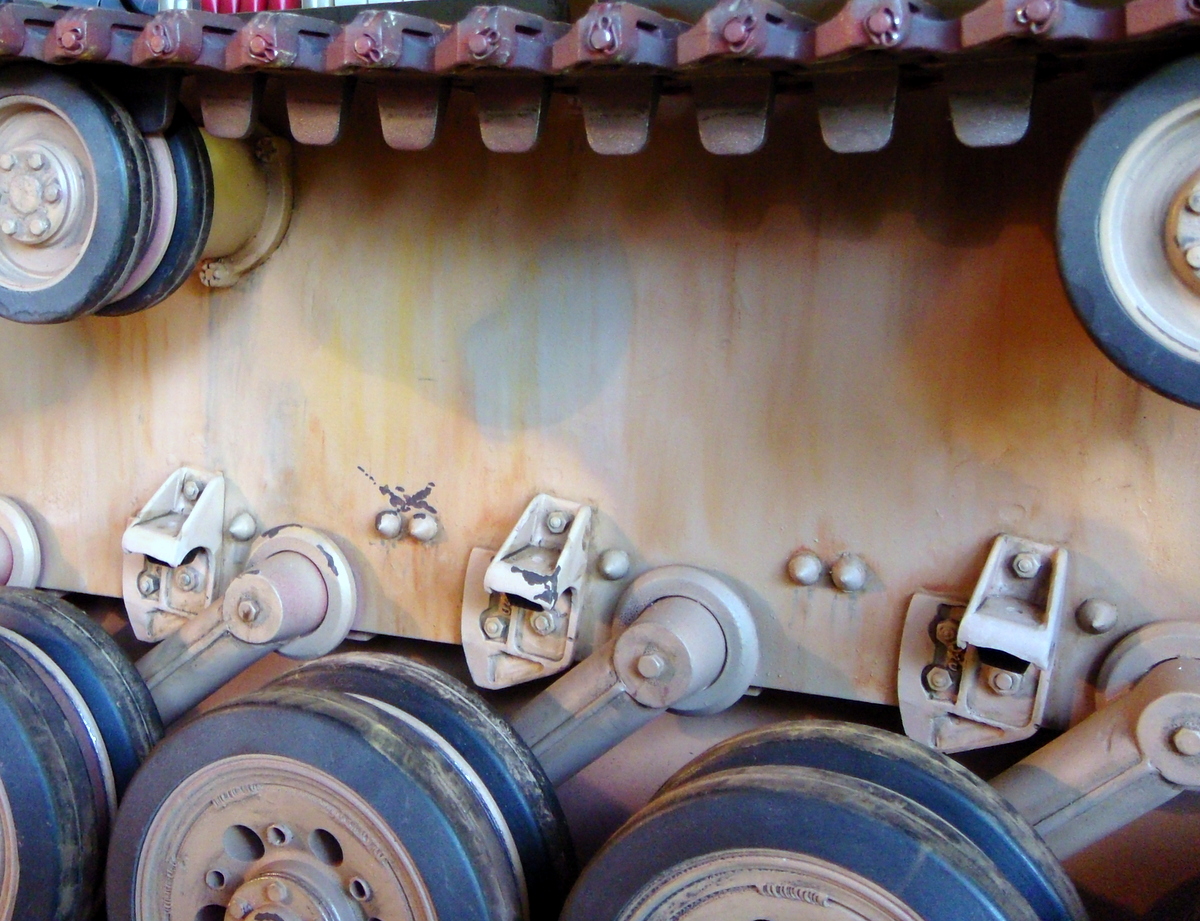

- Filter. A filter is a translucent layer of complementary colour(s) which changes the saturation of base colour(s). Filters are most useful in unifying and dulling down bright camouflage colours. Apply the oil wet and well thinned, brushing evenly. Concentrate on larger surfaces. Don't flood the surface and don't scrub - apply in an even light layer.
Filter applied on the left, unweathered camouflage colours to the right (German Tropen Scheme 1943, RAL 8020 Braun and RAL 7027 Grau)

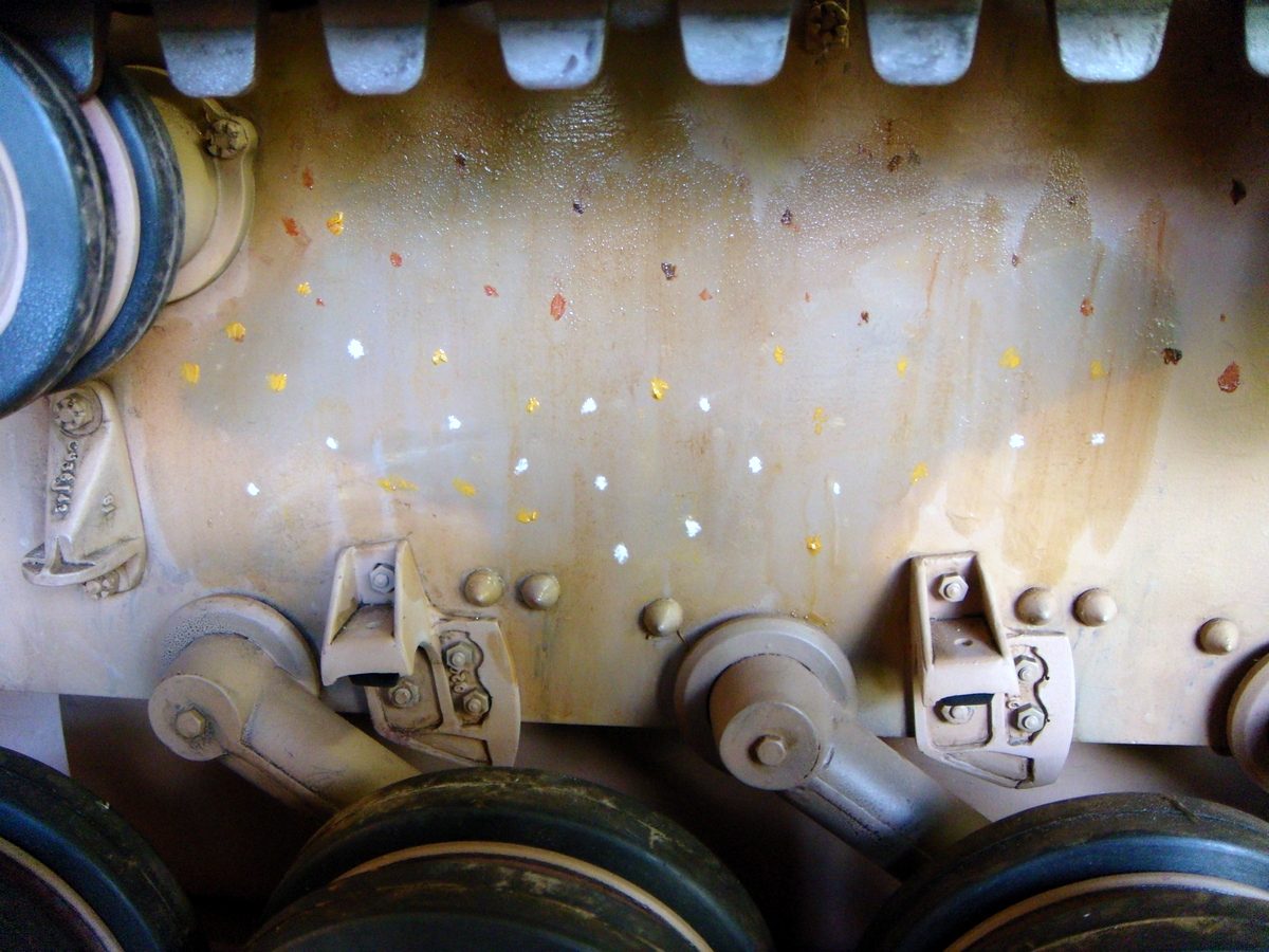

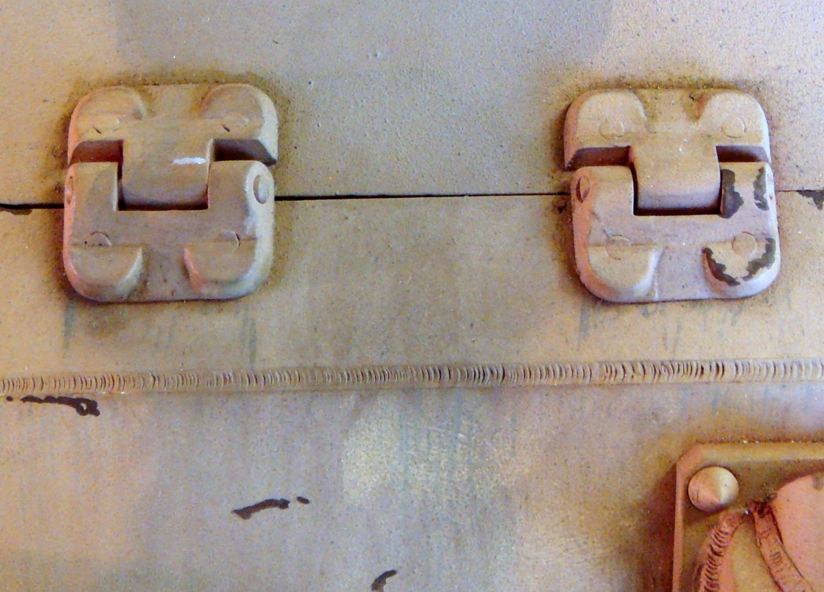

- Chipping. Chipping is a technique to reproduce the scratches, dings and marks associated with heavy use. **Caution – can be overdone warning.** It’s very easy to get carried away with this technique. Operational vehicles really don’t suffer that much from chipping and scratches and any which do occur are usually superficial and obscured with dust or mud. Military paint is designed to be robust, except for temporary covers such as winter whitewashes. Some modellers apply a coat of hairspray under the basecoat which can then be selectively removed by scrubbing with water. This does produce fine detail but is probably best restricted to reproducing temporary schemes. Chips can be hand-painted with a fine No 2 round brush, using two colours, a dark base and lighter surround. You can also produce finer wear by using an almost dry piece of sponge to dab a thicker wash of oil. Try to achieve irregular shapes with sharp edges not rounded blobs - like a map. Size must also vary, uniform sizes kill the effect. Don’t distribute chips all over but concentrate in areas which would be subject to wear. No two areas should be the same. Try to create differences.
