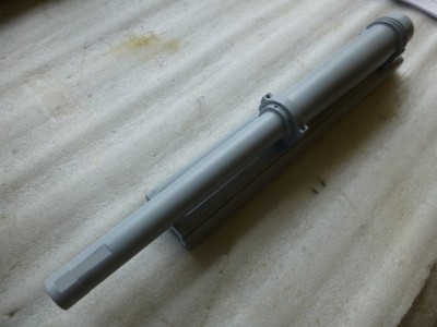

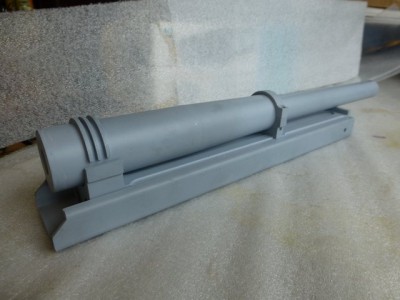

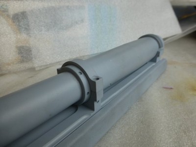

Has been a while, and I should change the name to reflect what is really happening, as it may help others who are contemplating building the Aust version of the 25-pdr field gun. I say 'Aust' version because there are some differences in construction, one being the jacket/barrel assembly. In contrast to the Royal Artillery, the Royal Australian Artillery were not equipped with 25-pdrs with muzzle brakes during the Second World War - it was not until the early 1960s that the muzzle brake was introduced on the field gun (The Aust Yeramba SP gun of the early 1950s was so equipped).
First challenge therefore was to measure and draw up the Australian barrel. No easy matter as I now live in the USA, but I was fortunate to be in Queensland last December - January, and measured the field guns on display at Tiaro and Murgon, north of Brisbane. These measurements were then sent to Allan Bowers in New Zealand, who did an excellent job of drawing up the barrel/jacket assembly - thanks Allan! Stephen White, who needs no introduction on this forum, then took time out from his outstanding Centurion build to turn up the barrel and modify the recoil system to suit - thanks Stephen!
The Kompact Kit comes with a stylized barrel/jacket assembly with a uniform diameter between the rear and front seats of the recoil system, whereas the actual jacket has a taper. So the diameter of the recoil system's rear seat needed to be enlarged by a couple of mm, and the jacket at the front seat needed a step to compensate for the difference in the smaller diameter jacket compared to the diameter of the front seat of the kit's recoil system.
The Mark 2/1 jacket also has thrust collars both above and below the barrel, whereas earlier Marks do not. The barrel muzzle profile has a parallel muzzle swell, in contrast to the original bell-type British barrel, and the later, threaded barrel for the muzzle brake, as represented in the kit. There is also a flat milled into the top of the barrel for placing the inclinometer during sight alignment checks.
The Australian jacket/barrel assembly therefore looks quite different in detail to the one provided with the kit. The results of Allan and Stephen's work is shown below.
Mike
