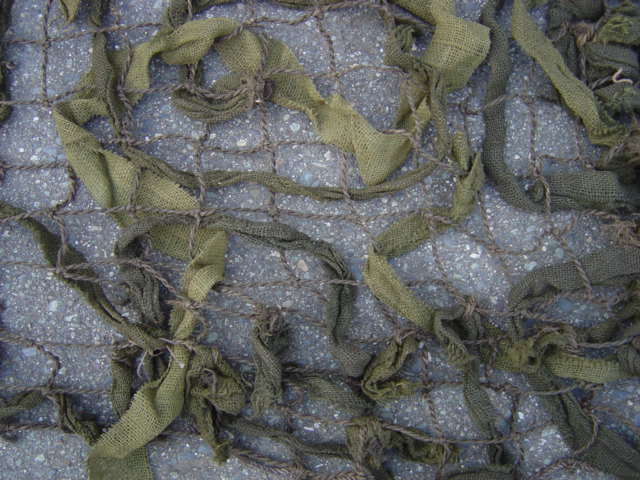

a few ideas from these pics their are a lot of 1/35 us / uk kits with the long strand type on them the swirly type were for artillery but of course used on armour so you cant go wrong really :)

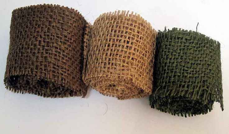

I am still looking into this as well and the only colour image I have found is a painting of the camouflage strips being applied. I spoke to a chap at the On-Track show this year and he related that his dad as an evacuee was adding the hessian to the netting as a child after school and apparently other voluntary organisation were involved. So is there a Ministry pamphlet for the patterns and colours used. See the other pic I found for hessian colours unfaded.
Mark.

Well, I went ahead and got some of the netting Colin recommended.
The 2in British mesh translates into 8.45mm or so at one sixth and as you can see, the mesh size is spot on. The material is a bit stiff as supplied and needs to be coloured but with the addition of scrim, it will be perfect. I just need to finish my Cent now and get back to the Comet.
Thanks for all the input to this thread, positive and negative. Certainly helped me, as ever with this forum.
