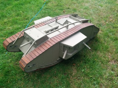

Re: Mark IV No. 35
More testing, I seem to be getting some track binding in reverse, not sure what it is fouling on at the moment though. Meanwhile I fitted the sponsons and the speakers and spend a while annoying the neighbours with the noise
Next up is the roof and rails but I am trying to figure out how I can mount them and still have some access into the tank...

Re: Mark IV No. 35
Daniel -
You're a bit ahead of me, but I had a look at the issue of the roof and the unditching rails today, and I think I may have a solution for you.
The issue is where the unditching beam goes. It's more of a problem if you do it according to the build instructions, as you'll have to take that off first. If you put it in the later historical position (as discussed at length between myself and Steve Stuart) then it's nicely out of the way at the back of the tank.
The only point where the unditching rail fixes to the roof is at the support EK0647. I can't see any way of avoiding that, so just bolt it finger-tight and remove the bolt whenever you want to take the roof off. The roof should then slide out between the rails.
Personally, I'm going to leave the Stop Plates (EK0652) off my build, especially as my unditching beam will be at the back. If you tie the unditching beam down securely on the top they shouldn't be necessary. The holes at the top of EK0647 will need to be filled, either with filler or a rivet.
Hope this helps. If any of the completed builds came up with a better way, or if Mark has some tips, I'm sure we'll all be agog to learn !

Re: Mark IV No. 35
Further progress, got the rails attached and the spud box re-attached. Just the top plate to finish once I sort out a solution to getting access to the batteries etc. The left track is going to have to come off to sort out some binding issues and to replace some lost screws but after the trails of getting them on I am postponing it until I get to 'play' some more

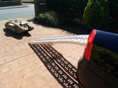

Re: Mark IV No. 35
As a last piece of testing before I take the tracks off (to find out what is binding) and secure the roof I wanted to see how the Mark IV would get along with my new ramps:-
Placement on the car seemed ok so I lined it up...
Pushed forwards and up it went!
Still got to make a support to hold it in the boot but that can wait for now. Onwards to October
