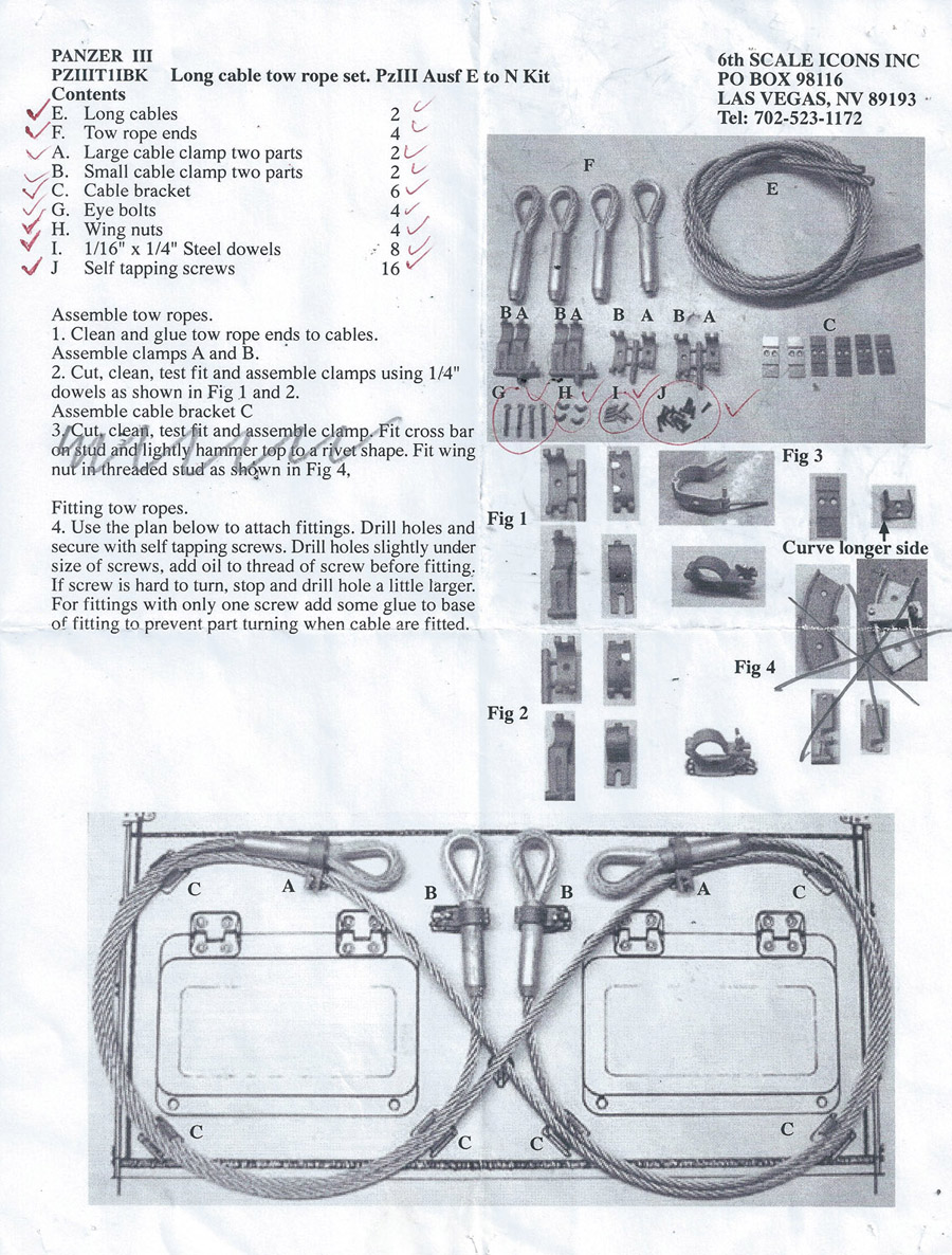

hello , can anyone tell me where I can find a drawing of how the tow ropes are
stowed on the rear deck of the the panzer 111

Hi David,
Here's a copy of the late Mike Stannard page on his Panzer III Tools and Accessories, showing the arrangement of the Long cable tow rope set for the rear of PzIII Ausf E to N kit.
Hope this helps you out!

Hi Ian, Adrian thanks for that,
