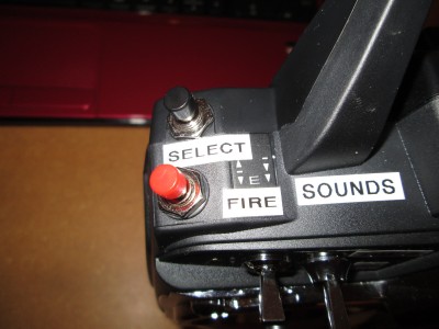

Hi all,
I seem to have got things working OK so far but I am thinking about modifying the transmitter controls to make sound selection a bit easier.
My idea is to replace the double throw toggle switch with either a similar switch but momentary operation so that it returns to centre making the stick waggling easier, or to remove the toggle switch altogether and replace it with two push to make button switches so that the rear one is pressed the right number of times to select the sound option and the front one is used as a "fire" switch to activate the selected sound.
If anyone has any thoughts on this or any tips on changing toggle switches then let me know as I want to start butchering soon lol. I told you I was not electronics whiz.

Hi all,
I have made the modification to the Futaba radio control unit for controlling the sound card.
I replaced the single toggle switch with two push button switches, one of which selects the sound to be generated and one of which activates it.
Quite a simple table top mod with minimal stress on a hobby level electronics pudding like me. It operates really well, with a few easily counted clicks of the black button to select the sound and then a single press of the red Fire button to activate the sound. Its an easier way of modifying the controls compared to new encoders and multiple button boxes which I am just not competent enough to attempt yet.
Ciao for now, Mick
