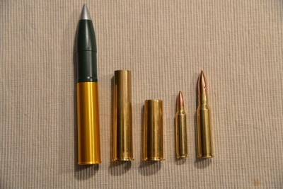

I have made some progress in the search for ammo for the 25 pounder.
There were several options but the .577 Nitro Express Casing came closest. It has a rim and is slightly tapered. I found a box with 20 empty shells to play with.
First photo shows a real 25 pdr. casing with directly below the Cyber Hobby US 105mm round, the cut down .577 casing (+ full size casing), a 7.62x54 Russian round and the current service 5.56mm round.

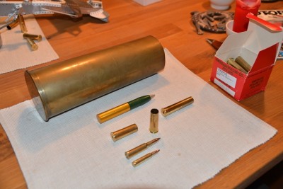

Another line-up showing the size of the .557 NE casing!! It is big! The .577 NE is used in real life as a big game round. The pic also shows that the 7.62 Russian is way to small.
