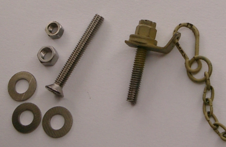

The tab consisted of a 3mm steel plate bended 60 degrees at front so the carabiner hook was able to go free for the triangular shaped front plate upper edge.
(that edge is later something in need for a makeover at least on my 2006 edition Panther)
Please note that years of wear and tear on the Houffalize Panther have flattened out the steel plate.
Also note the curved front end and that the rear end was square and not curved as the drawing in Panzer Tracts 5-156 show.
Another photo, this time the Bovington Ausf G:
A castle nut with 3 spacers bolted this item to the hull so no welds here.
I used a M2,5 screw and made the castle nut from a 2,5 high nut that I reduced I height and made 6 slots in. Silver solder it to the M2,5 screw
Add a M3 high nut and 3 M3 spacers I reduced the wide in to 7mm, all bolted to the plate made of a brass strip.

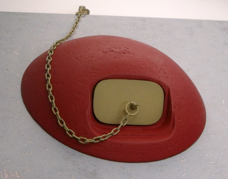

I made the cover out of brass, silver solder together.
A lot of trial and error before I had a working one that fitted my customized MG ball mount.
The rubber gasket with its flat edge I made out of the rubber from wind shield wiper glued in place at the cover.
The chain I stripped from a model tugboat I made in the 1980-ties.
Who I got the chain from back then I don’t remember but it is a perfect match.
I have enough chain to fill my Panther as it is all over her in different places, also used it on the round engine hatch seen in an earlier chapter in this saga.
This is how everything turned out in the end, painted and with a minor weathering.
Hanging loose:
(Please note that the chain will be adjusted in length when the front plate upper edge is taken care off later on)
And fitted:
Hanging loose:
And fitted:

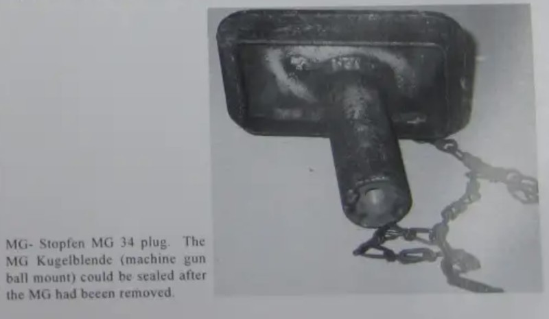

Good to see you back in action again and it´s an interesting topic too. I´ve researched this too (of course) and came to the following details, which differ slightly from your details;
The rubber is round and I think I see that in your Panther photo, this one;
but I also found an original MG ball plug with the rubber intact and not touched by any
restorers and it´s round;
Also the reason for the hole in the middle (threaded 10 mm) is for a threaded axle to be inserted from the inside to hold the plug tight and firm against the MG mount, see this photo from the Ft Knox Tiger II which I took in the early 90`s;
Maybe to late for you to change things but interesting perhaps just the same.

Very, very interesting Per!
Yes your photo of the real thing show without doubt the rubber was rounded.
Will change my at once, thanks.
Suspected that the hole was there for a reason, now we know what for.
Thanks again Per, the forum at its best.

The Per photos above really got me going...
The round rubber was easy, just a 17x22mm O-ring, piece of cake.
One thing I missed was that the cover pin was not only off centre vertically but also horizontally:
Took this opportunity and change the pin into the more accurate 6,3mm diameter.
Also did I change the loop as I had made it far to thin.
Now it look like this:
Much better!
