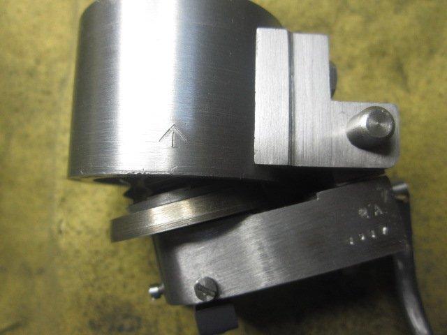

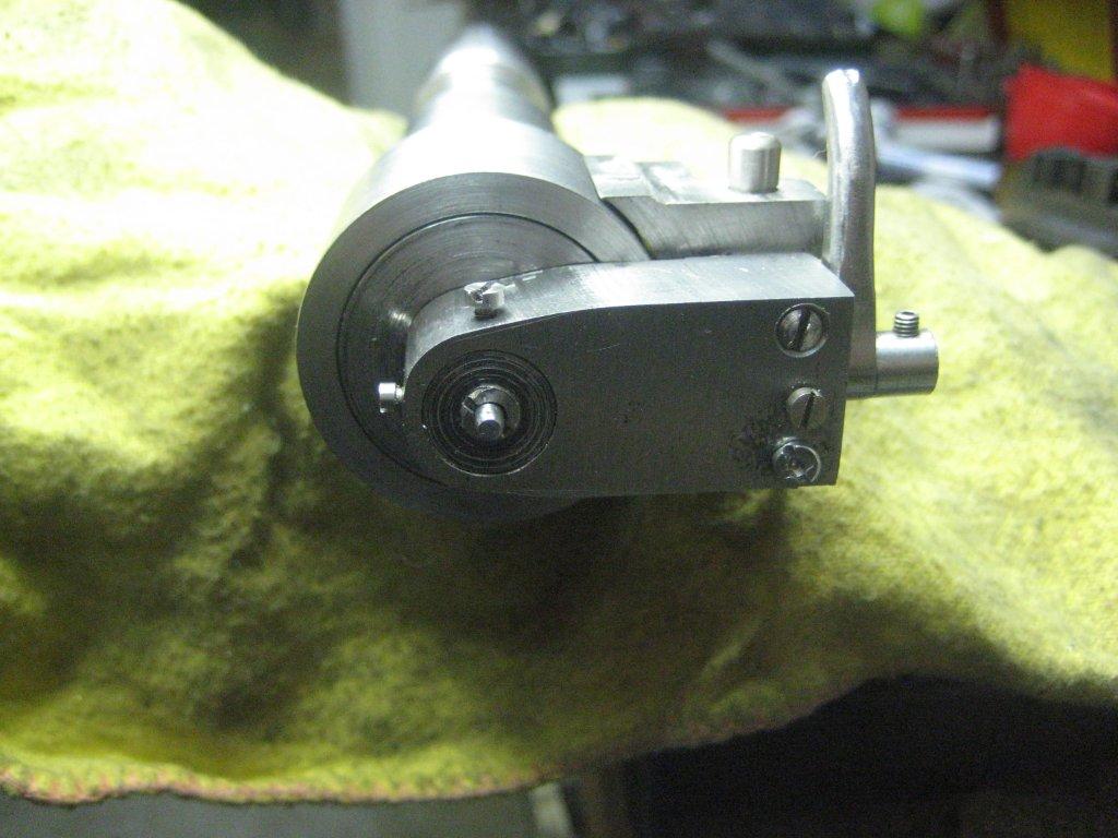

My next project has been comissioned and the very first part has been made.
Scale 1/13 :D

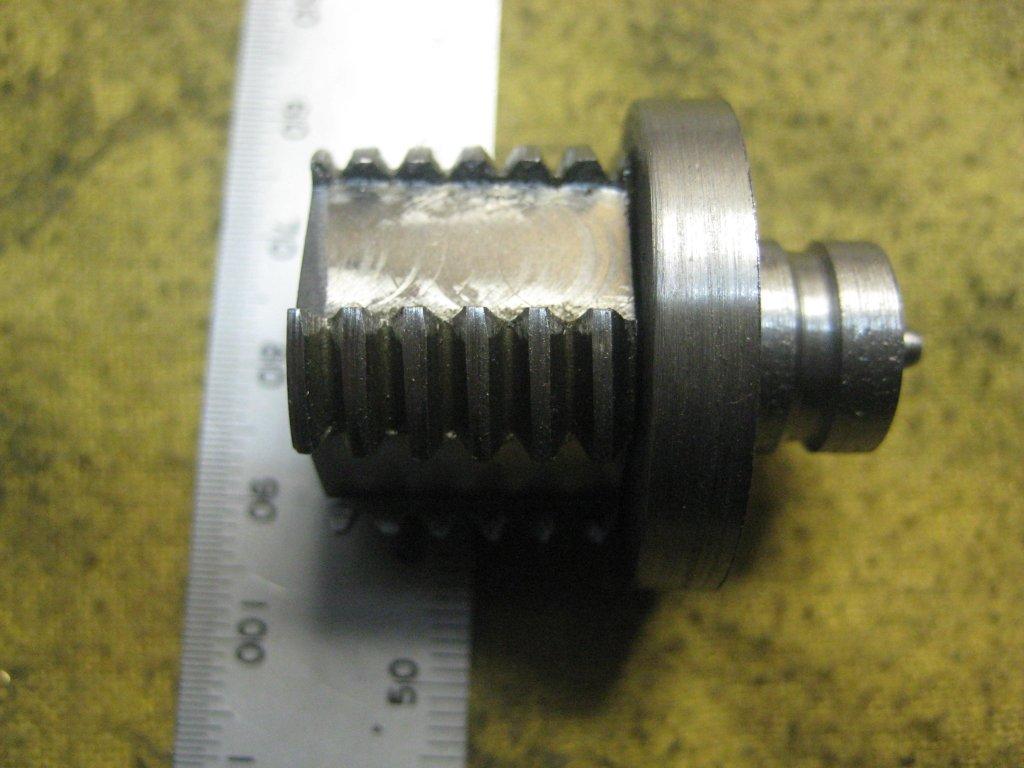

Looks like a breech of some sort... :?:
Bob Gould
Posts: 495
Been liked: 31 times
Re: What Part?
Post by Bob Gould »

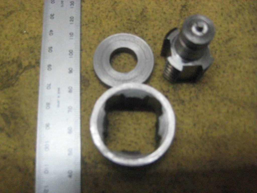

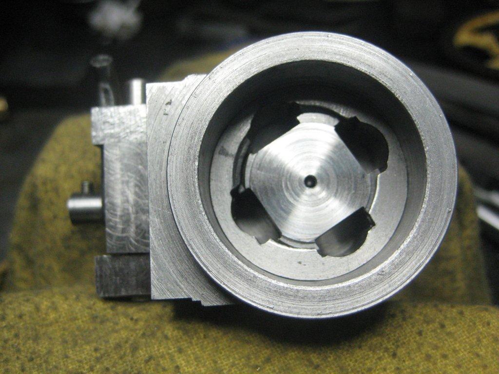

Correct. Had to be remade with 8 segments tho to achieve a 45 deg turn to lock/unlock
new breech + housing

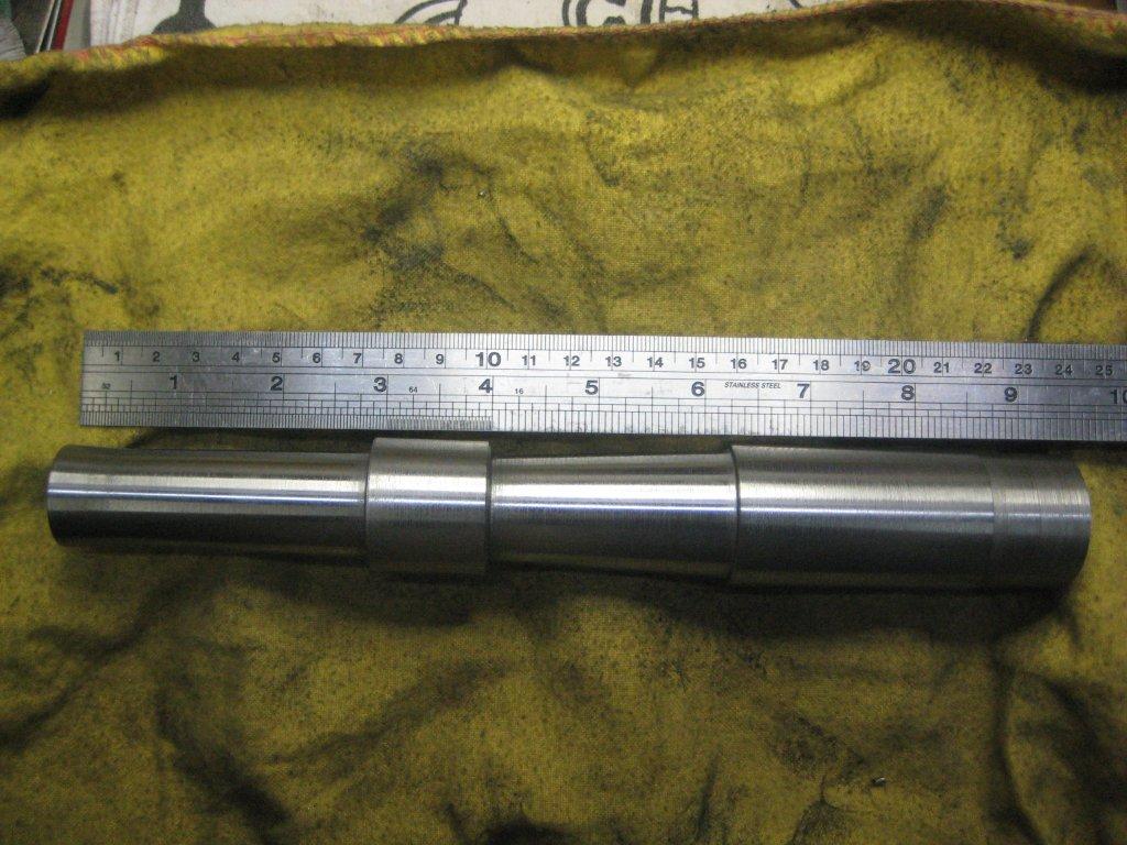

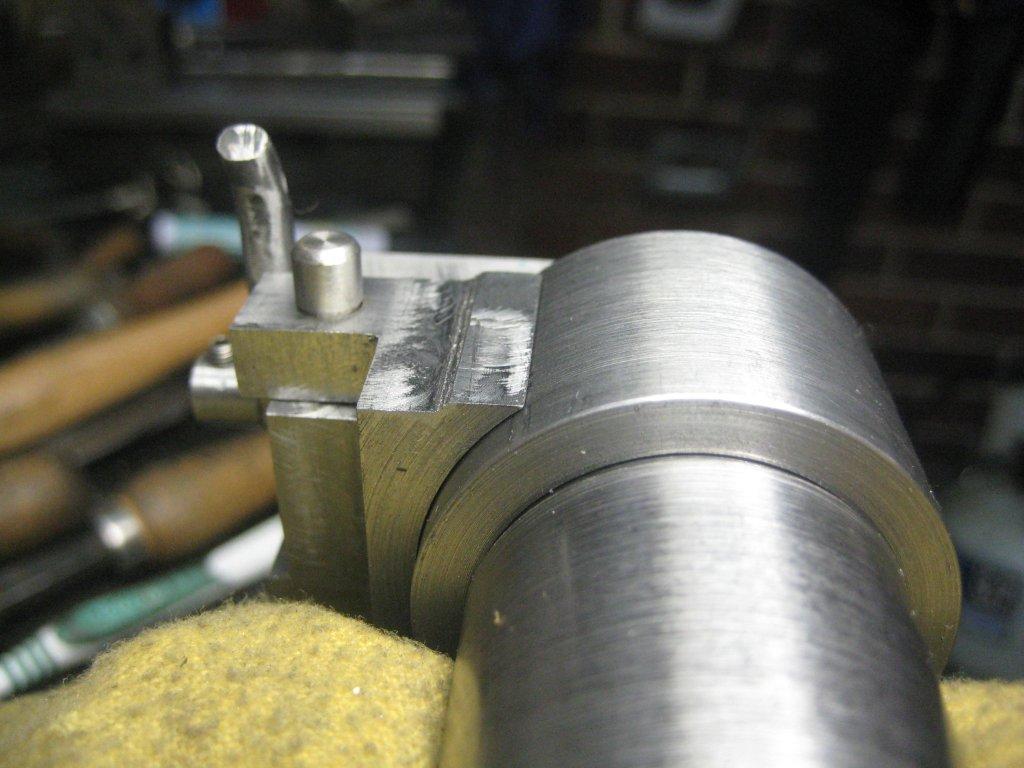

Barrel: hot off the lathe

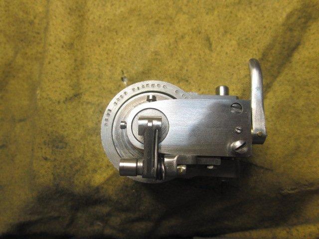

a fully functional breech. Handle down unscrews and opens, handle up close and locks. Just needs tyding up

i know its not "tank" but i like to share it anyway. :D
