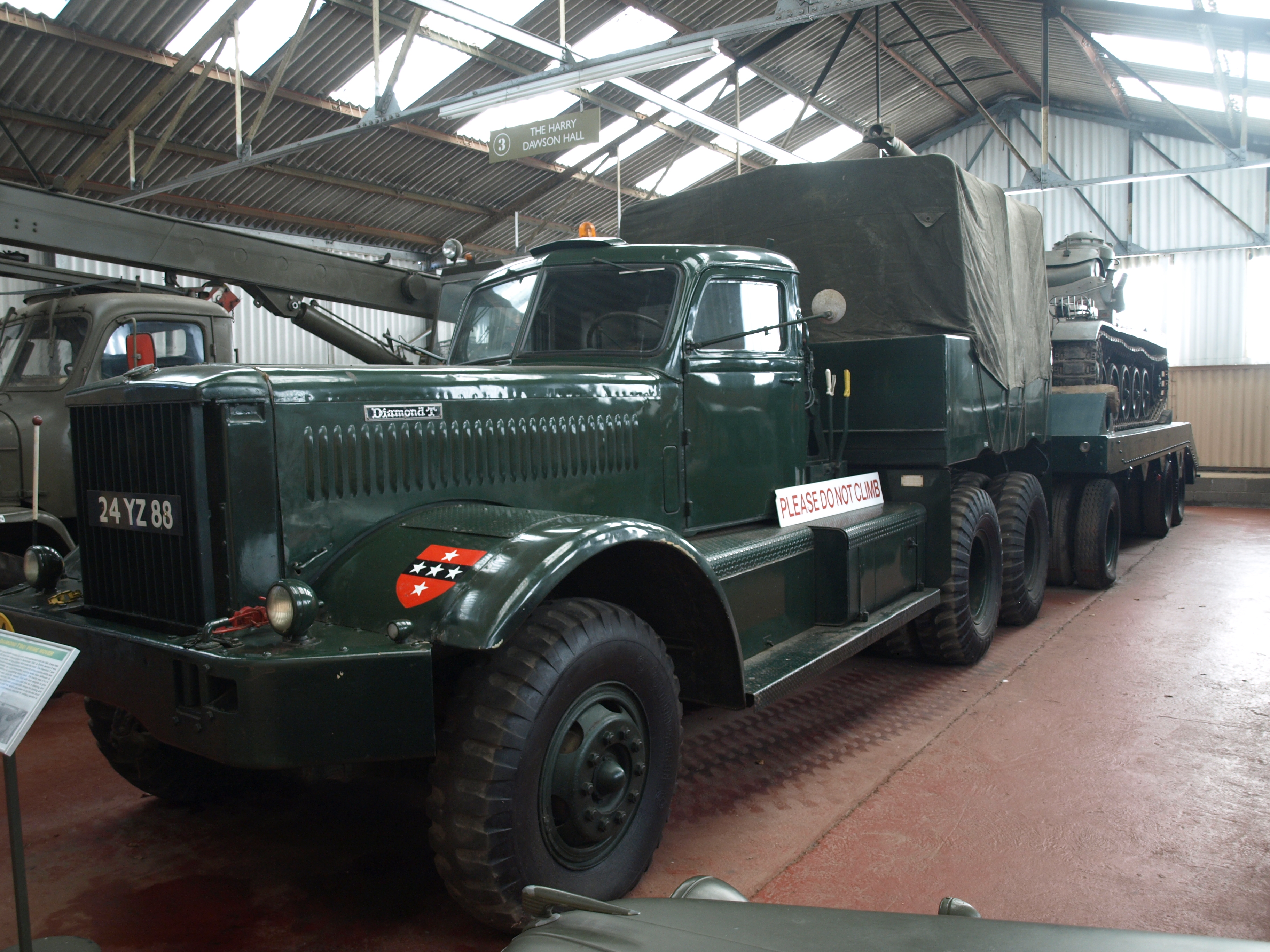

At half term we went for a trip up to Norfolk and took in the Muckleburgh Collection and was pleased to find that they have a big version there!
This not perhaps the correct location, but there was a Centurion tucked away in a corner as well.
Steve-
