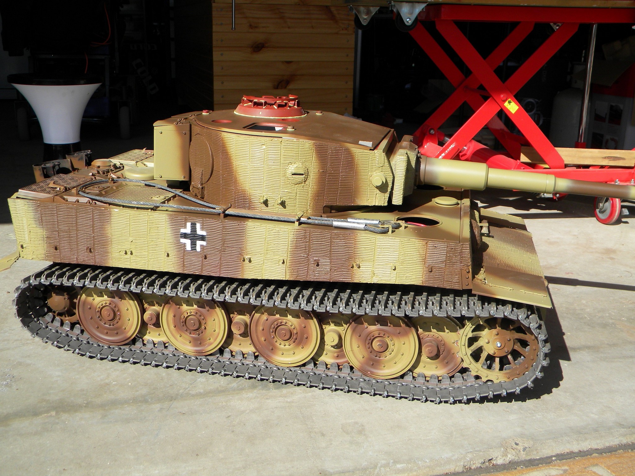

G'day Jason,
It dries rock hard & is a bugger to get off if you stuff it. It can chip if knocked with something hard but general handling it is robust.

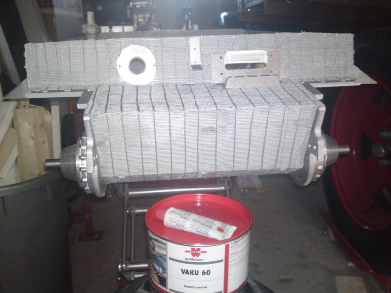

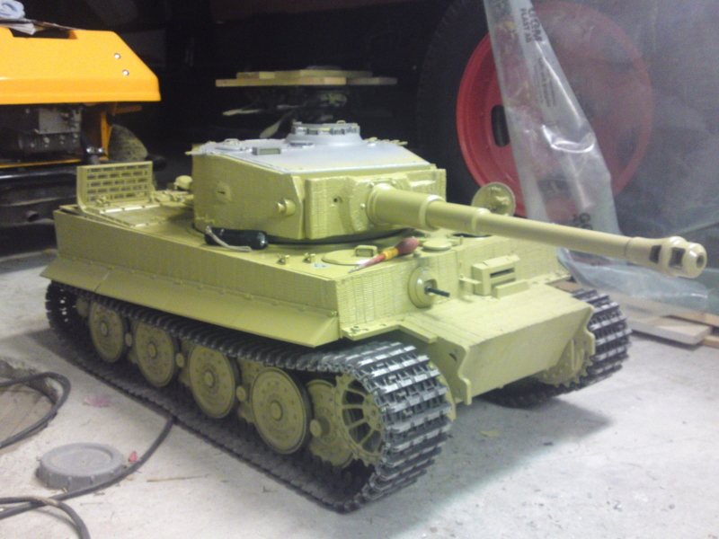

Hello!
I see that it is moving forward even for you. I also have a Tiger 1 late production
2012-020 that gives me much pleasure.
There are many ways to do zimmerit. I myself have been using Wurth Vaku 60 metal spatula.
it is placed directly on bare metal and is then very hard.

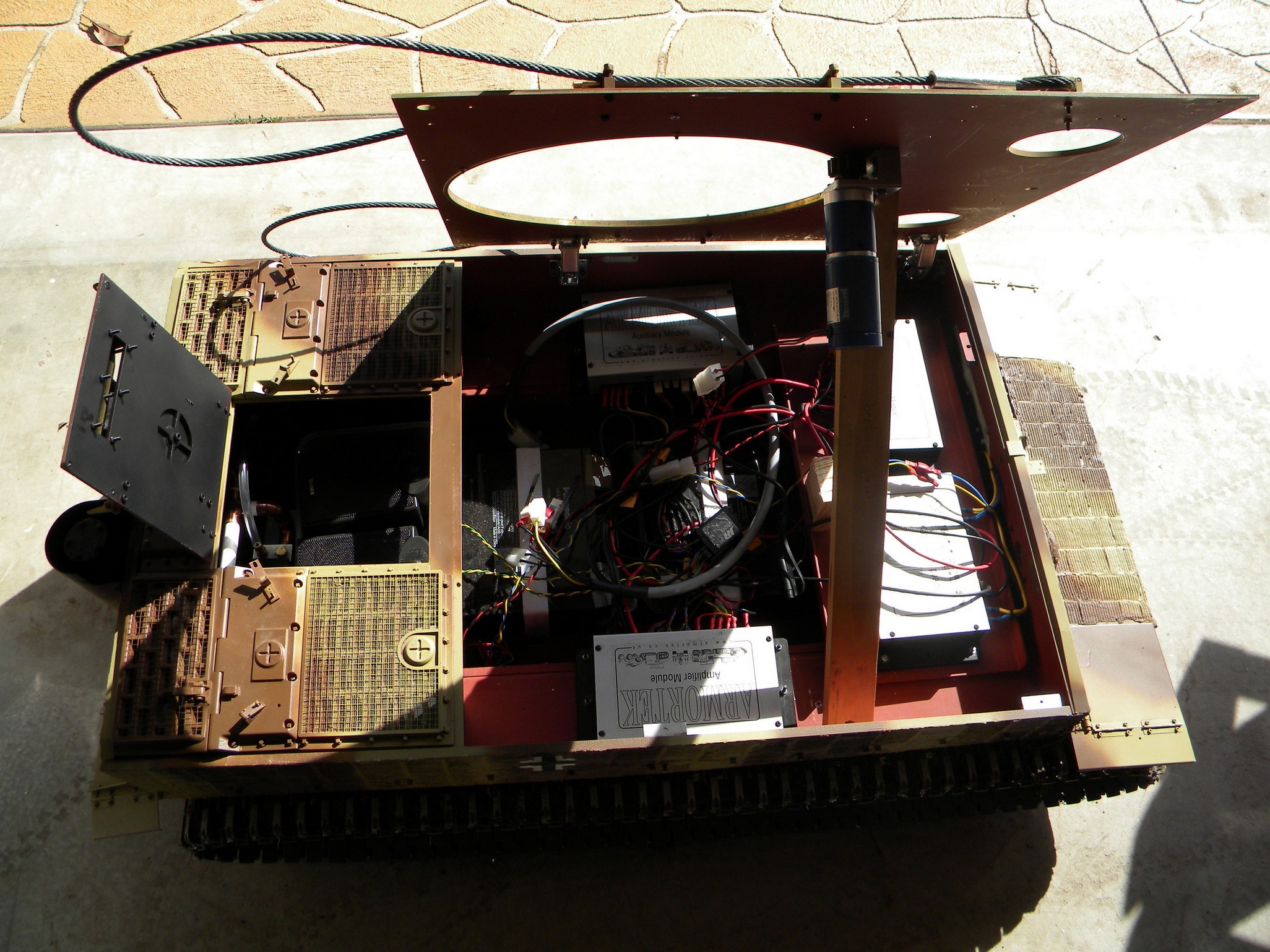

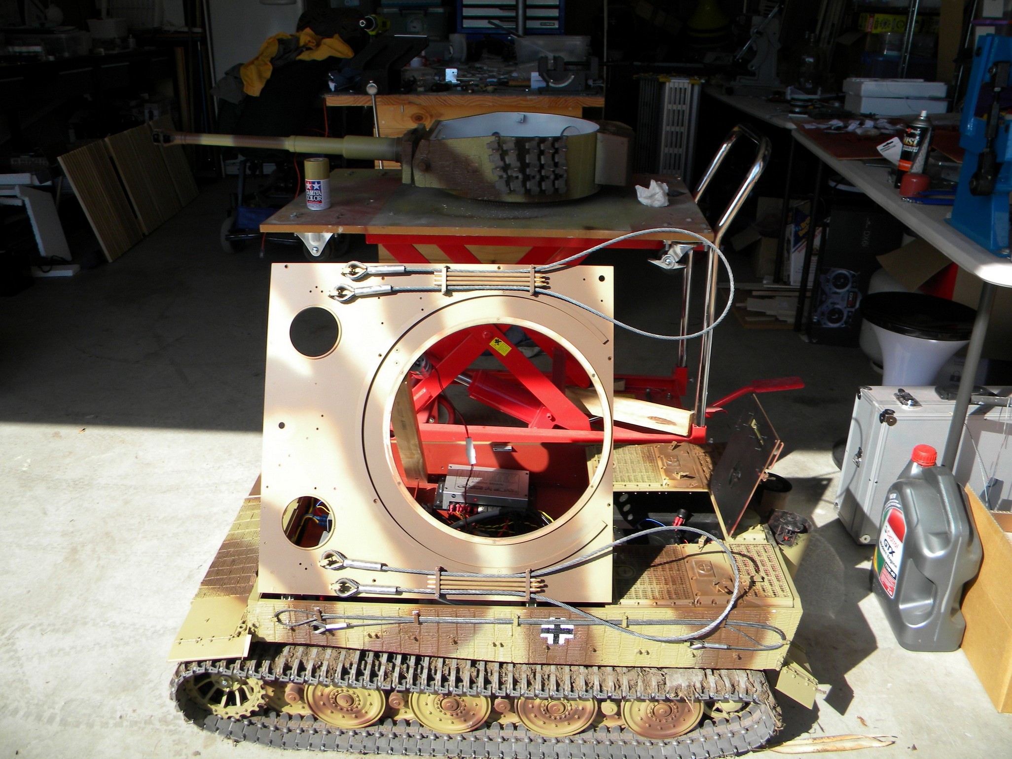

Hi Ray.
Your Tiger looks great in your Zim and camo,
nice pictures and I like the hinged deck and your controls layout.
Their has been a few posted now,so I have plenty of options
when i get to installing mine.

Re: new tiger
Nice camo and zimmerit. Great access also. Well done.

Thanks guys. I think the more that post the more people see the various options that can be combined. The hinging of the deck has greatly assisted the conundrum of where to place pieces when working inside the vehicle.
If my layout is replicated by others then I feel I have given help to others as a return of help given to me.
Ray
Ray

Hi Ray,
Your Tiger is getting more spectacular!
I like the cabinet hinged deck idea. It looks the cabniet hinge used are different from the common types (which can't be used on thin plate such as the tank's deck and side panel)found in hardwares shop. Where can it be found?
Cheers,
Lerh Chang
Cheers,
Lerh Chang

Re: new tiger
g'day cheng. at bunnings. i'll bring one if you're going to fairfield train tracks on 2 Dec.
ray
