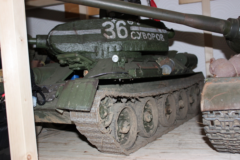

Re: T-34/76 Road Height
Hello Bill,
I used shorter springs to get the T34 down. I have testet the model and the suspension is working very well. It is still a little bit to high, but looks much better. Now it is also easy to mount the tracks.
Günter
Günter
