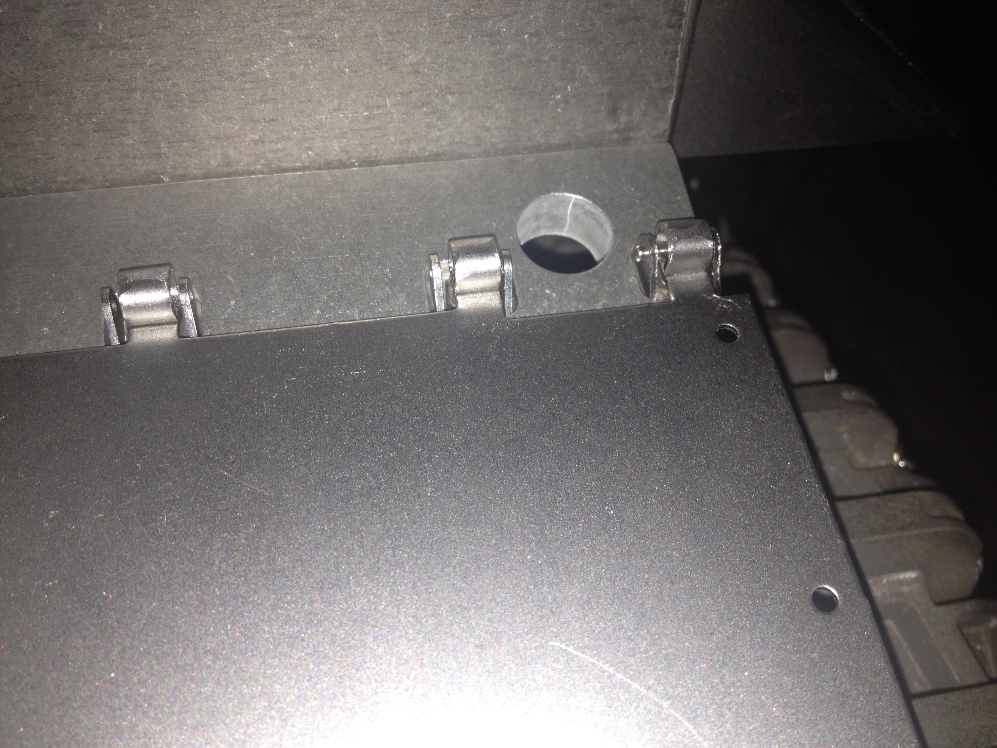

Ok New Question
The front mud guards wont move when the pin are inserted. I tried filing both the inside and outside of the loop but still not enough room to move freely. Any ideas on what im doing wrong

G'day Steve, I had the same problem. I drilled the hinge holes out from 2mm to 2.5mm and used a m2.5 button head & nut.
http://www.armortek.co.uk/Forum3b/viewt ... 6&start=45
Works fine for me.
Ray
Works fine for me.
Ray
Re: Tiger 1 Side Guard fasteners question
I used countersunk instead of hex bolt underneath for better clearence. Then it worked fine without drilling.

G'day again. I had trouble with the pins fitting. So I just drilled to save time & frustration.
Ray
