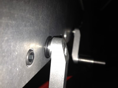

I am now installing the torsion bars and suspension arms but the "O" Ring isn't fitting snug with the arm to the body.
Do i need to fit the arm in closer or screw the arm on the axle further? Feels like the arm is screwed on all the way.
Ok what am i doing Wrong?

The o-ring is sandwiched between side plate and hull bar and fits into a recess.

Just press into recess between. Put some silicone grease on them first.
