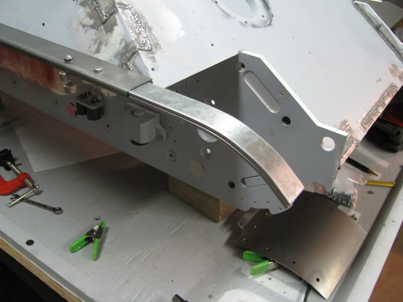

Decided to add a little extra support for the front fenders. Image Image

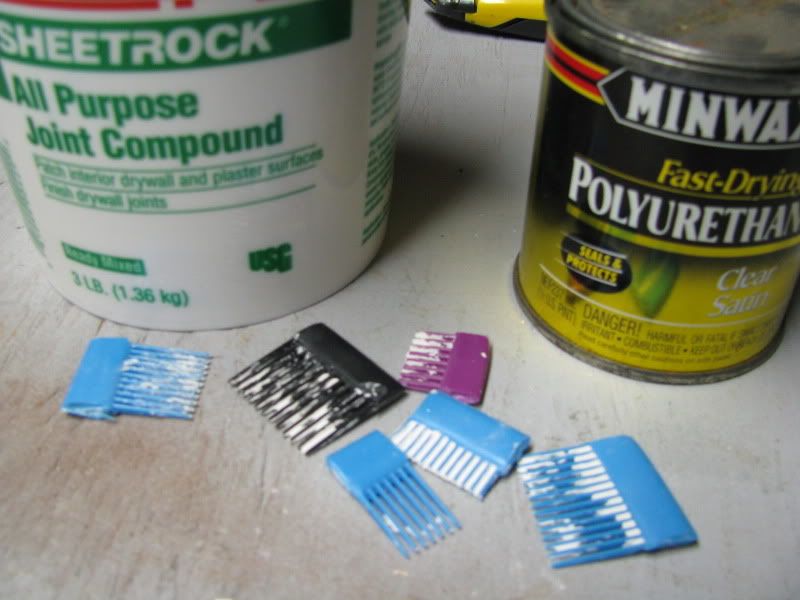

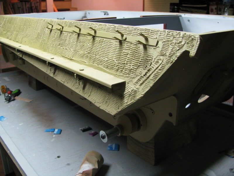

Thought i'd try my hand at applying zimmerit which was a little more difficult than I anticipated.

That must have taken an age :shock:
Looks good though :D
Which product did you use - the colour looks like Milliput to me :?:

I used the same stuff Tim Bowman used on his tanks-drywall mud ,its cheap and easy to work with.After drying I covered it with some polyurethane which gives it a rock hard finnish. Image

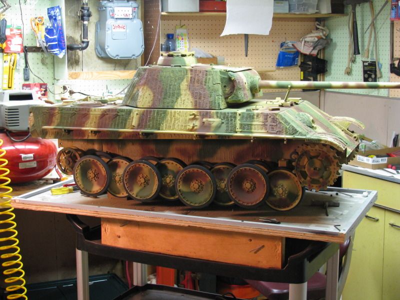

Finally got to try out my new airbrushImageImage

Nice job! Your Panther looks really good. I like the camo and coloring. you must be really happy with it.
