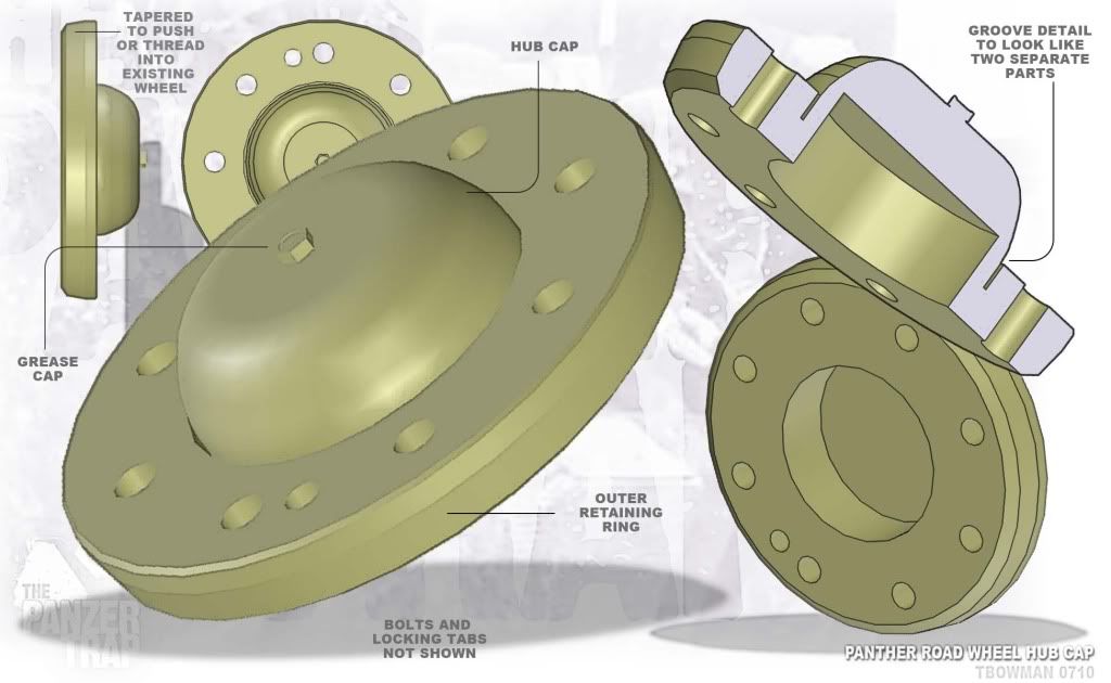

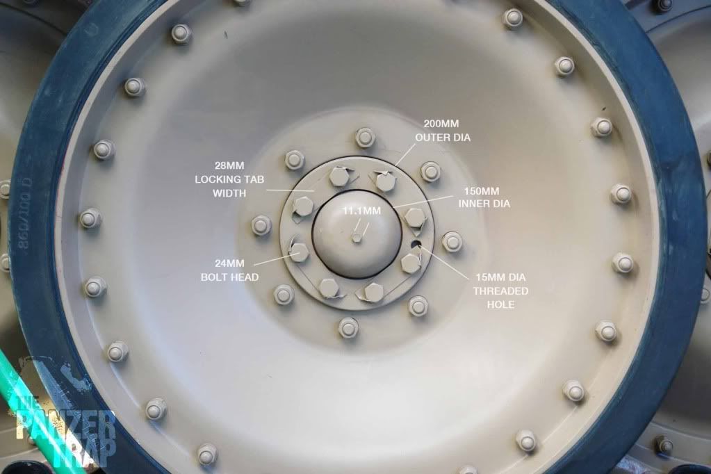

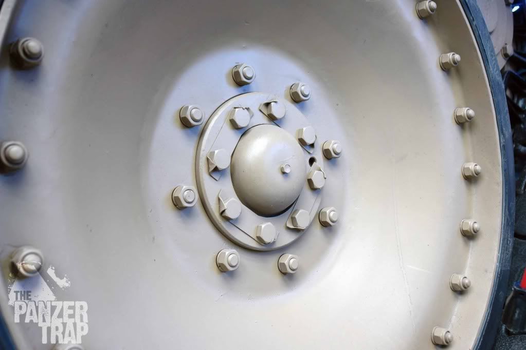

Hi Kent
Over a year ago, I created them in 3D based off measurements I took from the Littlefield Panther but there was no interest in them. Could have them made without too much trouble. I am in the process of gathering many of my Panzer IV, Panther and Tiger parts together for use as possible masters for metal castings. Perhaps these could be included on the list?
here's the series of photos and measurements I took at the time

Hi Tim,
Oh yes I remember that drawing of yours.
That is how I would like them to look like spot on.
That groove and accurate height makes a huge difference.
IMHO those caps make the Panther wheels and at least for me are well spending work hours and money to achieve.
I believe the discussion regarding them halted as the ultimate Panther kit was released and a promises to
make better hub caps.
Well the hub caps do look better this time and now I only have to decide what way to go to have a set of perfect looking ones.
Tim if you can make them for maximum £10 / hub cap in any material fully functional and well fitted to the wheels I am in.
That would save me a lot of time better spent on other things.
