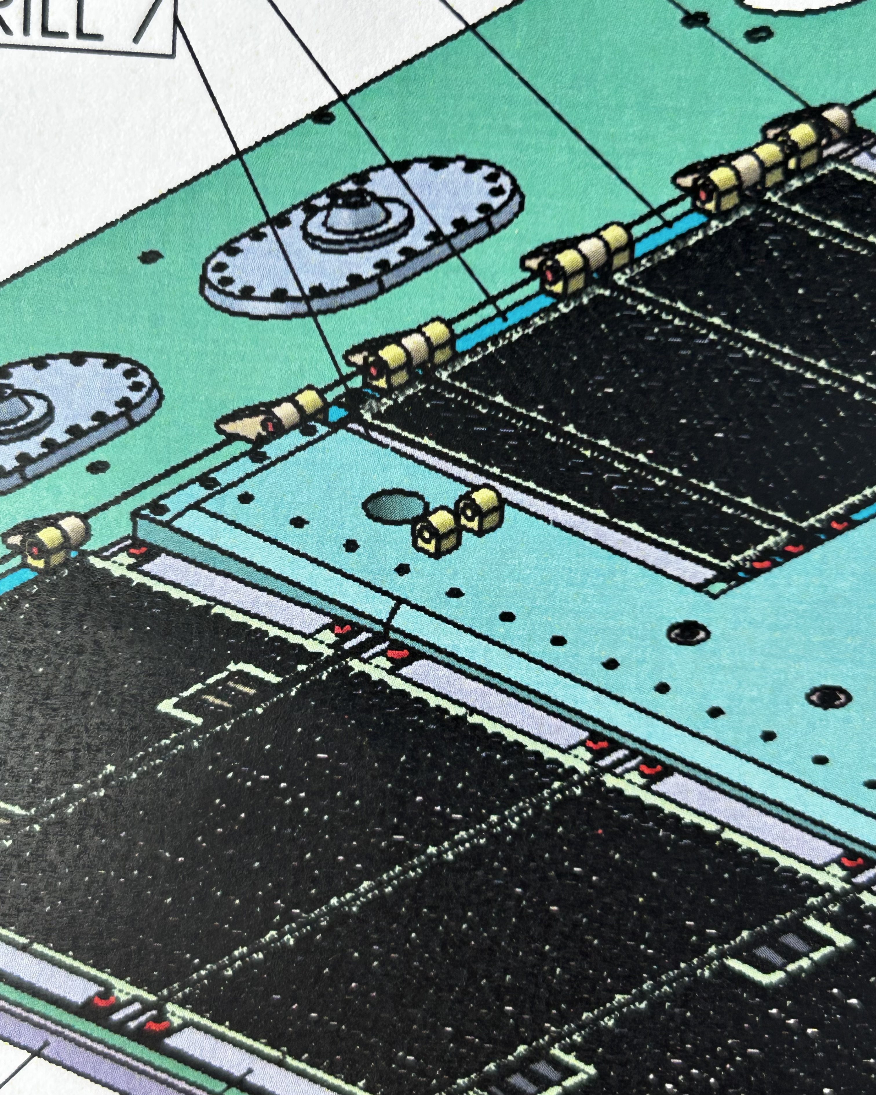

Me again. Need your help. I have made the rear engine vents but can’t find out which button head bold I should be using. The only bold reference I can find in the manual is a M2.5 x 5 button. But this is not long enough to go through the mesh vent and bace plate and fit a nut onto the thread.
It’s the two centre rear vents I am fitting.

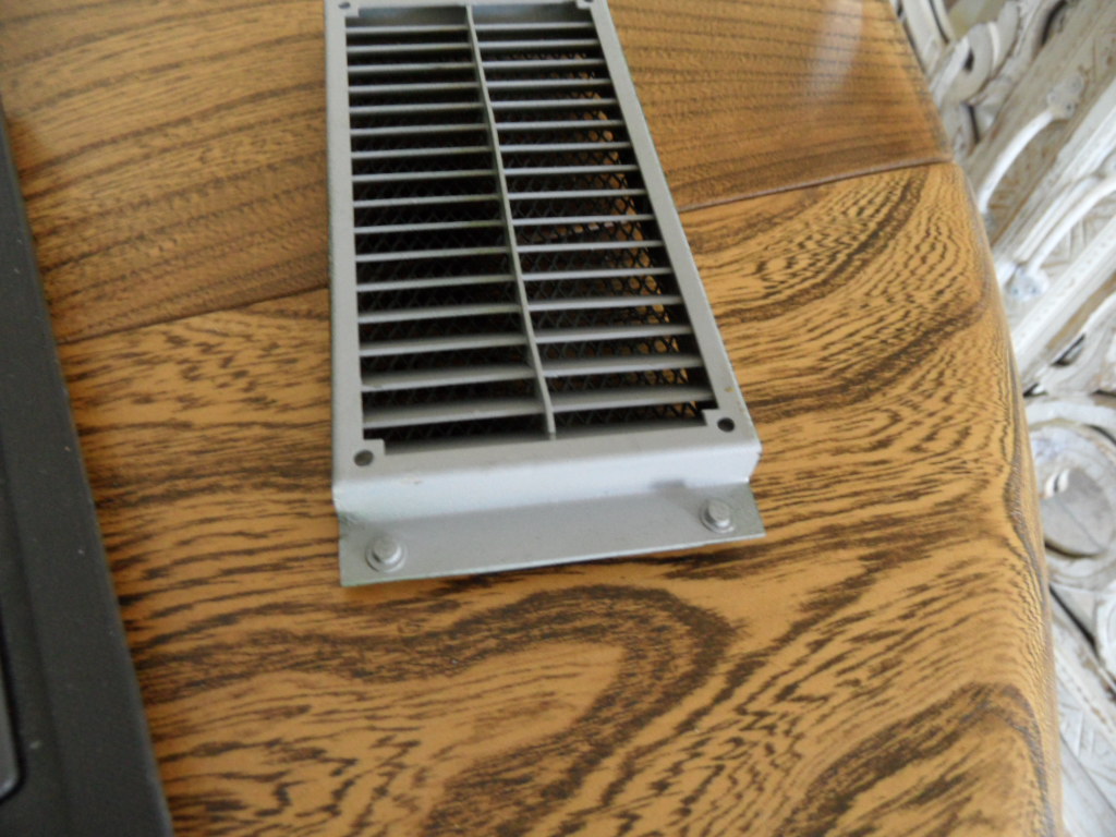

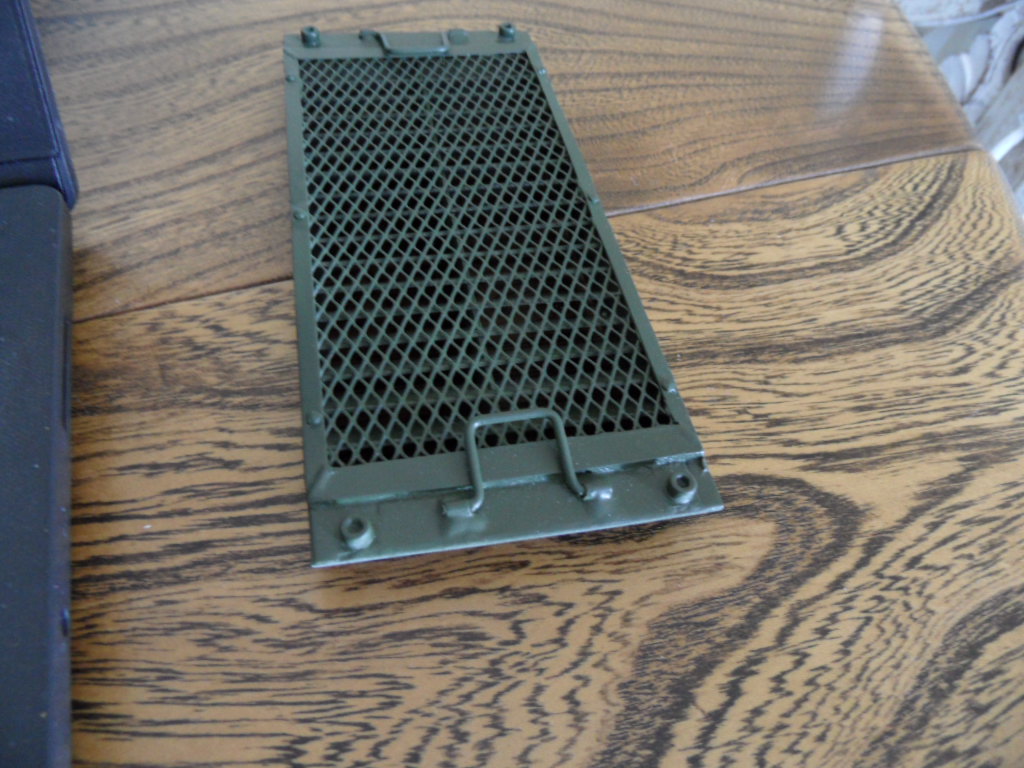

I used cheese head 2.5mm and rounded off the nuts so that they slip in and out easily of the cut hull holes. The actual tank uses cheese heads, so I thought why not. (Cheese heads being the old term for socket heads)
These grills are the main access to the control gear and smoker and I wanted them easily removed and refitted. To hold them in place I fitted magnets under the hull holes. Not that it really needed them, as they all pinched together nicely.
Save the head banging for when you try to align the grills within the T piece without the quality shut gaps you'd find on a Morris Marina.

Hi Martin, sadly no. the handles are fabricated and brass tubing soldered on to the brass frames of the grills. The mesh was cut out and replaced with finer mesh. Looking at it now the whole thing needs tidying up a bit. Which is what I find when brought out from the dimly lit garage into the sun light. The hated Dracula effect

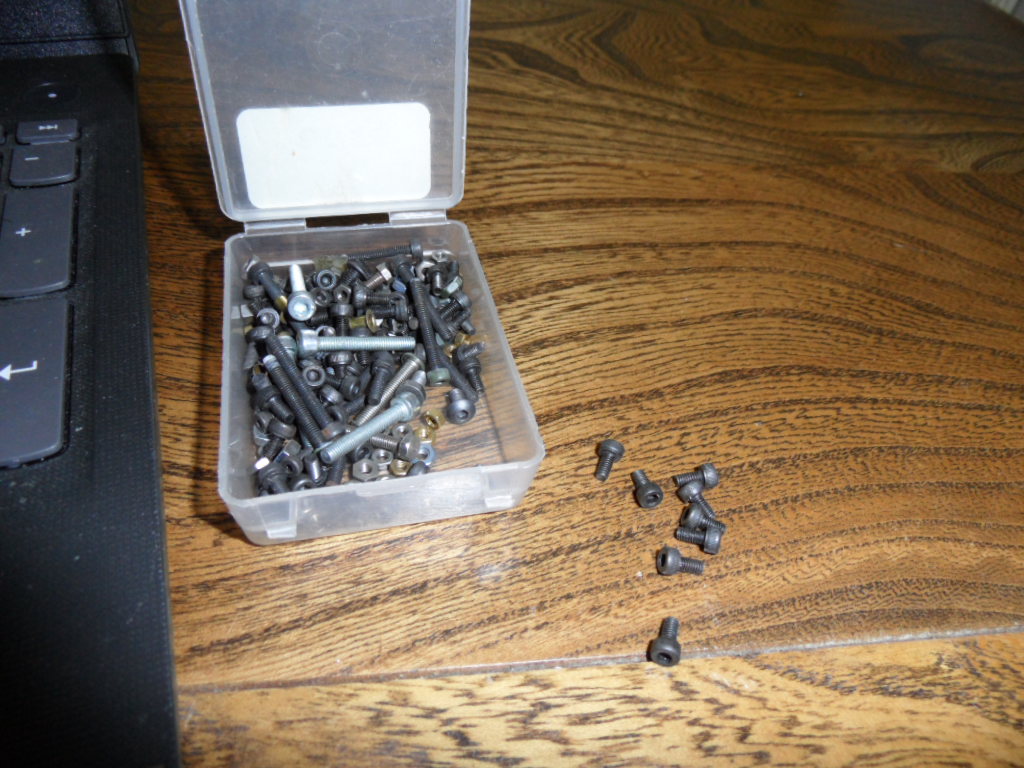

Or you could send me a stamped addressed envelope and I'll send you enough Cheese head M2.5 to do the job. see picture the M2.5 spares box.
