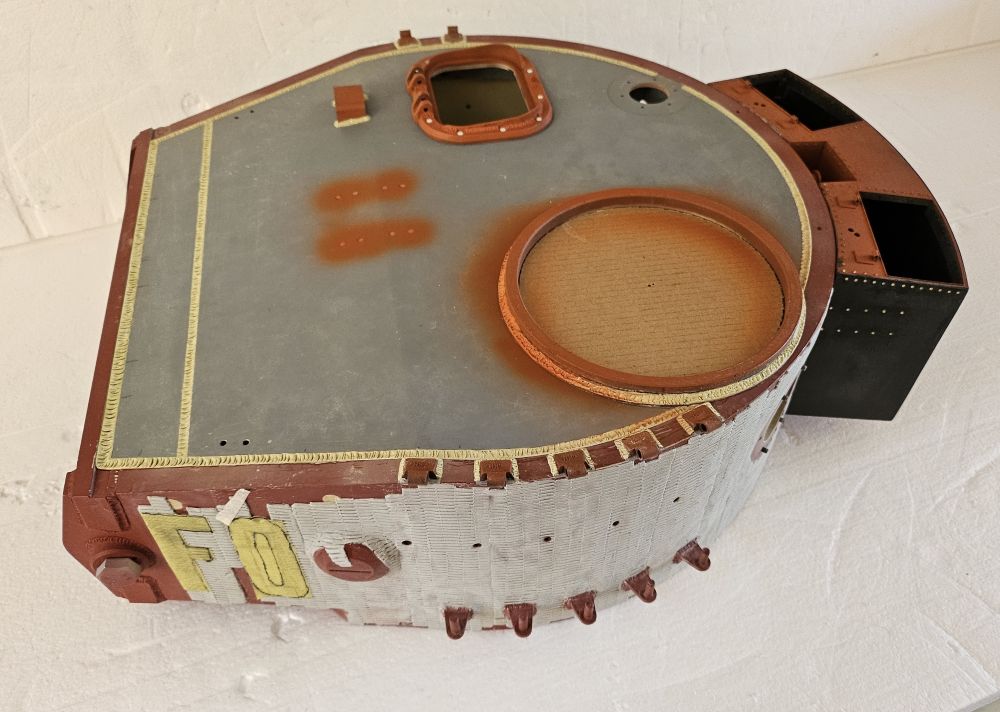

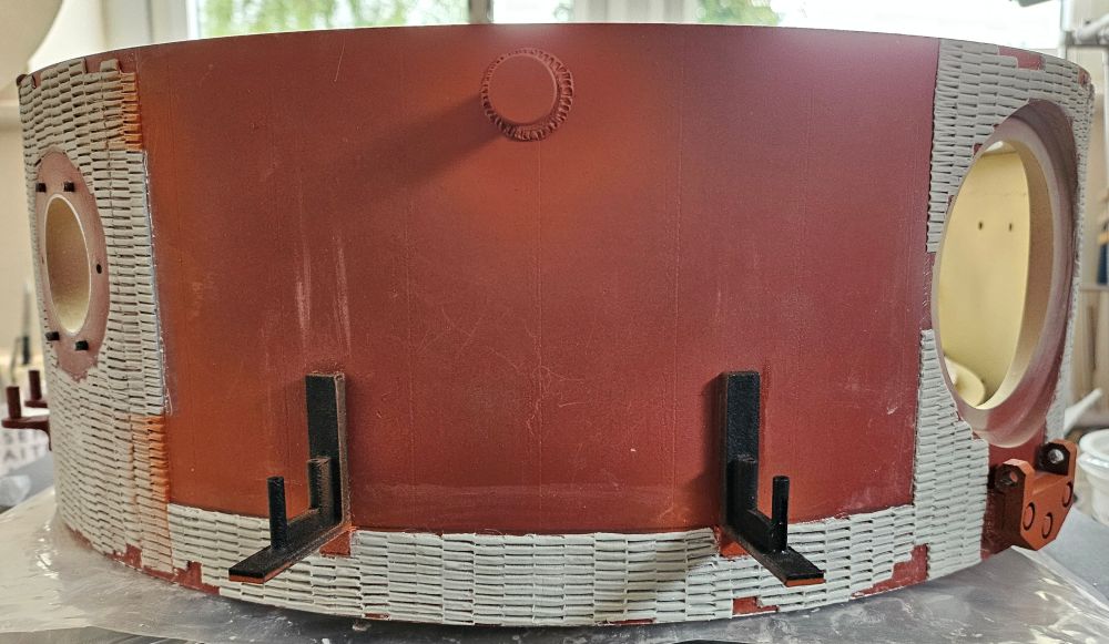

Update 13 May 25
Zimmerit complete... As I am leaving the rear of the turret uncoated I have had to wait until the turret bin was available.

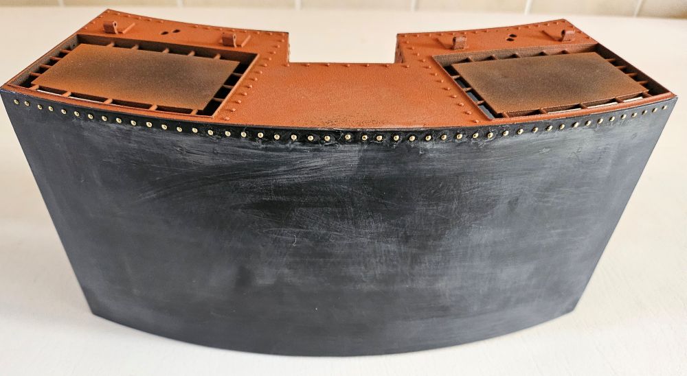

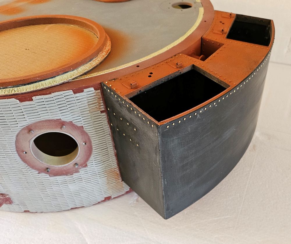

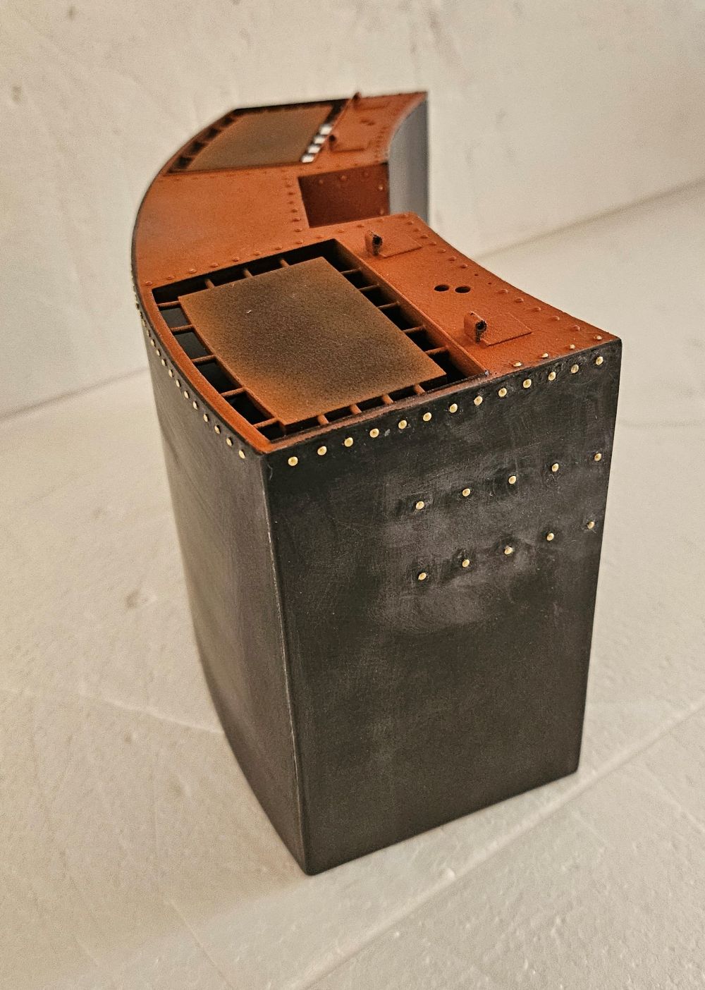

Turret bin

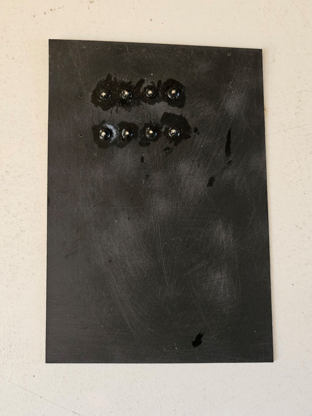

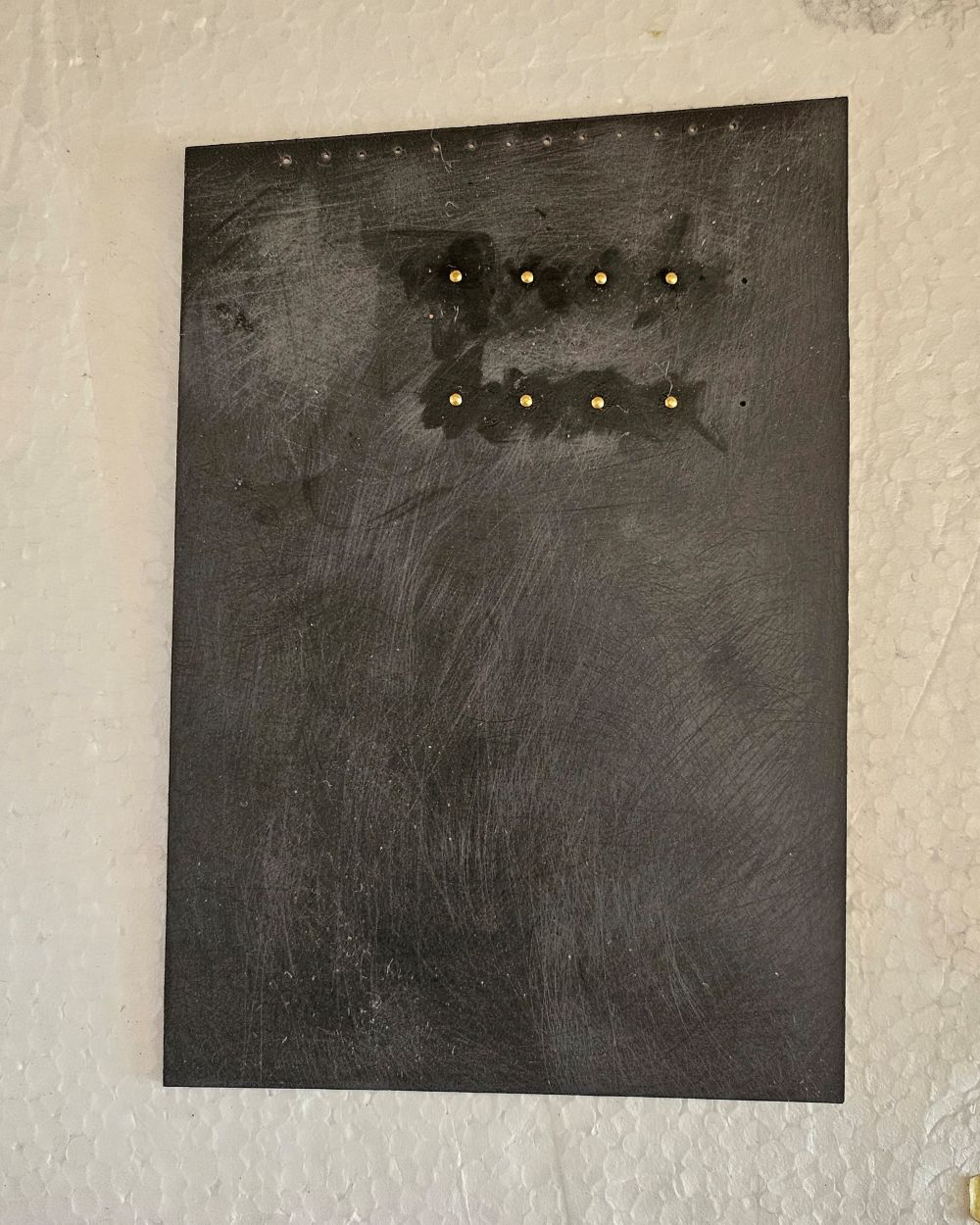

Front of turret bin detailed, ready for clean-up... I have used the sheet metal tool in Fusion 360 to unwrap the design and give me a template for the front and sides. The front was cut to size along the top and the holes for the rivets drilled to 0.8mm. Before fitting the sheet was curved by tying it to a large saucepan and pouring some boiling water over it. The bottom edge was cut to size using the rivet holes to align the piece. The sides were trimmed to size once it was glued in place with epoxy and medium CA.
Bin side cut out and drilled for rivet detail. Once again, the top edge is close to finished size and the rest is oversize. (Note: side rivet detail added with internal doublers.) The bottom and sides were trimmed with the plate in position before it was epoxied into place. Side complete, just need to do the other side.

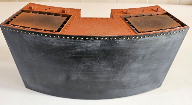

Test fit of finished bin. (Lids will be fitted later.)

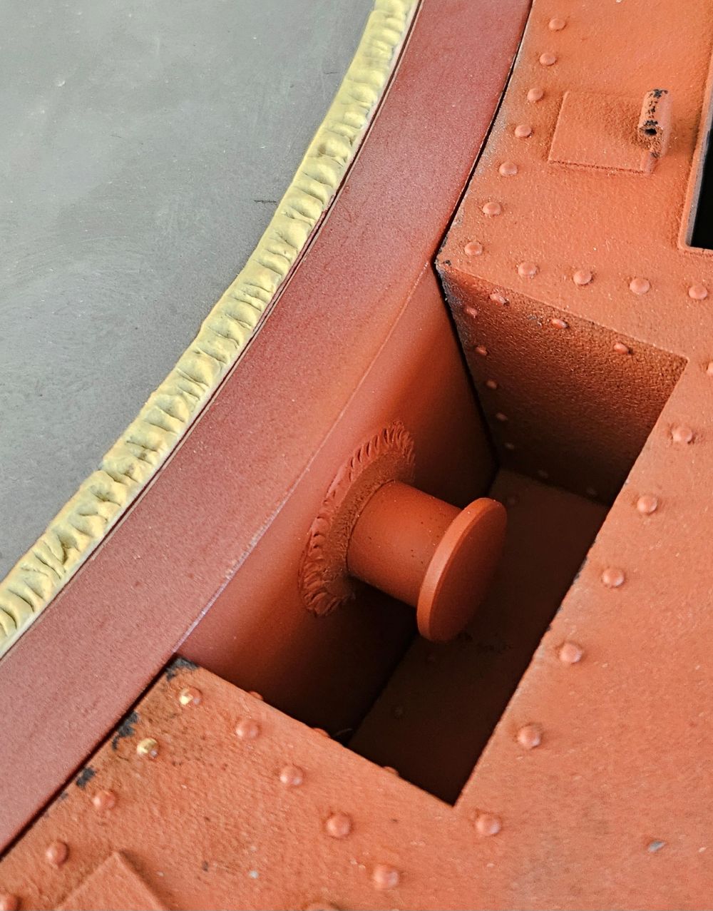

Close-up of revised rear turret lift lug… That's all for now
