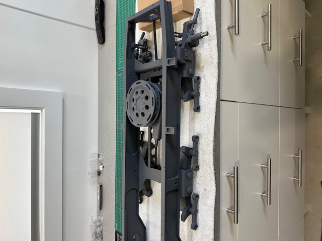

A bit more work on the chassis today suspension next . Dale

Stage 1 complete Dale

Got some more work done today on the suspension arms Dale

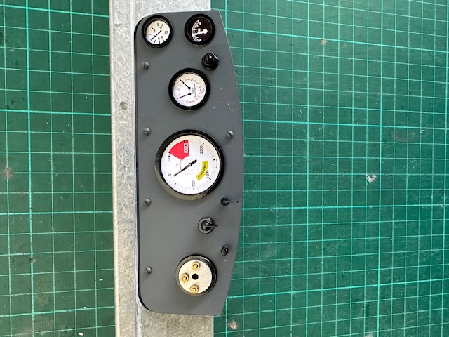

Some Dash work today . I followed the Lead of Simon and Michal wonderful builds still some more detail to add .. Dale

Re: Dale Sdkfz 7 build
Post by Derek Attree »
Hi Dale
Welcome back to 1:6 world, very impressed with your build.
I have one waiting after I finish the jagdpanther.
One question , Where did you get the dash board graffics from for the dials ? Particularly the central red and white one .
Regards Derek
Post by Dale jordan »
Hi Derek It's on the SdKfz 7 page , Gary Sullivan build , put it up 23 down from the top Paul wills put it up . Dale

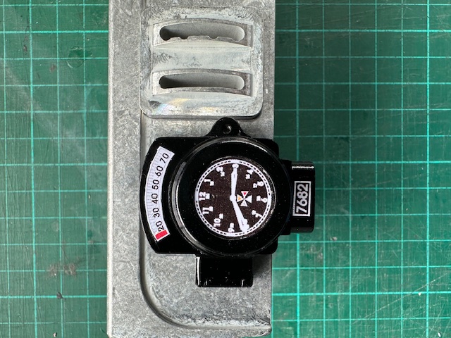

A bit more dash work .Dale
