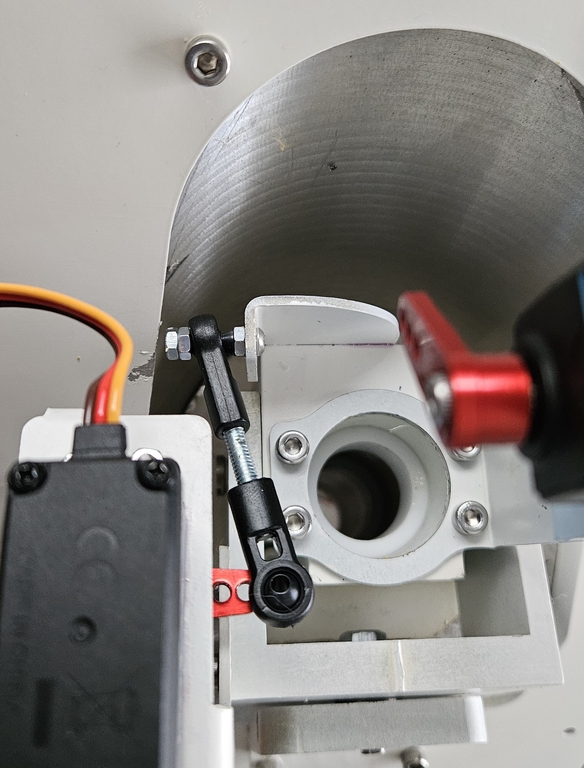

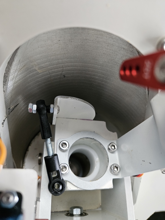

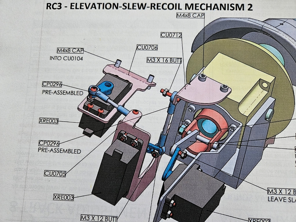

Until this point, everything was going smooth and as planed. But now I am stuck and need help from you guys:
While mounting the Recoil Option Pack, I installed all servos for the elevation and slew machanism as shown in the manual.
But somehow the gun elevation mounting point colides with the hull and seen from the front the gun could not slew and elevate much to the left (looking in driving directions).
Sure I can try to move the mounting point to the inside but maybe it collides then with the recoil mount oin the gun barrel?
Before doing try and error engineering any advice from you guys?
Malcolm.Plumb
Posts: 242
Has liked: 451 times
Been liked: 912 times
Re: once upon a time there was a Hetzer..
Post by Malcolm.Plumb »
Is it possible to turn the screw around and have the two nuts on the inside against the bracket?

good idea, maybe I will try this first. What bothers me: It looks like all other Hetzers did nor have that Issue. So I am worried I mad somewhere a big mistake.
Posts: 5119
Has liked: 1475 times
Been liked: 1674 times
Have a look at this video from Tony's Workshop - about 25 minutes in - and see if he installs it the same as yours.
It looks to me like the ball end of the adjustable rod is against the bracket in his video but you have a nut between the arm and the bracket.
