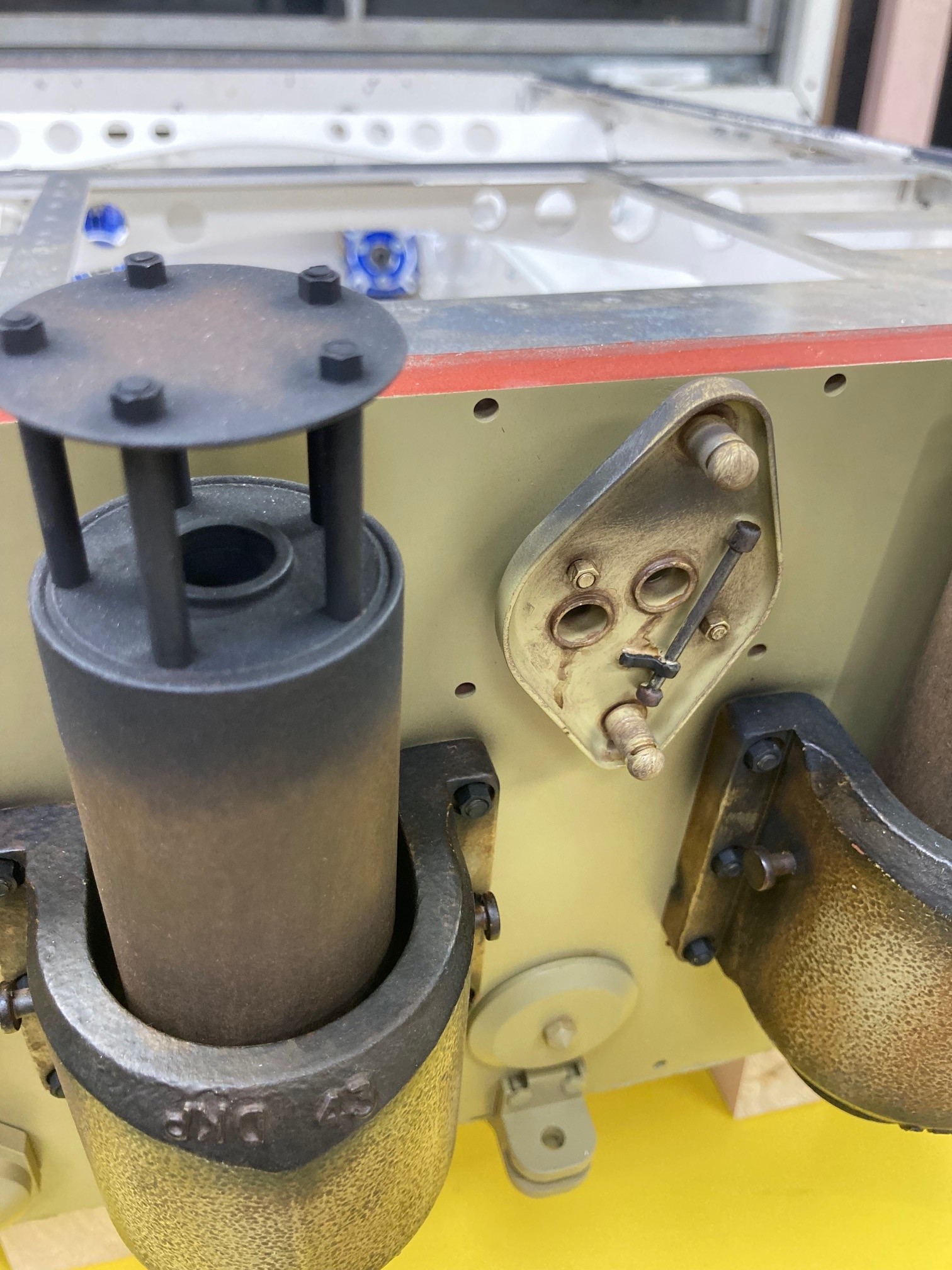

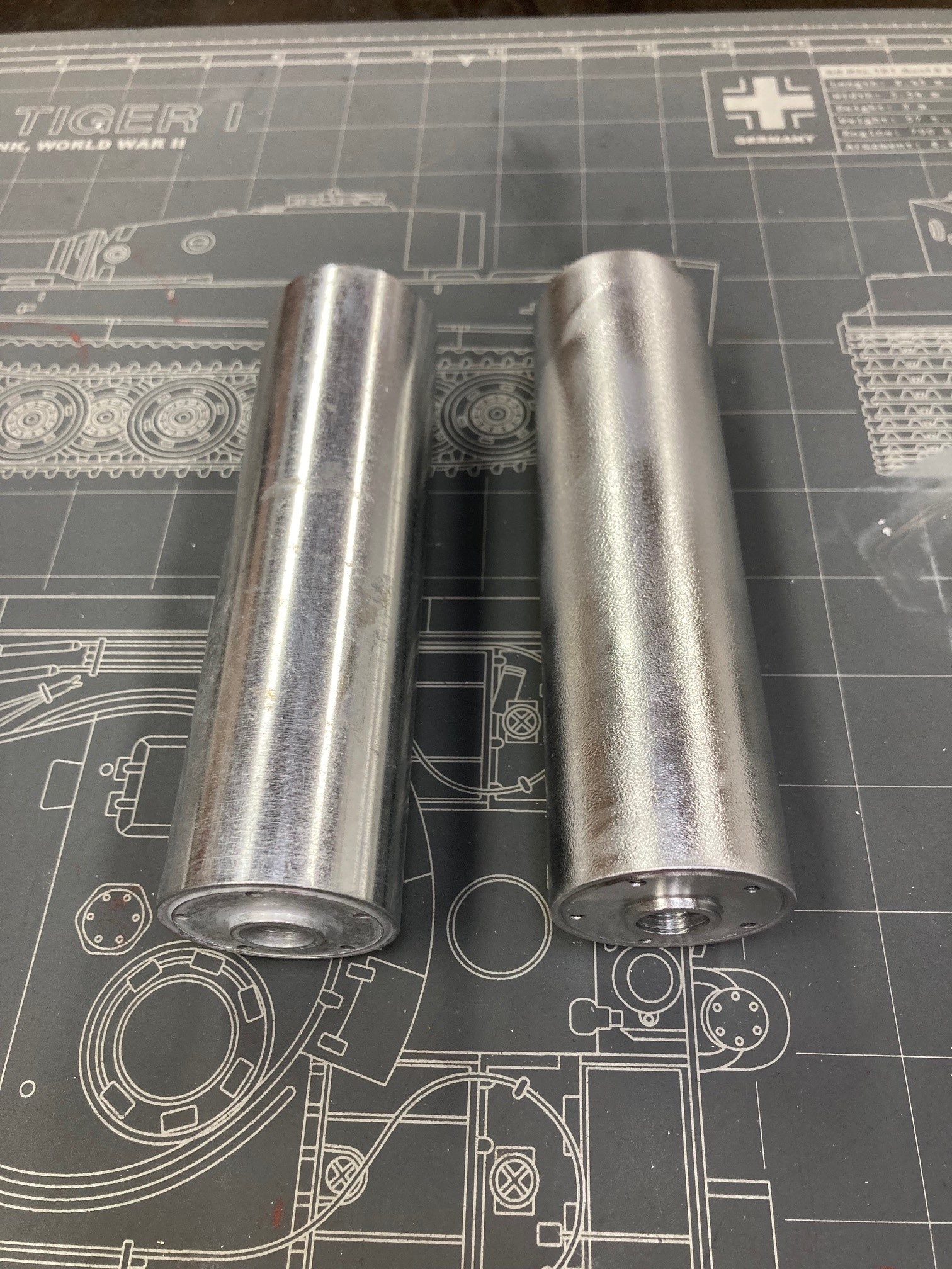

Some good progress made so far over the Christmas break. With 36' - 38'c days, high humidity, in between heavy rain days - 600mm last week :o my Air-con tank room is the best place to be. I have been working on the rear hull, exhaust stacks wire buffed & painted, tubes fitted over the studs under the rain covers. Exhaust guards machined & needle gunned for cast patina, brass cone bolt made for starter cover, starter plate modified to have a little more detail. I find myself starting to get a little impatient as I really want something to drive but on the other hand, I want more detail than a standard kit. Some things like the jack retaining clamps, folding hinges on the guards and other things, I will come back too after I have it running. I have also tried my hand at weathering but some things I might have gone too far on, but I will wait till the camo and weathering have been done on the rest of the tank before I go back and touch up. Next onto the top deck. Happy New Year to all!!! :D

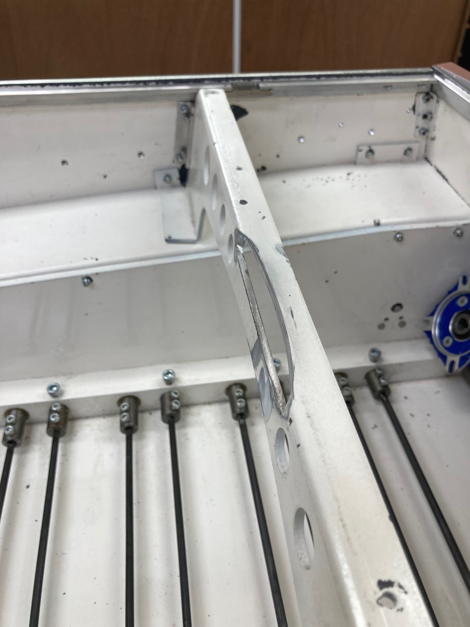

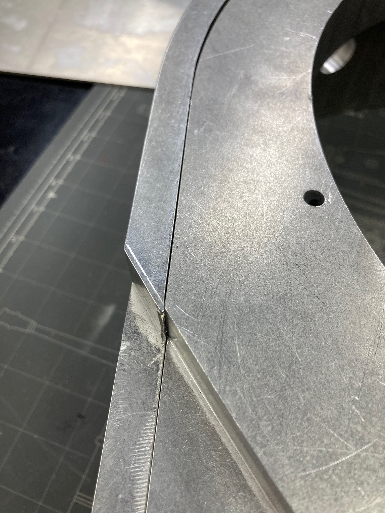

I have finally started work on the top deck, I've machined the gaps in the grills and painted with wrinkle paint for cast effect as I find it much easier that Mr Surfacer. I have also decided to put a Lazy Suzan bearing in as well. I've machined the deck supports so that the front & rear of the bearing is sitting on the supports, and it will bolt to the underside of the top deck plate. I've also started on the turret assembly and found the wrap was out by a fair bit, but with the use of five 'F' clamps and a dead blow hammer, I managed to get it on. A little short on one side and a little long on the other but nothing some Milliput and a sander won't fix. Now for a small hiccup with the gun pivot, one side hole is out by 5mm, so it is not parallel to the front plate. :?
Option A - make a whole new pivot :(
Option B - mill the hole over and epoxy the gap behind it :wink:
I think option B will save a lot of time and effort.

Problem solved, milled out to my biggest end mill bit 16mm, and made a new bush. It wouldn't fit in my mill, so I had to tilt it to 60'.

Now for another slight hiccup, I one part of my turret top plate there is a 3.5mm gap :( . Luckily I have spoken to Liam and he will laser cut me a new one once I send a template down.

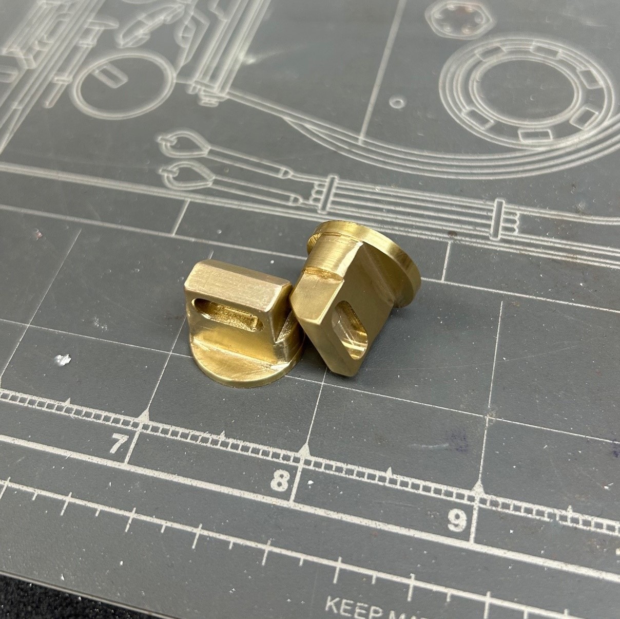

So our wet season is in full swing, and it's been raining heavily for days its good to spend time in the tank room. While working in the turret I wanted to make a functional latch to keep the escape hatch closed and of course it morphed into a bigger job than I expected.
While trying to come up with idea for the retaining bolt, it was a good excuse to unpack my new addition (rotary table) for the mill. :D It gave the old grey matter a work out :?

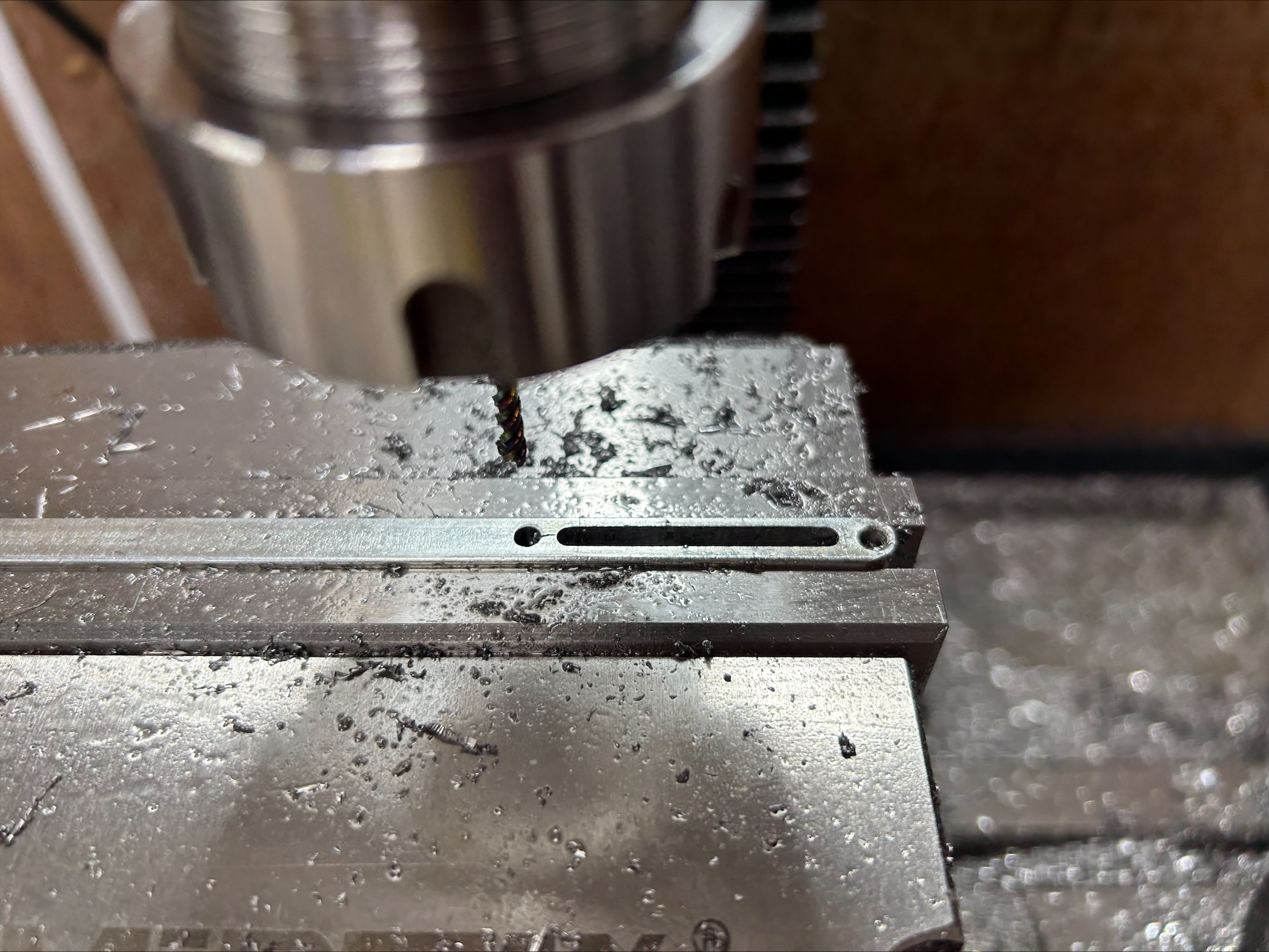

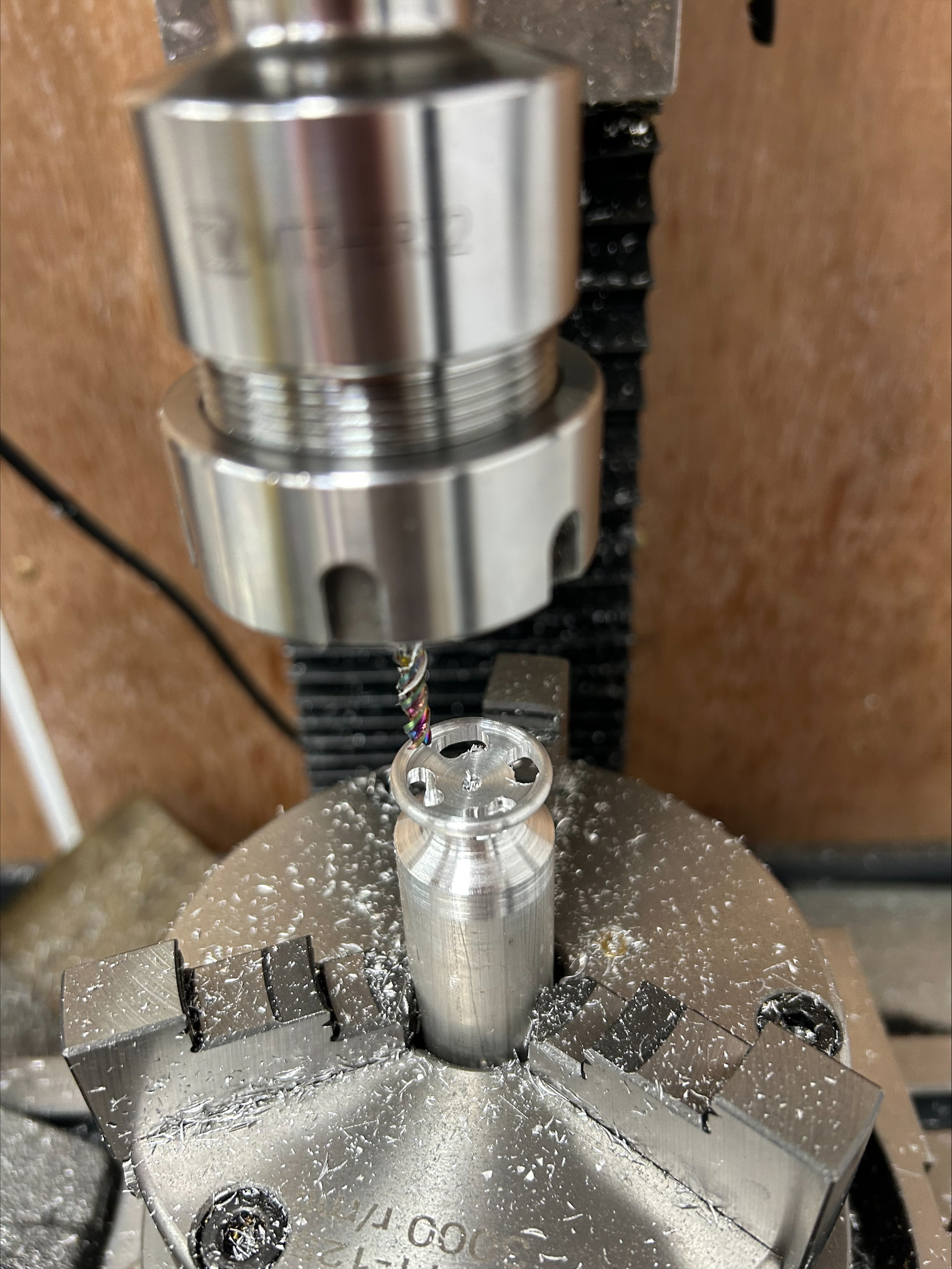

Well, it's another rainy day and I thought I'd give my new rotary table another try. I decided to have a go at making the drivers & bow gunners periscopes. I'm pretty happy with the end result. I think I'll put some epoxy in the slot before I glue them in.

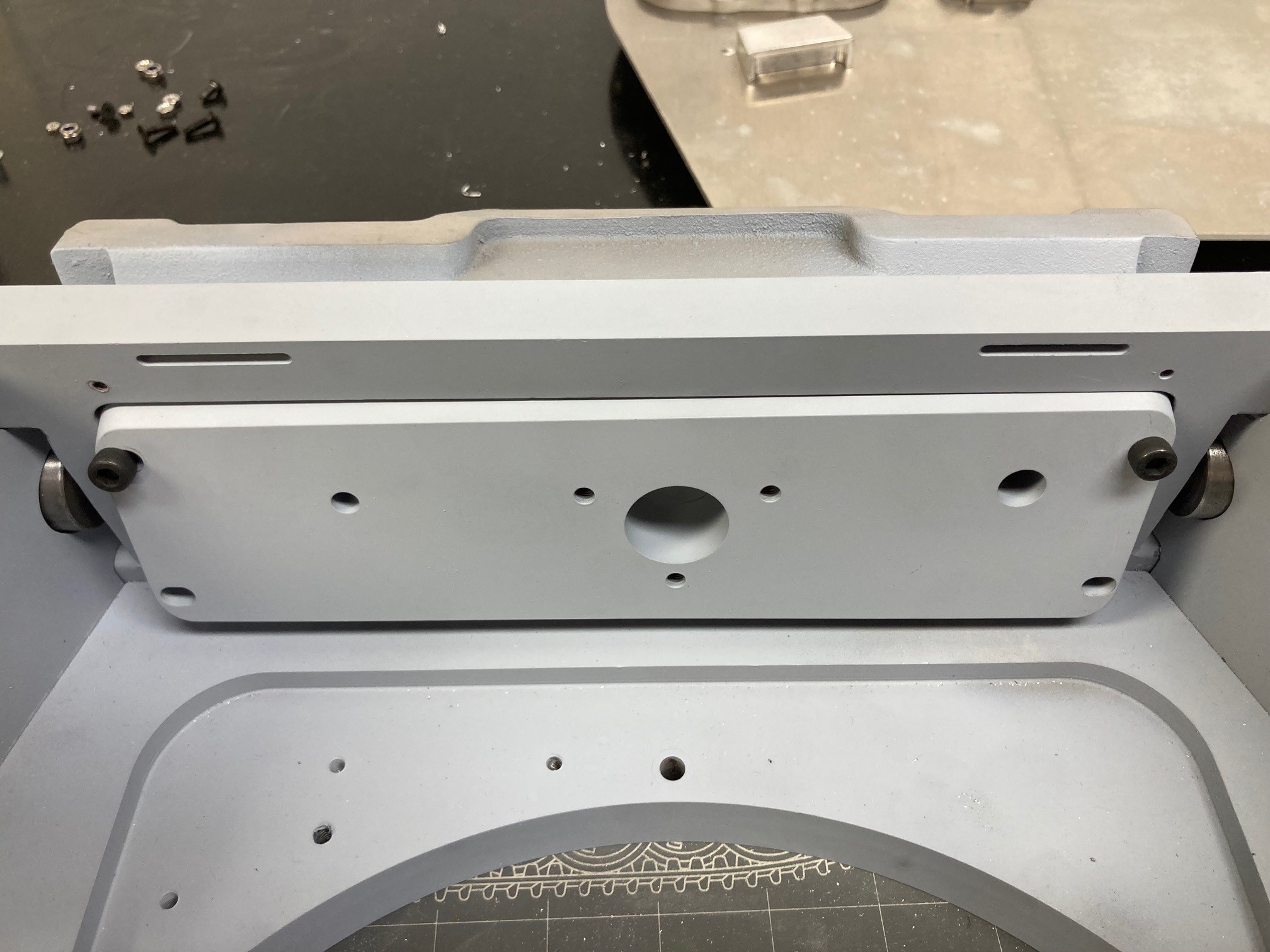

I also had an issue with the back centre plate, once I bolted it down, the front plate would sit up 2mm, I was going to put a magnet and bracket in there but came up with a cooler idea of using the dome intake cover as a knob. Clockwise to lock it down and obviously anti clockwise to unlock.

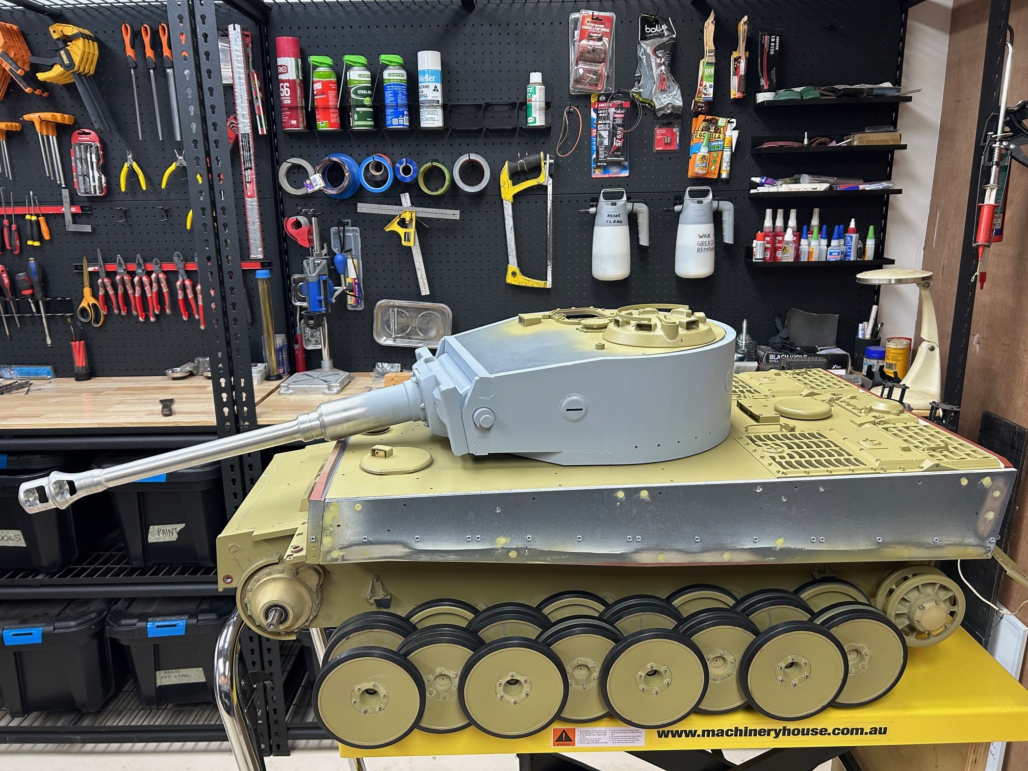

Well, it's starting to get exciting :D
Re: Pauls 2014 #4 Mid Tiger 1
Builders know what it takes to get to this stage, Looking good Paul, regards Simon Manning.

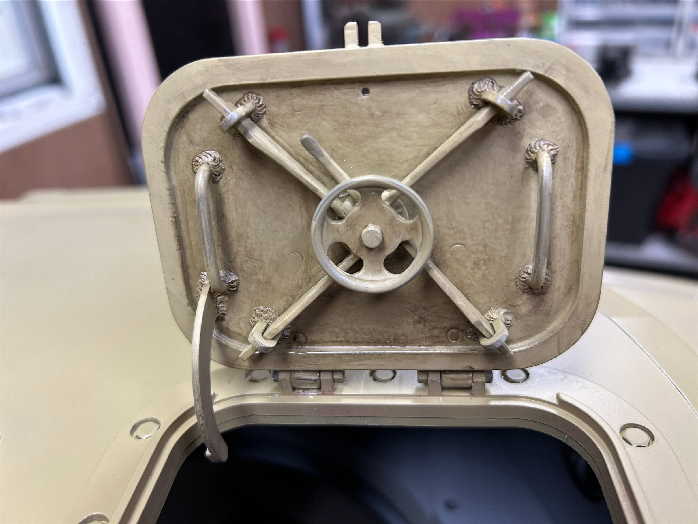

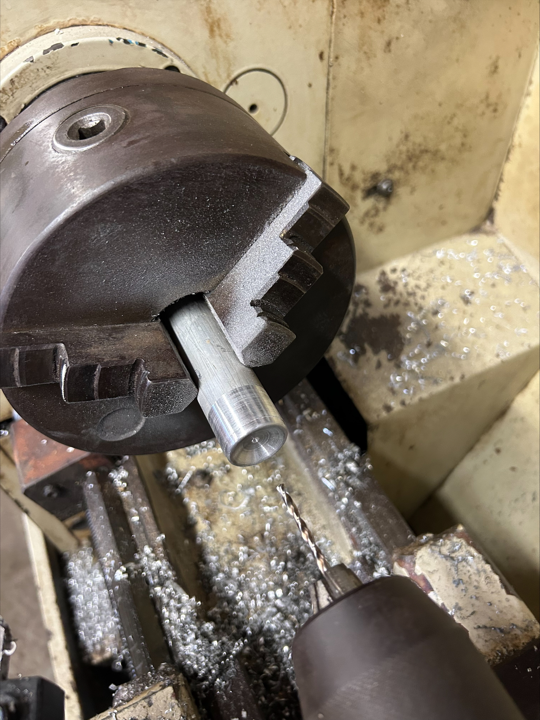

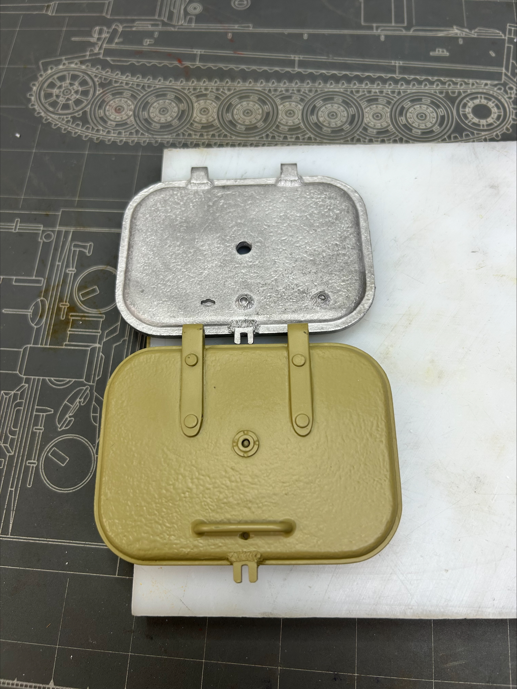

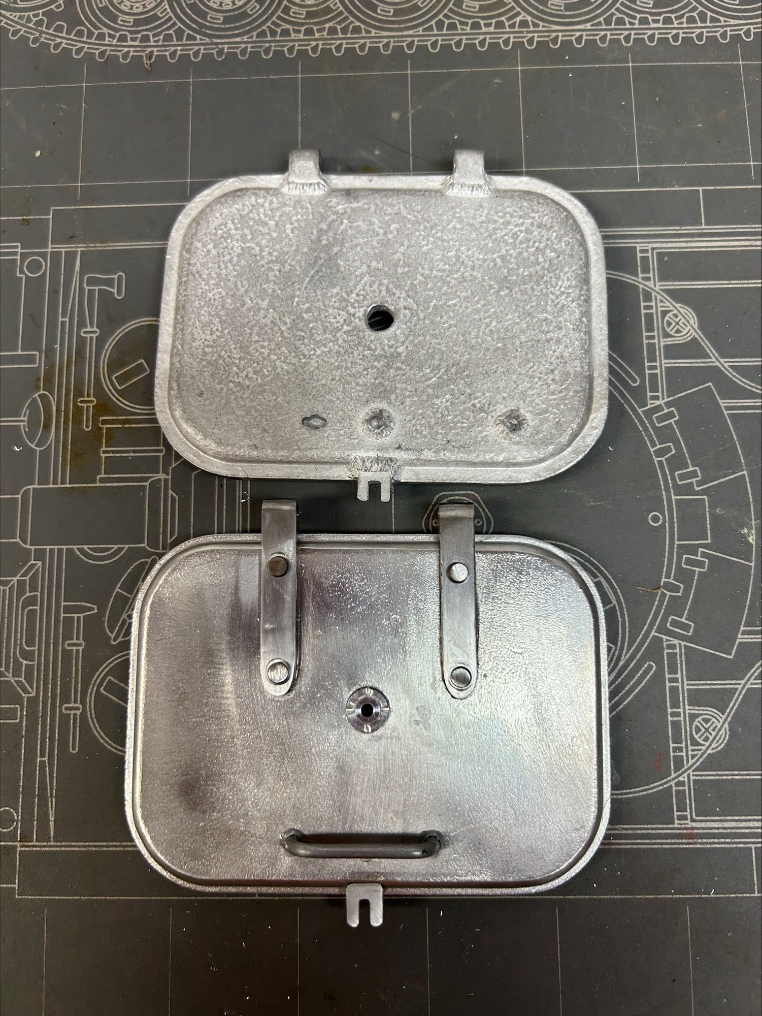

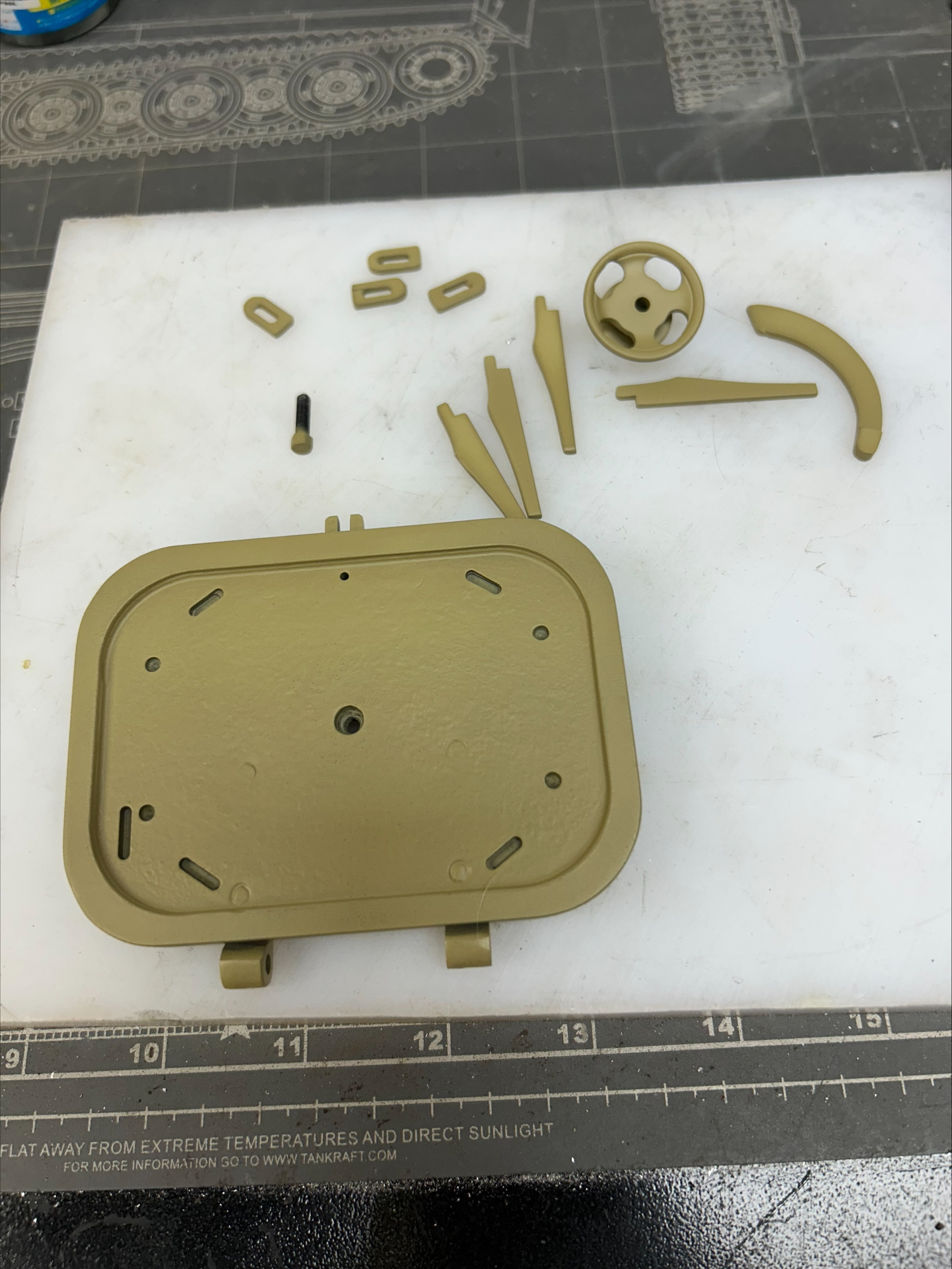

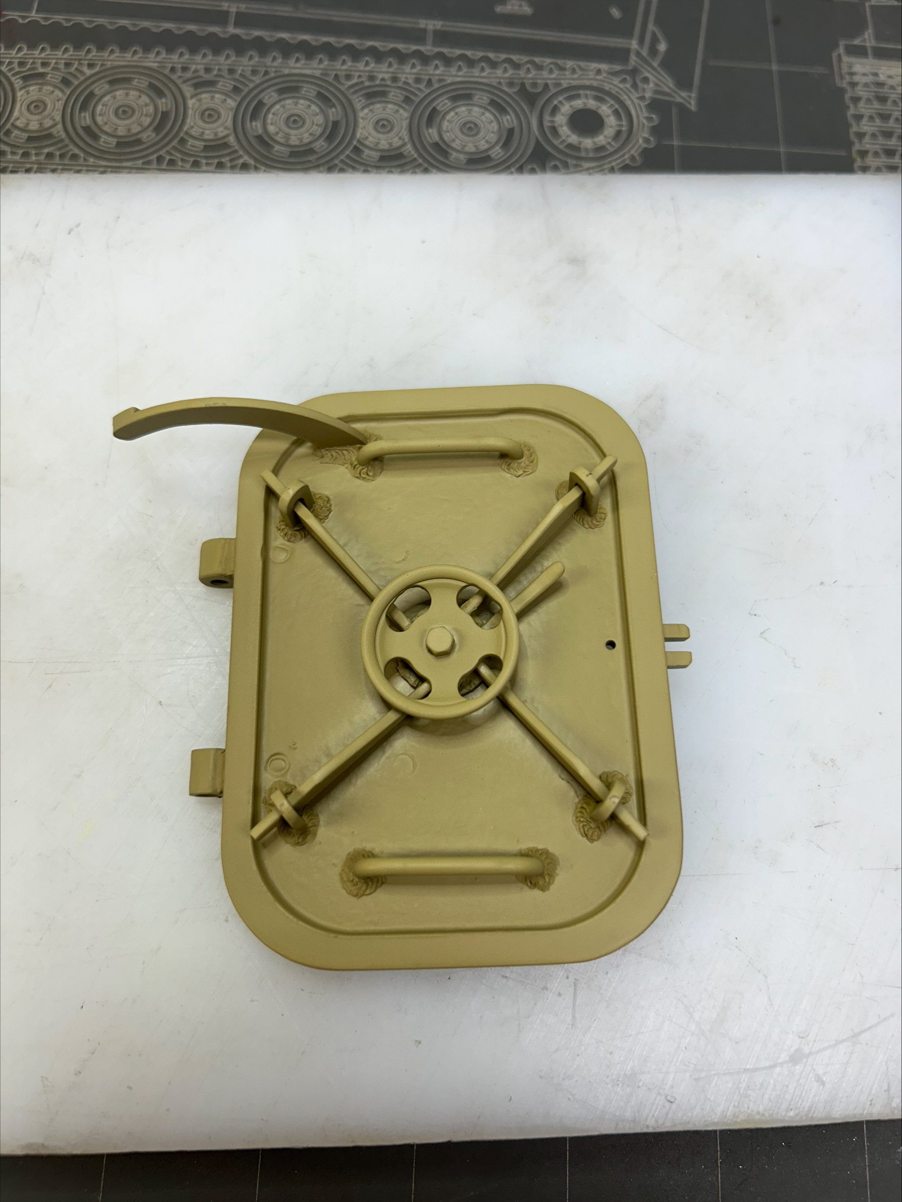

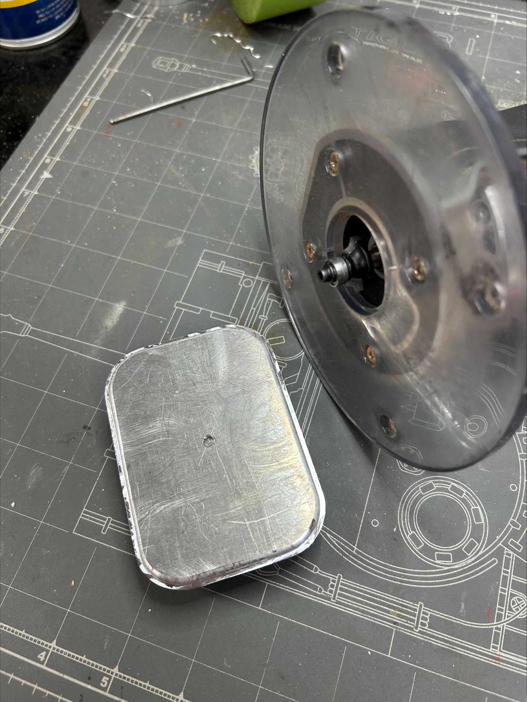

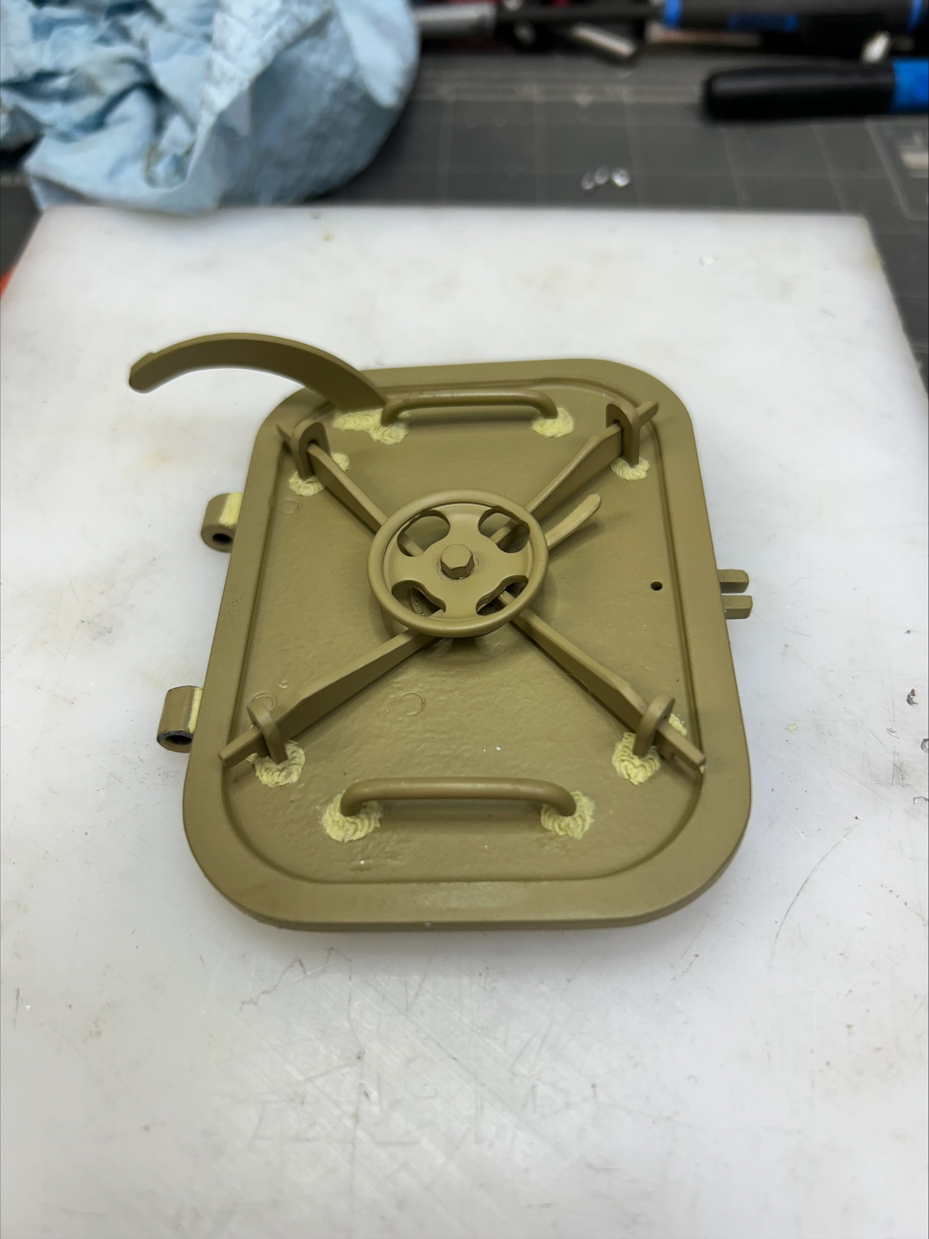

So, my Tiger came with an Armorpax loaders hatch which is for a late production, and it did not fit well. I was going to order a mid-production one from Armortek, but I thought I would have a go at making one first, and of course it morphed into a bigger job. First was how to replicate the rounded edge around the top. I swapped bearings to a smaller one on a router bit so it would give me a small step and routered the edge. Then made the hinge straps from key steel and riveted it on, the handles were made from fencing wire. I made a small centre lock and clip and thought I was done! Then the nagging thoughts for a week or two of how plain it looked on the underside when the hatch was open :|. So, after looking at pics the forum I had a go at making my own components, with a lot of swearing, frustration and many failed attempts I got there in the end. I'm pretty happy with the end result :D
Lovely details on the hatch! Excellent.
