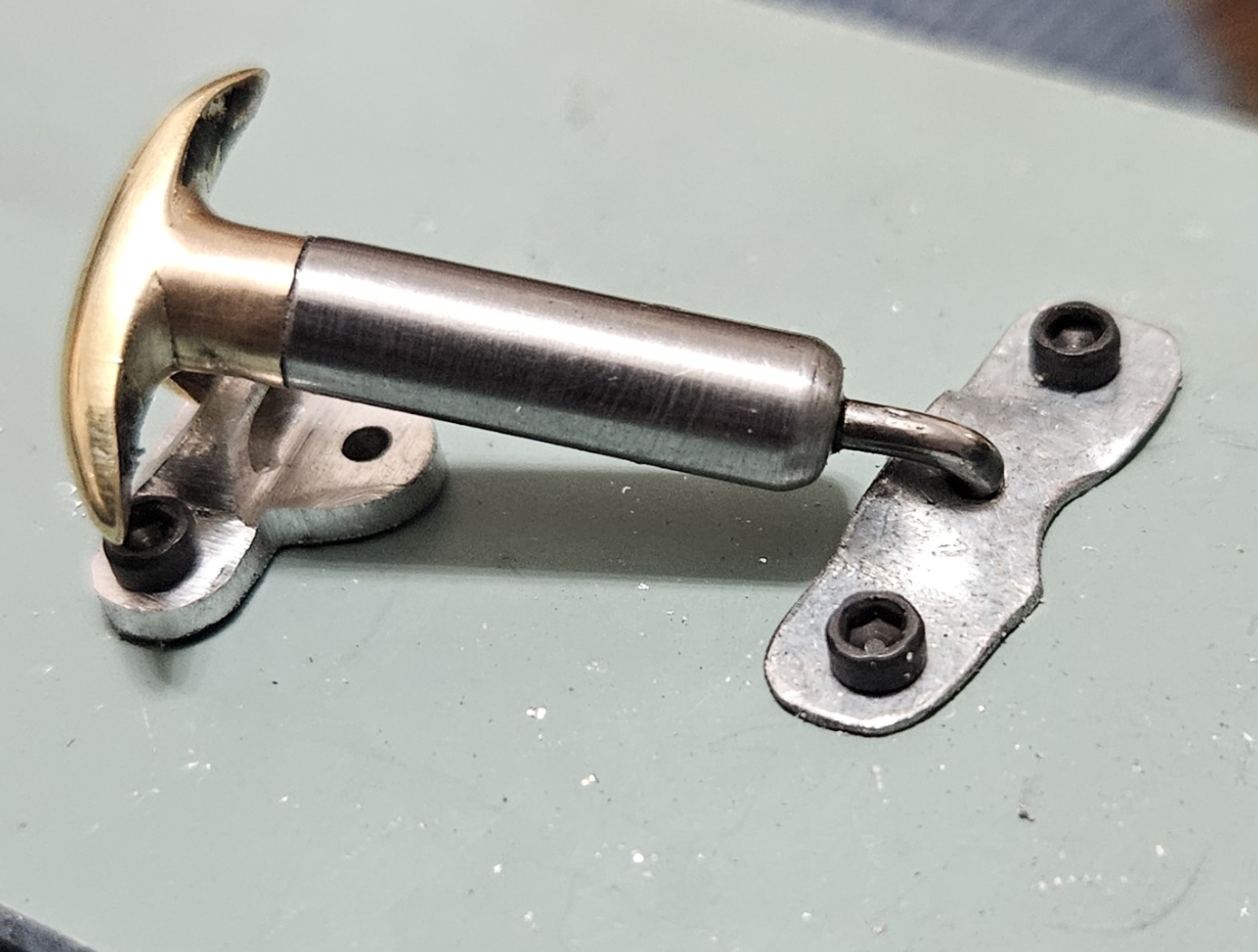

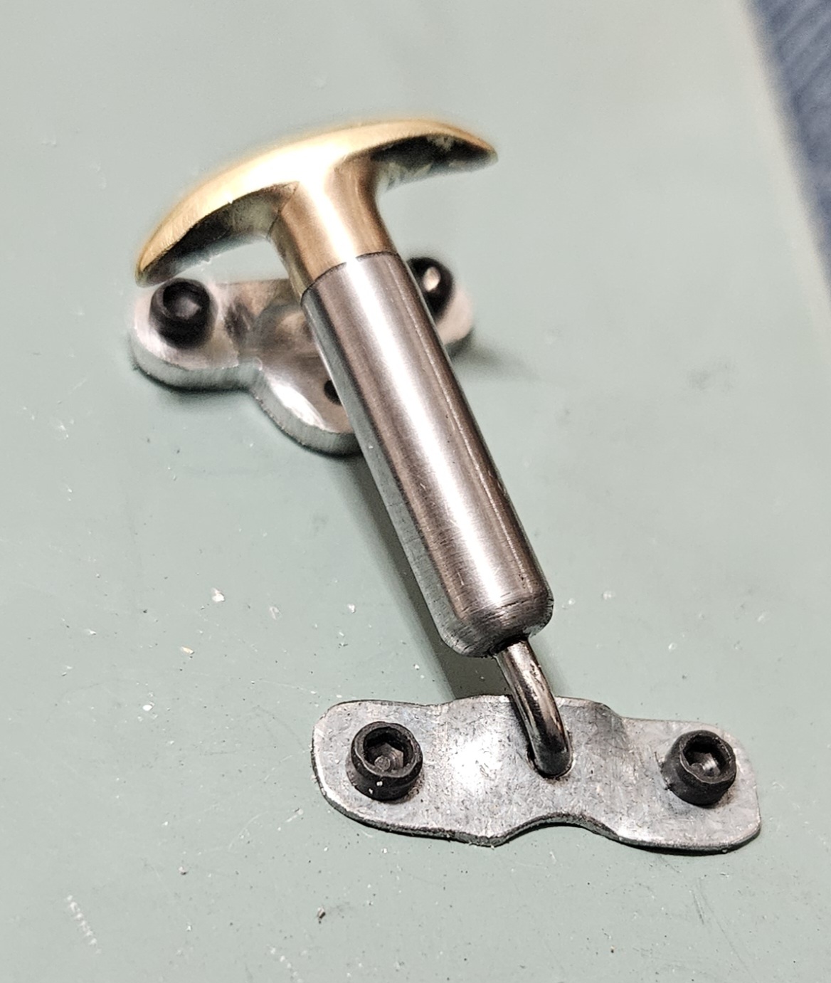

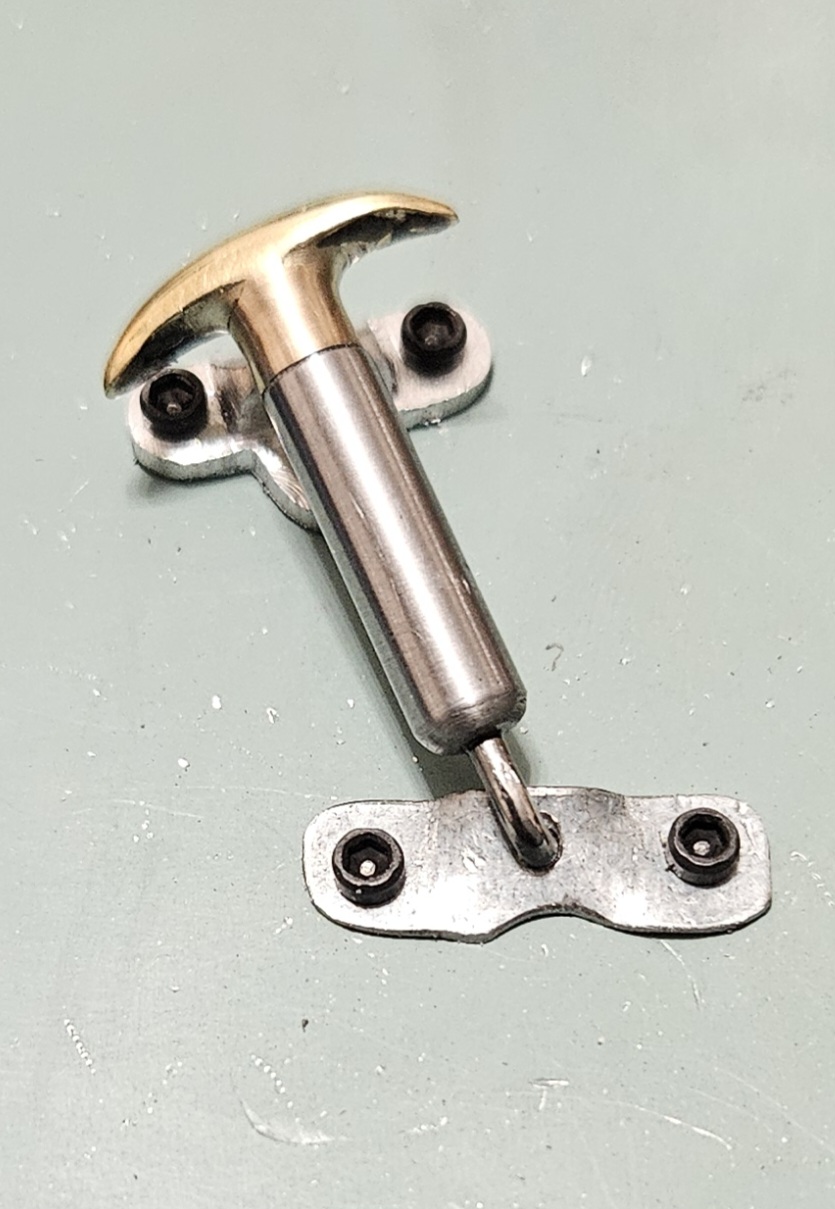

Made the top and bottom brackets today.
Bottom one I'd just pressed galvanised steel sheet, but the top one is cast alloy in the original so I needed to mimic that. It was a case of milling a piece of aluminium block to start the profile then filing it to shape before separation from the parent block.
I mounted the parts to a piece of scrap aluminium just to see how they look.
Fiddly but a nice way to spend an afternoon lol.

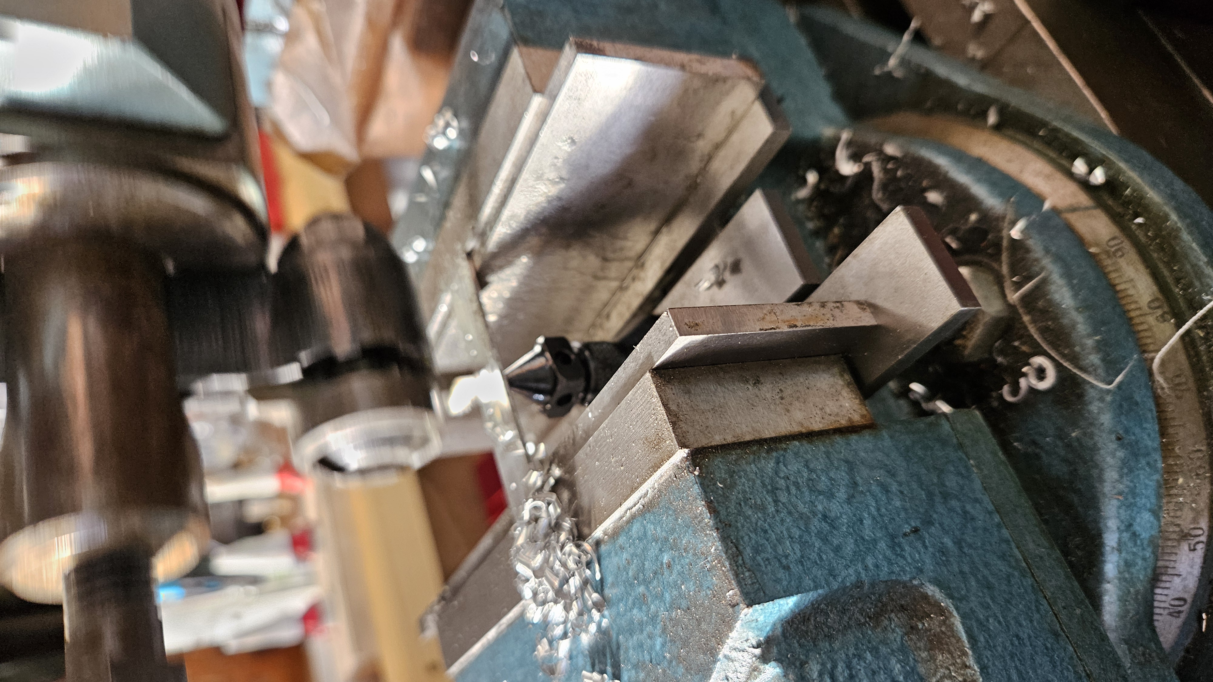

Started to make a full set of catches, making four that will hopefully be pretty similar. Using the old shaping machine to make the top catches in batches.
Found some M1 and M1.4 slotted screws which I can see being useful in the build.
I've just ordered some new needle files as I haven't bought any in years. Making the detail parts involves a lot of filing so I will need them.

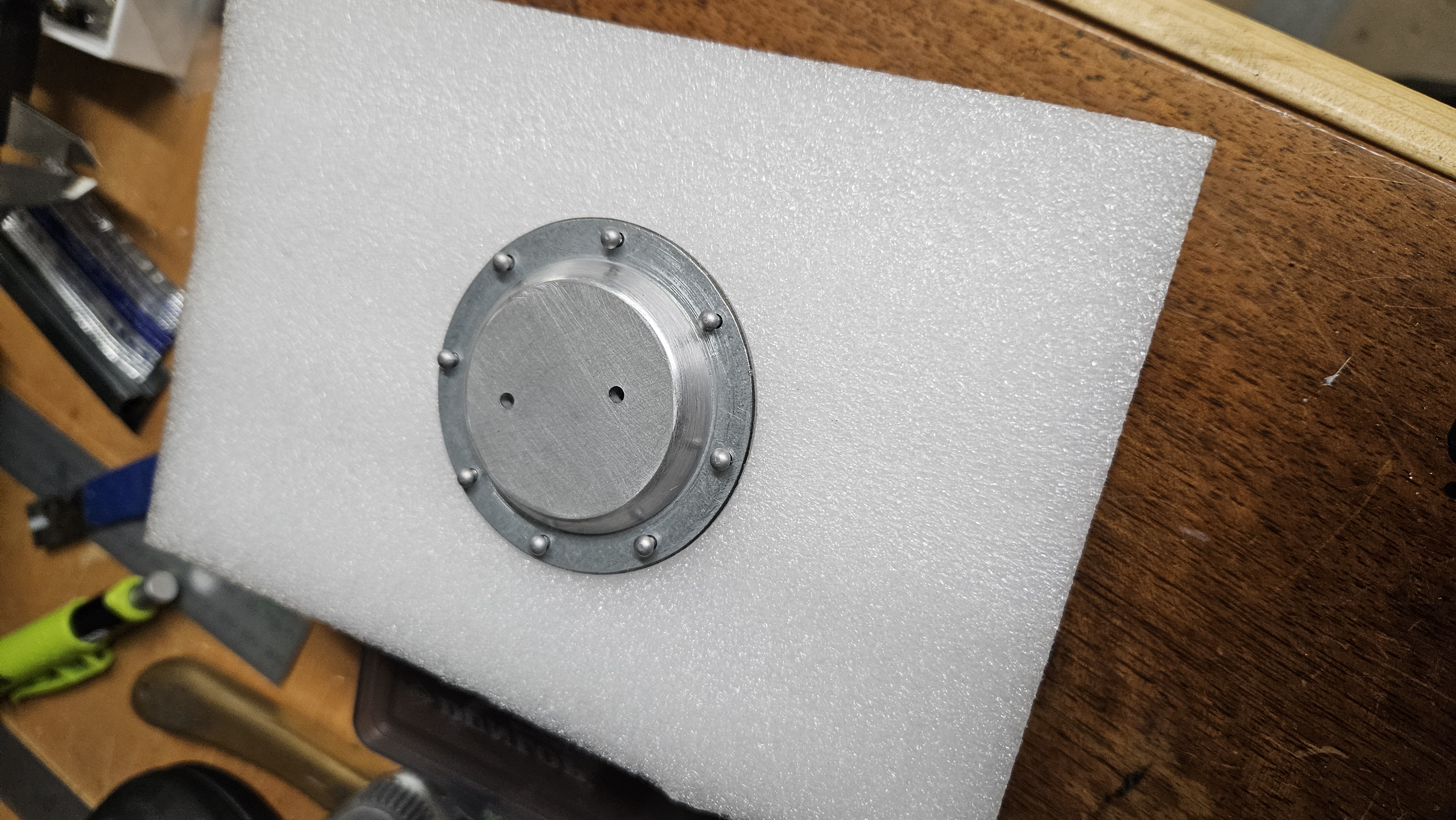

But I managed to make the spare wheel mount for the bonnet this afternoon.

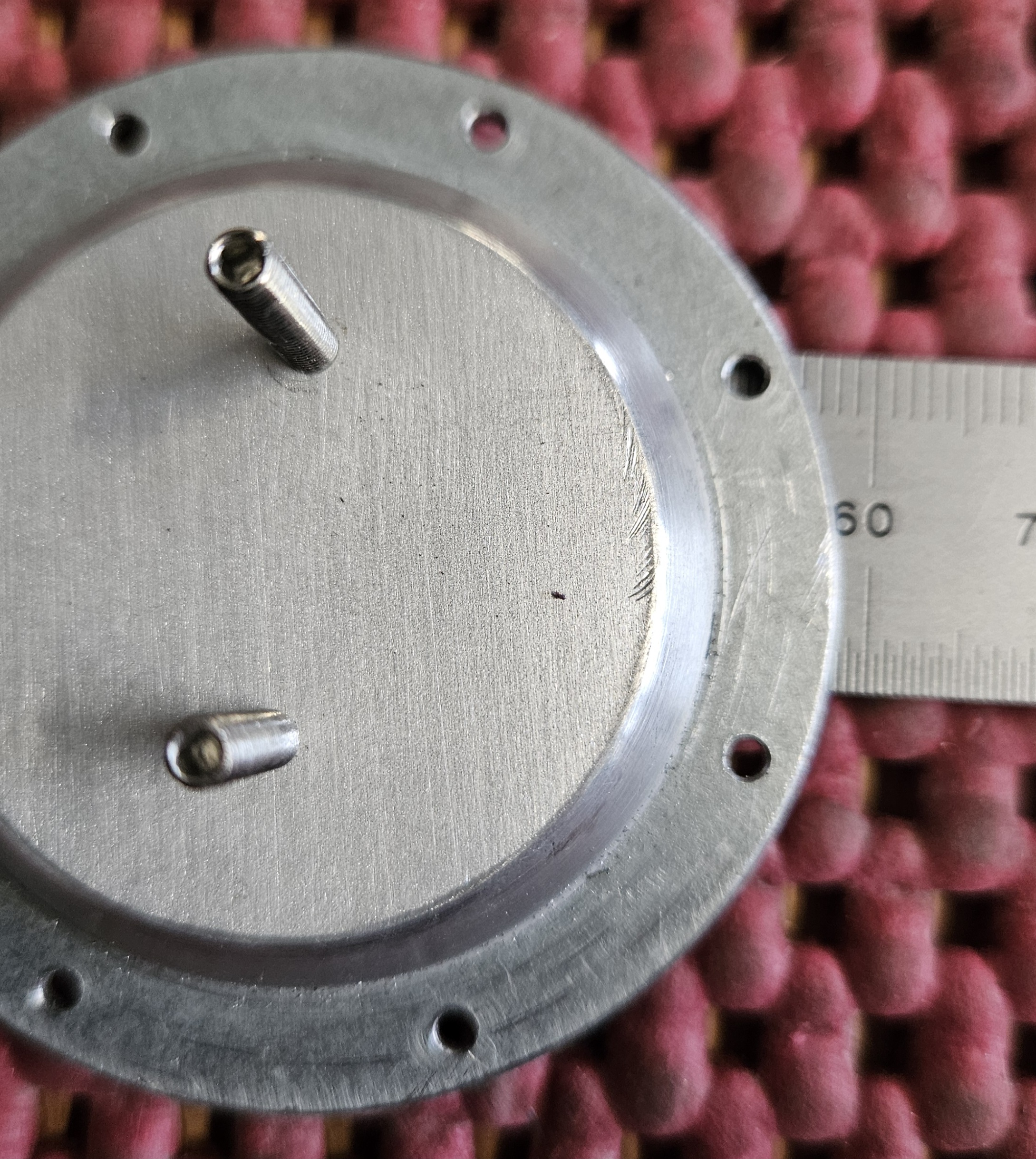

Sure I can post the dimensions. I will take a snap tomorrow on the bonnet so you can judge if I got it something like.
The rivets are 2mm shank aluminium, the base is a steel washer and the dome machined from aluminium. The original prototype was made of two pieces welded together with an obvious weld line. Production versions were a one piece pressing.

The spare wheel mount has the following dimensions
58mm base diameter
45mm boss diameter
8mm height of boss

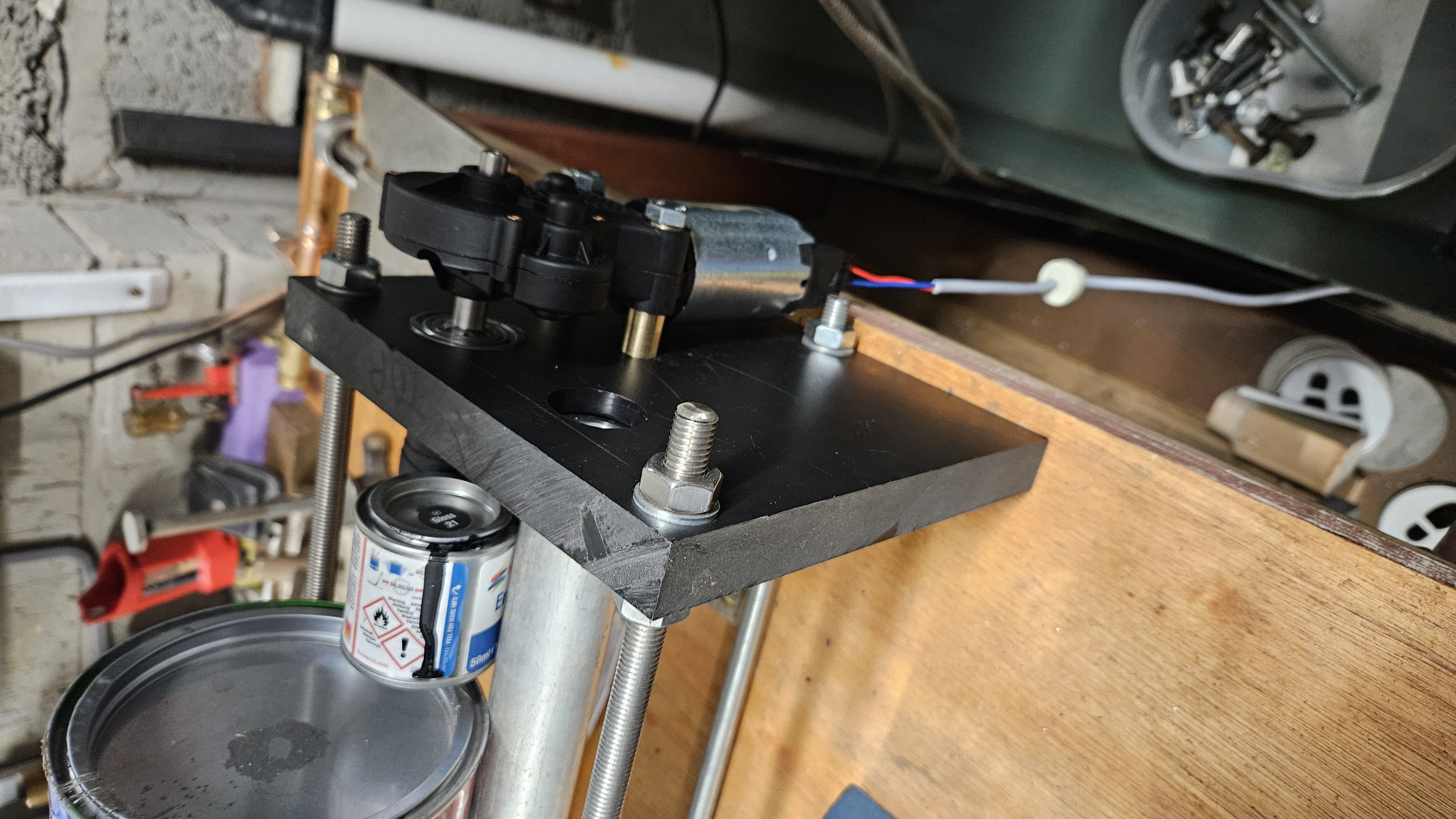

Spent the day building a paint tin tumbler as per the Chris Vine book.
I had a 12v motor with a gear box on it from a broken bath lift, lovely slow speed and plenty of torque.
A few bearings, some plastic plate scavenged from another job and some threaded rod came together into a pretty nifty little device.
The ideas is the paint never stays still long enough to form a skin. It's also ready to use without stirring.
Takes tin sizes from 50ml to 5 litre.
