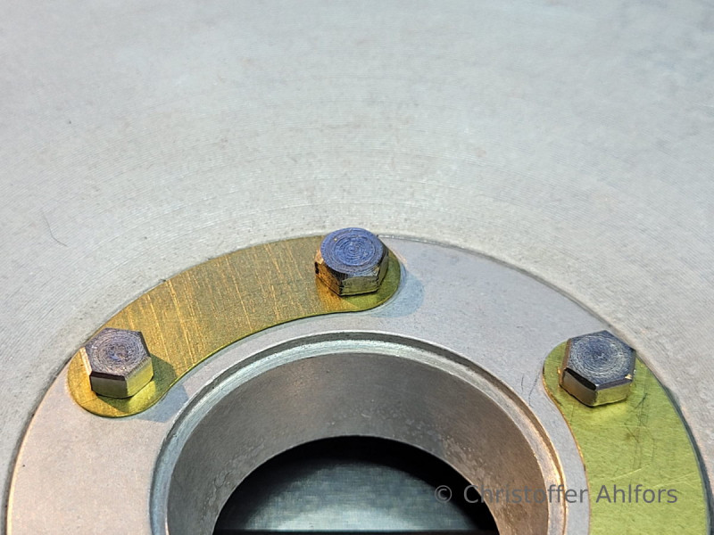

It appears that the screws and nuts on the wheels on Bovington's tiger 131 are different size. I have come to the conclusion that the nuts are 32mm and the screws only 25,6mm. A difference of more than six millimeters! :wink: Am I on the right track here?
There flat ring where the screws and nuts sit, has its edges very close, so a slight size error will be quite noticable.
I managed to stock up on screws and nuts with a s/w of 5,35mm, which is extremely close to the 5,33mm that corresponds to 32mm in reality. So far, so good, but the screw heads would need to have a s/w 4,27mm. It has not been possible to find a reasonable match of this head size - especially since I have already tapped for M3...
So, I figured maybe I could machine the 5,35mm screws down to size? :P
This is the result. One machined screw of 4,27mm and the other 5,33mm from the bag. The difference is quite visible, but is it right?

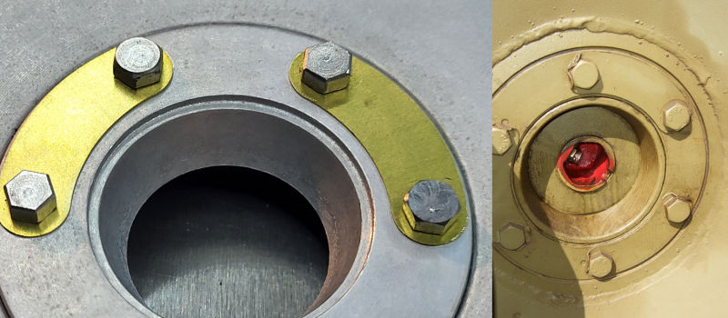

A 7BA bolt would be 4.37mm across the faces. A 6BA bolt with a "one size smaller" head would have a 2.9mm diameter thread but a 4.37mm head.
I don't know if it would fit an M3 thread though. Maybe with enough Loctite :wink:
The other question is whether the bolts in the Tiger wheels are still the originals from 1940s or more modern ones which have been swapped out at some time. They only seem to have been seriously interested in restoring it from 1990 onwards.
Three of the bolts in this picture have RIBE 8.8 markings on the heads, the other three are unmarked.

Remember Adrian we had 7BA Hex heads with a 3 mm Thread made at EKP, for general use on the models, they give a better visual effect and are more to scale, wheels especially, The bolts with numbers on are probably not original, regards simon.

Thank you Adrian for this perfect photo! :D
It makes me think that my machined screw is too small. I got the 25,6mm from a full size to 1/6 conversion chart that was published here some years ago. When I look at DIN and ISO thread tables, M18 s/w 27mm is a possibility. That would be 4,5mm in 1/6th. I will try that and see if it looks better.
I agree with the danger of relying on museum vehicles. It's quite likely that the screws have been replaced, but with a different thread? That would have been so much more work than ordering M size screws from abroad, if not available locally. My bet would be that some of the screws are indeed new, but with the same M size and a head size similar to the original.
Just for fun, I tested a BA6 screw in an M3 nut. It works, but is very loose. I would have to go through the same machining process anyway, so I might just as well continue with the M3 screws I have enough of. Besides, they are stainless.... 8)

If I read your mind correctly, this thread is taking the direction you just predicted: I just couldn't help trying s/w 4,5mm (M18 s/w 27mm) to the right... And I adjusted the photo angle to better match Adrian's photo of the prototype, for easier comparison:
What do you think?

While waiting for opinions on size (is the bigger one actually better looking?), I am troubled with the fact that the chamfer on the real thing is circular, while mine was hexagonal. My primary purpose was to remove the burrs, as not to get splinters in the skin. I have heard, that can be a real problem... :wink: My deburring tool is 45 deg. The commercial screws seem to have a chamfer of maybe half of that or max 30 deg. Being somewhat of a nerd (...), I was so curious I decided to try a circular chamfer with the 45 deg tool I have (center):
Looks way more okay than I thought - yay! :D
But I still need your opinions on if the 4,5mm looks right (as opposed to the 4,27mm on the left) or if I should aim for something else? Maybe someone knows the exact dimensions?

Looking at Adrian's picture, I get the feeling that my screw heads might be a bit thick? I decided to have a go at thinning it slightly and that makes it appear bigger as well. The "flattened" screw is to the far right:
I think I'll go with this unless someone chimes in with better size information. 48 plus spares. :D

I went ahead and this is the result:
And for the wheels with nuts:
This is a lot better looking than what I had before. :D
