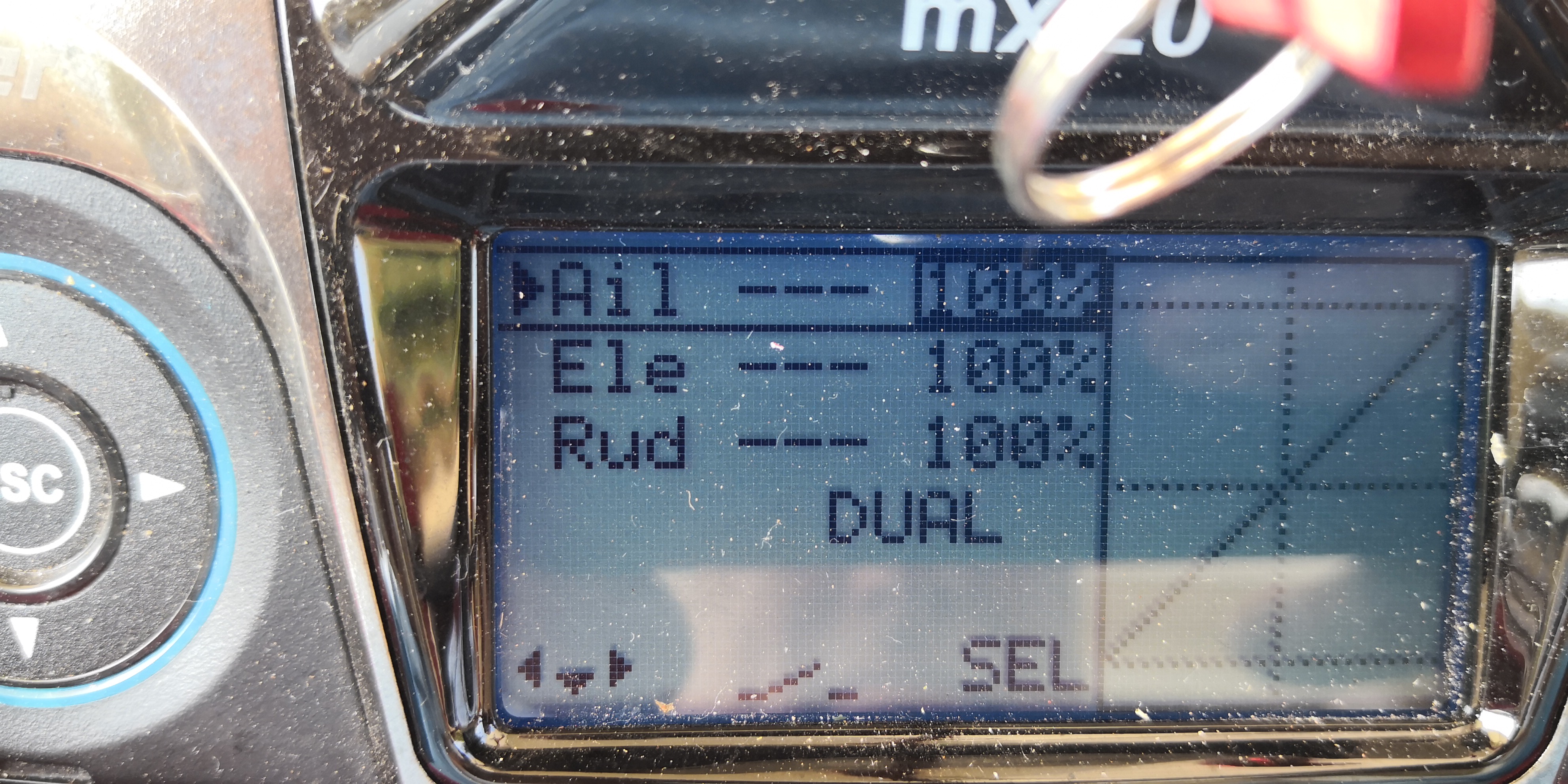

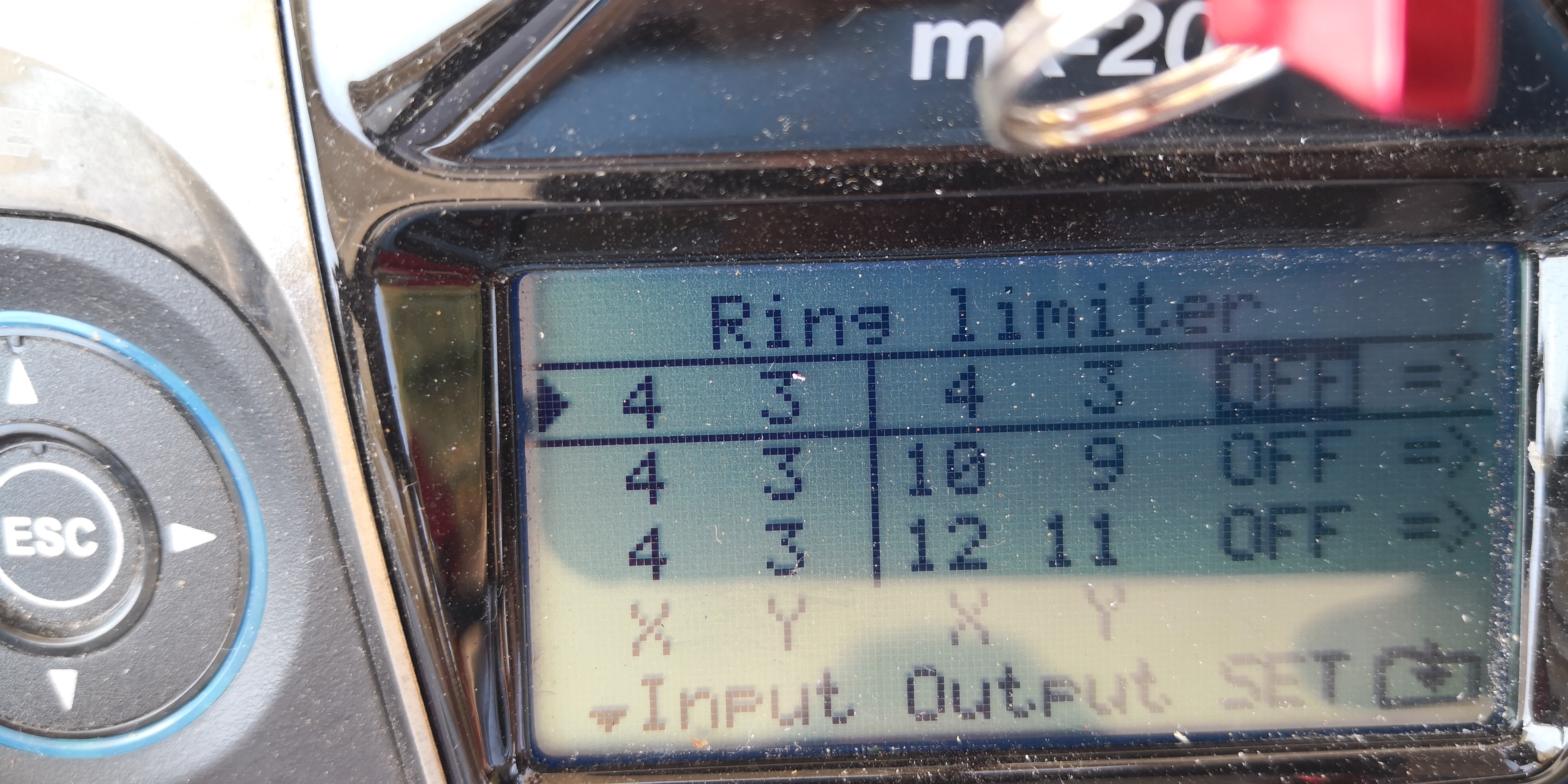

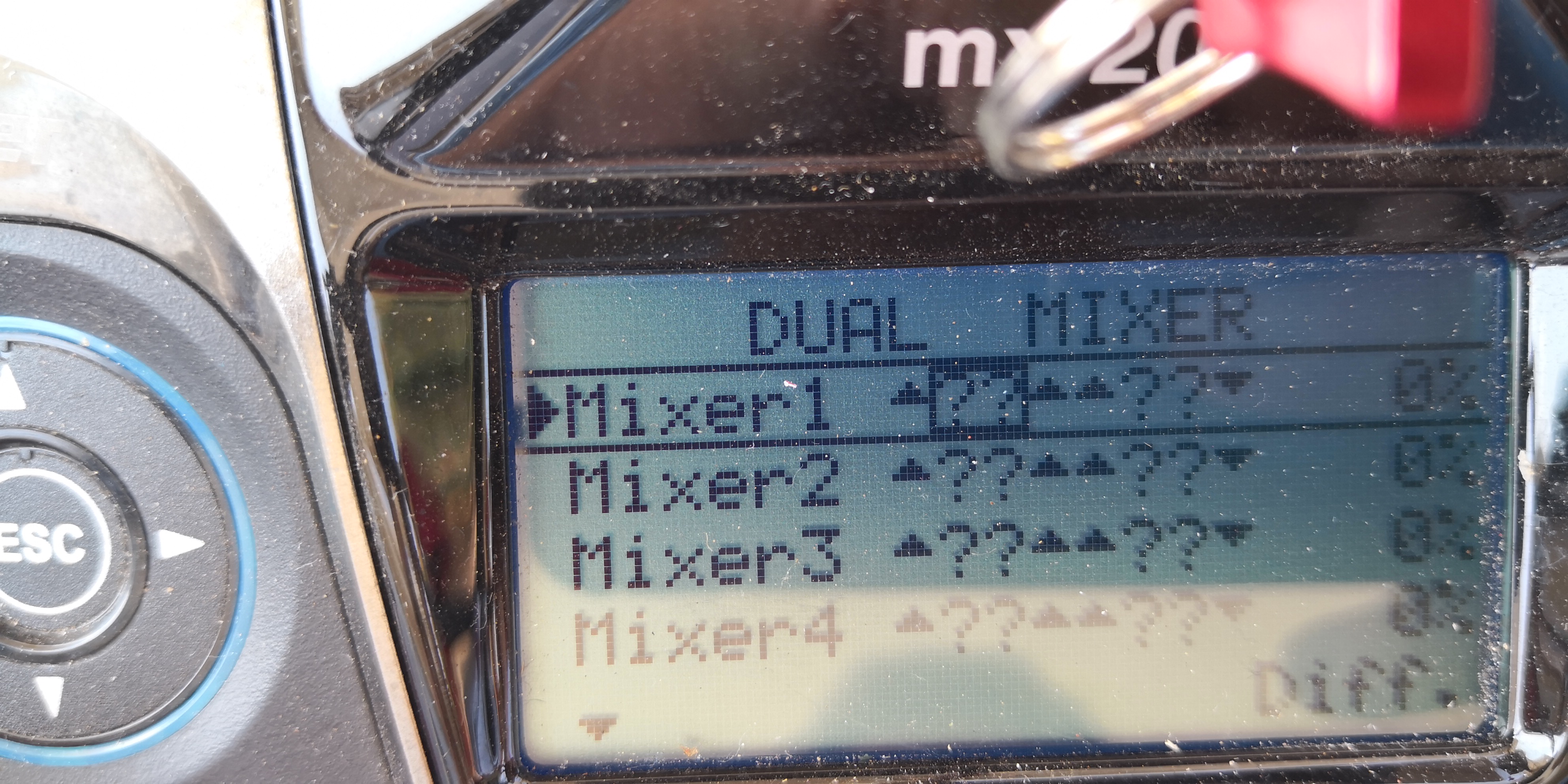

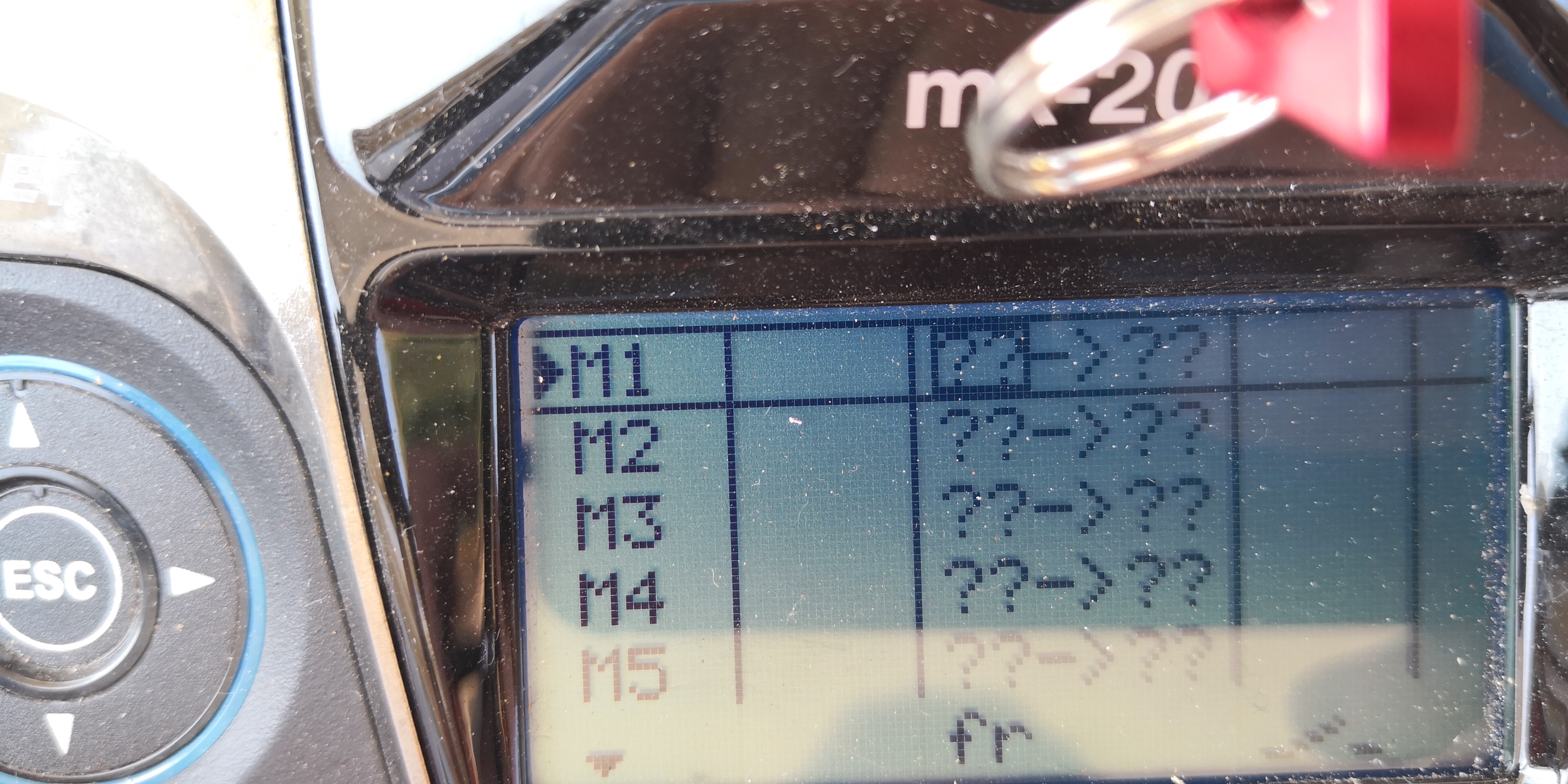

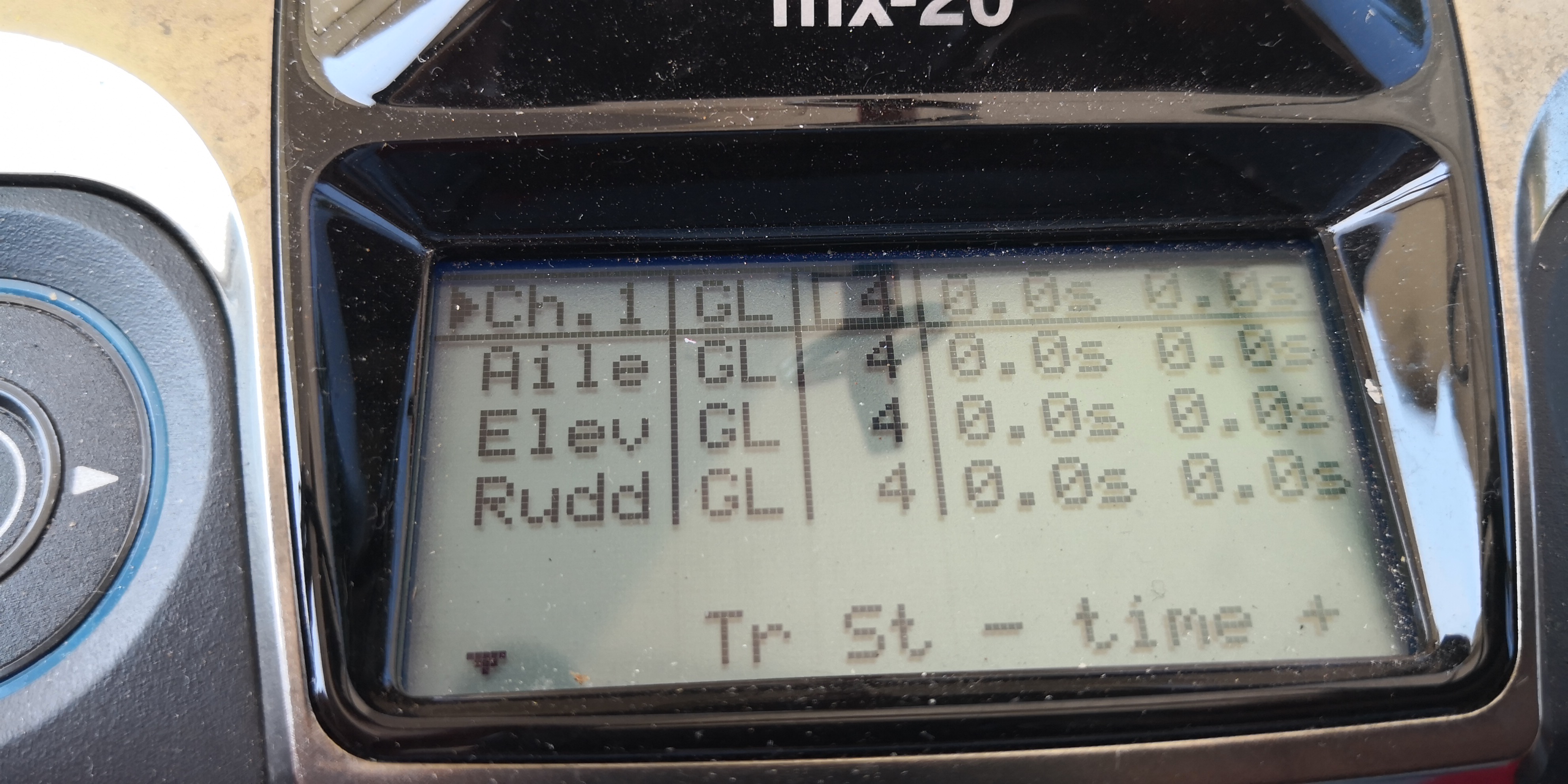

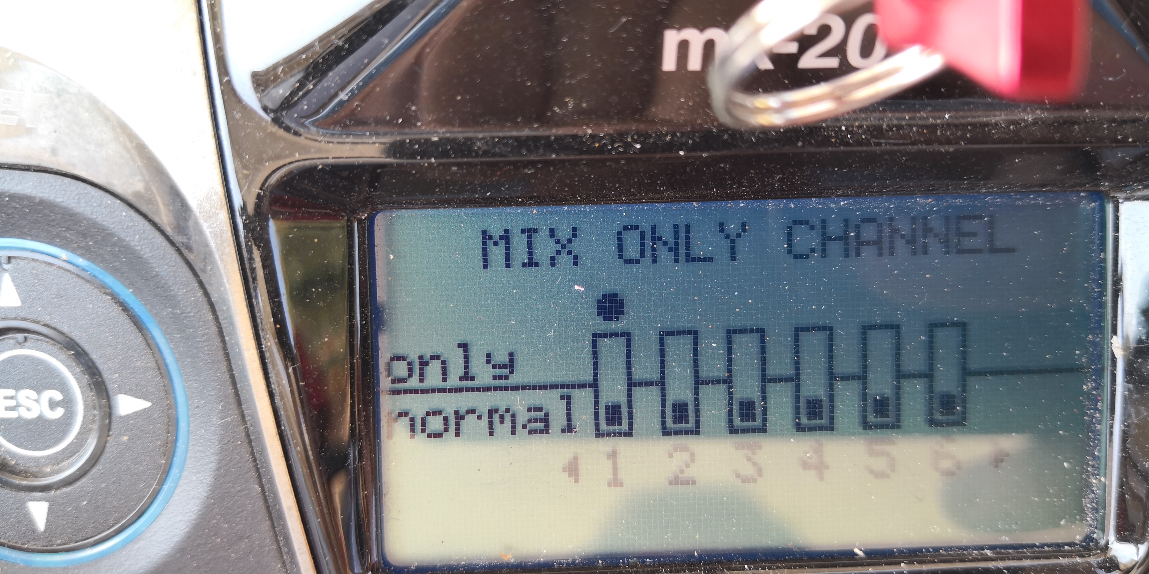

Post by yves mouton »
Hello Adrian,
I send some pictures and a video of my Graupner setup.
Best regards Yves

Post by Steen Vøler »

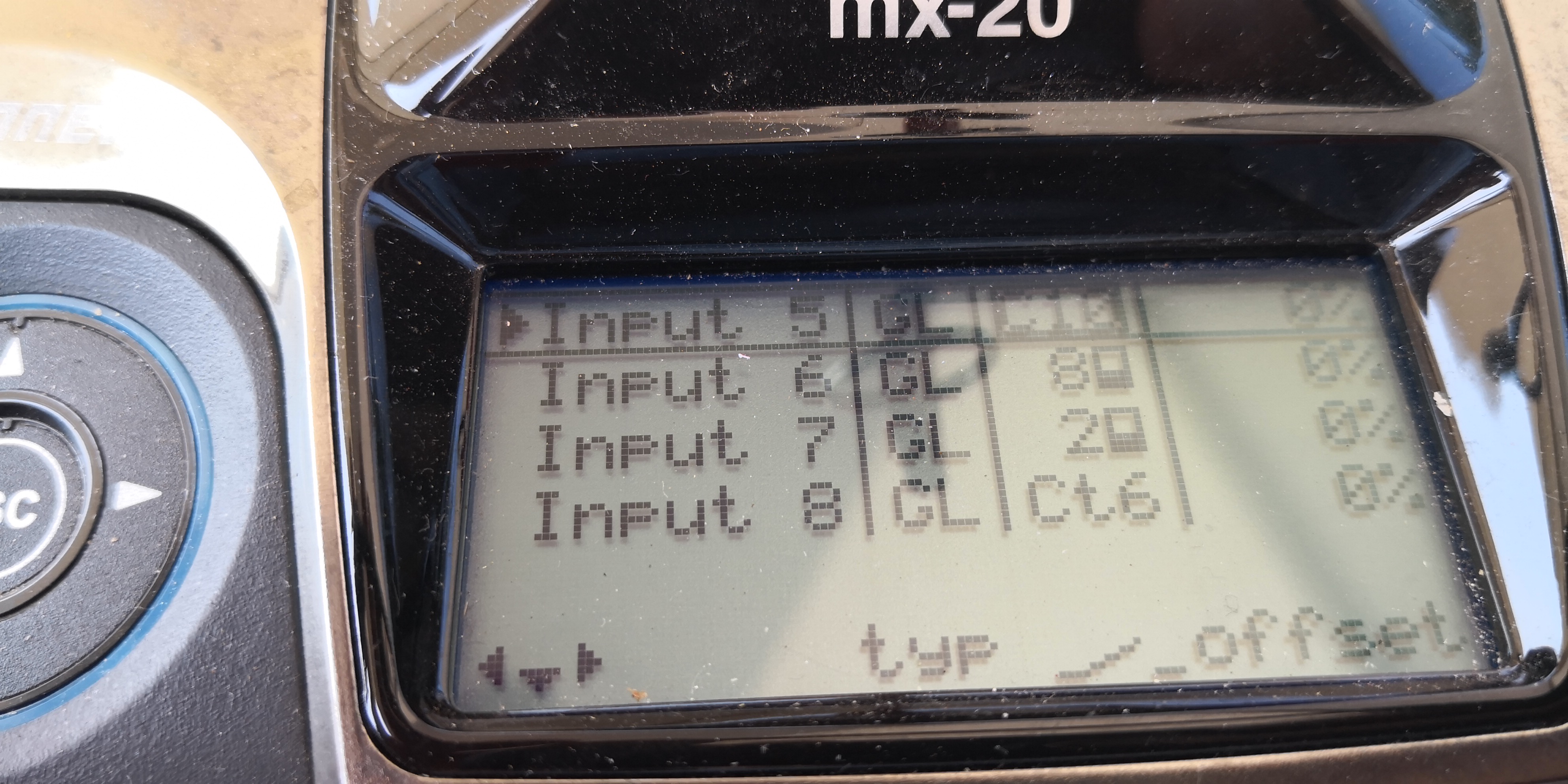

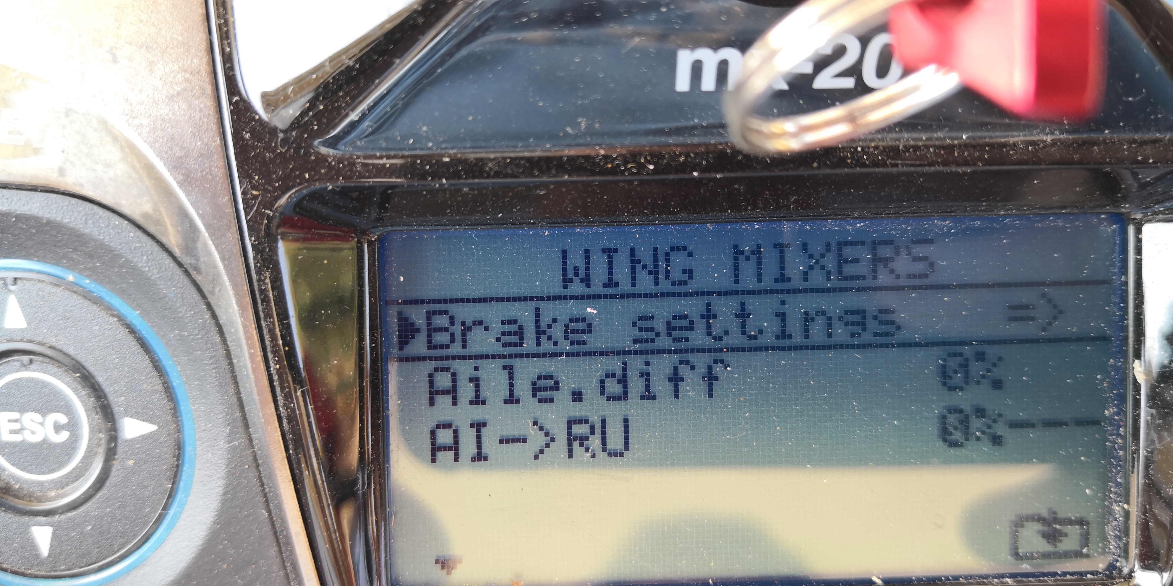

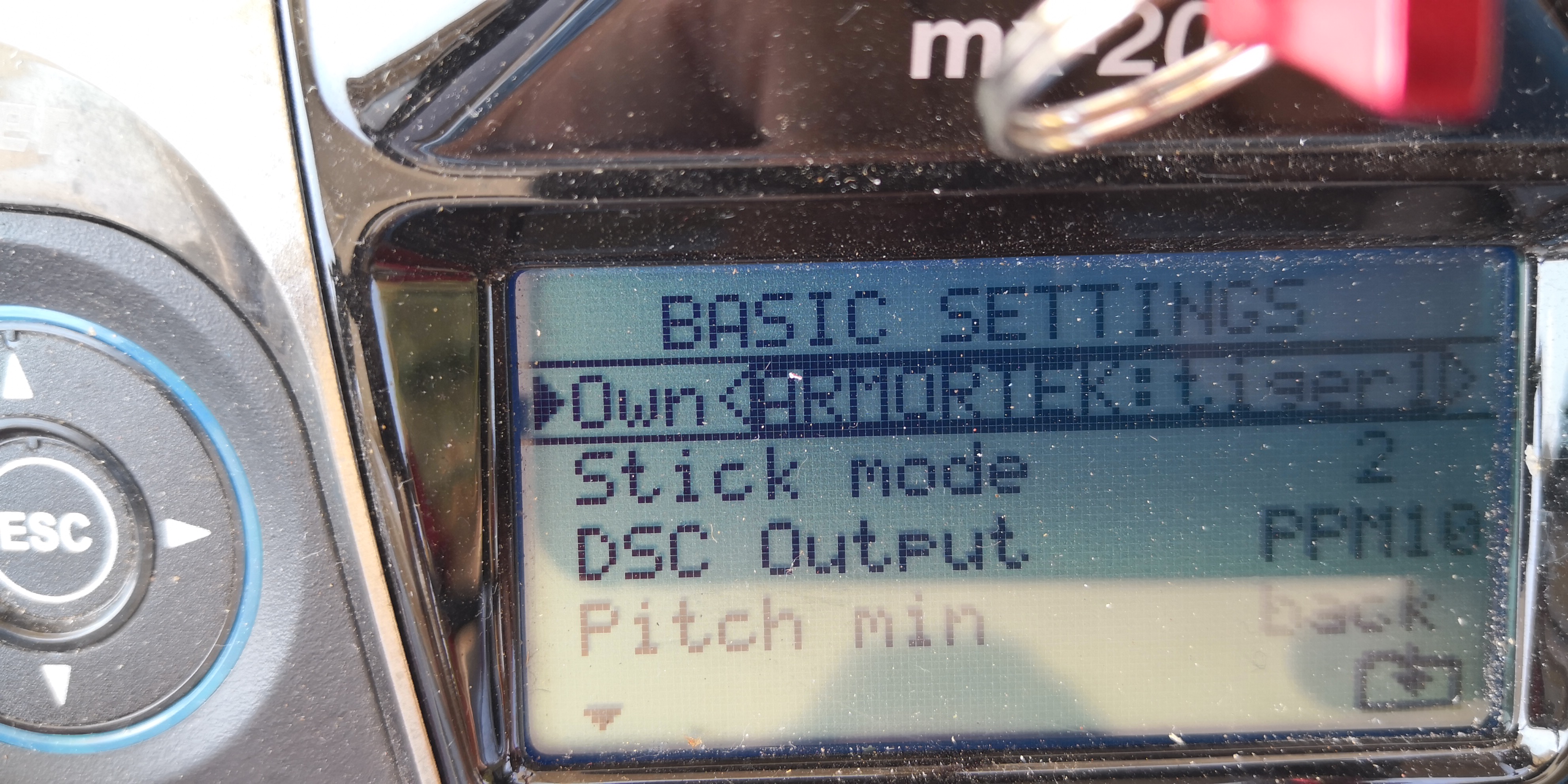

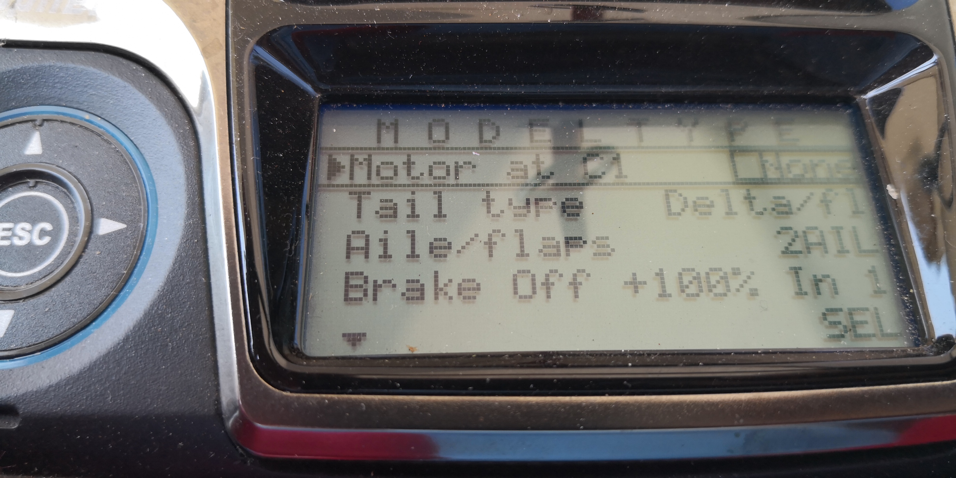

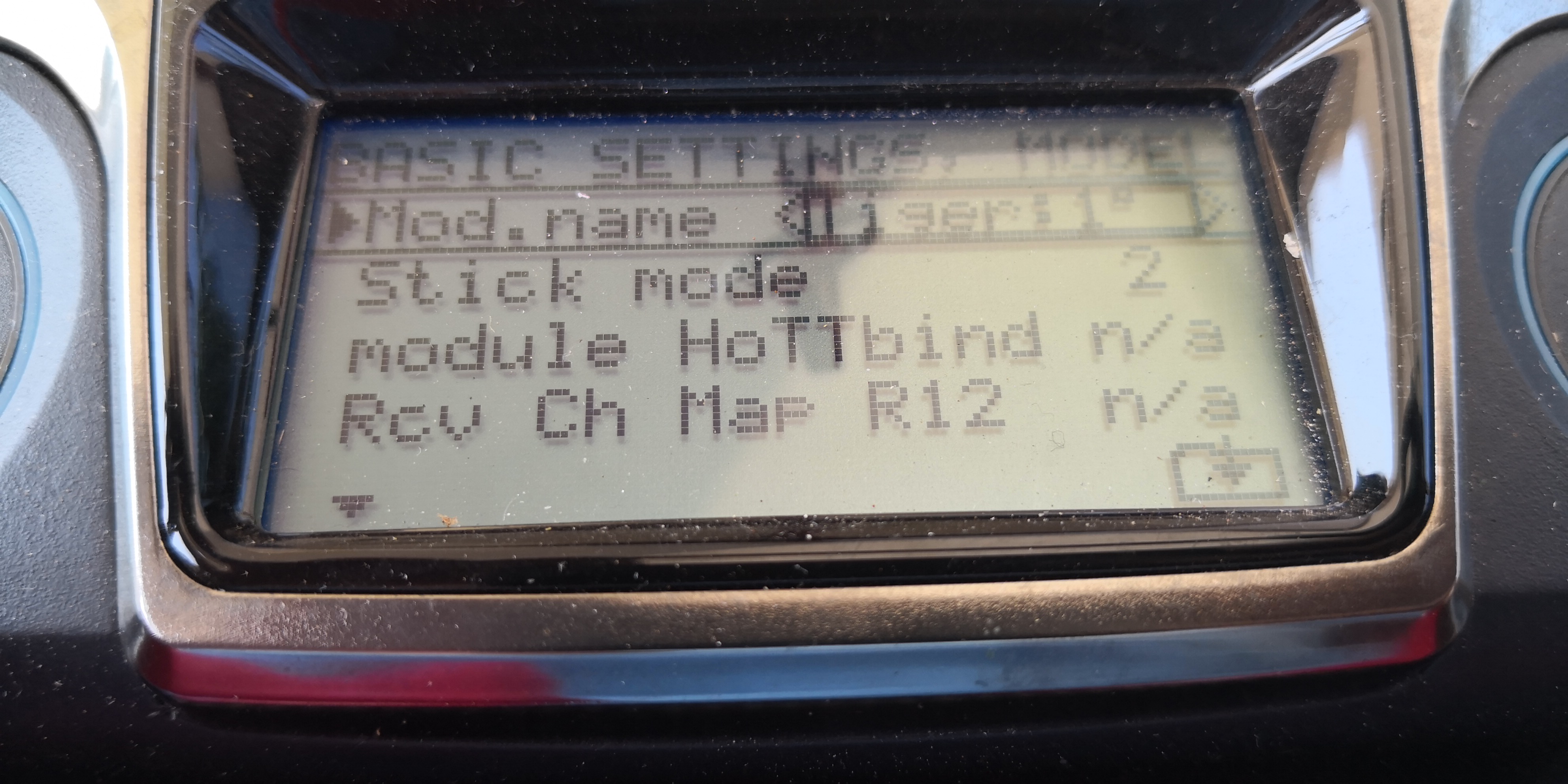

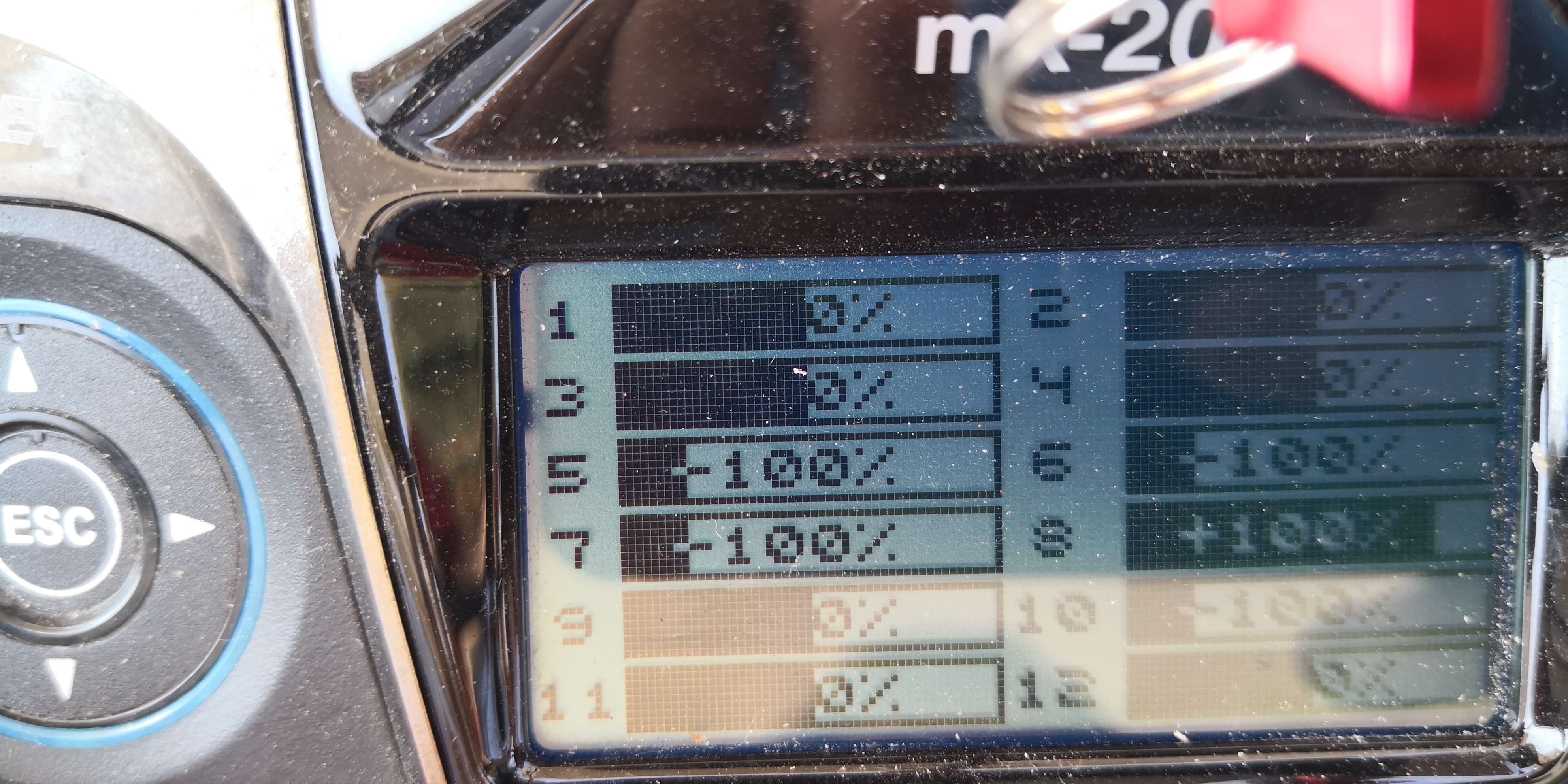

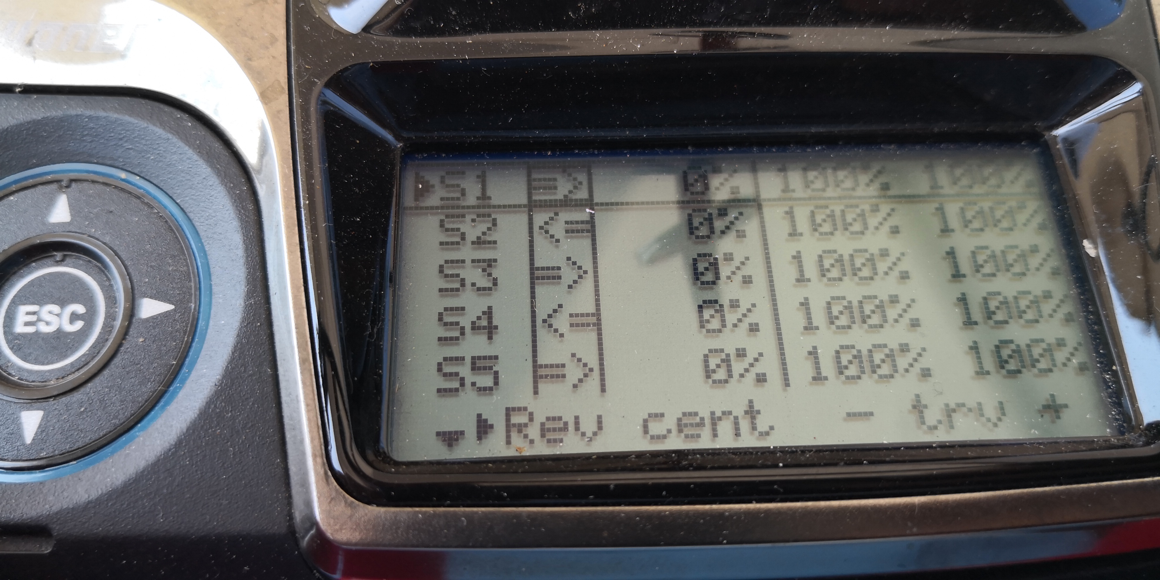

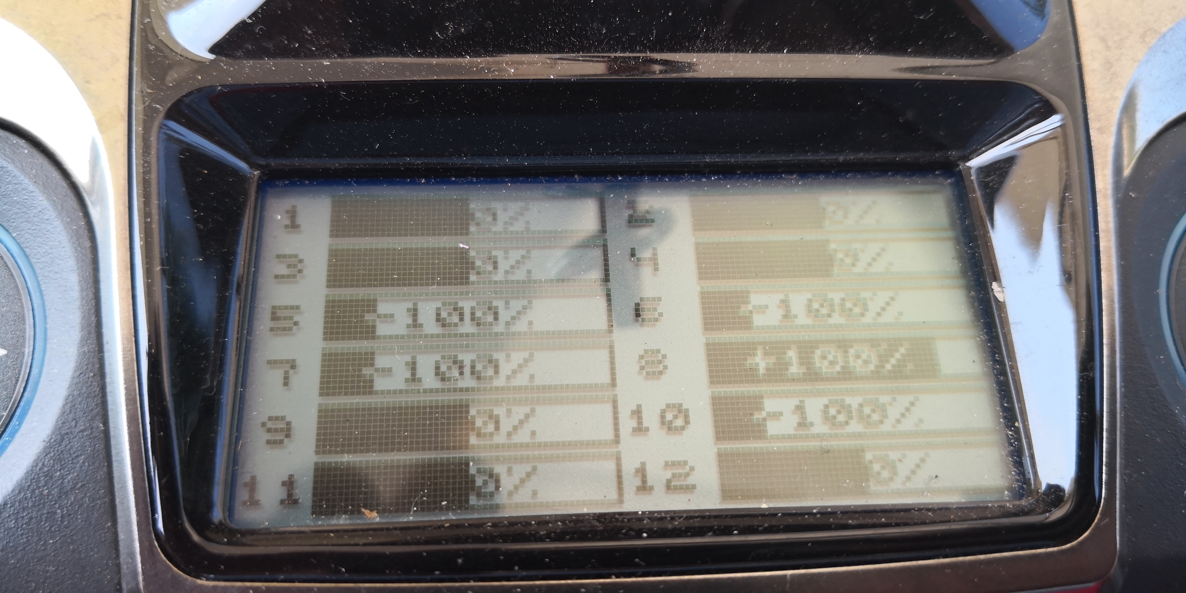

Hi Adrian,
the pictures are from a Graupner MX-16 singlestick
cheers
Steen

Thanks Steen. Do you have red box electrics ?

This did work both on the silver and red boxes
cheers
Steen
