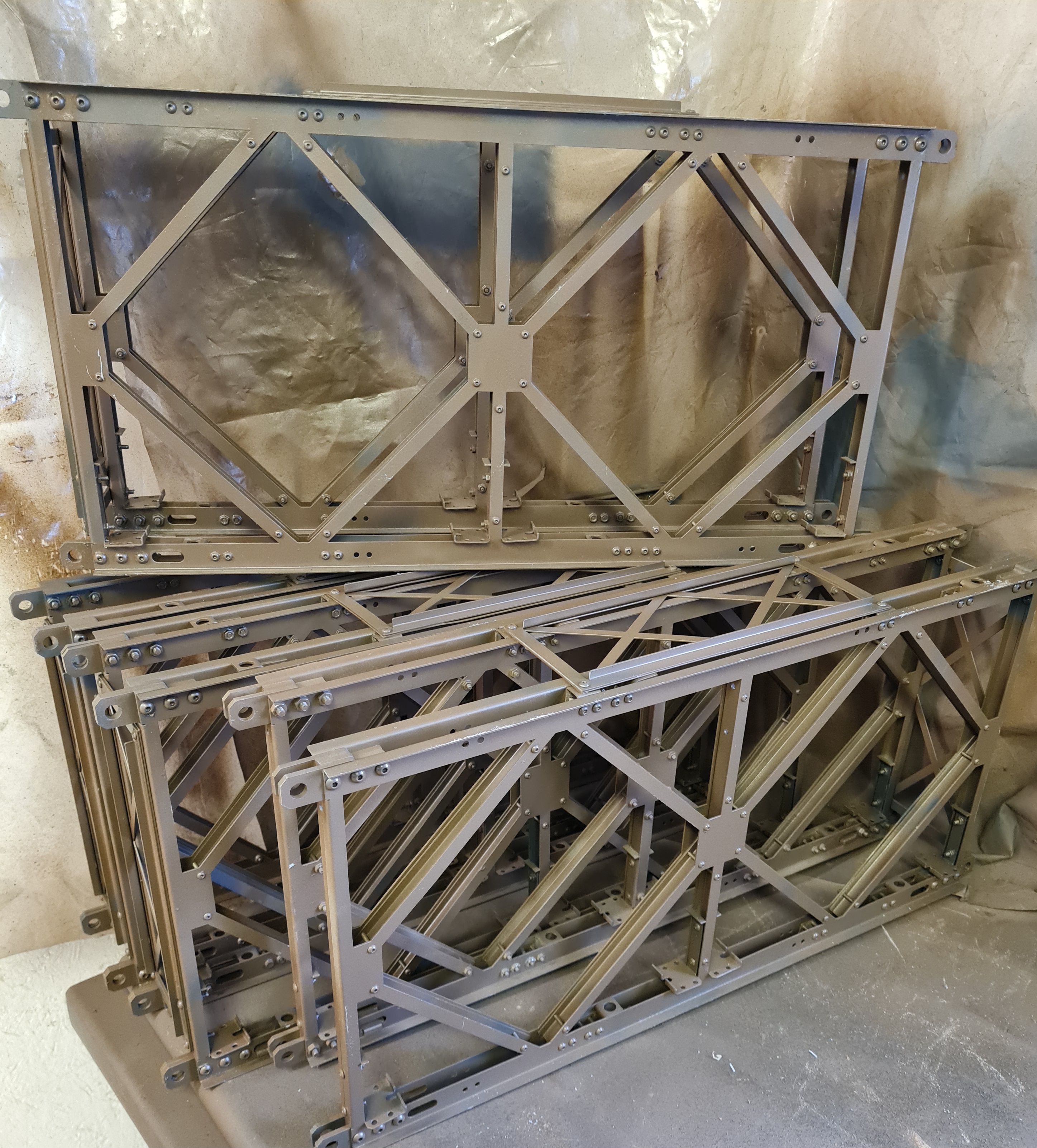

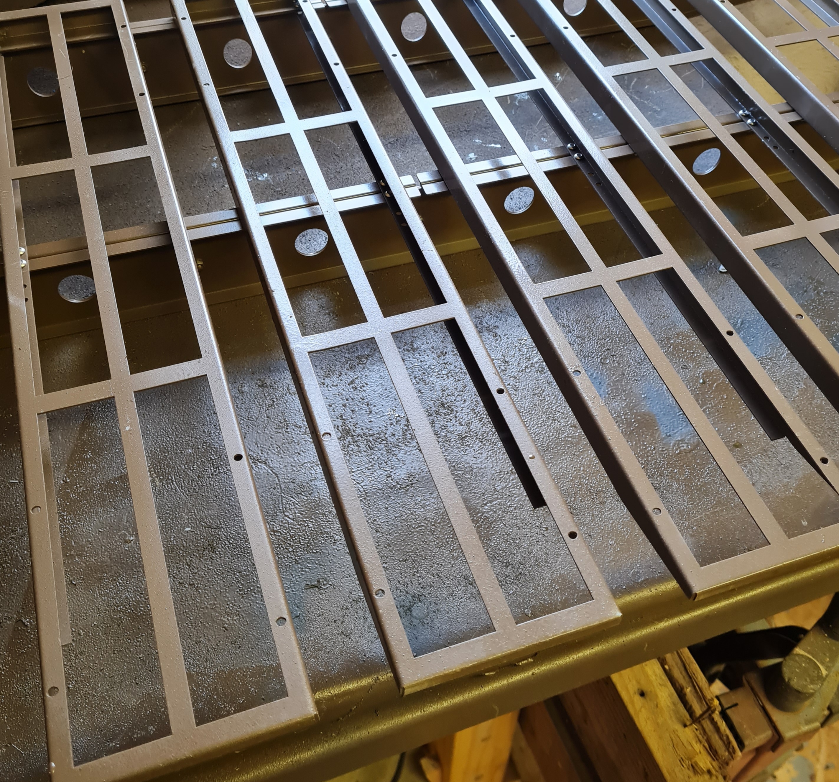

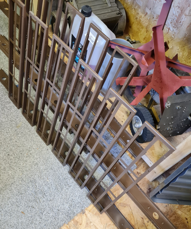

A few more bits done over the past few days and weekend.
We sprayed some dark grey primer on the fittings and a good bit of over spray then lightly sprayed with the brown hopefully to give it a used look and not the new car shiny look.
We may have a lead on some larch at a very good price for the slats with not to much work to do on them.
Enjoy the rest of the evening
Take care and stay safe
Steve and Luke
Side panels made
Side panels made
Both the ramps made
Both the ramps made

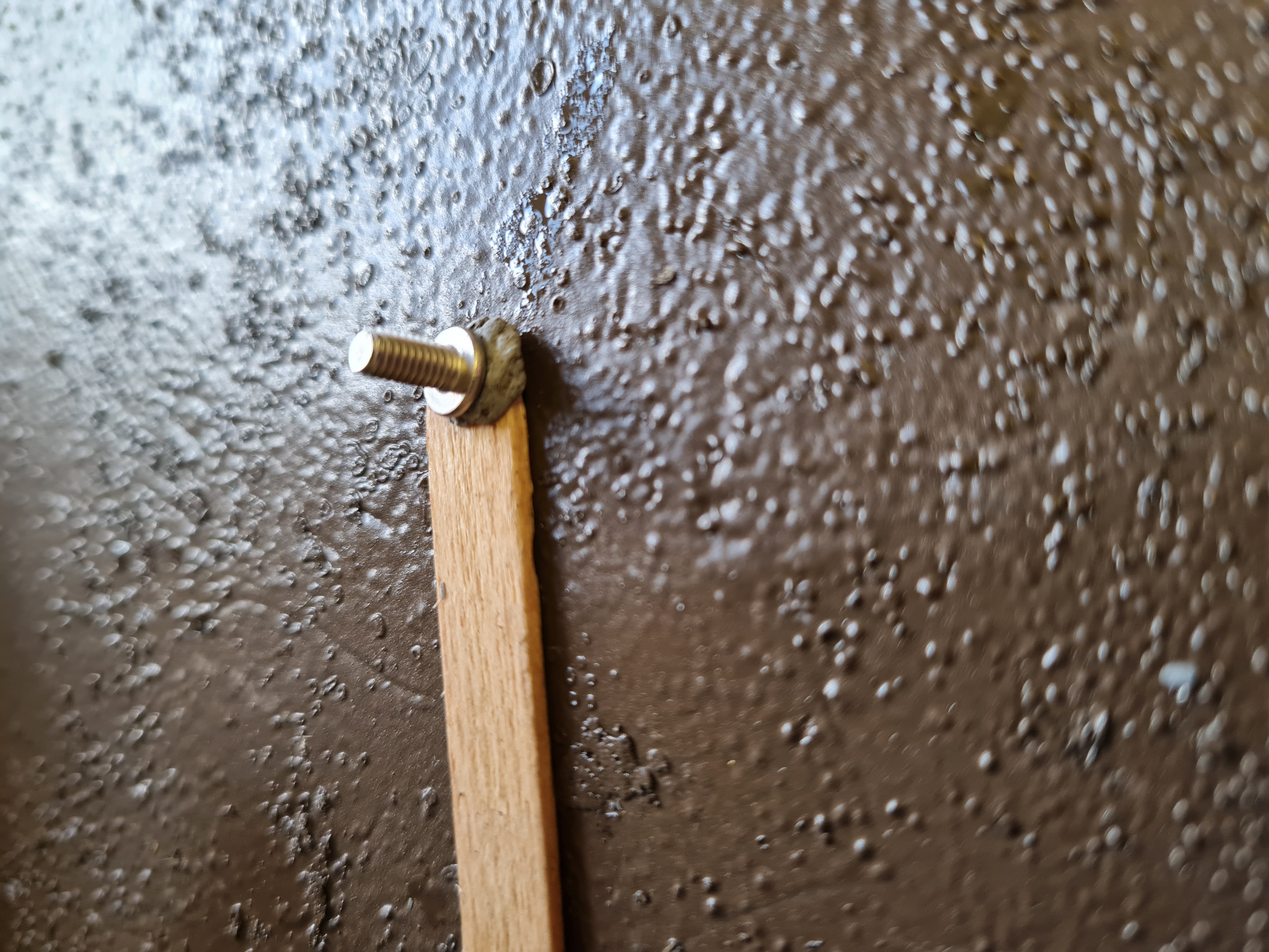

Special tool for getting the M3 x 6mm panheads into the holes that are hard to get to.<br />A small bit of blue tack stuck to  Mcdonalds tea stick lol works like a dream.

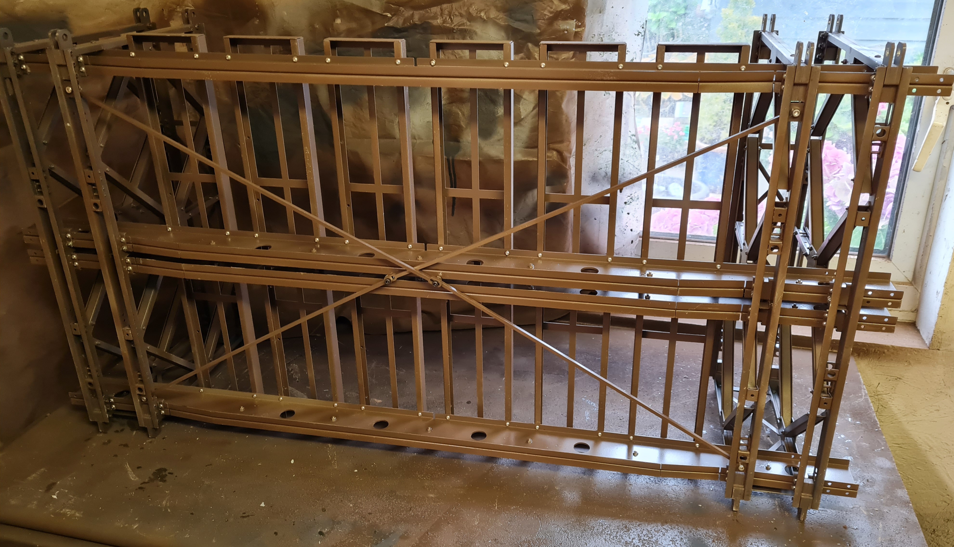

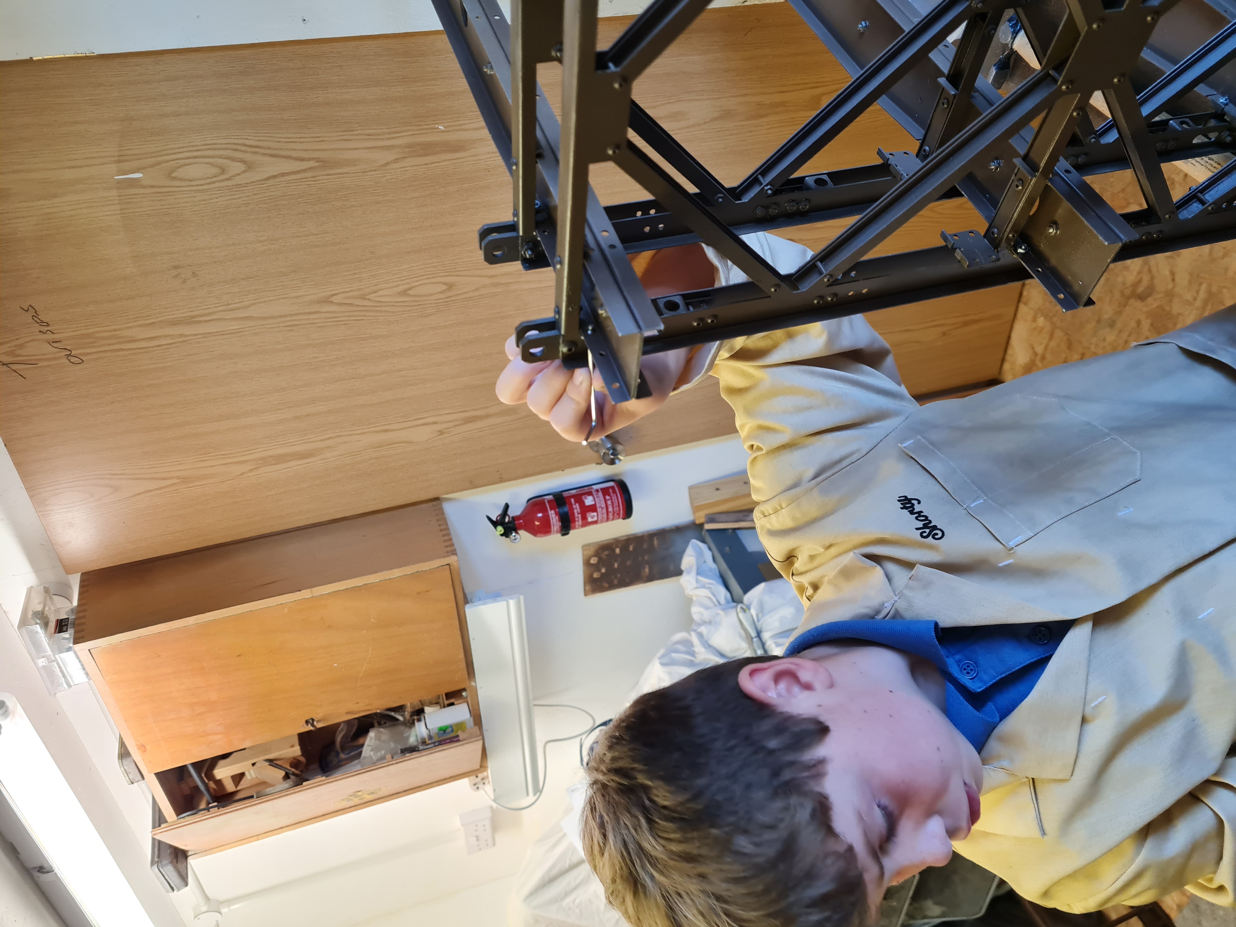

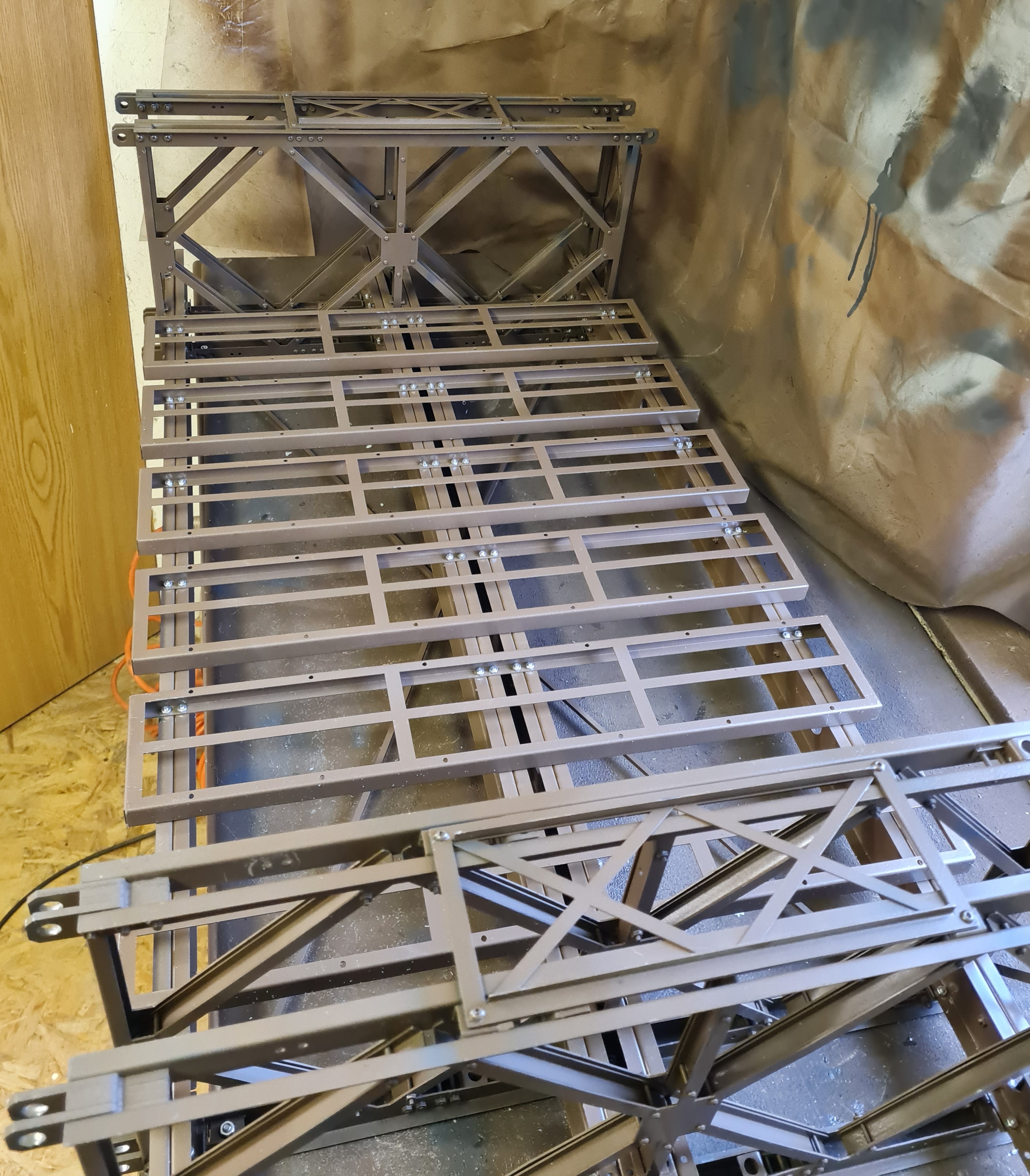

Just a quick midweek update tiny and I have made a start on the first span.
Take care all
Best Regards
Steve and Tiny
Getting the nuts and bolts fitted.
Tiny looking for a bit of help.

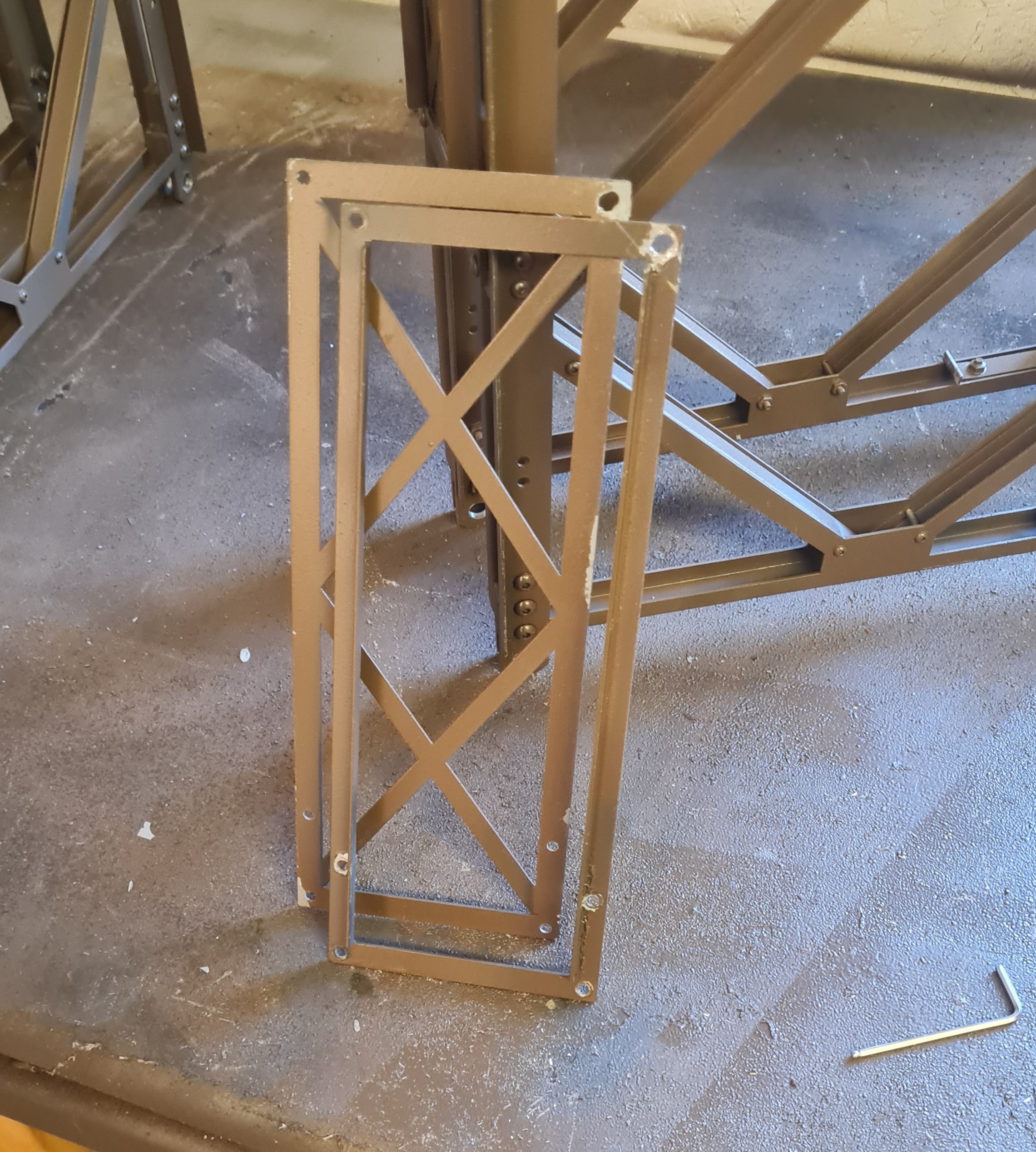

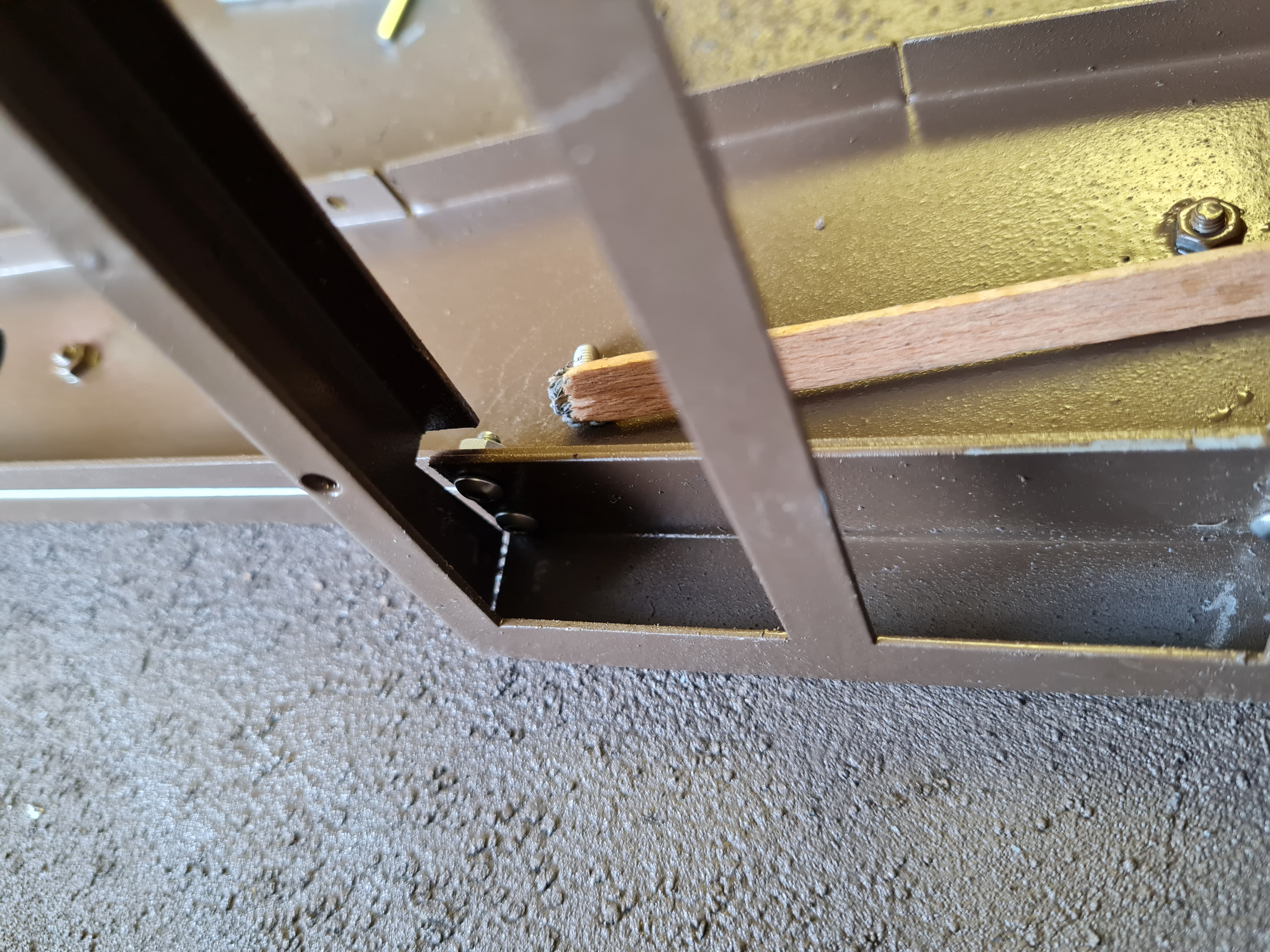

Well not a great deal done this week but one thing did crop up.

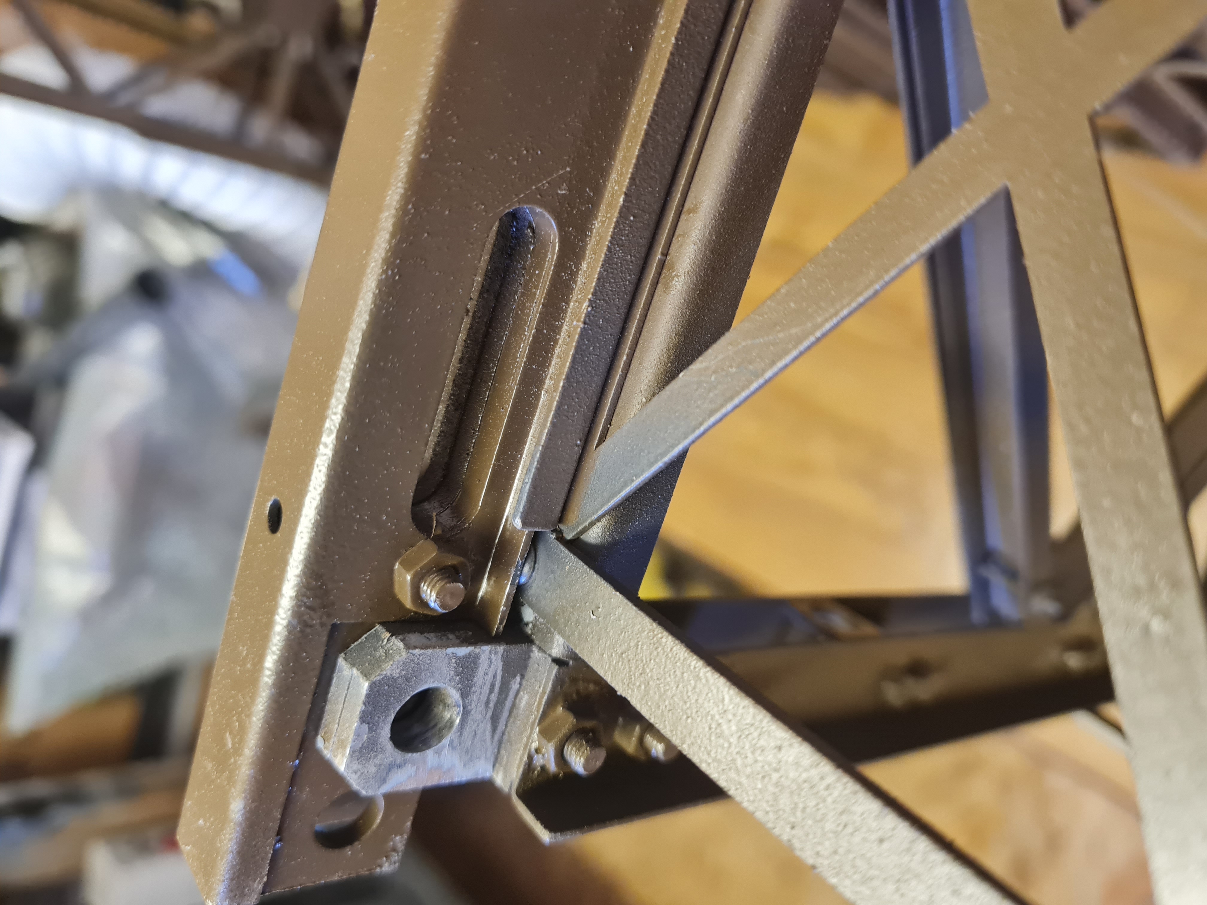

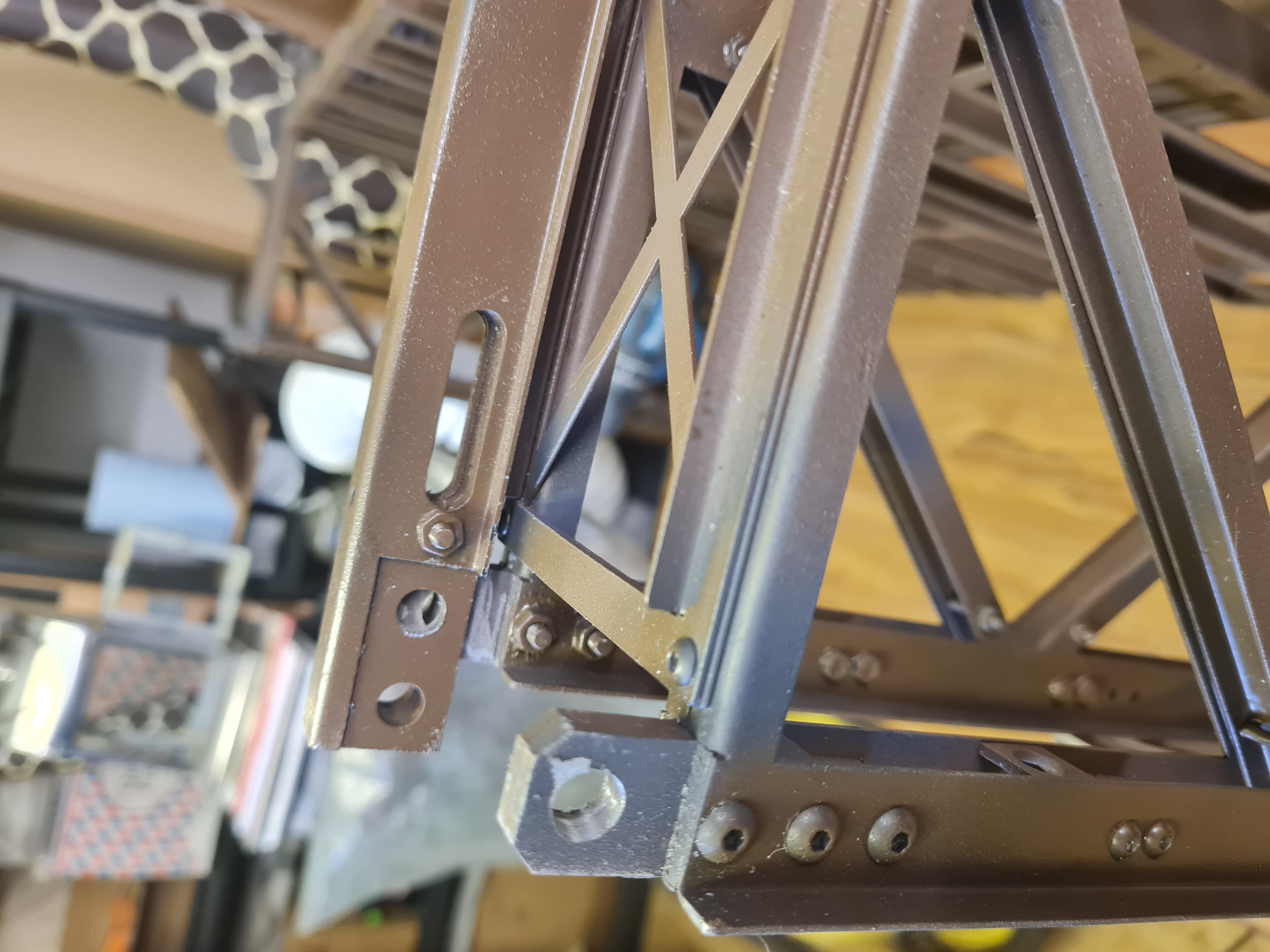

I was contacted by one of other forum members about a problem he found so after a lot of gigery pokery and a few choice words on my bridge I think I found the problem so I phoned kian for his advice just incase it was me getting it wrong.
The end posts will not fit to the spans with the bracing frames ( parts EN0134 135 ) fitted.
There has been a mistake in the instructions.
The bracing frames are fitted only to the span that is in the middle of the two spans I hope this makes sense to you all.
Both ramp ends are open.
Having said all that I am only removing ENO134 and retaining part 135 this is only because tiny and I were chatting and I ended up with an unsightly hole so part 135 will cover it nicely.
A big thank you to Kian for a worp speed response and all his help.
Take care and have a lovely weekend.
Steve and Luke
Part 135 ready to refit to hide hole.I dry fitted the end post and all is well it fits no problem.
Bracing frame removed.
End post fitted with bracing frame fitted the pin holes will not line up.
End post up against bracing frame so you can see what the problem is

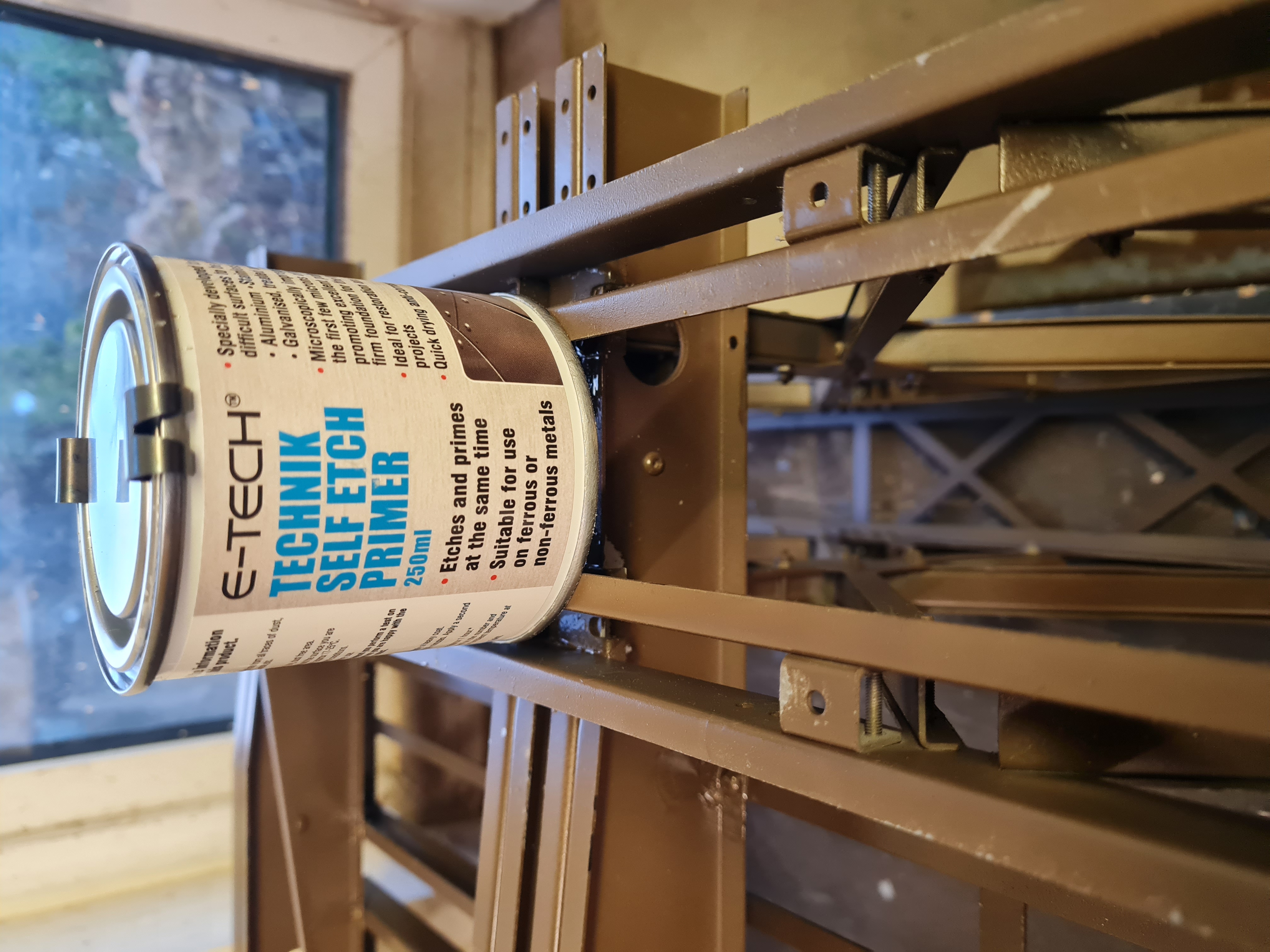

Well Tiny and I managed to get a cupel of hours in the workshop on Sunday.

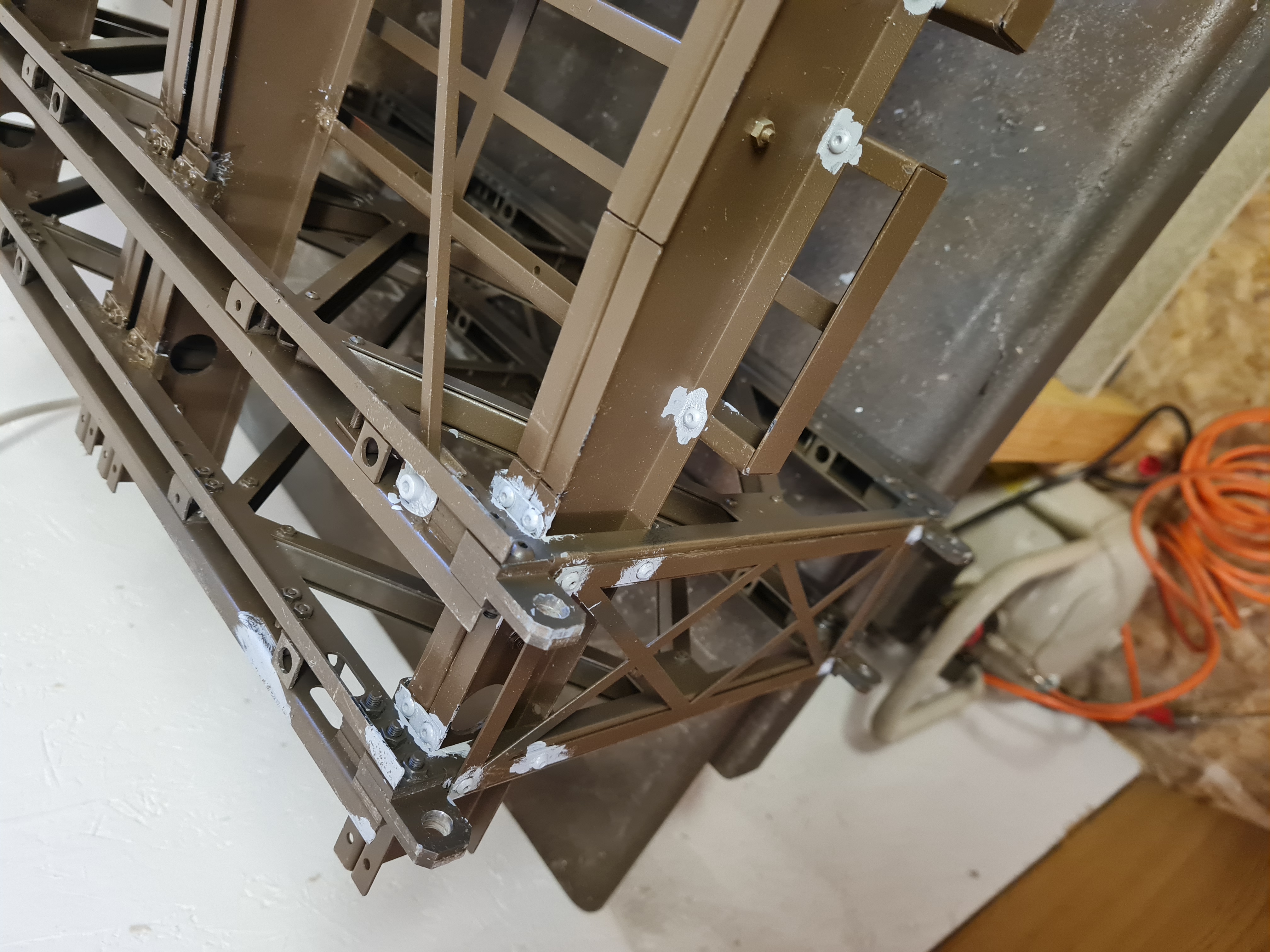

I brought a small tin of etch primer to paint all the silver ends of the fasteners and finished the assembly of span No2.
I also got fed up looking for a decent hard wood at a realistic price ( no such luck ) so I brought a small pile of red wood and a thicknesser plainer to bring it to size.
Our sapele tree trunk was just to big for us to process so we sold it and went for the more easy option.
Take care and keep safe.
Steve and Tiny
The plainer thicknesser from screwfix the only tool we never had in our workshop now we do .
The end of the fasteners primed just have to top coat them now
Etch primer from Amazon its light gray and works very well and dries very quickly.

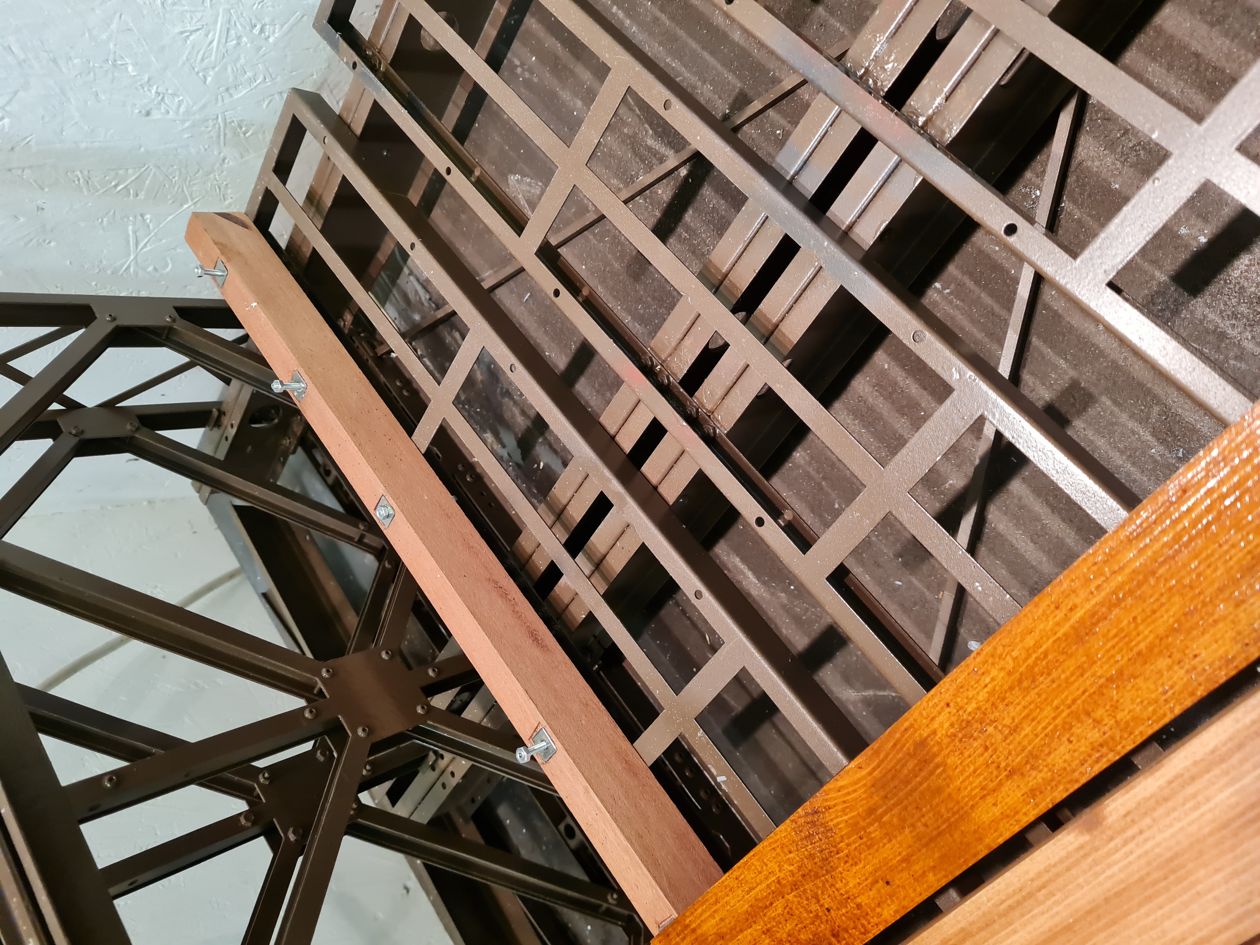

Hi guys

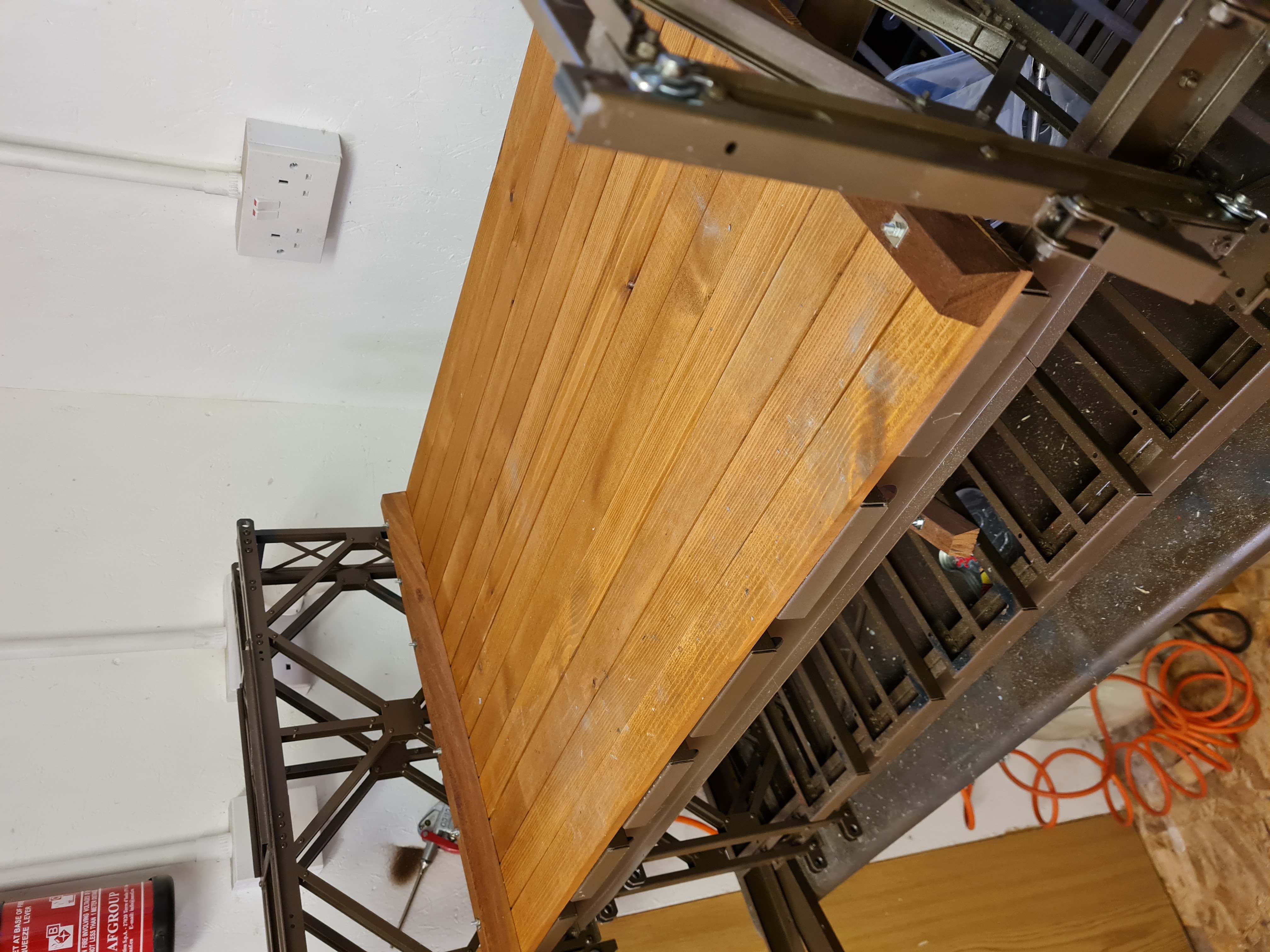

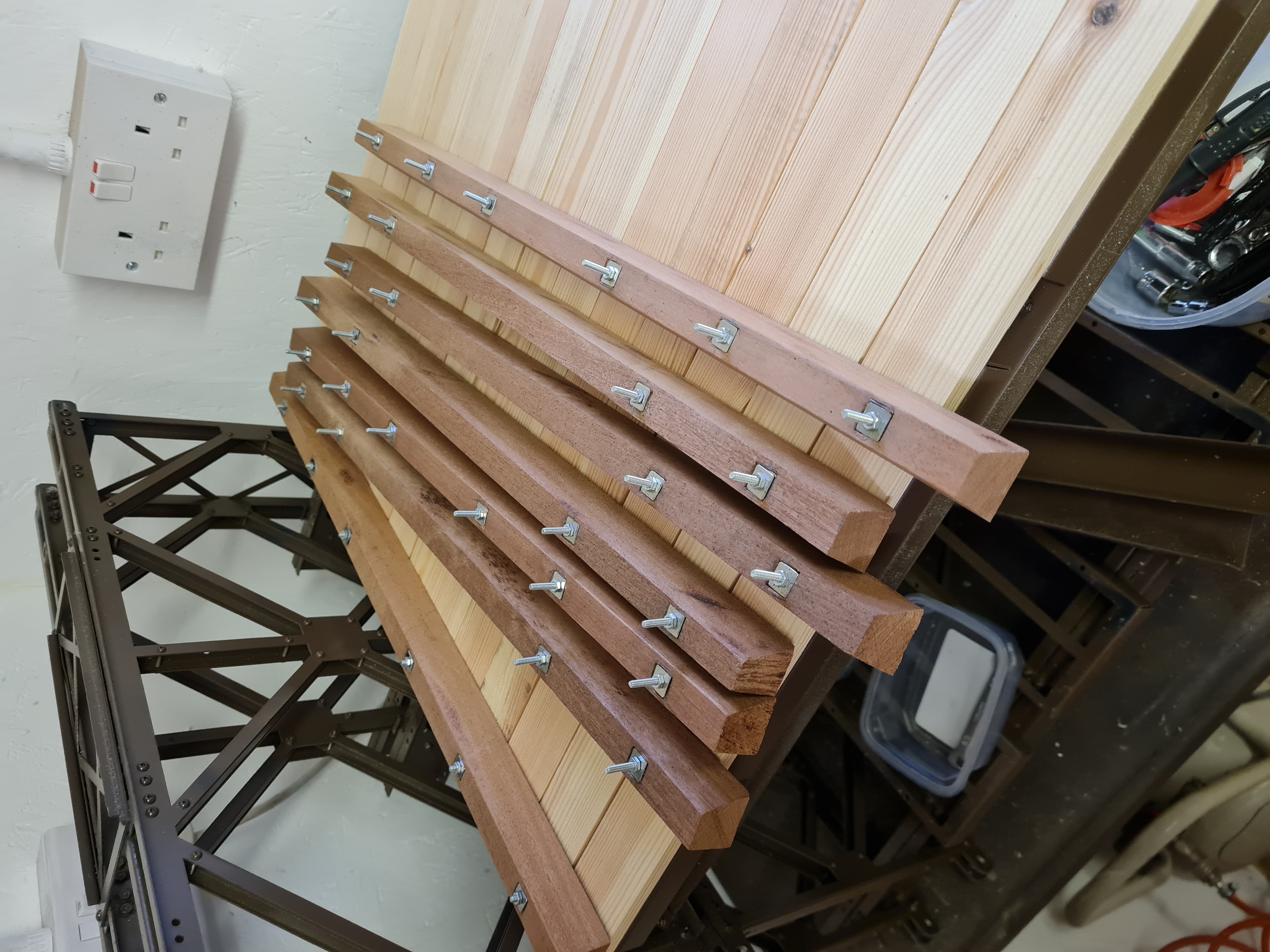

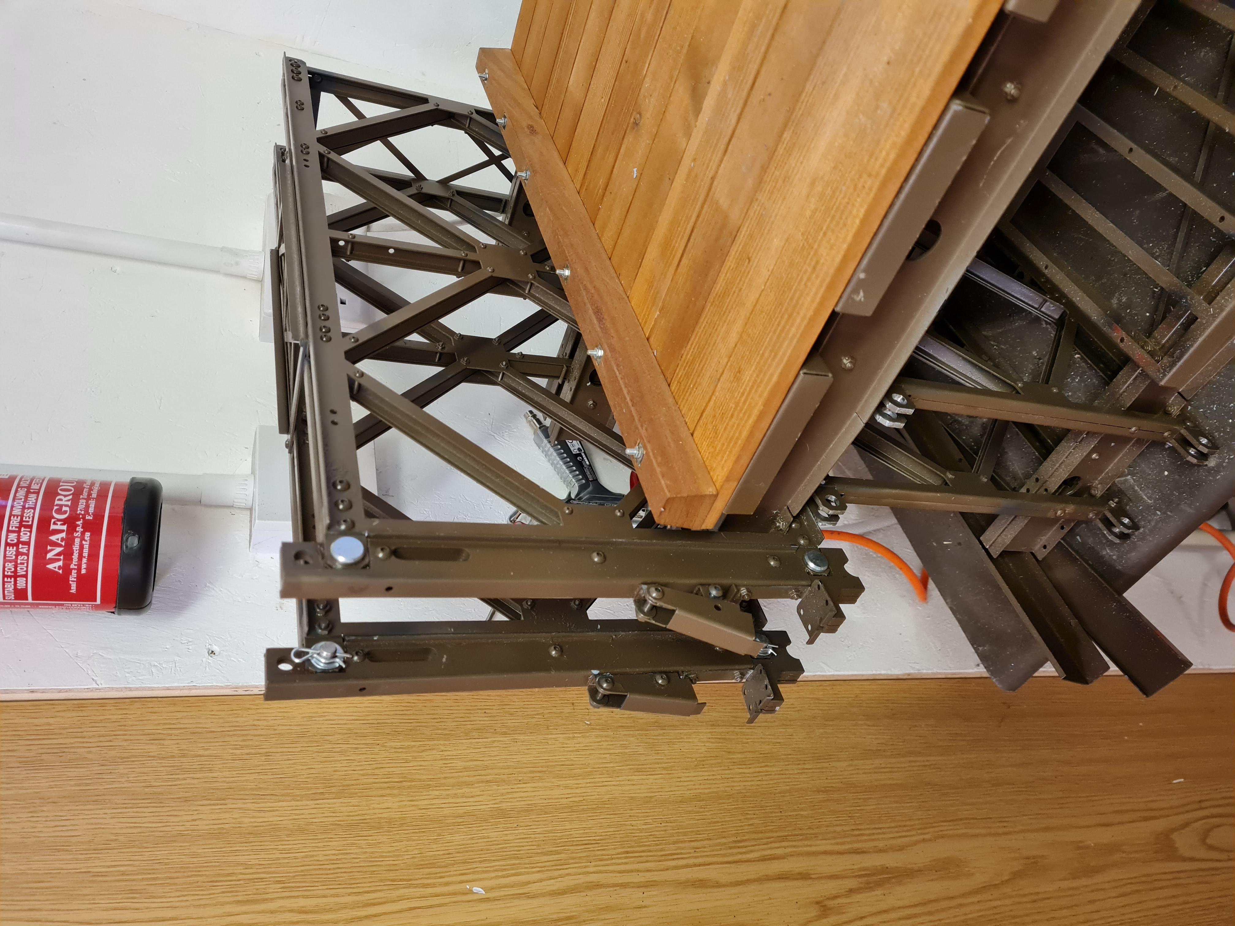

It's been a little while since our last post. Well, we finally got a bit of time to get back into the workshop over the past couple of days.
At last, we got the first span finished with the decking planks treaded and stained, ready for some weathering at a latter date.
I must give a big thank you to Phil D for the Ribands he made and sent up to us a first class job, Phil.

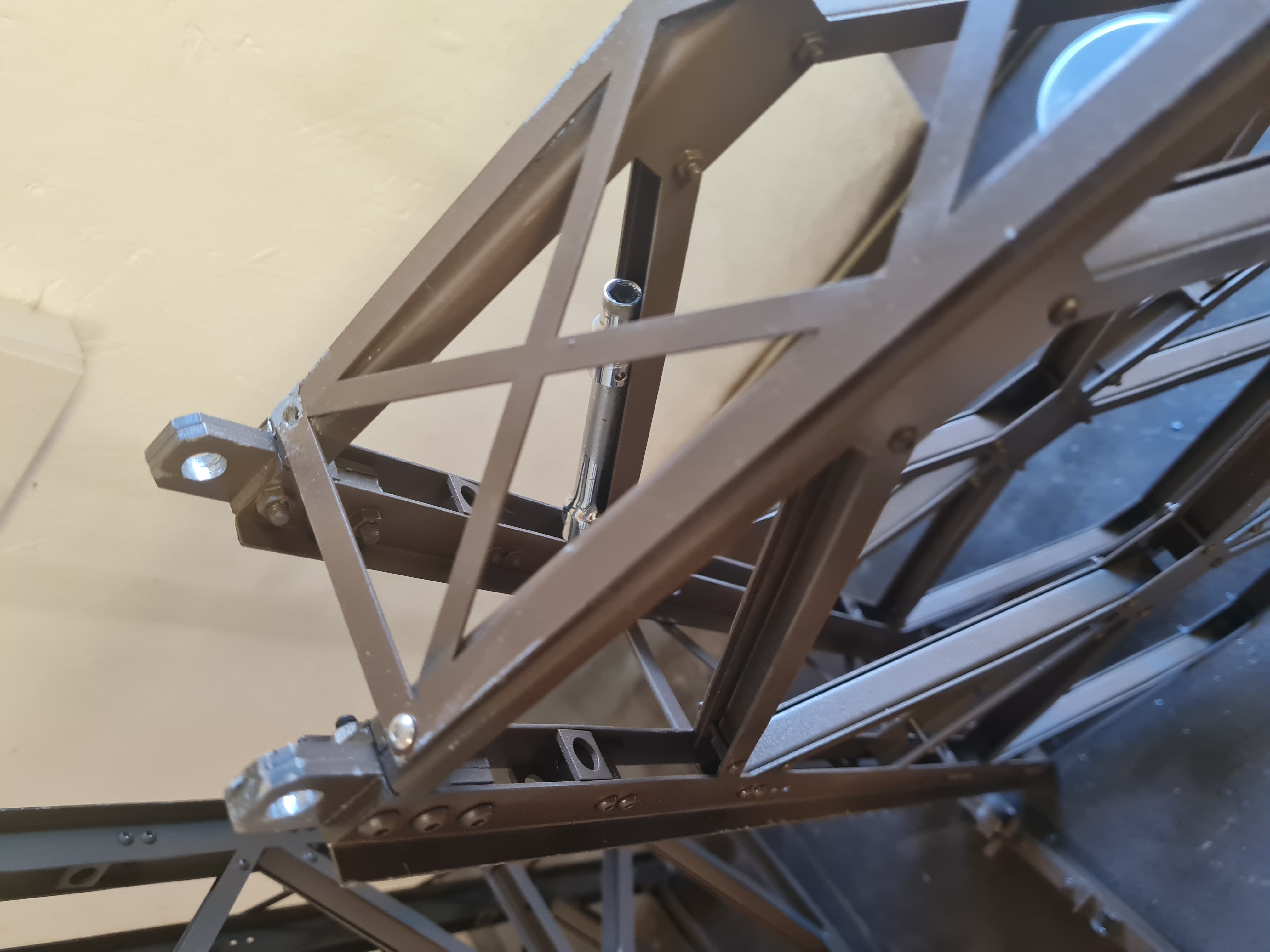

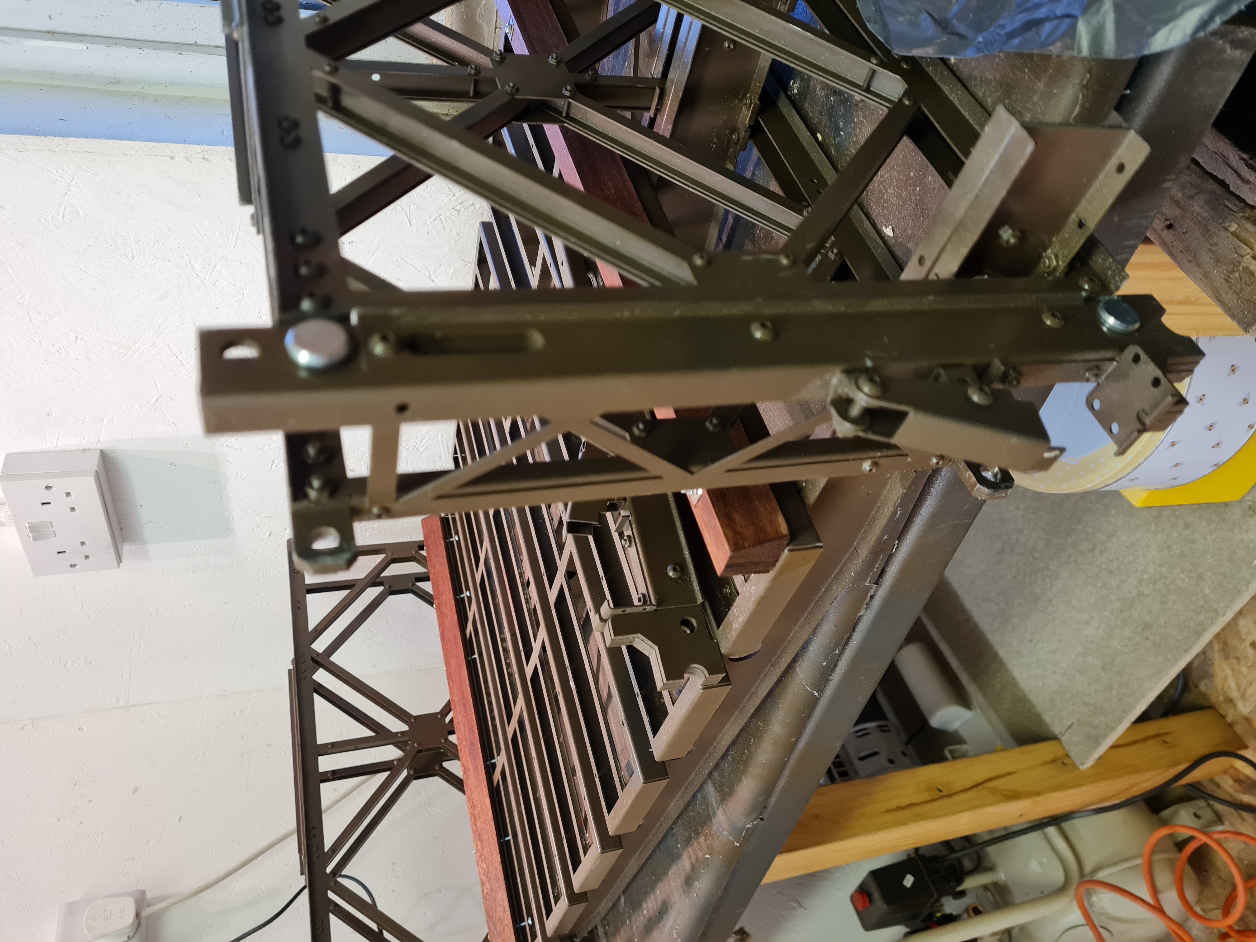

The end posts took a bit of filing to make them fit nicely due to the fact we had undercoated and topcoateded all the parts before assembly.
The thickness of the paint, even though thin, made a difference to fitting them. Also, the holes for the pins had to have a quick ream 8mm for an easy fit.
We made a start on span two, and my little mate slid away to take the doom buggy for a spin the only clean part of him was his boots.
Take care and keep safe .
Steve and Tiny.
One very dirty Tiny
One very dirty Tiny
Span two first endpost fitted
Span two started showing the planks first coat of preserve and second coat of stain
Span one
Span one
Span one finished
Span one finished
Ribands from Phil D
Ribands from Phil D
