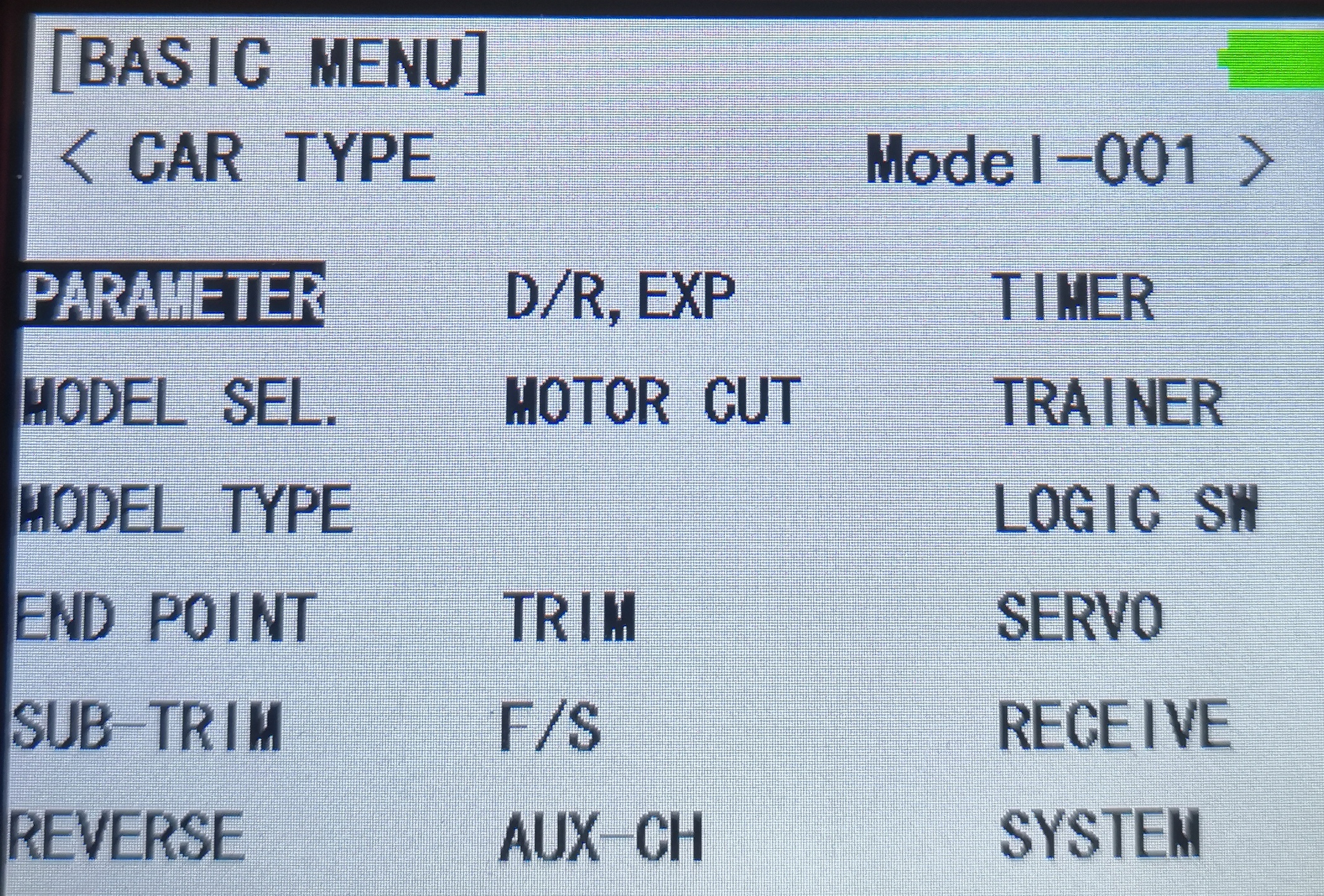

When you move the right stick up and down, channel 1 reacts.
When you move the right stick left and right, channel 2 reacts.
So you need to enable Elevon mixing of channels 1 and 2 to get single stick driving.
Section 3.3.11 in the version of the manual I downloaded.

I've put it in auto mode, but I can't find elevon in some places, maybe I'm stupid🤔🤔
Posts: 5130
Has liked: 1481 times
Been liked: 1687 times
Re: Power engine wire help
It says "Car Type" and I see an entry for ABS, so does this transmitter have a car mode as well as aircraft ?
Elevon would probably only be visible for an aircraft.
