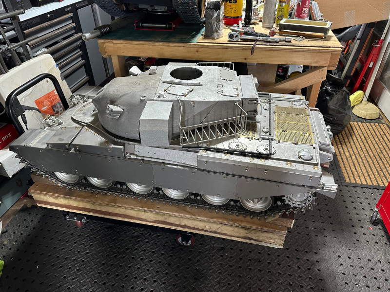

Safely in the Workshop

Re: New to Chieftain
Looks like you've got a decent build there Steve :lol:
Good to see you got it home safely, looking forward to seeing what you do with it.
Does it have double X stamped inside?
I was wondering what other goodies Armortek gave you with it? :mrgreen:

Post by Steve Cope »
Hi John
I must admit I have my work cut out, there are bits missing and I need to try and work out how to fix an issue with the turret bearing not lining up with the hull, so it is not fixed, there seems to be a 5mm gap between the front of the hull and the rear so none of the retaining holes line up, plus I will be stripping it down so that it can be painted as there is a lot of rust showing itself.
I will post pictures of my progress and I will post a picture of the issue I have got with none of the retaining position holes lining up, hopefully the communty will have ideas how to resolve
Yes the XX is stamped on the inside.
Sorry to say no goodies from Armortek :(
