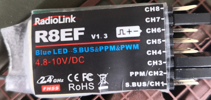

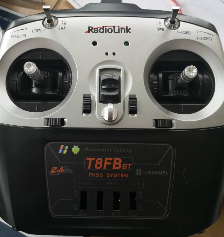

I have a RadioLink T8fb and an 8 channel receiver.
Receiver
Receiver
Sending
Sending
Has liked: 1492 times
Been liked: 1699 times
Re: Help help
Looking at the picture of the receiver, you can't see the colour of the wires, but the white lead should be at the top and the black lead at the bottom.
KimLarsen
Posts: 28
Joined: Wed Oct 25, 2023 2:47 pm
Been liked: 4 times
Re: Help help
Post by KimLarsen »
So are they.
It is the white one at the top, red in the middle, black at the bottom

Sorry if this is a re-send but as far as I can determine the first one did not go through for some reason.
I downloaded the manual for that transmitter ( available online ) and it says it is Mode 1.
Going by my understanding of the normal convention for channel allocation
1 Throttle
2 Aileron
3 Elevator
4 Rudder
The photo showing channels 2 & 3 on the receiver being connected would have 1 track moving with the left stick going up/down and the other track moving with the right stick going left/right
