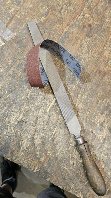

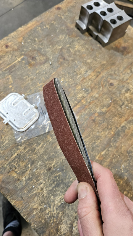

I use an electric belt file. Places like screwfix sell for about €50-€60. Various belts available and cheap. Makes short work of all these jobs. Stay clear of the black & decker. I went through more than 10 of those and they kept replacing under warranty.

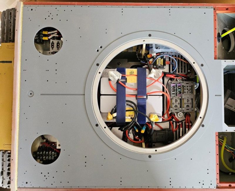

- AlastairCooke
- Posts: 248
- Has liked: 16 times
- Been liked: 776 times
Re: Dave's Tiger I (Early) Kit Build Thread
Hi Dave,
See image below from my thread and note that the bolts do not protrude from the nuts. I had to change out the countersunk fasteners as the originals were too short with the ring I added to make the countersinking easier to accomplish on my sheet steel roof plate (shown below). The fastener length had to be chosen carefully to avoid touching the gear on the rotation motor and fouling the motion. Alastair
