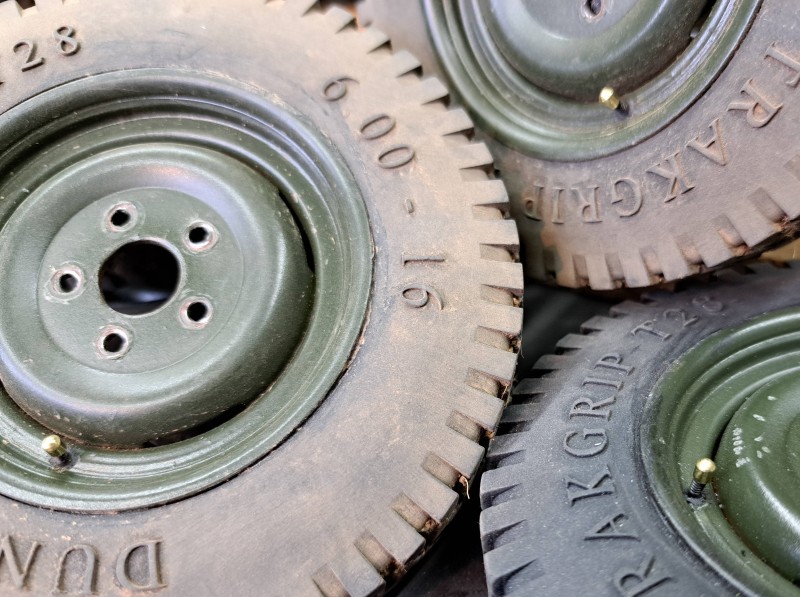

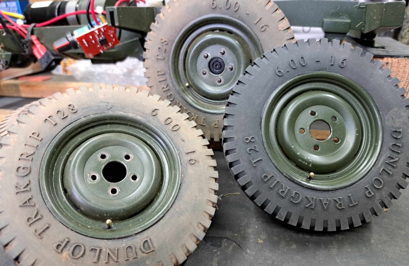

just a quicky, an early xmas pressy :D arrived for S1 (no.28):-
General view, they are tiny.
Closer look
Closer look
As John pointed out a bit of something sticky to hold them on and many thanks David.

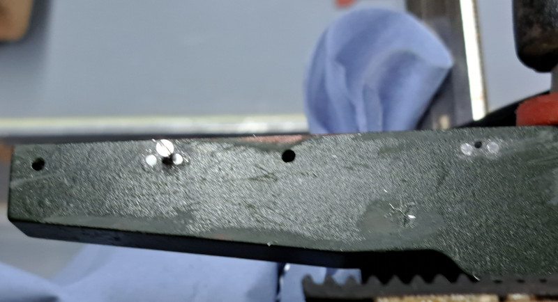

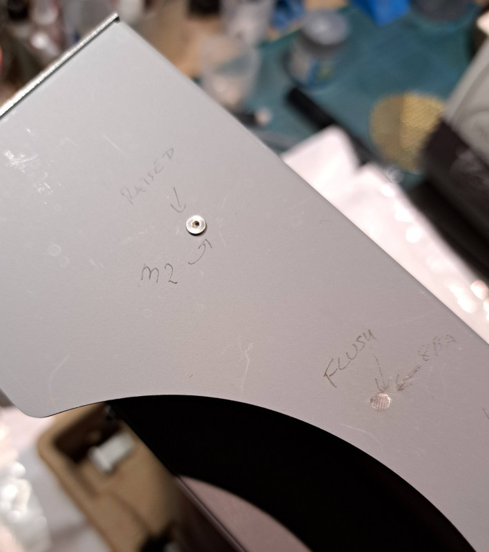

Just mucking about this afternoon with some lovely EKP (am I allowed to product place)slotless screws, 9BA would be ideal but filed down some 8BA instead, matches M2 better thread wise. 10BA to loose on the hole for my liking.
Filed down 8BA rivet screw replaces the m2.
I could have CSK the hole as is but metal tends to become too thin, spot welding, an option for those thus versed in the art could work too.

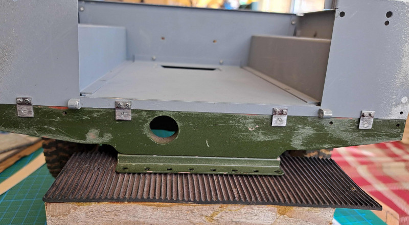

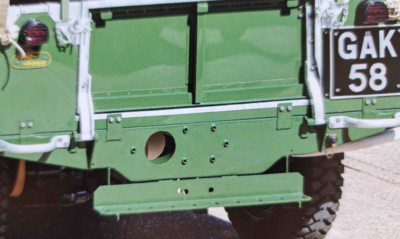

Hi all.
Lovely to see other S1's appearing and with useful tips too, I will certainly be using some of them in my build. However, over the weekend and after the arrival of more EKP screws:-

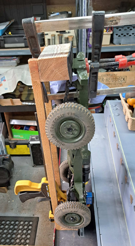

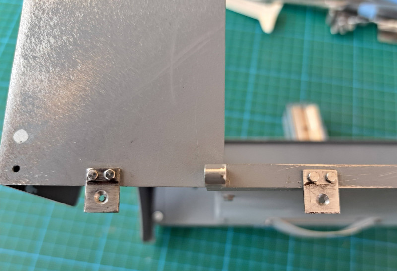

The aim or objective of this exercise, the "tabs" connecting the rear body to the chassis.
Method or madness, it helped, honest (though I did bend the towing hitch, too focused). Top tip, take it off first if going down this road.
Some old holes filled and new ones drilled and tapped, or maybe its me that's tapped.
New plates with CSK, ready for new screws.
And finally, all together, just needs some filler/repaint. Note the re-straightened tow hitch.
There we go, next up will be looking at the front end and hiding those CSK screws.

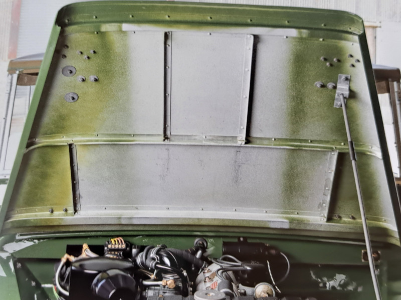

Had an afternoon spare today. So decide to complete the task of gluing on the rest of the placky rivets to No 28's bonnet (hood to those across the water).
To the rivet counters, numbers match but not necessarily in the right place. Some compromise was required.
Although I could dill out all the holes and put in metal rivets(probably wreck the bonnet), I would love to see if someone could replicate the underside of the bonnet(hood). That would be interesting.
Take care.

Posts: 2180
Has liked: 766 times
Been liked: 1739 times
Re: The life and times of No 28.
What's the purpose of all those rivets? Must be holding something on the other side.

Here you go Vince.
Frame work under the bonnet.
Nuts and bolts I can do. But riveting and bending "L" sections are beyond me. As I have said I will be pleased to watch those that can.
Take care.

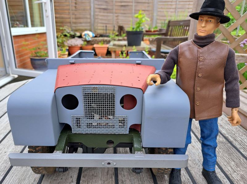

Not a lot to report but work continues on the front end and I am happy with the result, so far. Unfortunately my first attempt to replicate the later front end using slightly thinner metal meant it bent :cry:
The second attempt, the one shown here is the same thinner metal, but bolted to the kits front end. It is therefore much more rigid when handling the front section as a unit off the chassis.
After mating with the kits front end, I added 2x extra srcews.
Primed and fitted, (Chappie needs a pipe & a mug of something)
Please note the 'T' grill is only dry fitted with a magnet and does fit centrally. Though, be aware, I found my kit part ET0304 to be slightly off centre(1.5mm) when I used it as a template.

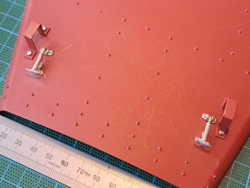

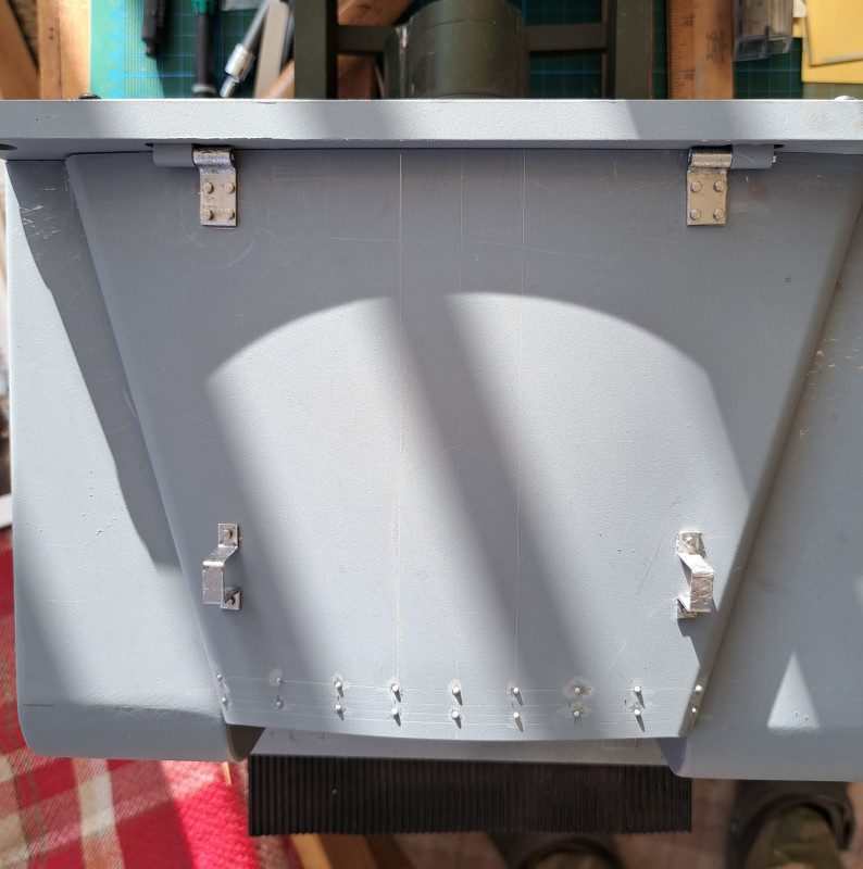

So here we have a couple of Armopax bonnet catches reworked to look S1 (ish):-
Re worked Armopax catches.
Note the use of slotted pan, the 14BA head hex bolts were a bit too tall.
Bonnet catches next when time permits.
Charles
Chieftain No.34, functional. PKW IV (2002), operational. Panther G No.18 (2022), started, well some of it is. Series 1 4x4 No.28 and a Bailey Bridge.

Looking good, very good. The rivets look fantastic.
There's a lot of work going in to just one component of this kit.
Your attention to detail is a treat to watch.
