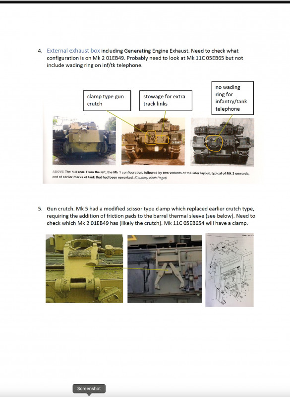

Just a quick question about the Chieftain, could you tell me what Mk 2-3 0r higher it is based on?
Has liked: 1040 times
Re: New to Chieftain
Steve - the Armortek Chieftain represents a Mk 5. I've not published these notes before but they show the research which went into the model, before Kian and the team measured prototypes at Bovington and did the detail design.
Enjoy your build. Good to have another Bluebell on board.
