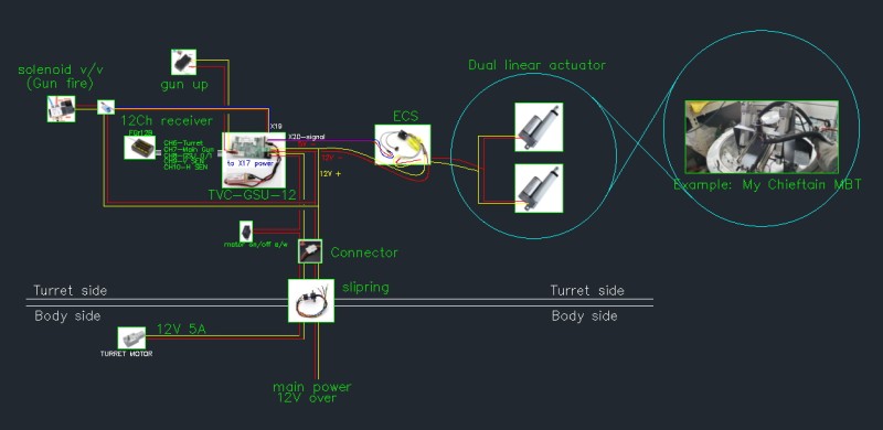

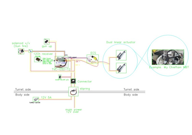

I share how to install GSU using linear actuator rather than servo.
So far, I've illustrated this method based on how to combine linear actuator installed on my Chieftain with GSU to be added in the future.
If you want to apply it to leopard, please refer to it.
